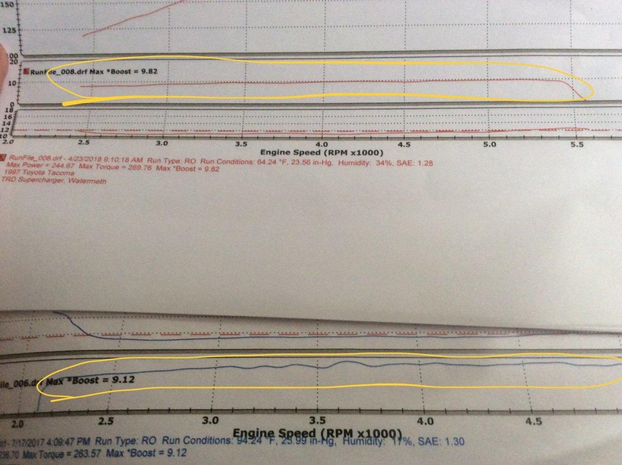

    Ok so the summary is all done and is shown below.
    Some big plus’s for a 50.00 swap
    Before the VOLVO ECU swap was done these are the numbers recorded by the same company that did both tests.
    MAX POWER HP 237 REAR WHEEL
    MAX TORQUE. 263. REAR WHEEL
    MAX BOOST. 9.12
    AFR was spot on consistent across the whole RPM
    Boost pressure graph was a little erratic, not totally linear
    Summary after Volvo MAF swap with new DESNO sensor was completed
    MAX POWER HP 245 REAR WHEEL
    MAX TORQUE. 270. REAR WHEEL
    MAX BOOST. 9.82
    AFR was spot on consistent across the total rpm band
    Boost pressure graph was very linear across rpm band unlike the 1st test.
    TORQUE PEAKED AT 10 more at 4500rpms then the 1st dyno.
    TORQUE WAS +5 more, higher across the whole chart minimum and maxing at +10 more peaking at 270 rear wheel
    HORSE POWER CURVE WAS THE SAME FOOT PRINT with the added +8 horses give or take in some areas.
    Rear wheel Horse power went up +8hp
    Rear wheel torque went up +7
    Rear wheel torque peaked +10 more at 4500rpms compared to stock MAF
    Boost went up .70 pounds.
    Gained 1-2 MPG
    Boosts pressure was much more linear in power than stock MAF uneven chart
    Can replace the MAF sensor in 5 minutes now
    No air restriction in the MAF tube now
    My AFR stayed the same, same footprint before swap and after swap
    This swap has been perfect with zero negativity for 1997 v6 Superchargered Tacoma
    All positive results
    The 1995 and 1996 ECU is different than the 1997-1999 ECU and this swap
    might be problematic with a lean code for the 1995-1996 years to adapt to the newer DESNO sensor and the Volvo tube section.

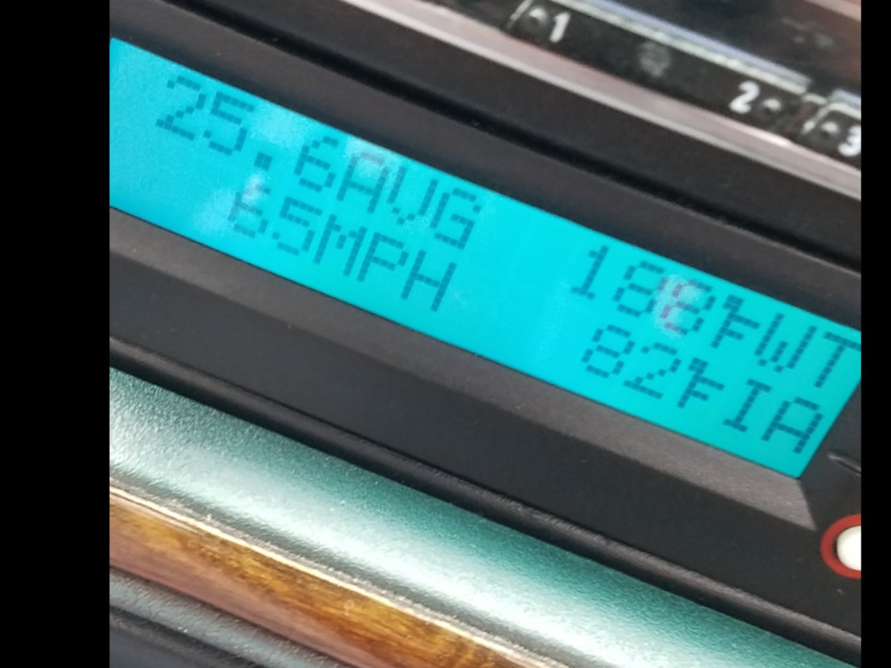

    UPDATE
    2 months later and 5,000 plus miles on this conversion and everything works perfectly.
    No codes, no issues, even had my mpg as high as 25mpg at 65 on the highway
    New 3 core ALL aluminum radiator (200.00) also keeps my temps at 185-190
    Best 50.00 I have spent in a long time
    And Radiator was another fantastic conversation for 200.00

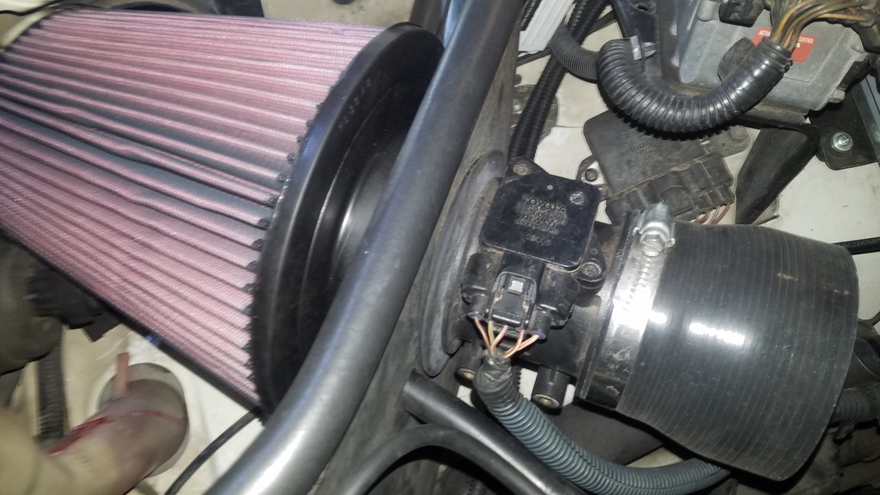

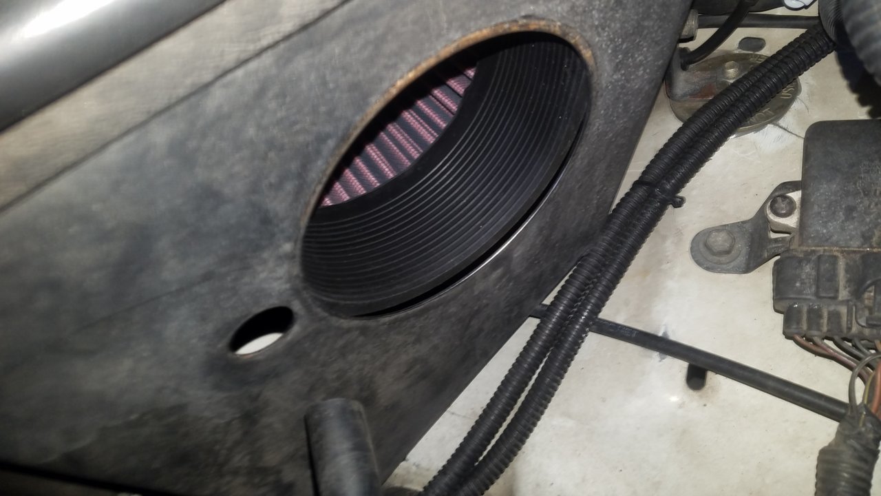

    Any pictures of how it was done on the k&N?
  16. Oct 24, 2018 at 7:21 PM
    #76
    1997tacomav6
    1997tacomav6 [OP] V6 5sp,RegCab,TVS1320 Supercharger,Haltech, 800k
    Oct 5, 2013
    #113940
    10,386
    John
    Denver
    97 reg cab, v6 5sp 300hp supercharged, Methonal Injection, 800,001 plus miles, Original Owner
    V6 5sp,RegCab,TVS1320 Supercharger, 56mm pulley, methanol injected Haltech ECU, AC Tvs1320 supercharger,(MUST DO) every 125,000- 150,000 needs rebuild Projector headlights HID 5 speed manual Amsoil for all drive train Smaller 56mm custom pulley, (MUST DO) 2004 DESNO fuel injectors, zero ping ping, 2004 side door mirrors Dick Cepek Rims, Michelin tires LTX, ATM Pathfinders Dynopro ATM ( that last 100,000 miles) Now running Dynopro ATM mud and snow tires KN cold air intake Cat back dual exhaust with ss exhaust tip, Raised exhaust tail pipe to 2" below body line Optima*dry cell battery,red top Alpine sirius radio, 200 watt amp, focal is165 split door pod speakers Focal door speakers Subwoffer behind seat Viper alarm, Electric Locks Dark tinted windows, bucket seats corbeau lg1 Tacoma Rubber floor mats TRD fender extenders, Bilstien shocks, King shocks JBA UCA trailer iv hitch, electric brake control, Drilled slotted brakes, High carbon steel (MUST DO) EBS green stuff 7000 series pads(MUST DO) TRD engine oil cap TRD stick shift, Marlin crawl shift kit. Rear sliding window 2002 4Runner functional hood scoop cut into Tacoma hood, 4Runner dual overhead map light Gentex Auto dim + Compass + Temp, garage,rearview mirror Snow Methonal kit stage 2 Custom 3 core aluminum radiator Linex bed liner Haltech stand alone ECU, Intake supercharger gauge. Stainless steel brake lines, Custom leather wrapped steering wheel, Haltech stand-alone ECU,

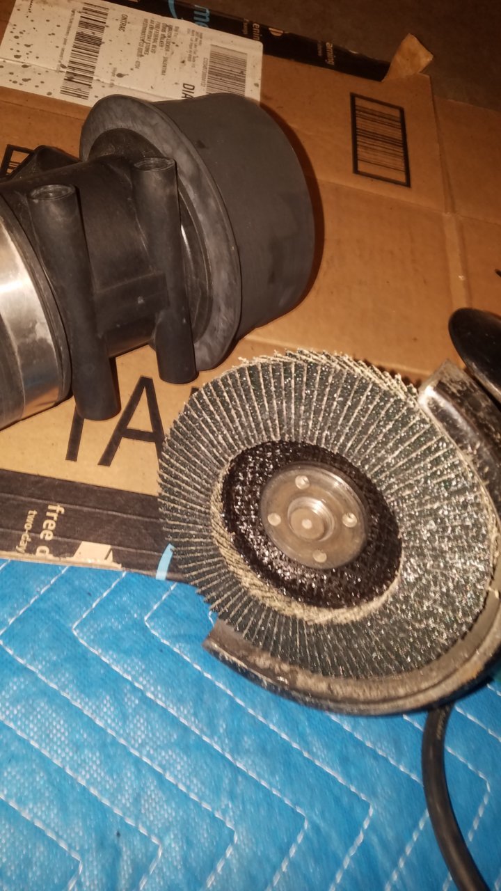

    I got a different tube reducer, went to the auto parts store and matched on up.
    The rubber donut that slides into the KN FILTER I had to sand it down a good 1/4” to get it to fit.
    Circled in yelow
    The reducer in red in the KN reducer and needs to be a bit longer
    Still working perfectly with zero issues

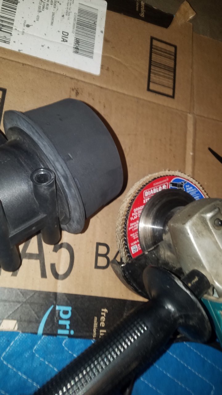

    This is the larger reducer I used, its abit longer and fits better.
    This is how it goes together.
    Used a 80 grit sandpaper the take off a good 1/8”-1/4” of the rubber so
    the donut will fir through the kn steel bracket wall.

    This is the rubber sleeve from KN that I had to sand down 1/4” in order to fit through the metal kn support because the new Volvo
    input section is 1/4” larger so the sleeve goes on very tight on both ends
