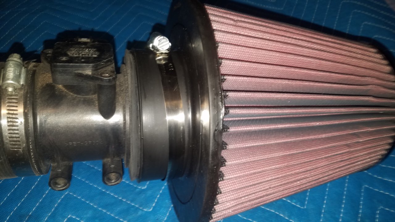

    This is how it connects without the KN bracket

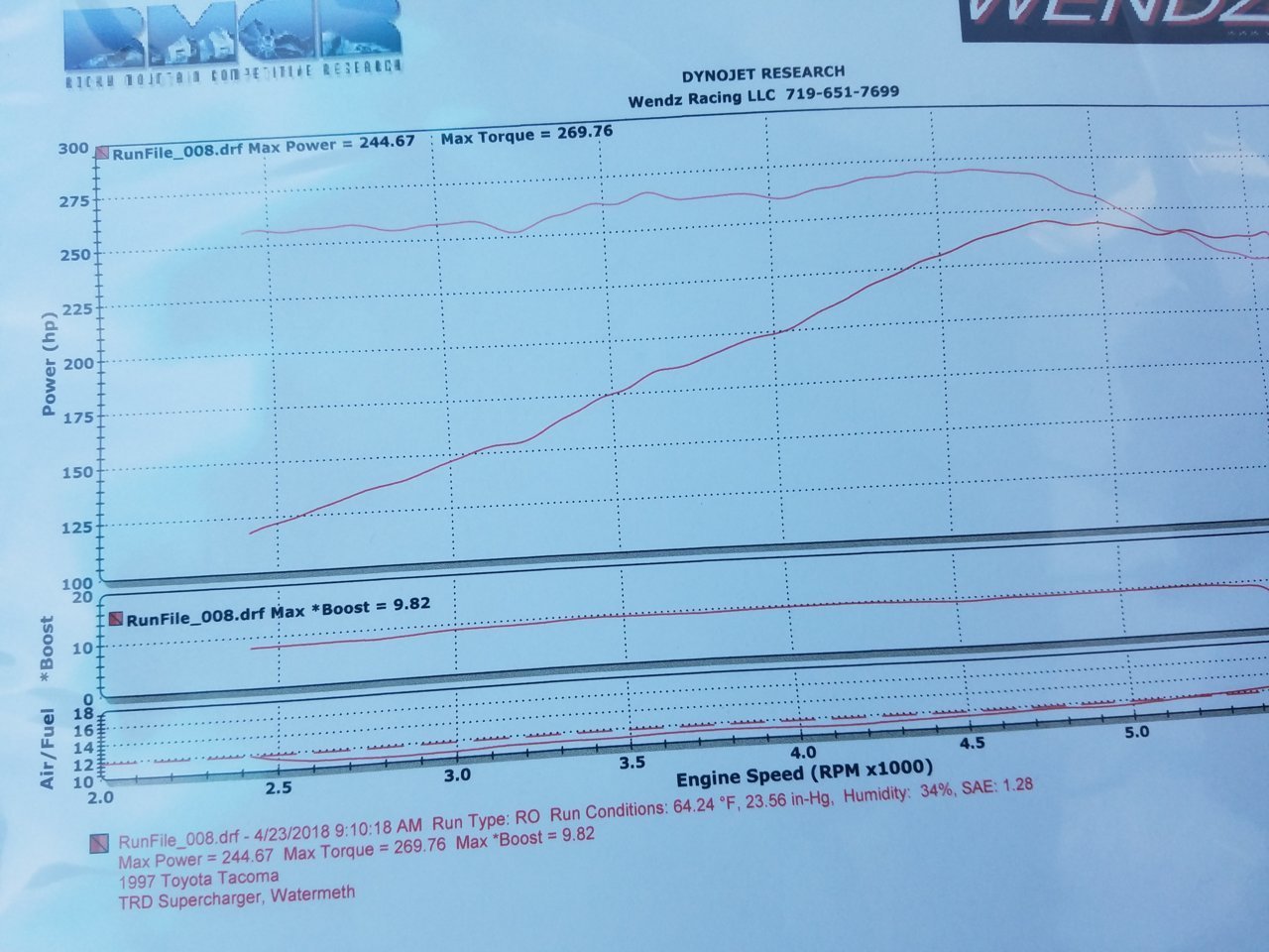

    Supercharger is being ported now, so when it gets back I might have new numbers, anyway the Volvo mod works perfectly and I did a dyno
    after the mod and the AFR reads perfectly, zero issues and gained a few horses.
    Does not work for the 95-96 ECU, I have a 97 ECU.
    You can actually look at the AFR reading on
    the dyno chart.
    But I am spraying methanol at 4.5 boost up
    for the supercharger
