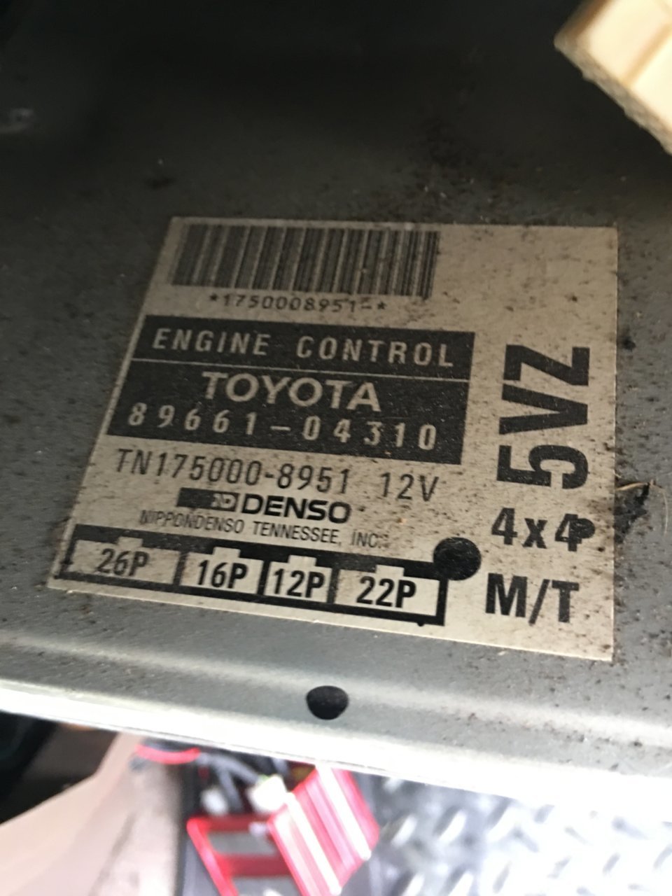

    Let me go check the part number on mine. I’ve never had issues with the SC. I still get some light ping but I’ve learned to drive around it.
    I’m about to pull the trigger on this mod but I’m nervous it might throw something off with the ecu and trims. I’ll still probably try it though.

    This will be handy if both of you can show your ECU PN's. Might clear up a lot of questions and frustration potentially.

    Can I snap a pic of the PN without touching the ecu? I have all my 7th injector connections stuffed up in there and I’d hate to pull it all out and mess up a connection lol.

    No its on top of the ECU. You have to unbolt it at least and angle it down.

    Ok let me see

    awesome thanks!
    That confirms that again for the 2nd time for me..

    Well, shit. I was honestly hoping there was another P/N that was a magic bullet.

    It was easier to pull than I was expecting haha. Glad I could help

    So my ECU IS 89661 04300

    My truck has an EGR system, so its a California emissions, has 2004 injectors
    that are just a bit larger than 1997 injectors.
    Methanol injected for about 40,000 miles
    10 pounds of boost
    2" pulley
    Zero ping
    Volvo mod done in March
    Maybe 12,000 -15,000 miles on the mod with zero problems
    So my original PN ECU IS 89661 04300

    So we have different ecus. Must have to do with the egr and emissions stuff you have. Mines non egr. Curious what @Blackdawg gathered from his research as far the 04300 ecu and boost. Obviously we know it works because your truck runs fine with boost.
