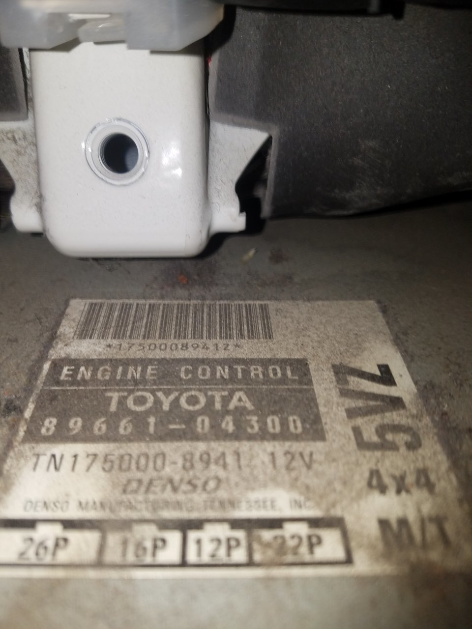

    Thanks John,
    That is very interesting.
    I wonder if @Dirty Pool would have any insite into this.
    Both the 04310 and 04300 were made at the same time. However, the 04310 is marked as "discontinued" from Toyota.
    Had different Vin associations
    VZN170 for the 04310 vs VZN160 for the 04300

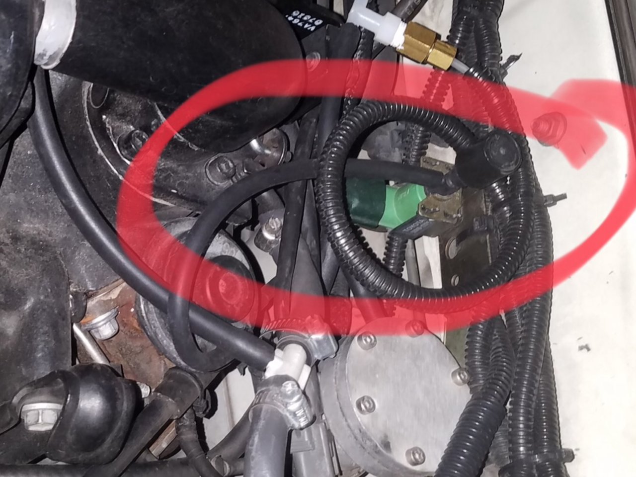

    It's like the SX got its own ECU or something..I wonder wtf is in My SX now..Will have to check!

    My SX also has EGR.

    That would help explain differing part numbers from the same time. EGR is a PITA but easily deleted at least

    yeah should be easy to get rid of it if so inclined. Could be what the difference is. though I fail to see how EGR has anything to do with it as its not an electronic system.

    It's less Tacoma and more mod
    It is completely electronic, VSVs control the operation of the EGR diaphragms and the temp is monitored by the ECU to determine EGR flow at any given duty cycle.
    cruiserguy and Blackdawg[QUOTED] like this.

    No EGR here. I wonder if that's the only difference, and if so, how it would the two ECM's work with opposing trucks.

    I mean considering you can block the EGR easily you should be able to swap it easy enough and it won't be pissed off. Whether it's an improvement or not..that's the real question. If you buy it let us know. Im gonna see what my SX has in it. It's a 95 so likely an earlier model ECU.
