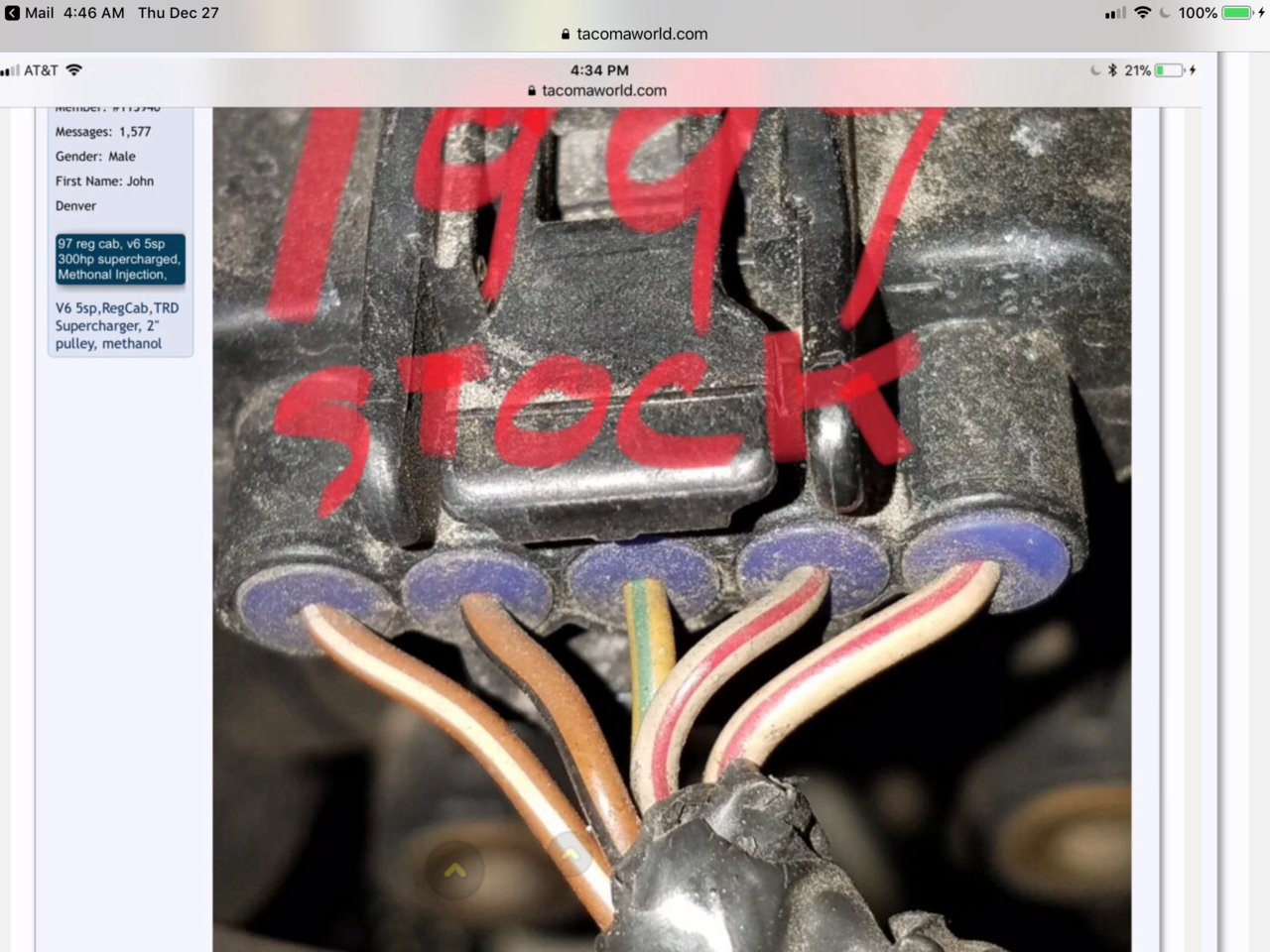

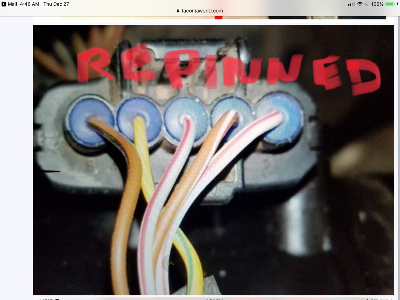

    Question about the wiring. I'm about to do this and saw that there are two wires that are white with the red stripe. Which one do I reposition?IMG_2780.jpg

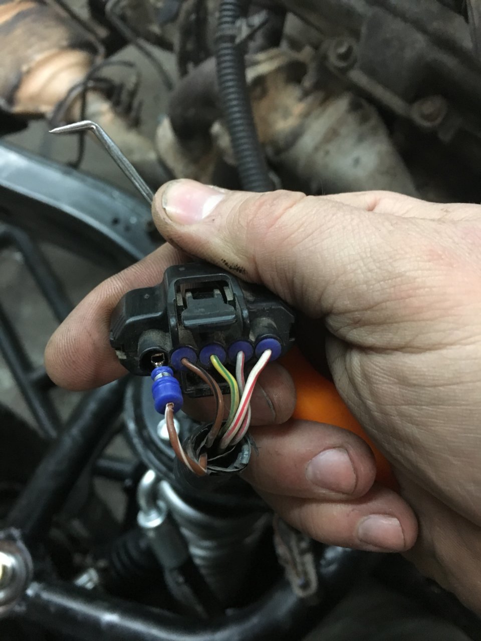

    If I remember correctly you move all of them except the far right red and white wire,
    So the hiccups I had with this setup was trying to figure where the tab was to press down to release the pin wires.
    There is a tiny tiny single plastic tab directly under each of the tiny 5 metal clips inside the connector. You get a eye glass screw driver or a little larger and push each one down and then just pull the
    wire out from the back.
    There is a white plastic clip that you pry off starting on one side.
    When you repin the wires each wire has to go in the exact same way it came out. The tiny prongs point down when you reinstall the wires. When you push the wires back in there will
    be a click sound and it locks in. If these are not put in correctly the white plastic clip from the front will not fit back in after all the wires are repined.

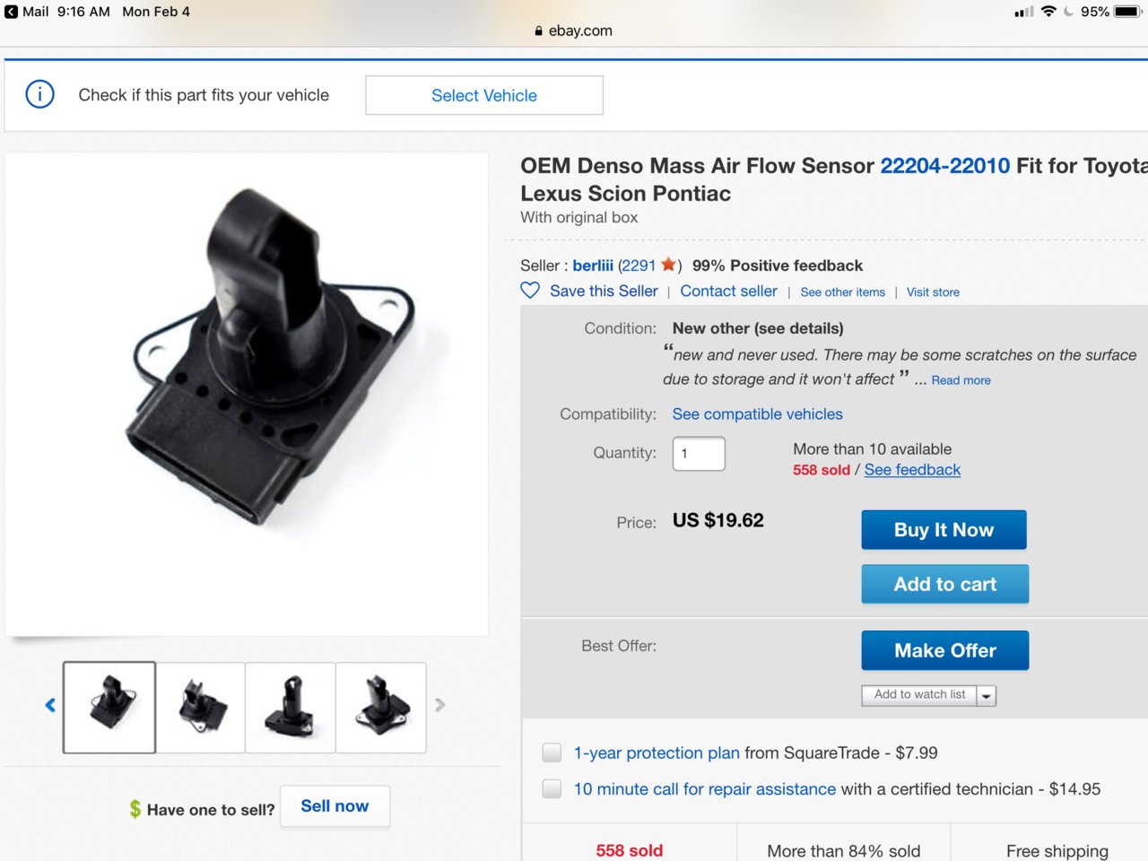

    Just ordered the Volvo MAF duct and the Denso MAF linked above, but was wondering if anyone has any concerns about these Ebay MAFs selling for $20 or less? Seems like the Toyota price is around $150, how can these Ebay sellers sell them for that much cheaper?

    That’s the seller I got mine from last year, zero issues,
    He has sold 500 plus of these with no neg feedbacks, comes In The Toyota box too

    Awesome, that's very reassuring, thank you! Can't wait to do this mod!
