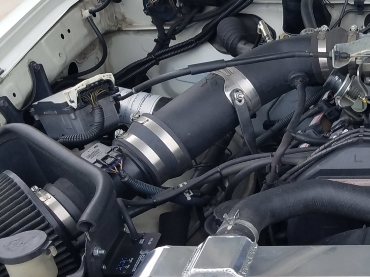

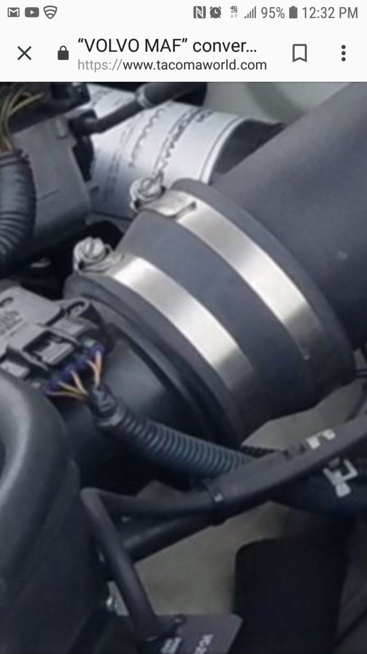

    This is how mine came out, had to get a different rubber tube connector too
    SpikerEng and JKO1998[QUOTED] like this.

    I mean the rubber connector I had to get one that was an inch longer because it wasn't connecting the two sections together

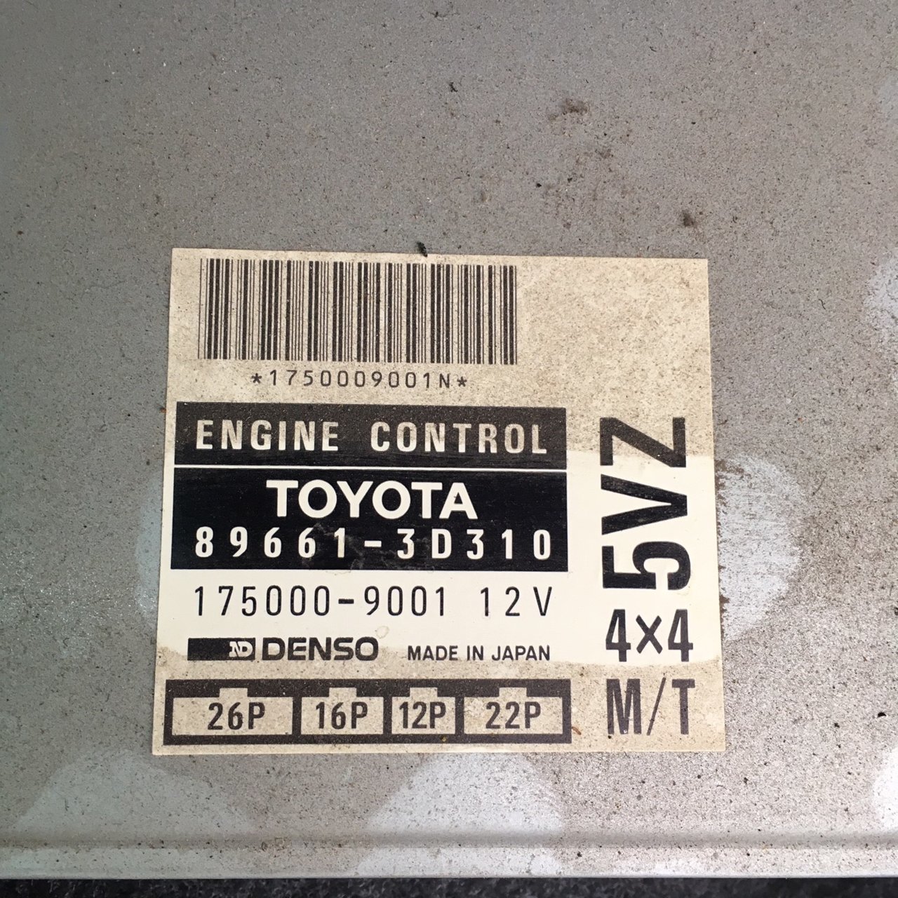

    Parts are ordered. I'll also attempt to photograph the ECU on my '97 4Runner. Thank you for this thread!

    1997 4runner ECU

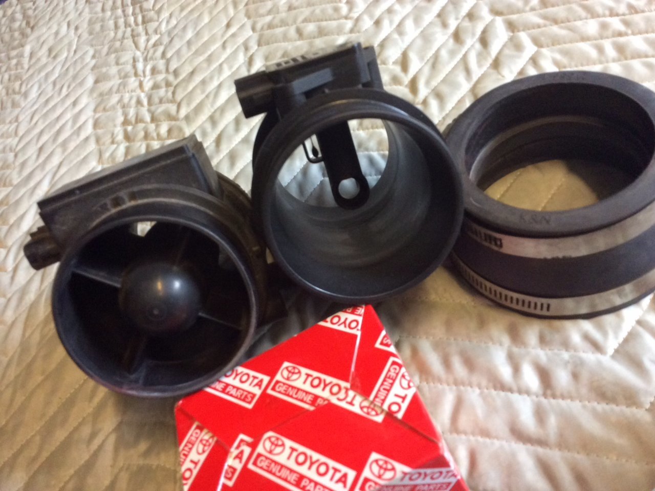

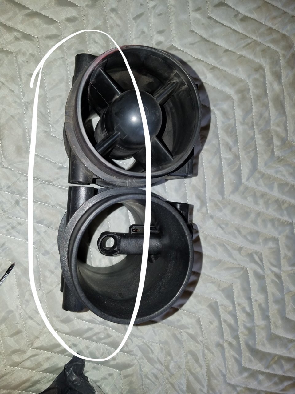

    I finally upgraded the '97 MAF to the '99, using the Volvo air duct.
    Here is a side by side comparison of the two ducts, '99 on top and '97 on bottom:
    Here's the end view, '99 on the left, '97 on the right:
    The Volvo duct fit perfectly into the air ducting.
    Before:
    After:
