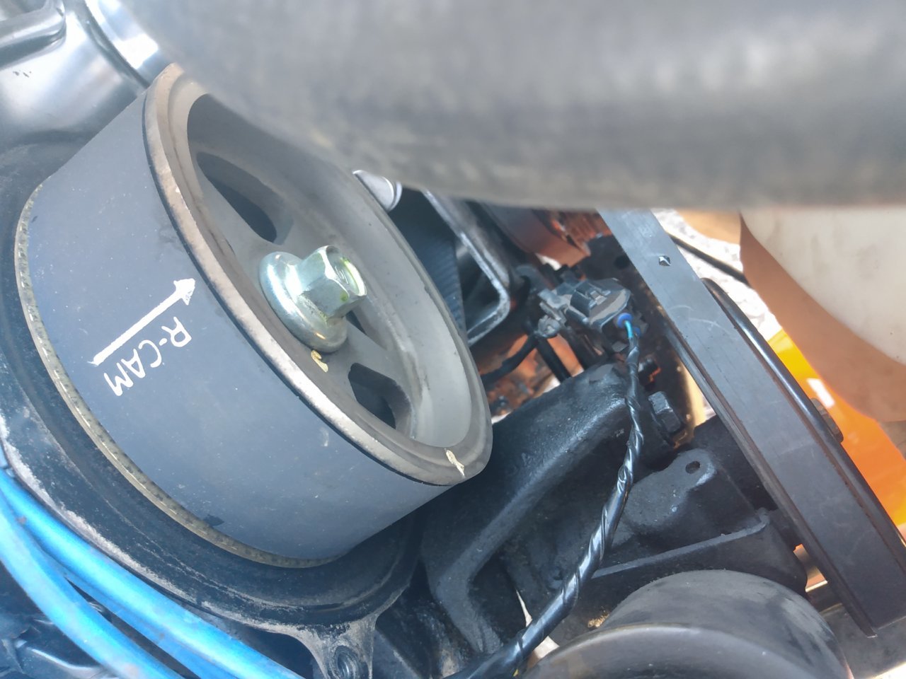

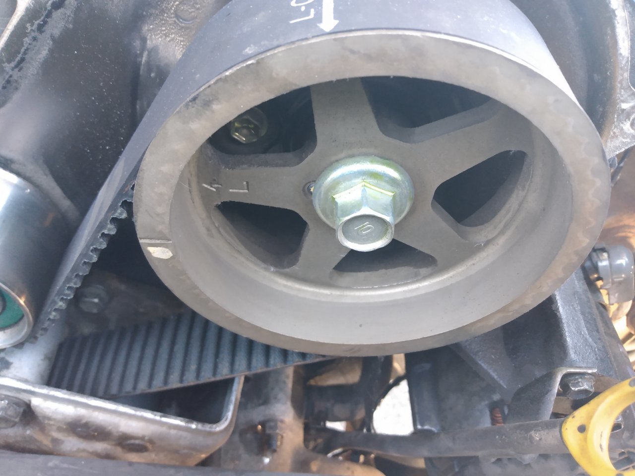

    We gonna need good pictures of all the timing marks.

    It sounds off, pull the cover and bring the crankshaft mark to TDC #1 and take a picture of the cams. Sounds like she is running advanced.

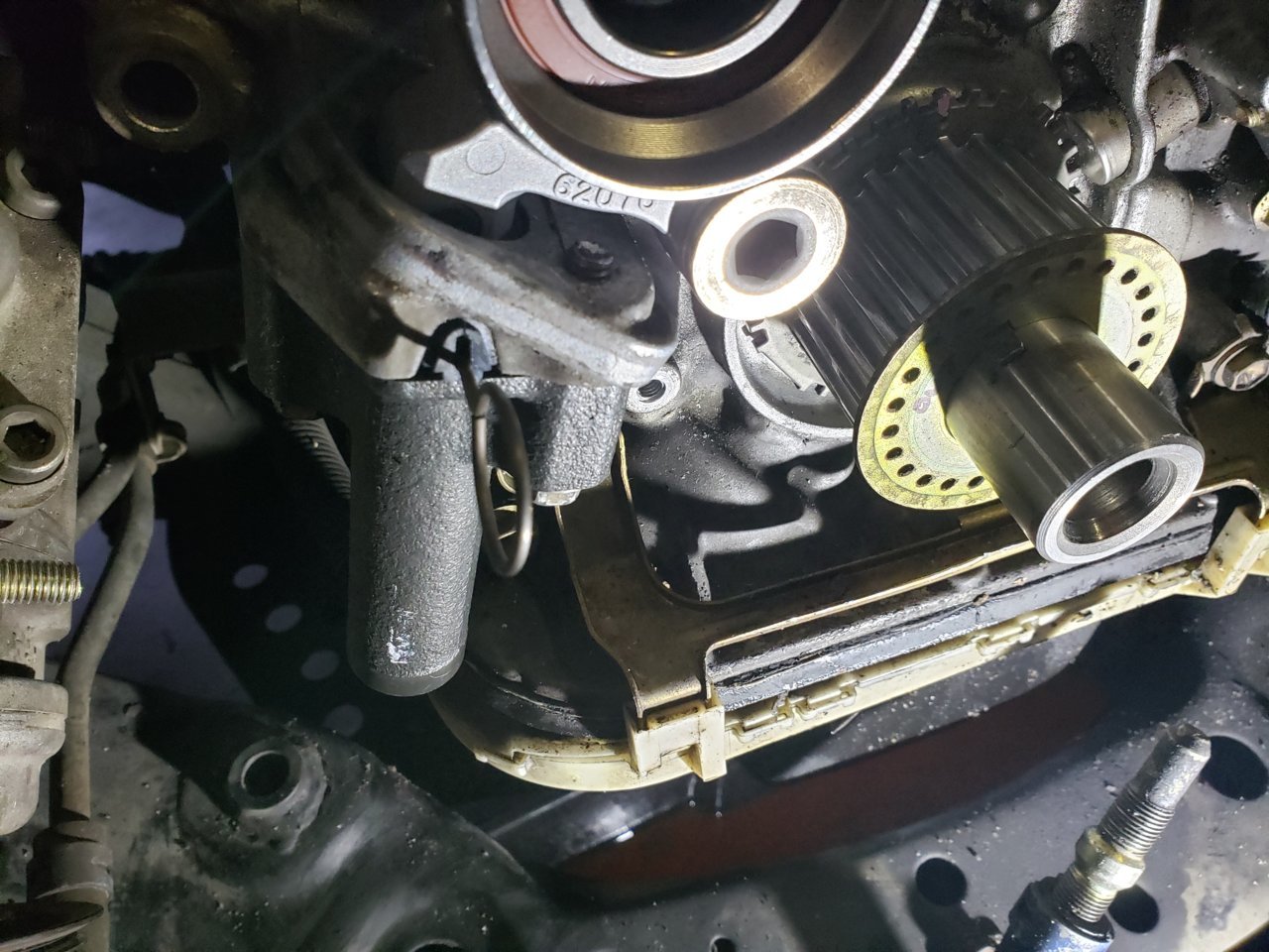

    This is another reason why it's best to change the bearings and the tensioner at the same time. You sort of half a**ed the job by doing only the timing belt. The tensioner could be bad. In your other thread I think you mentioned you just bolted on the old tensioner, without pressing it and pinning it. That wasn't the correct procedure.

    Yeah, definitely should repin the tensioner.
    Or better yet, replace it (Aways replace)

    With the tensioner unpinned, I don't know how it would be possible to get the belt on correctly. It's bad enough without it.

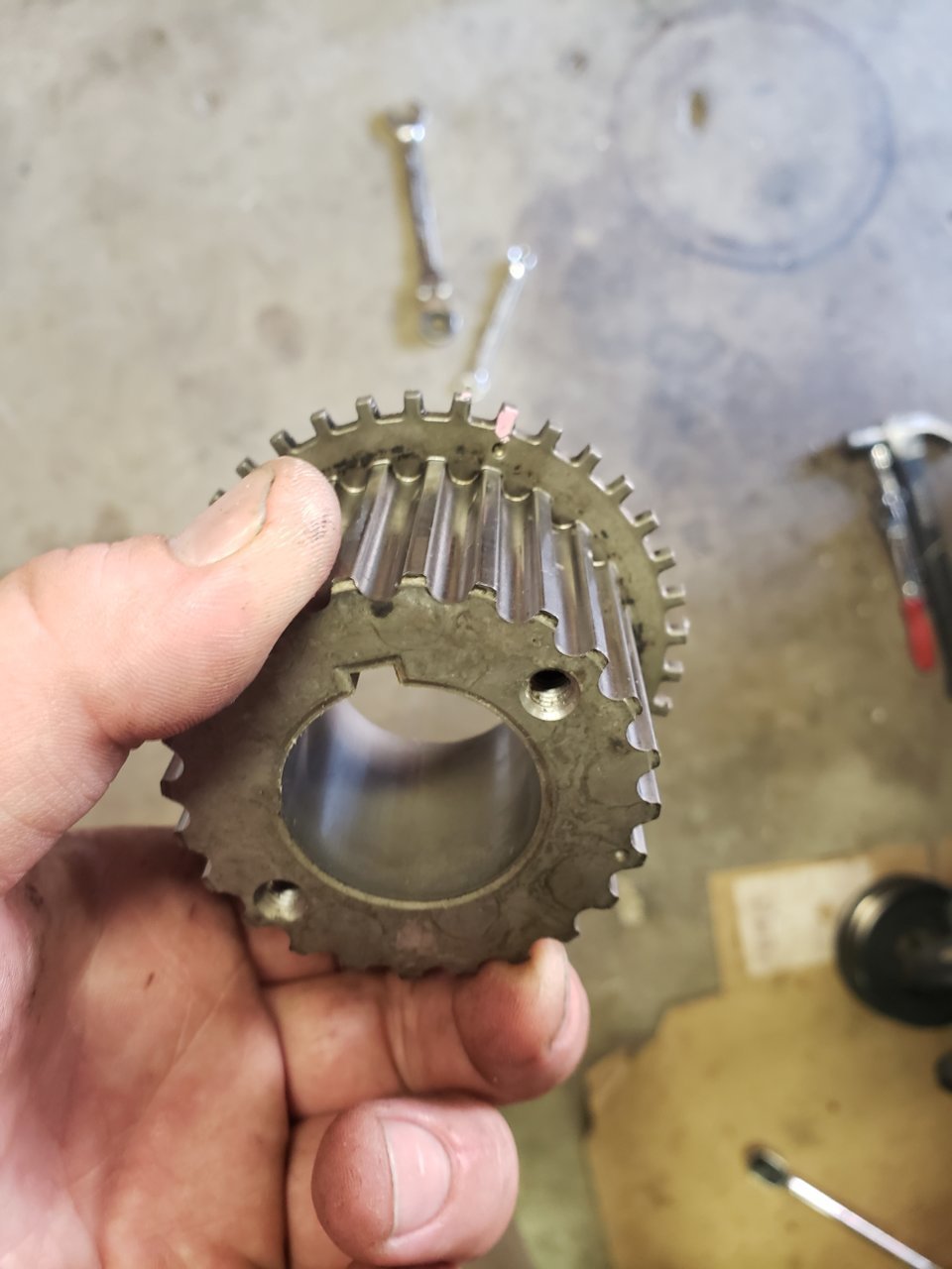

    Another idea, did you get the crank sprocket washer on correctly? The one that the CPK reads? I think it is beveled and only goes one way.
    Edit: The cpk reads off the sprocket. I suppose the washer or sprocket could be backwards.

    I never took any of the sprockets/gears off. I put the washer back the way it came out. It's got a notch as well so I matched it up with that.

    notice the two marks on the crank gear? One is for the crank position. The other is for the timing belt position.

    The pink mark is lined up on the mark on the oil pump. The other dot is lined up to the timing belt crank mark.

    This. Once you turn the motor, the marks no longer line up with the belt. Need to look at cam sprocket to timing mark behind the cam sprocket. Something one should know if attempting a timing belt job.
