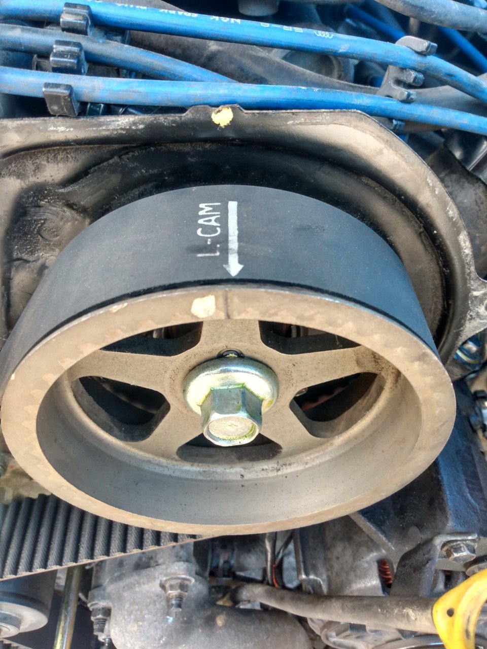

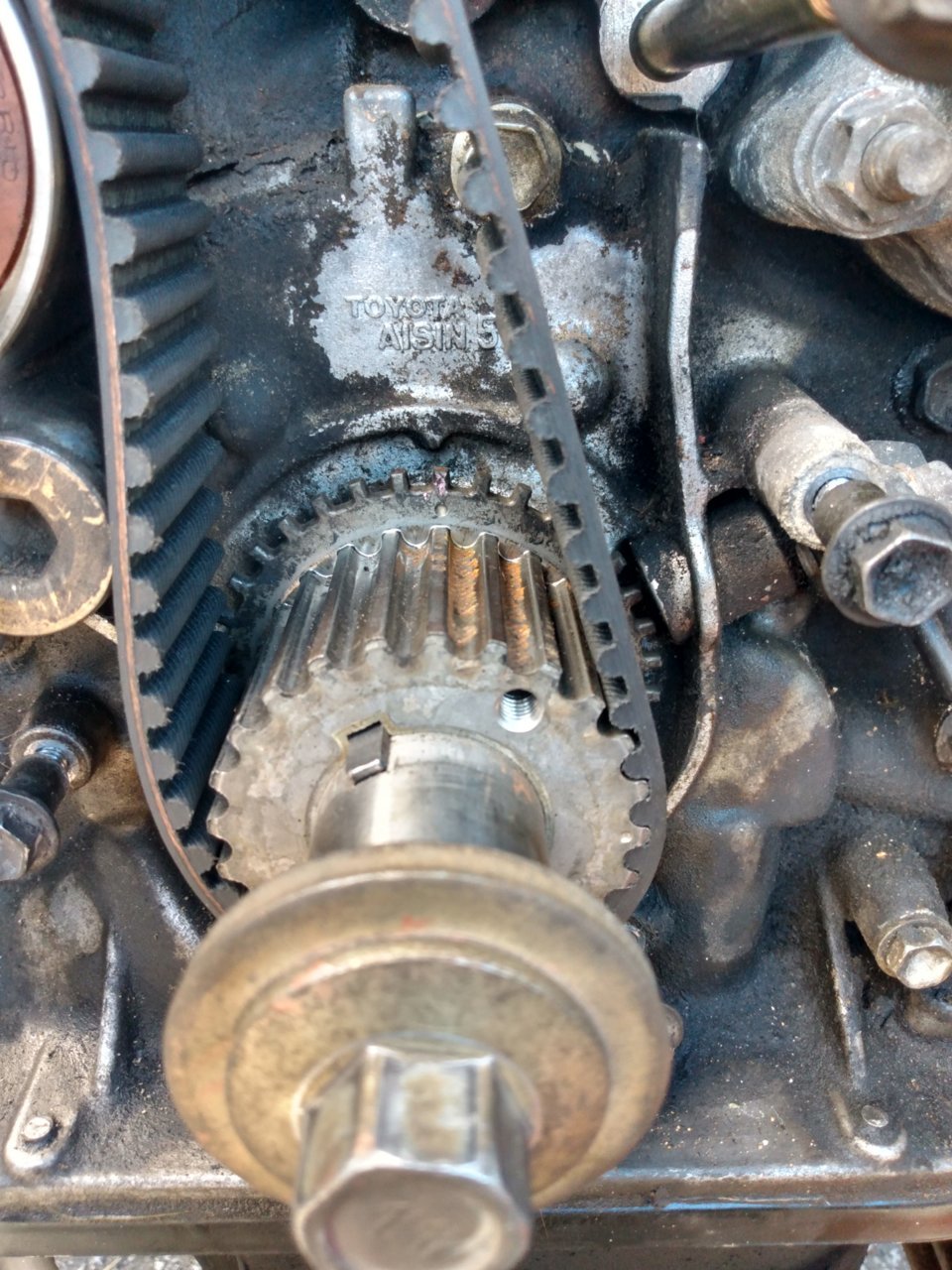

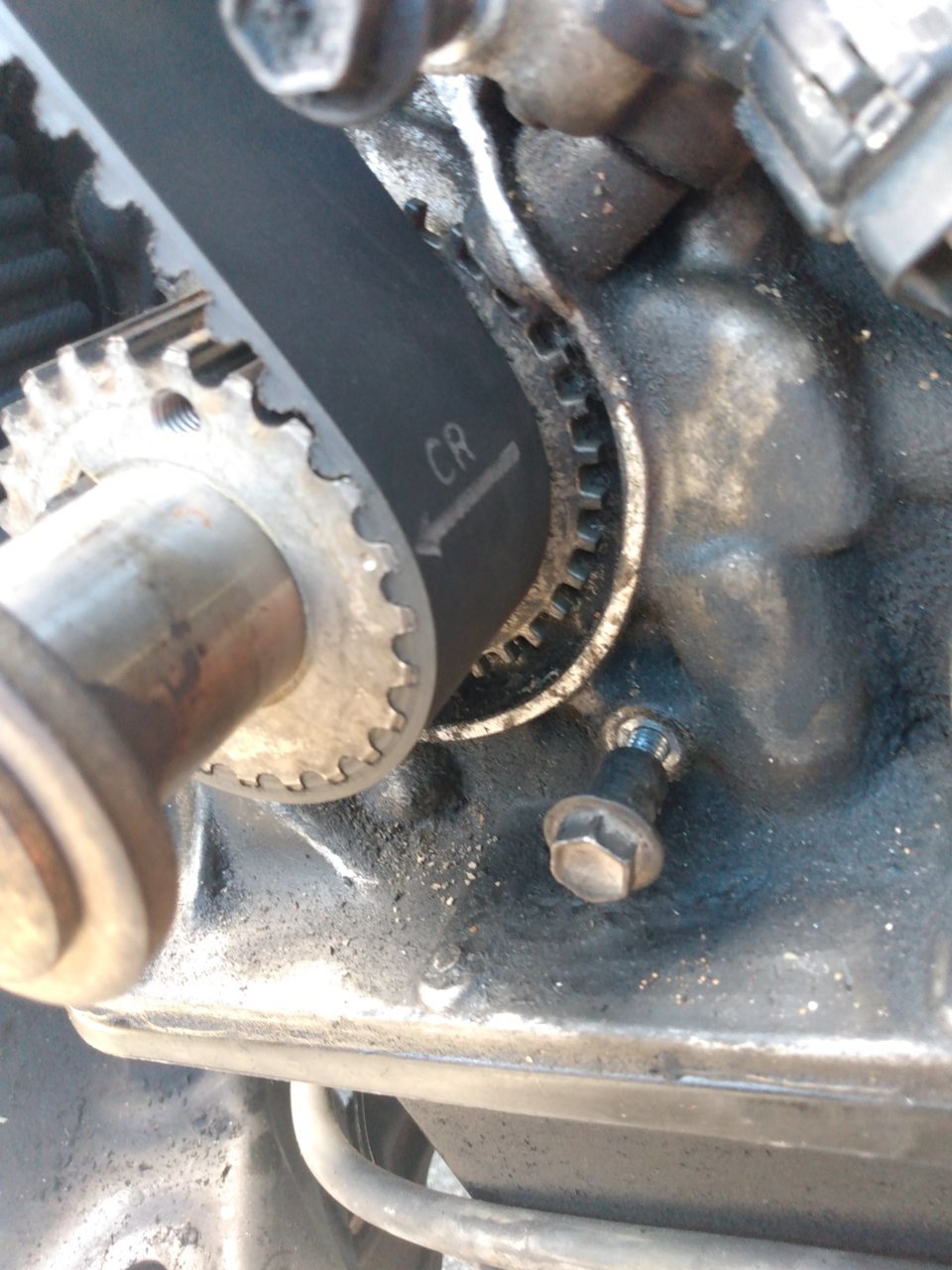

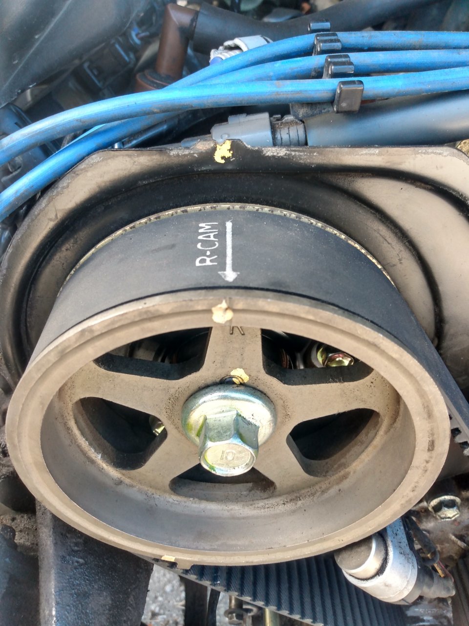

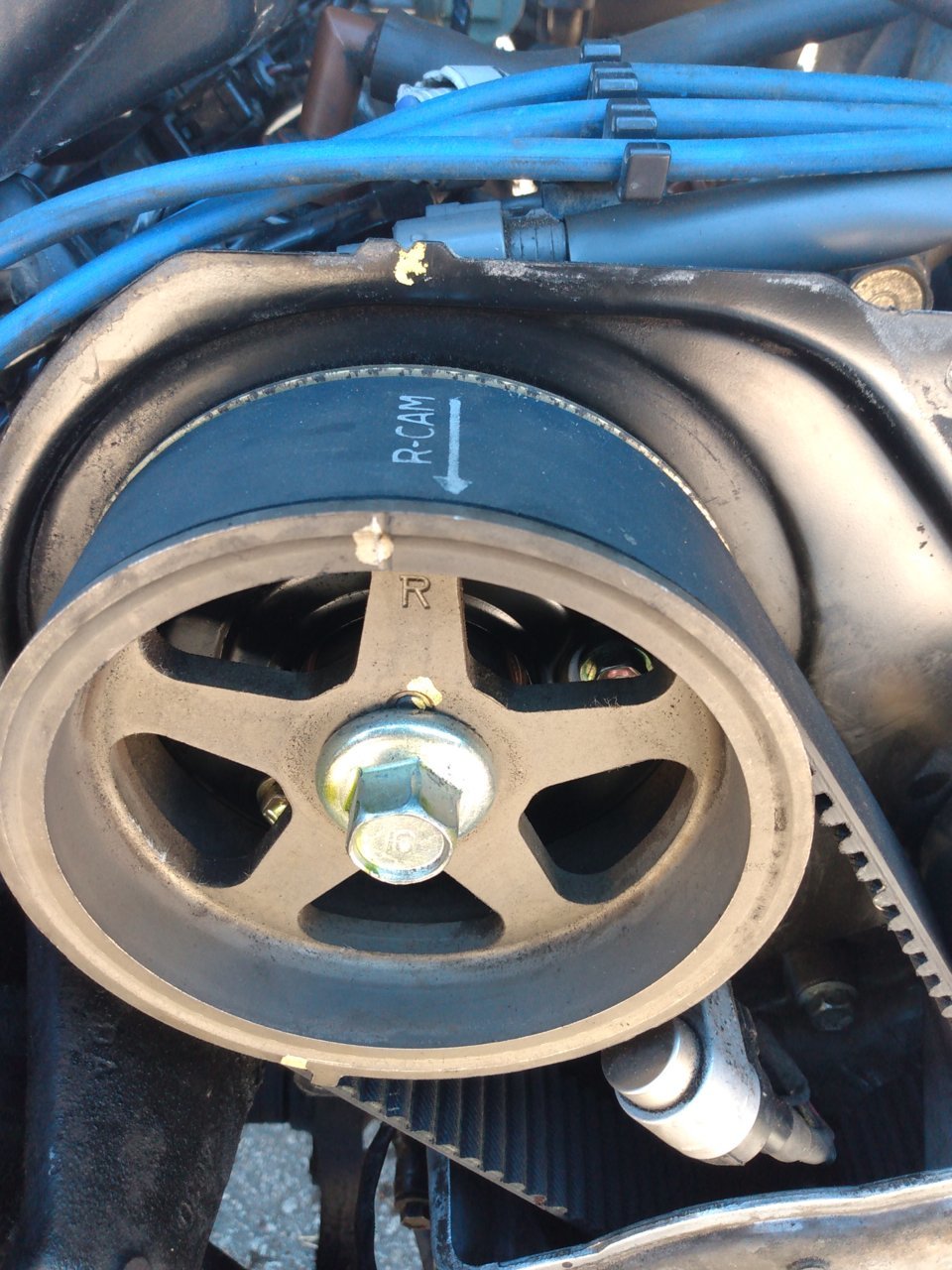

    Your pictures really don't show anything. Take pictures of the timing marks stamped into the sprockets with the timing notches in the background. The lines on the belt are just to make installation easier and get out of whack after the first revolution. They become irrelevant after the motor spins.
    Your belt should be fine just reinstall.
    Recompressing the tensioner is really no big deal. If you have a vice use it, if not use a c-clamp. Go slow , apply pressure... Wait for it to give a little, apply more pressure, etc. Then stick a small Allen key in there to lock it in place and reinstall. You have to make sure all the timing belt slack is only on the tensioner side of the crank pulley. Once you got it right, release the tensioner pin then spin the motor by hand over a revolution or two and make sure your timing marks (not the belt marks) are still on before you button everything back up.

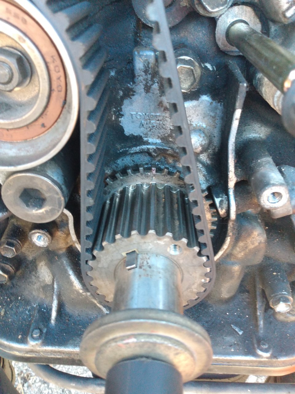

    Check my work. This is the belt installed without the tensioner.
    andywear, wilcam47 and Superdave1.0 like this.
  12. Aug 29, 2022 at 2:01 PM
    #52
    zero4
    zero4 Metal Cutter
    Sep 10, 2006
    #31
    5,989
    Will
    SFV, CA
    01' DCab 3.4L TRD
    Donahoe CO, Donahoe Rear Resi, Deaver J59, 16" Pro Comp, 33" BFG AT, Hayden Trans Oil Cooler, Oil Filter Relocator, FM 40, ES Bushings, Beefed CB Drop, Deckplate, K&N Drop-In, DO Bed Bar, Cobra 75 WXST, Firestik Firefly, Philips D1R, Clarion Remote Start, Husky Liners
    On every vehicle I have replaced the timing belt, after installing the belt & with it tensioned, I'll rotate the engine (manually with a ratchet w/ the crank bolt installed) one full revolution (or two) then I'll check if the marks are lined up. Only after that is when I call it good.

    I did one rotation and the belt jumped one tooth...

    Again, ignore the marks on the timing belt, they're only there for helping you first put it on. You don't even need those marks, heck I don't think I've ever installed a timing belt that had them.
    After rotating you align the crank mark then look at the cam gear marks to see if they line up with the marks on the cover behind the cam gears. While rotating if you go past the crank mark, don't try reversing direction, you have go all the way around again.

    Ignore the marks on the belt after rotating, they are for installation only. What matters is that all the timing marks on the sprockets line up with the respective marks on the engine.

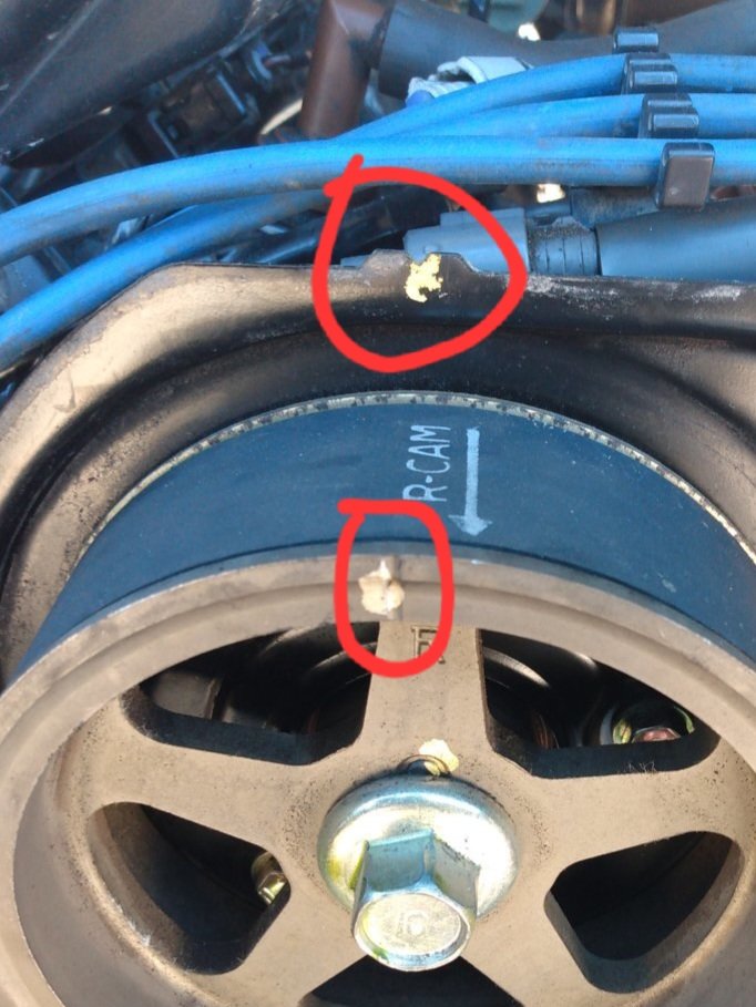

    Don't look at the belt after turning the motor. Only need to line up the 2 notches circled below.
    Wish I could help you out in person. Might consider paying someone to come over and help you.

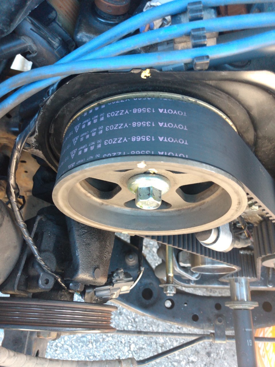

    Update:
    I compressed the tensioner pin using a clamp installed it properly.
    I rotated the crank twice to confirm that the marks line up.
    Then, I tried to fire it up and experienced the same noise and lurching that I videoed in the 1st post.
    Afterwards, I rotated the crank again to make sure the marks line up and THEY DO (the belt has moved tho, which doesny matter). Here's proof:
    So,what else could be wrong?
