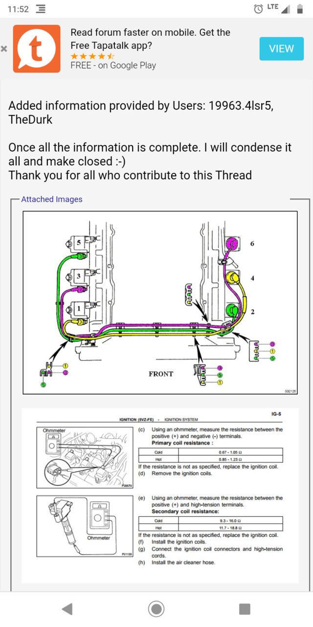

    I did take them off. When putting them on, I put them in all over again using this image:

    Dm93
    Dm93 Test Don't Guess
    Mar 3, 2015
    #150066
    13,820
    Texas
    2014 DC OR 6spd 4x4
    Predator tube steps, Ranch Hand grill guard, Magnaflow CatBack exhaust, Toyota tool box & bed mat, 2LO Module by @Up2NoGood, Rearview Compass/Temp Mirror, Tune by @JustDSM.
    That should be right I'd double check your wires though.

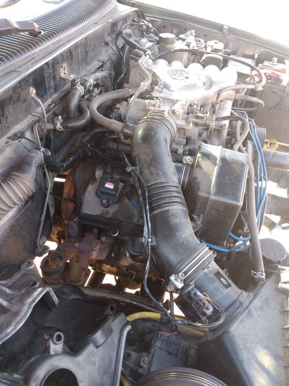

    What's up with this wiring below? That's not a factory tape job on that wiring. Anything else disconnected? like the MAF?

    Will do! One of the wires does seem overstretched.

    The sheathing was ripped so I electaped it.Everything else seems to be connected but I'll disconnect and reconnect to ensure connection

    Take a few more far away shots of the engine bay as it sits now. From a couple different angles. We might spot something else.

  13. Aug 29, 2022 at 6:28 PM

    As an aside, when I was taking things apart, I saw that the spark plug wires have blue-with-white-letter labels on them (1,3,5). The order of these wires was not correct. It was reversed. Instead of 1,3,5 (front to back), they were plugged in as 5,3,1 (i.e. wire for cylinder 1 was in cylinder 5). But, the engine was running without issue before, until I decided to fix it according to the diagram I posted above.

    That's very interesting, I mean if it was running properly before put it back the way it was.
    The way it was kicking back while cranking it definitely sounded like the wires were incorrect.
