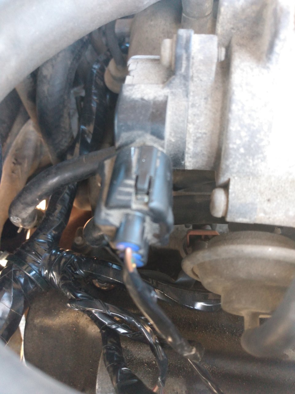

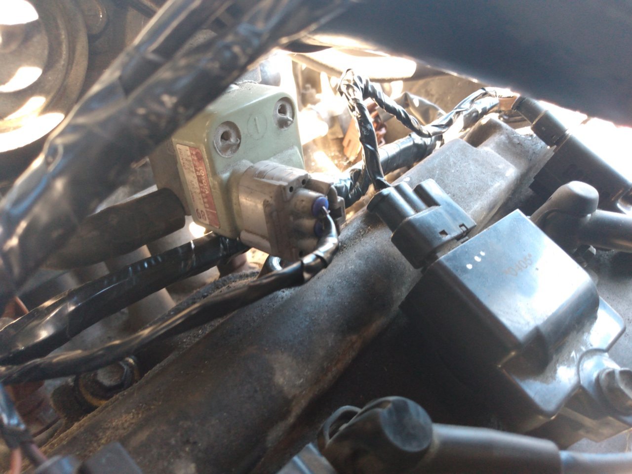

    These two connectors were very similar. I put the black with the black and the grey with the grey when putting things back. Did I mix these up?

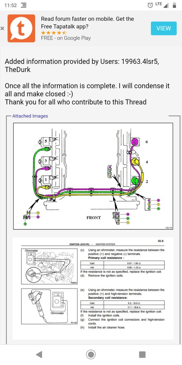

    I did the second test on this image on all the coils.
    Two read ~13 kohm
    One reads ~.5 Mohm.
    I'm just wondering how if they are so shot, the truck was working before. But doesn't work now. I guess fiddling around with the wires was enough to make them loose whatever contact they had before? I did have rough idling issues before (not too pronounced).

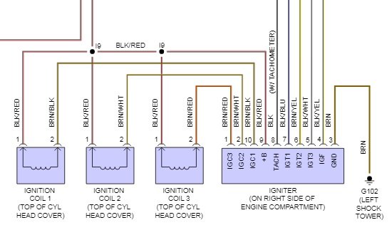

    2000. Would this be in the service manual?
  18. Aug 30, 2022 at 12:52 PM
    #98
    Dm93
    Dm93 Test Don't Guess
    Mar 3, 2015
    #150066
    13,820
    Texas
    2014 DC OR 6spd 4x4
    Predator tube steps, Ranch Hand grill guard, Magnaflow CatBack exhaust, Toyota tool box & bed mat, 2LO Module by @Up2NoGood, Rearview Compass/Temp Mirror, Tune by @JustDSM.
    Should be.
    Chungas and 5efvz[QUOTED][OP] like this.
  19. Aug 30, 2022 at 1:06 PM
    #99
    5efvz
    5efvz [OP] Well-Known Member
    Jul 22, 2022
    #401886
    326
    Coil 1 and Coil 2 wiring was reversed. xD
    ty very much. will put things back together and try firing it up again after a quick coffee. this has been a wild ride. hope everything works after.
