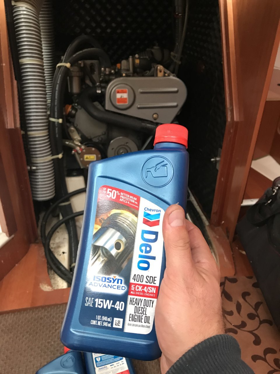

    It’s funny I clicked on an oil thread while waiting for the oil to be drained from this...(psst, don’t use this oil in your Toyota, unless it’s a Toyota forklift)52BDCB8C-4AD8-40DD-B2AF-41D405488637.jpg

    That’s one of the best oils made. Probably not the best for gas mileage in the 3.5L, though.
