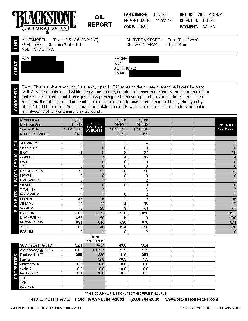

    I'm going to start posting this in every oil thread.
    This was using Wally World's SuperTech full synthetic for $15 for a 5qt jug. You can pay more for something else, but why? You can question the manufactures recommendation, but why?
    FYI total miles on the truck at the report was 42k.
