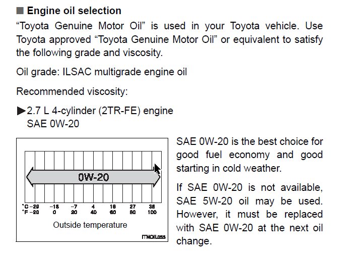

    If so then they are doing it wrong as the manual clearly states 0W20 motor oil. The below is from the owners manual for the 2012 Tacoma.

    If they use anything other than SAE 0W20 motor oil it is indeed wrong IAW the Owners manual that clearly states:
    " If SAE 0W20 is not available, SAE 5W20 may be used. However it must be replaced with SAE 0W20 at the next oil change."
