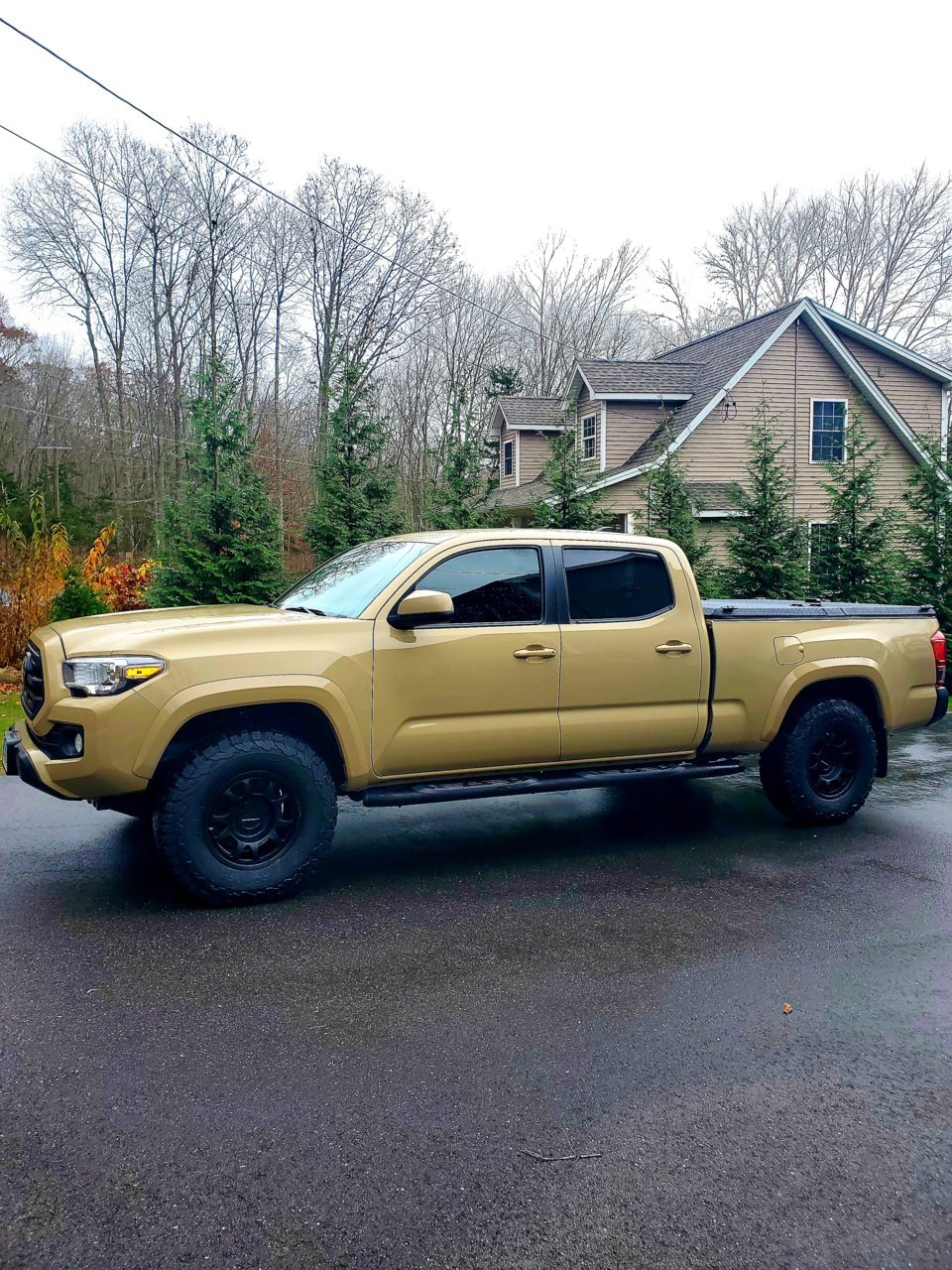

    I have bf ko2 265/75/r16 with methods 0 offset. Stock suspension. Slight rubbing at full flex on sharp incline/decline on fenders.

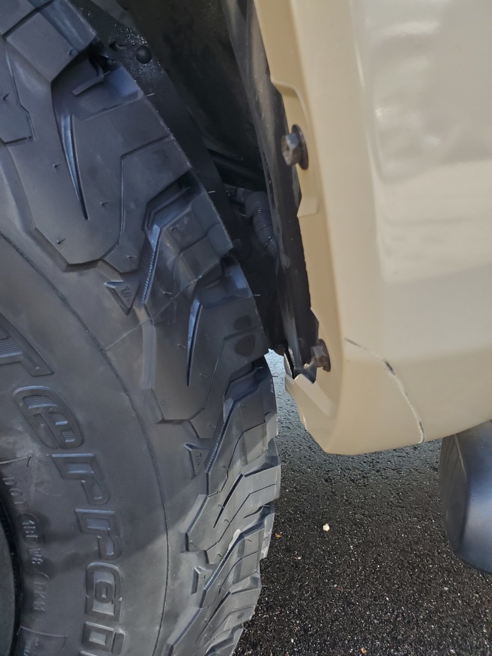

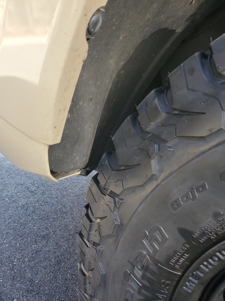

    I have method 316s which are 0mm and 17x8.5
    With 265/70/17 wildpeaks I had to remove the mud flaps & heat mold the fender liners a bit
    Still rub on the fender lines and even cab mount slightly with wheels turned going over a bump or dip
    It's not terrible and hasn't had any negative effects so far
    With that offset and wheel width if you want no rubbing at all you'll probably have to stay with stock size
    265/70/16 or 265/65/17

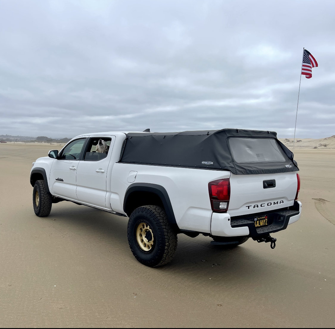

    method 315 0 offset 265/75/16 2” front 1.5 - 2” aal 265 still look good
