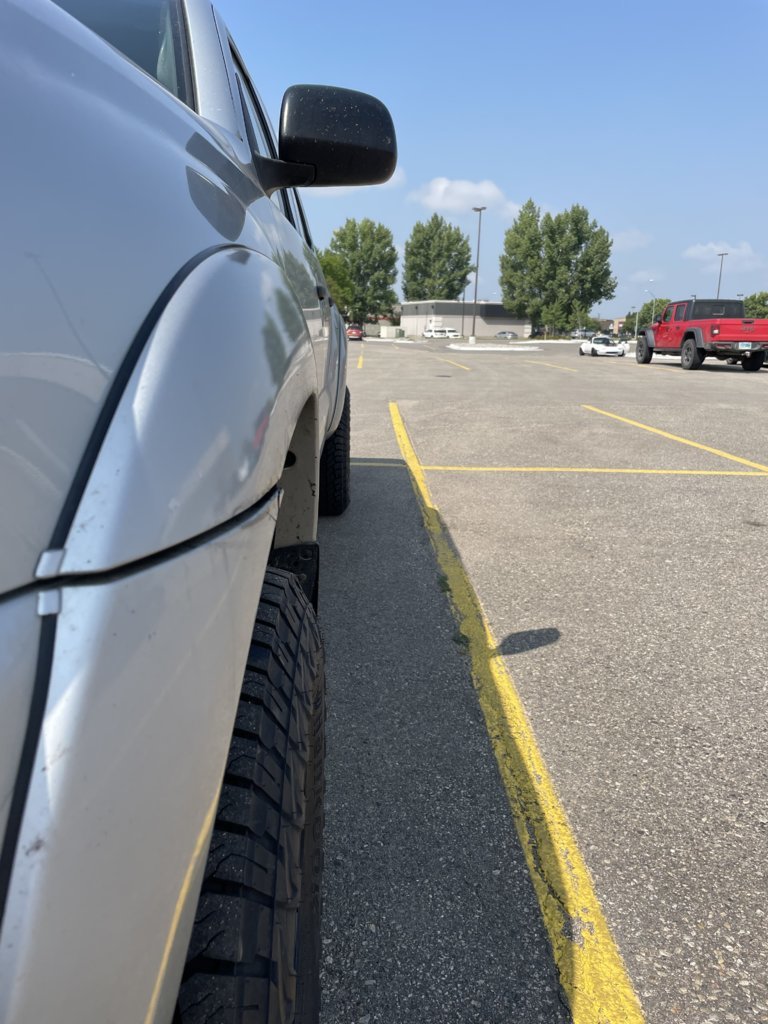

  9. Aug 23, 2024 at 12:32 PM
    tacotony MN
    tacotony MN New Member
    Jun 10, 2024
    #451277
    Tony
    Middle of Nowhere, MN
    2007 Double Cab SR5 4x4
    3rd Gen Bilstein Suspension DX4 Beasts wrapped in Hankook Dynapro AT2 Xtremes
    Not sure if you’ve already made your choice OP, but I just had 16x8 0 offset DX4 Beasts installed on my pickup (thanks Discount Tire). Fitment is phenomenal and I love them. 0 offset gave a good amount of poke but nothing too crazy, no rubbing. I run 265/70r1674560706750__6D045E79-E0DB-469F-92B7-056959F7DC41.jpg74560705804__9FD99A26-0F1C-41BA-BF08-53F6F02FF091.jpg 74560705804__9FD99A26-0F1C-41BA-BF08-53F6F02FF091.jpg
    Unit59[OP] likes this.
