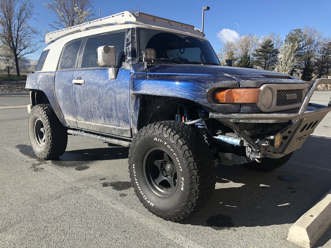

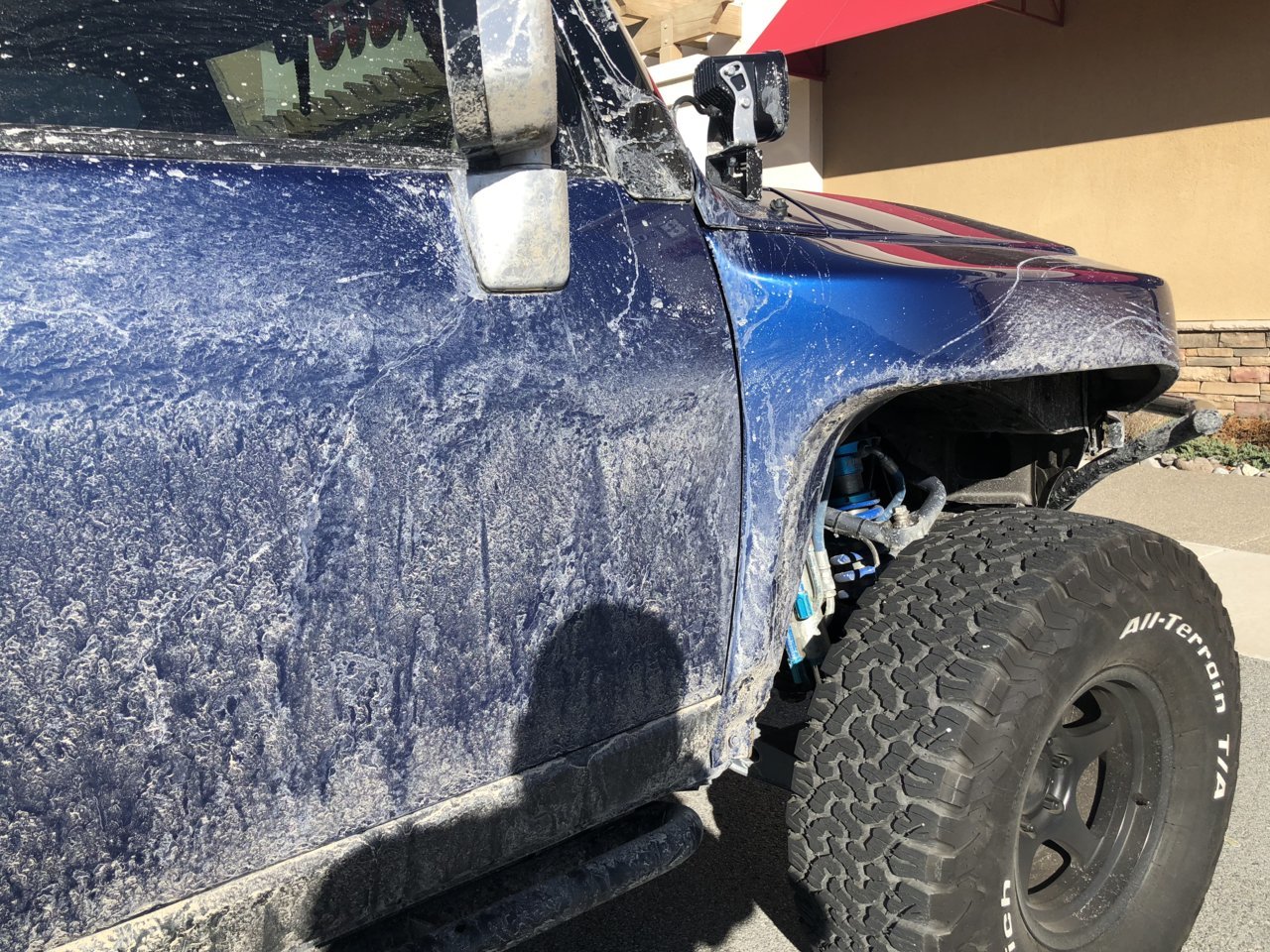

    F564761E-8F51-4D70-8EBB-04B48DD27089.jpg 9F925997-7989-48B2-8F77-9EA6D7FE3FA4.jpg Been rolling on -25 for past 2 years and bearing finally gave out. Rocks flings all over and causes dings and dents.

    So you're saying stay away from extreme negative offsets?

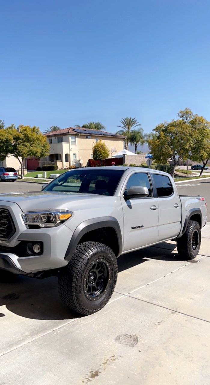

    Wow old thread resurrected. I went with a -10 SCS wheel. Looks great IMO

    Did you go with 17x8.5 wheel size? No CMC?

    Correct 17x8.5 no CMC. It did rub on stock suspension not too bad but it did. No rubbing at all now:
