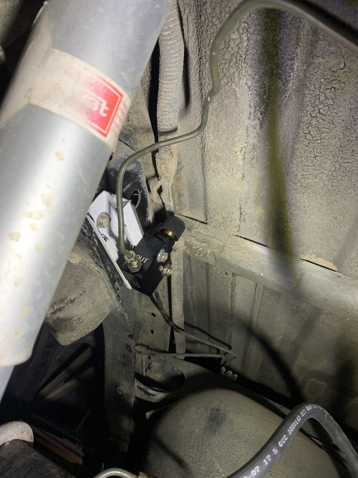

  13. Mar 14, 2024 at 12:50 PM
    ControlCar
    ControlCar My Moto: Help & Learn…period.
    Jul 22, 2023
    #429578
    3,397
    Steven
    Sugar Land TX
    1996 Taco 2.4L 2wd Automatic
    Clock Volt meter/LSPV Delete/Hyundai 16’s/FP gauge/after 9months of wrenching ZERO oil leaks
    Automan
    How I knew LSPV failed, 2 things
    -when I got taco from prior owner, had invoice for new front/rear brakes. While doing front bearings, I saw that the front pads were half life and top edge of pads were peeling off like a curly Q. Never seen before. I inspected rear drums….zero wear. I chalked up to wrong size pads installed and replaced front pads
    -after replacing the 3 27yr old rubber lines, I could not got the life of me bleed the rear corners…..kept getting bubbles.
    After going through $18 of b fluid, I gravity bled rear as best as I could
    returned here and ‘found out’ about this known-to-fail LSPV
