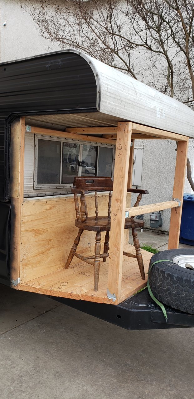

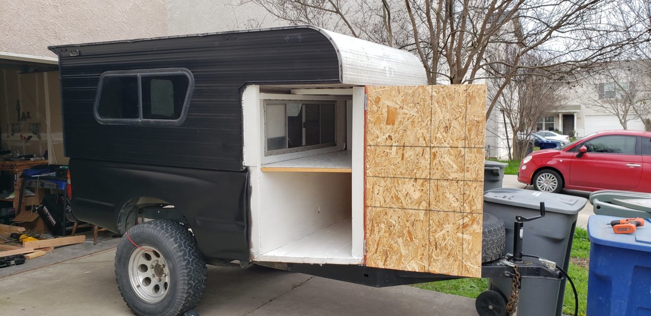

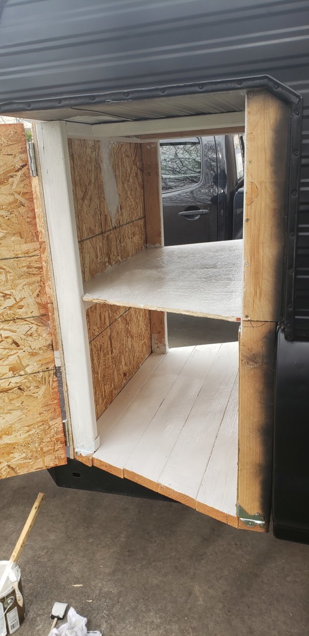

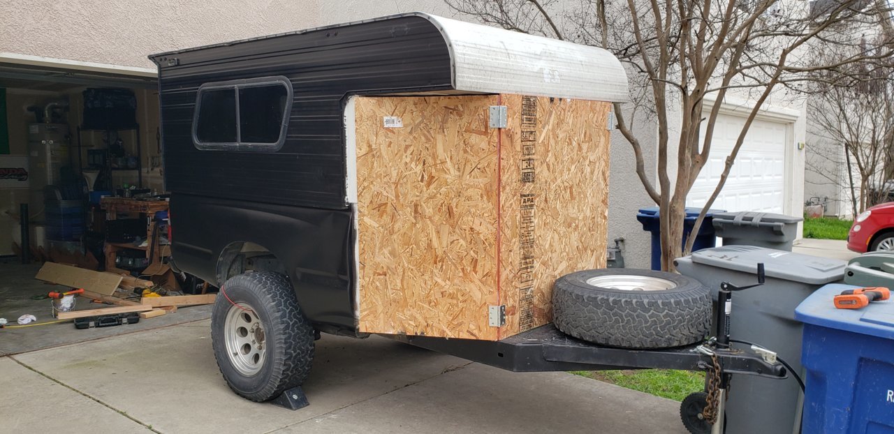

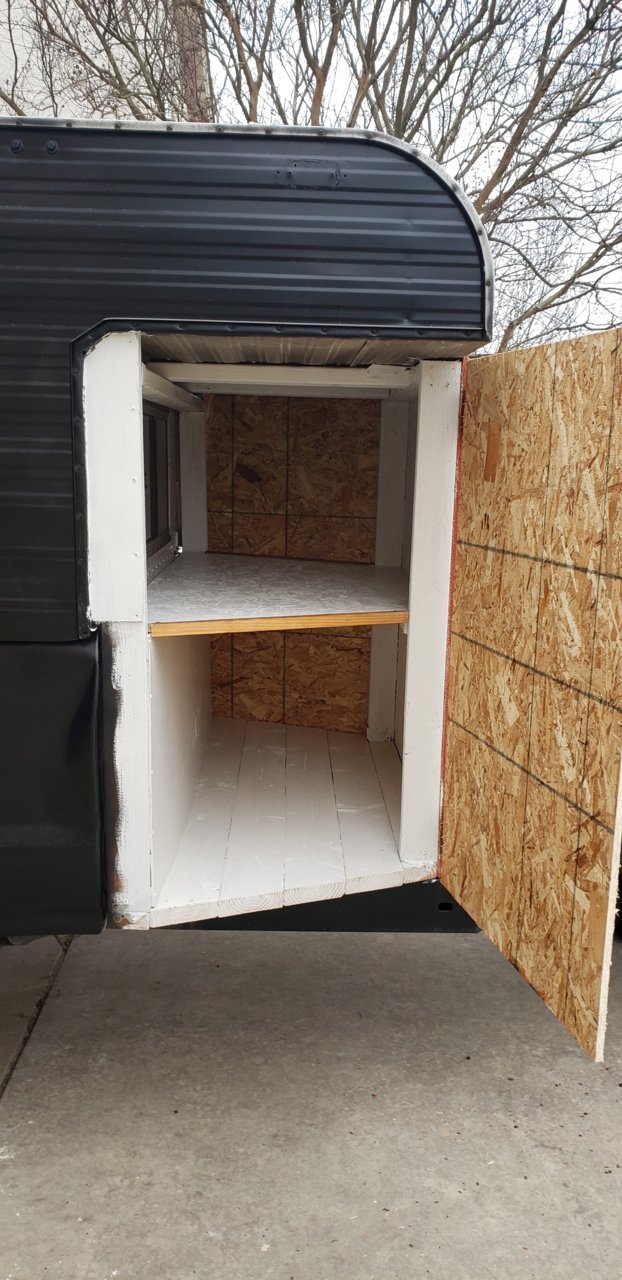

    Worked on the front storage area of the camp trailer build last night. Got the front wall, shelf and door panels cut and mounted up. Still need to seal up joints and small gaps, paint, install door handles/locks, foam weather seals for doors and run wiring for the interior storage lighting.

    Started putting the seal coat down. Interior will be white to help with making it brighter. Exterior will be black to match rest of trailer and truck

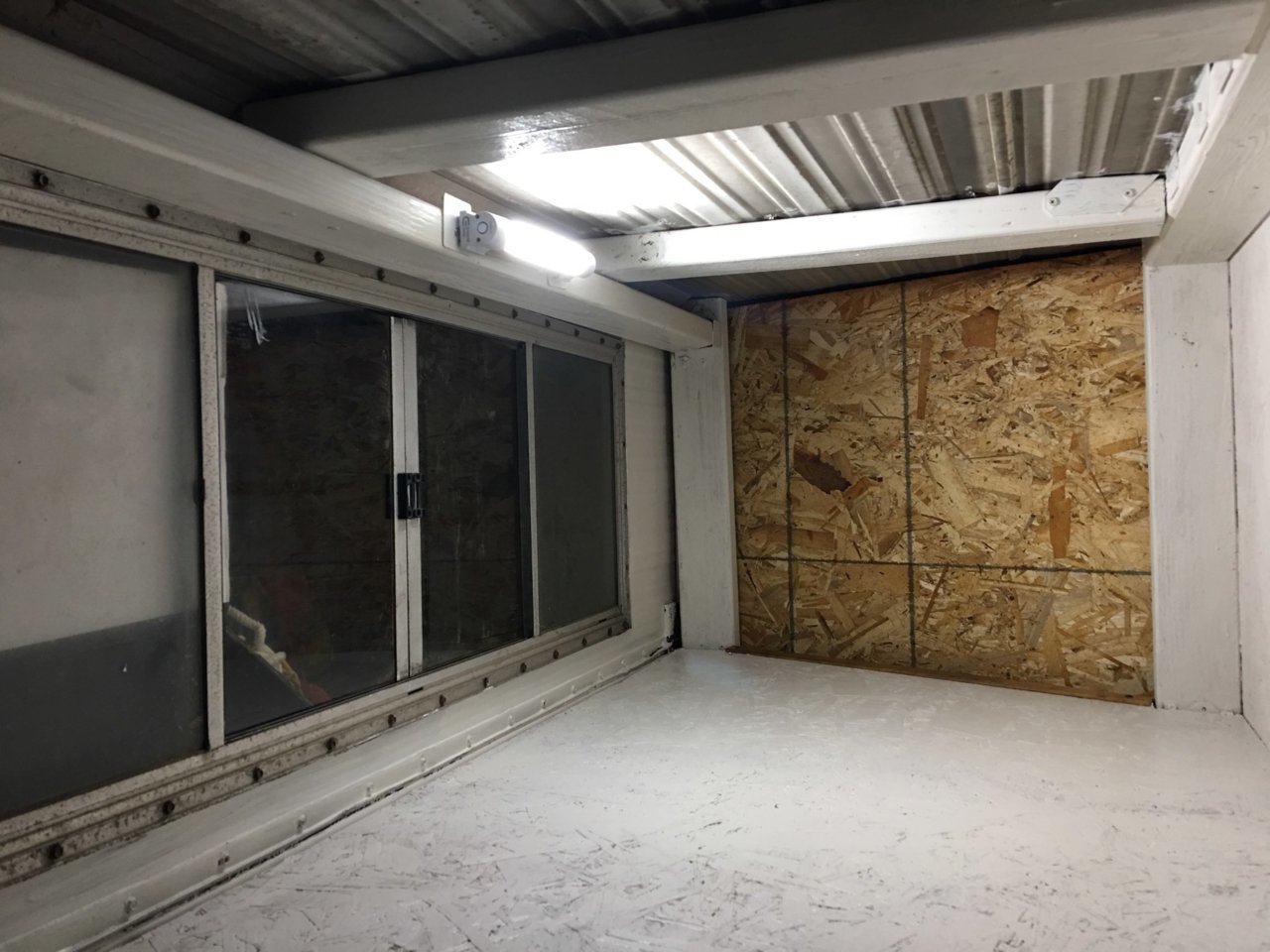

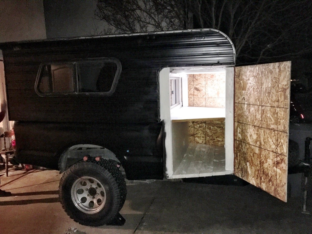

    And we have light! For the top storage area. Still gotta do the lower. Using some magnetic USB rechargeable LED lights I got from home depot a while back
