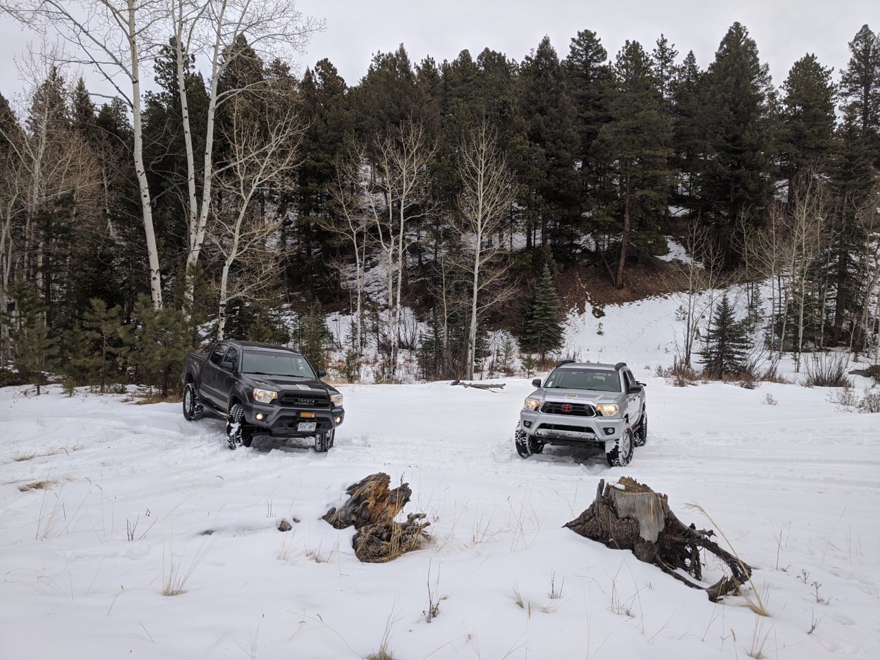

    Had some time to enjoy a snow run last weekend. (1/12) We ran Rampart Range Road and took 322 down. It was a great time cutting fresh tracks in the powder. There was between 5" to a Foot. maybe a little deeper in some spots. I had a minor slid off once and it took a bit to dig out enough to get back up. Also grabbed a quick shot of my buddy showing some flex. :)

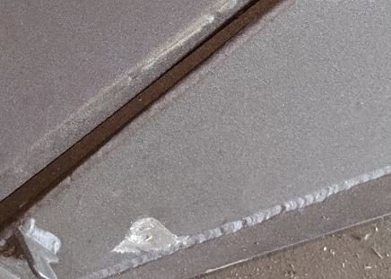

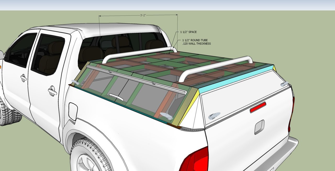

    Well its Cap (nearly finished) vs Cap (original design).
    * note I did ask to remove the round tubes in favor of Thule tracks. Other than that...
    1. the top sheet on the door is no longer aluminum (design change I was told about, but he never answered how the cost difference would be made up)
    2. the rear hatch is stainless steel ( a little wavy, from the PC process) The stainless was added for no extra charge, not sure I like the waviness though.
    3. The pad locks were a surprise add. (off-road they will beat the crap out of the cap, so not really useful)
    4. The door angle is longer than expected (I should have caught that in earlier photos, but I didn't)
    5. He did throw in the powder coat since its been a little over a year getting it done. (nice but, the price was about the same as aluminum cost) Maybe shipping will be free to make up for no aluminum top???​
    Its not completely finished yet, so I am holding out hope that I will like it more once its all finished. I am hoping the lockable T-latches are workable so I don't have to use the padlocks. (off-road they will beat the crap out of the cap). I suspect there is a different sort of latch in mind considering the odd clip looking parts on the sides by the 4 holes.
    I am not quite sure what to think at this point. I really don't want to lose out on my cash up front.... but shipping is likely to cost me another $150 to $200... unless that is how the difference is between the aluminum price and shipping will be made up.
    If the latches are not lockable and they are on the outside, I think if he offered me a full refund I would take it. I waited a year to get to this point and I am not sure the surprise design changes are all that exciting. :(
    (I keep going back and forth on it because it was not cheap, its been a long wait, and I am not sure I like the surprises... I am trying to not be ungrateful but again it was not cheap, and I am not sure many updates came without me prompting.)
    What are your thoughts?

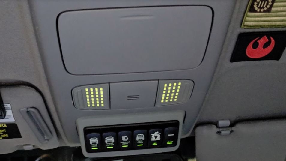

    Made a few minor changes to update...

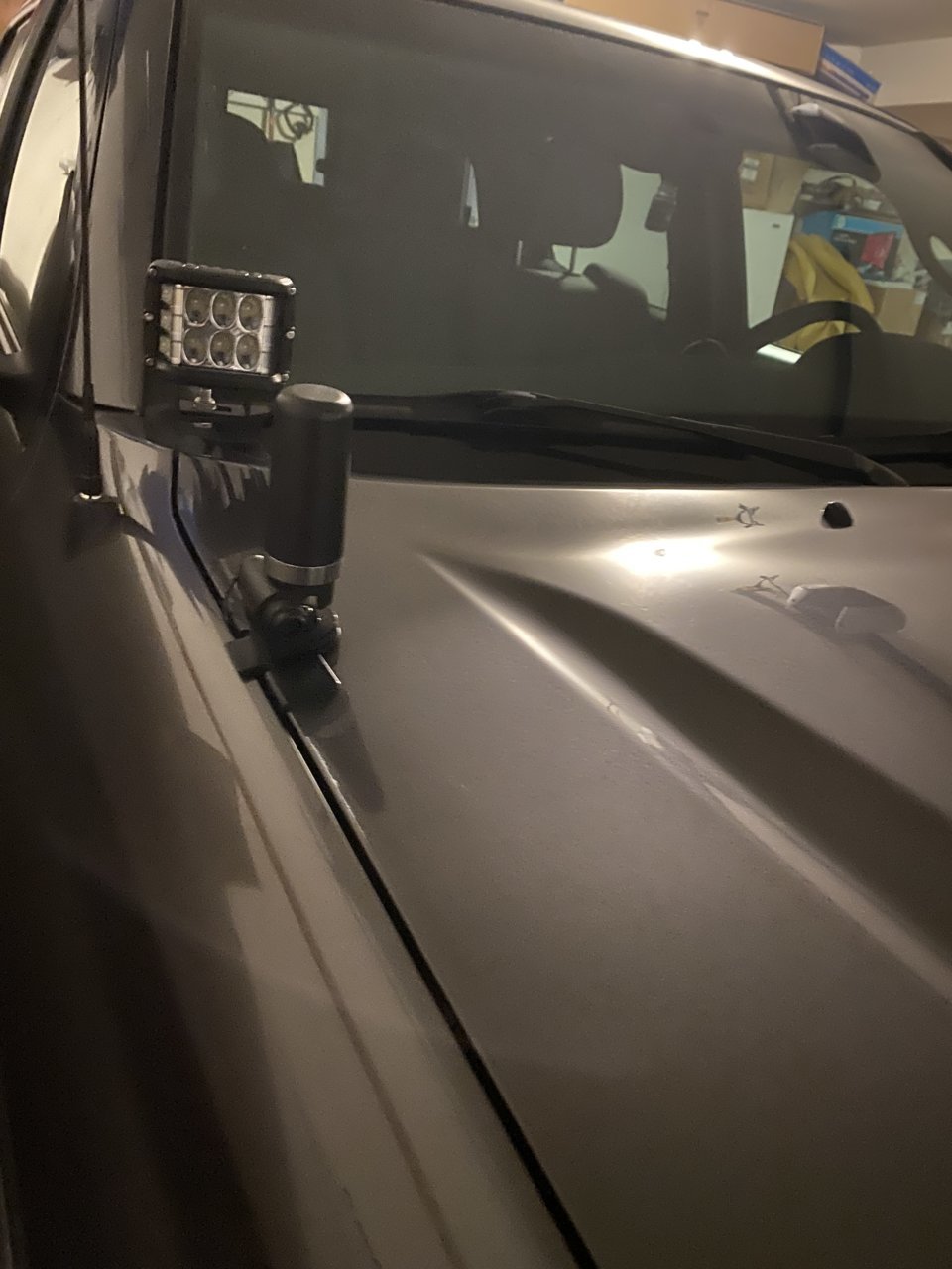

    Updated Spod Mount to a custom one created by Meso Customs.
    Also Notice I installed the Meso Map lights and Dome lights (not pictured)

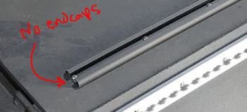

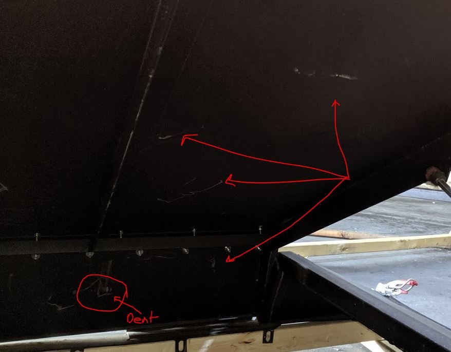

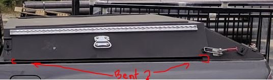

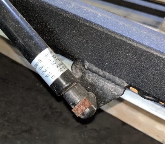

    I have been madly working on changes to the "Custom rear cap" from KORE that I ordered as a custom job during a group buy on 3/2/18. In that time I saw a few other GB and larger projects he posted on Facebook. The product arrived a few weeks ago (arrived 8/28/19). I would definitely not recommend KORE it arrived with way too many unapproved & uncommunicated design changes, was beat up, and rusted. I felt like I received an expensive used product!
    I am not sure what his situation was completely but with only minimal communication it was really difficult not to be extremely frustrated. His wife did finally jump in on the business email and helped to get the cap shipped, so at least I received something. I did appreciate her responsiveness once she was involved. (If it was not for her, I am pretty sure I would have paid full price up-front and received nothing.)
    So why did it feel like I received an expensive used product???
    It arrived with
    • rusted hinges and latches
    • rusted clips and shocks shaft
    • there were missing bolts in one of the latches
    • the cap had quite a bit of damage: (The damage occurred because it was shipped in a make-shift crate (with no top or bottom) that busted the only two cross supports (one diagonally across the top and one diagonally across the bottom) See photos below for most of the damage.
    The final product was also supposed to ship with multiple components that failed to arrive with the cap: (here are a few examples)
    • keys for the padlocks (I ended up having to cut off the locks)
    • weatherstripping
    • end caps for the tracks, etc.
    Last couple of items;
    • The cap is also grossly overweight (supposed to be 150 to 200 lbs and it ended up at about 375 lbs.) I am pretty sure it is overweight due to swapping the aluminum cap out for steel. He did tell me about it, after the fact and did not refund me the $$ difference. It was also quite a bit more expensive for shipping as a result.
    • The major design change on the rear door lost me nearly a foot of top cap because of the angle changes. On a 5 foot bed, that is a lot of realestate. Losing the locking Ts in place of padlocks and hasps was also bad. (who wants padlocks banging and floppy handles banging around when you are off-road?) Not me!
    Unfortunately, He still has not responded to my inquiries for component types he used (like the roof tracks and d-ring tracks) so ordering the missing parts is a bit of a pain. (I am not even asking for him to send me parts!, I just want to know so I can order correct parts to finish the job)
    I communicated the damage as well (I figured maybe I'd get a little back in shipping costs... ...<if you are wondering, there is a little sarcasm there>)
    At this point, since the cap has to be re-powdercoated, I am going to have a friend grind some of the welds to make it look more polished and fix the broken hinge weld. I am going to have appropriate locking and opening mechanisms put on it. Then I will have my neighbor do the re-powdercoat.
    In the end, there was so much wrong it is just really hard for me to get past it. Seeing some of his other work prior, it just seemed to me like he really didn't care about me or the project a few months after he started.
    I have seen some other TW posts since this project was underway and it looks to me like Kore 4x4 (Tony) is just inconsistent and is inexperienced at running a business. My guess it he had a hobby that he wanted to make money on and its just not working out well (or at least its not working out well for some of his customers)
    Lessons learned:
    1. Find someone local or choose a vetted vendor (to at least make your chances better in receiving a good product)
    2. Be very clear up front on timelines, specs, and process requirements for any changes once its agreed. Additionally, be clear on the process if timelines are not met. (this goes both ways as I am sure if I had not paid, he would not have done the job)
    3. Treat it like a business transaction, if it does not work out, follow-through on #1 and part ways. (that is what it is)
    4. If you can pay a partial then ONLY pay a partial! NEVER pay 100% up front. If you have to pay 100% then the shop is probably over leveraged and shouldn't be taking on the work anyway.
    Here are some photos of it after it arrived (there are more, but you get the idea):

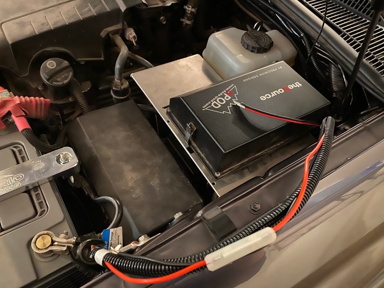

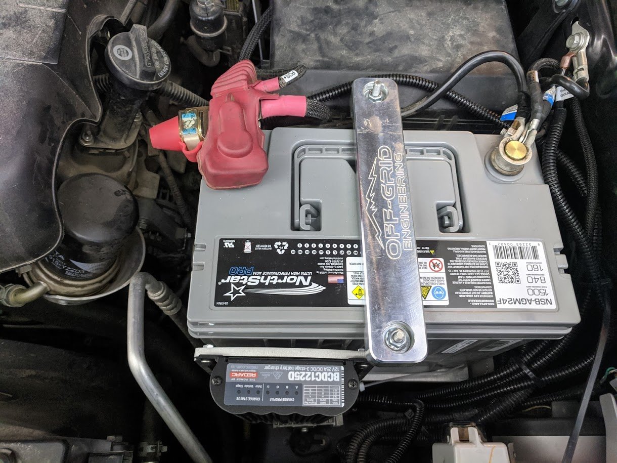

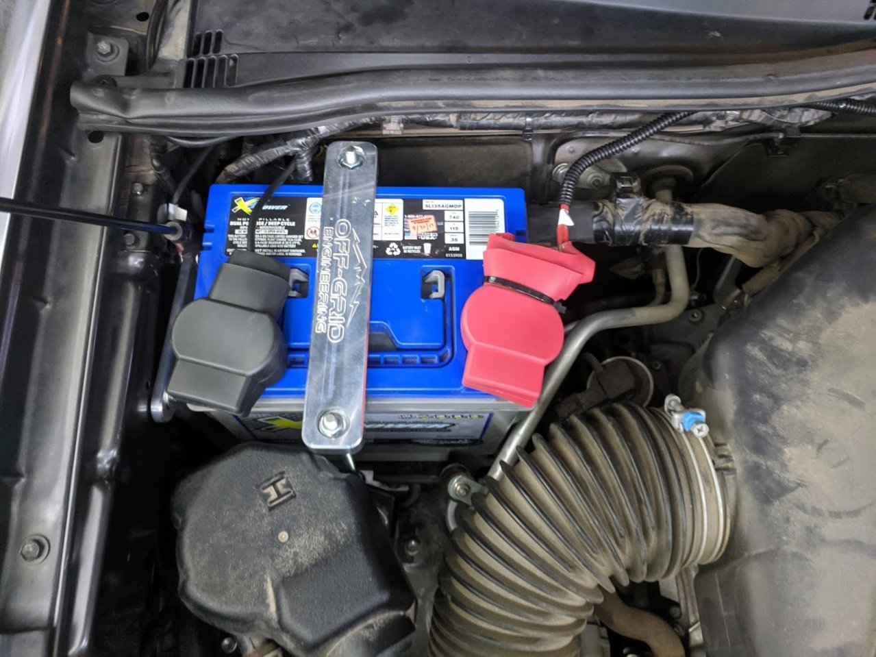

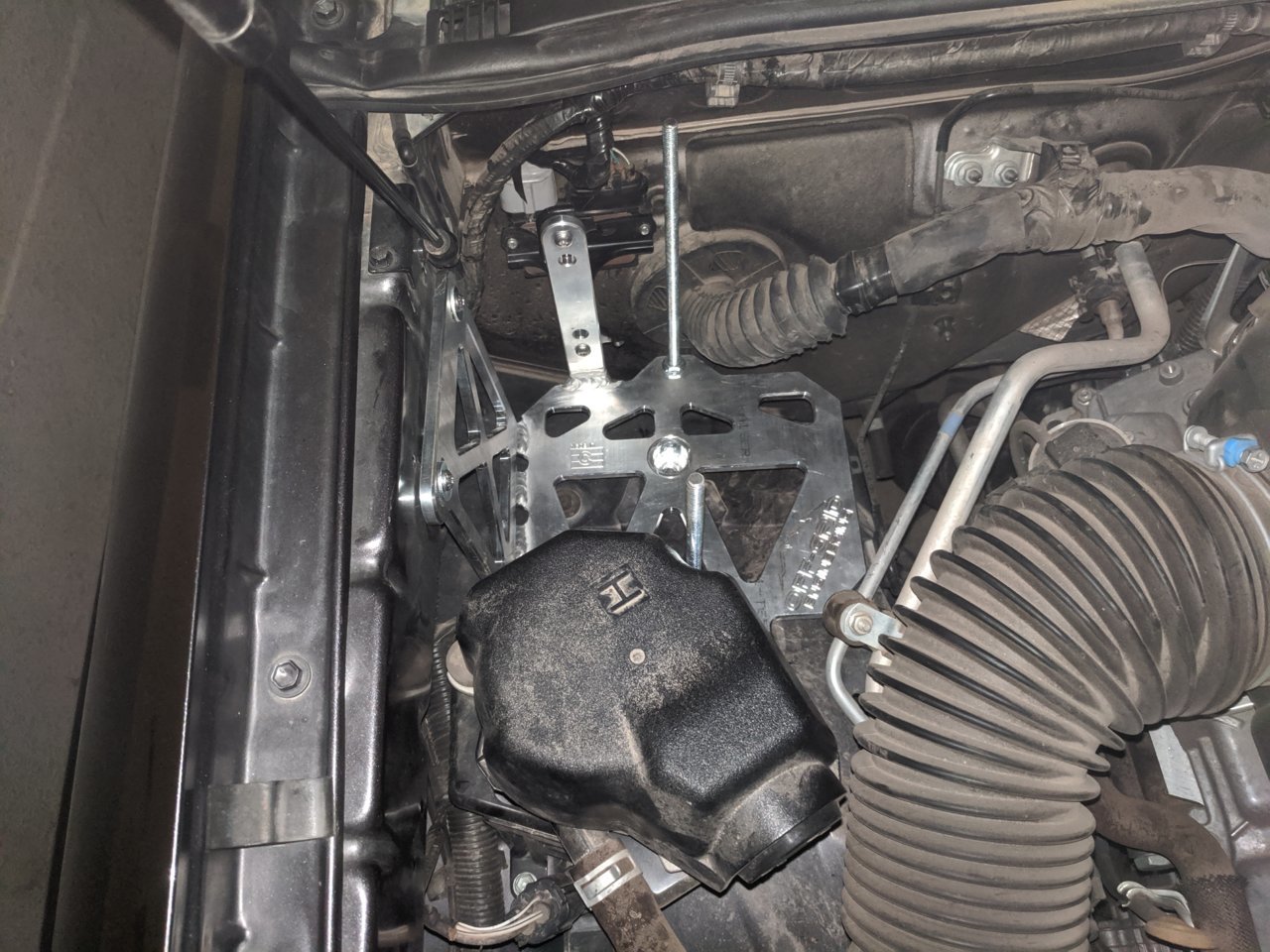

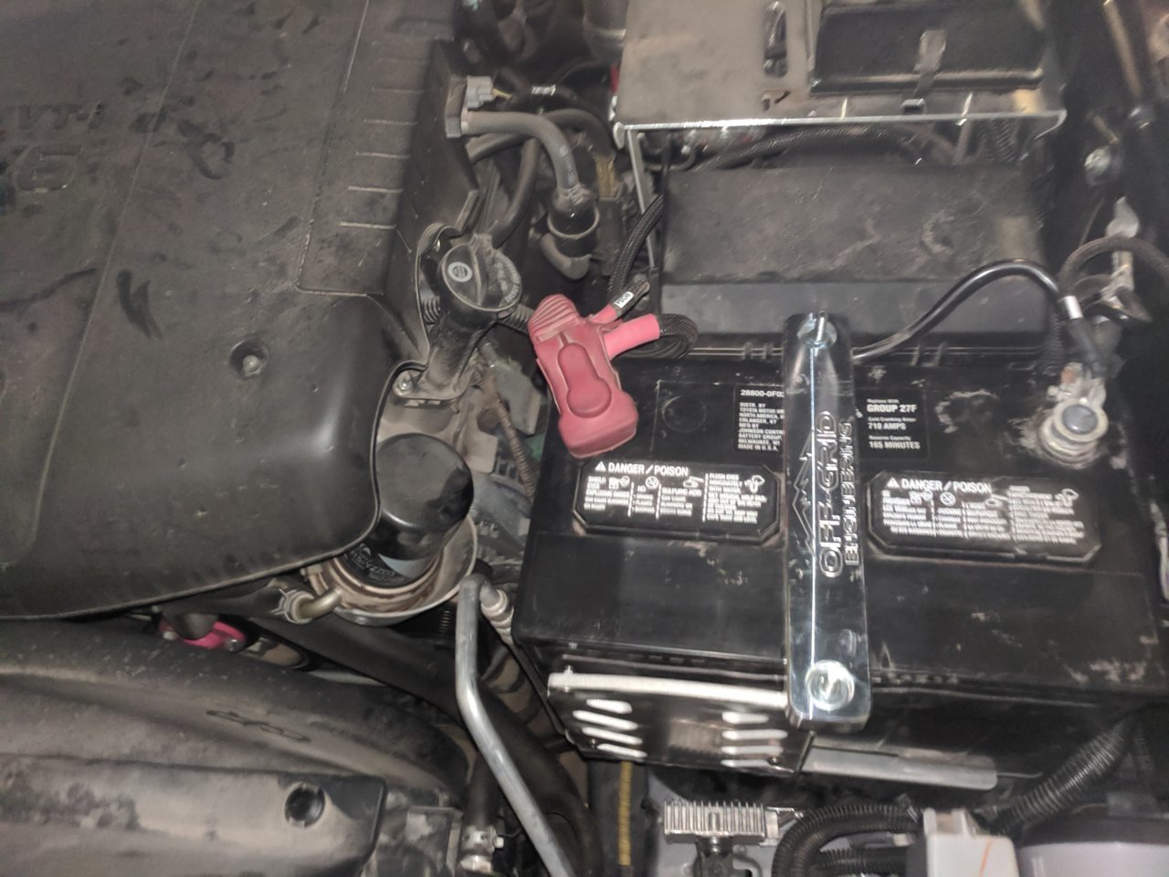

    Added the start of my dual batter kit this last weekend and a tailgate lock. (in prep for the final update on my custom cap)

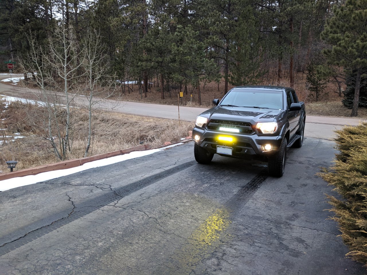

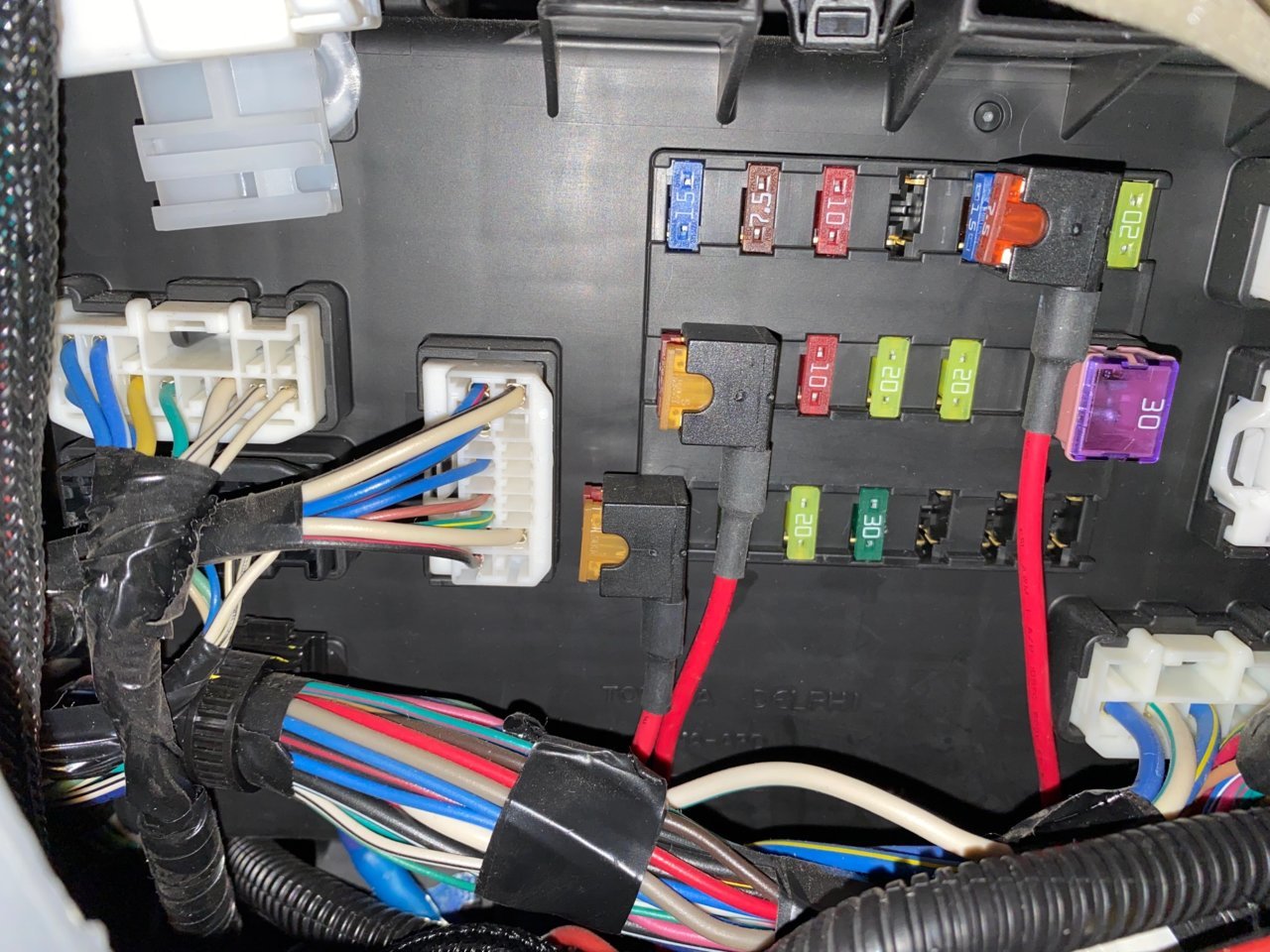

    Great weekend. :) Finally finished up my dual battery and ditch lights installations.
    IMG_20191220_155219.jpg IMG_20191220_155230.jpg IMG_20191220_155236.jpg IMG_20191216_211952.jpg

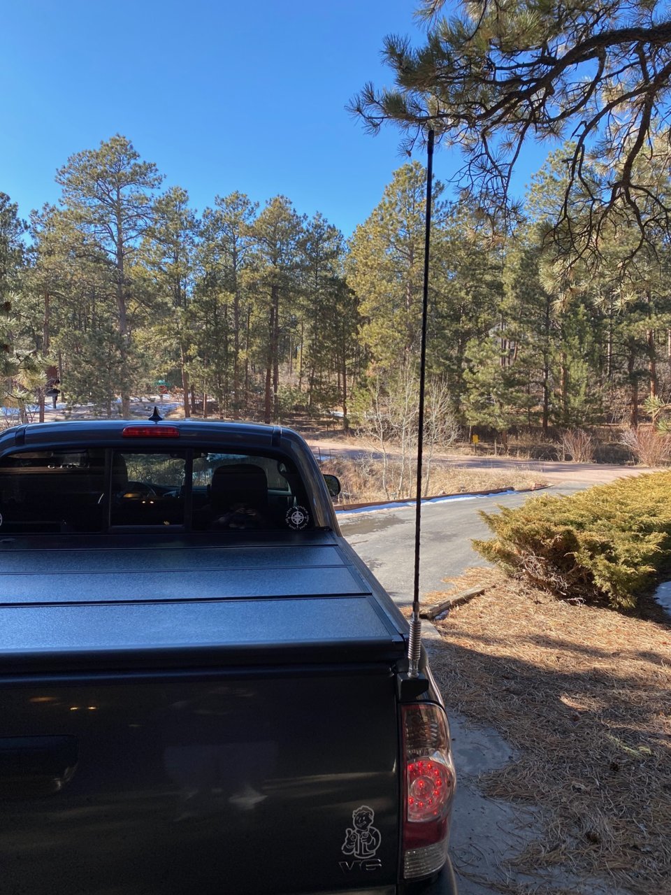

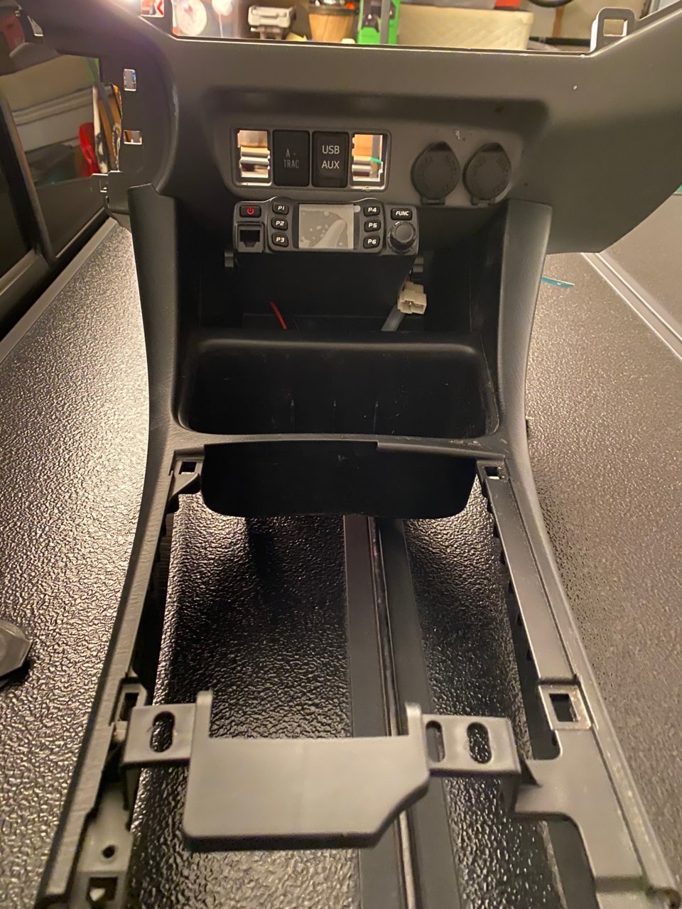

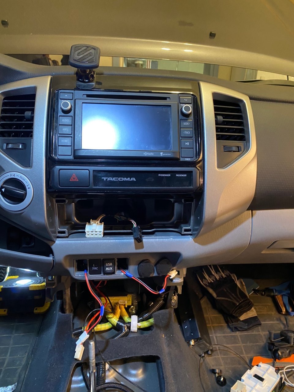

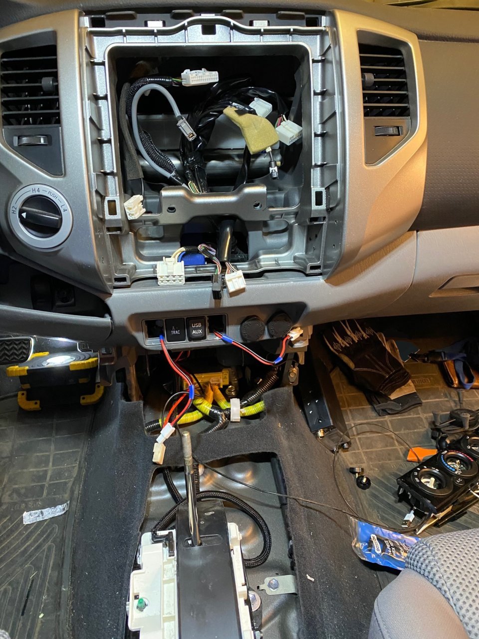

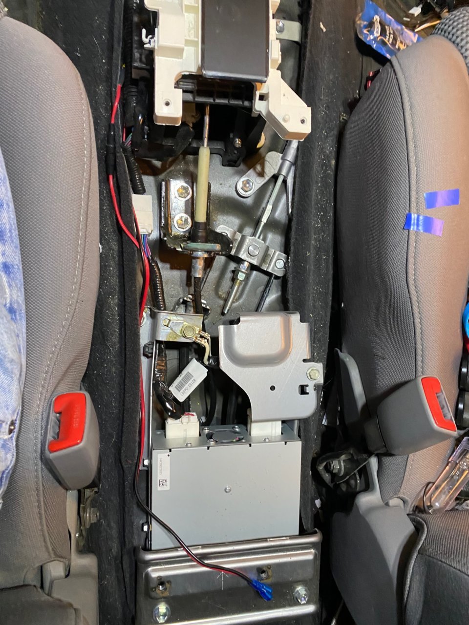

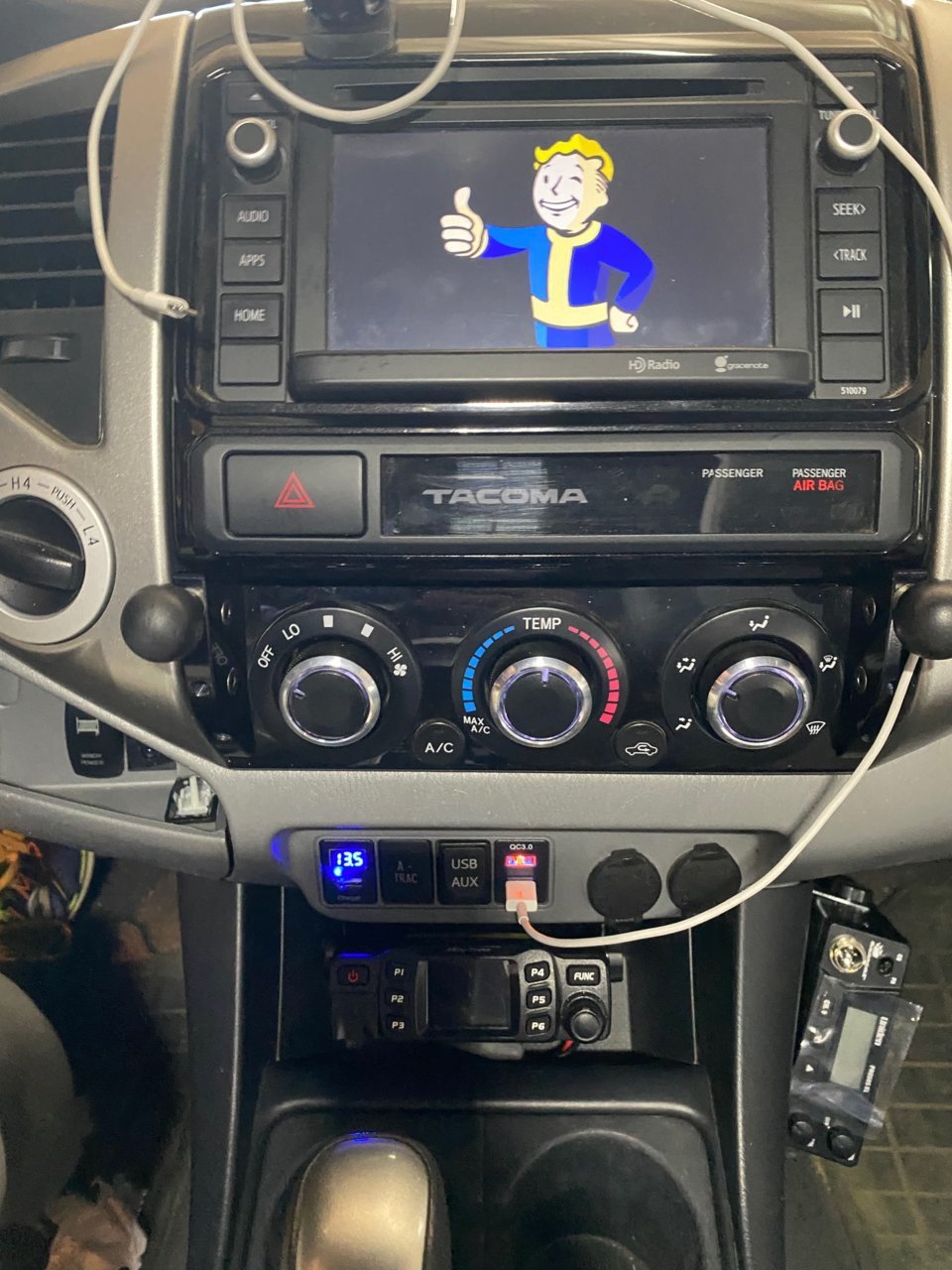

    Well it’s been a busy few days. I received a new CB and HAM radio at Christmas and finished up the installation this week. I figured while I was wiring things up I would go ahead and add in some extra USB ports as well. The kids like their power when we all go out, so I figured it was time to stop running their wires from the front to the back seat.

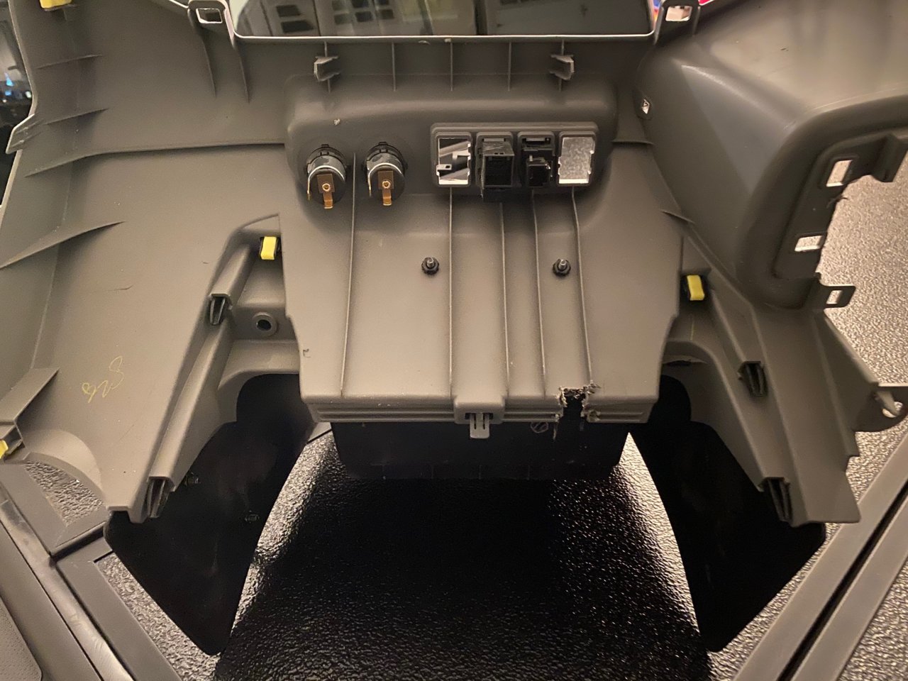

    Installing the USB ports was a bit more trouble than I expected, it’s not perfect, but it worked out fine in the end.
    The following components are what I used:
    Radio
    Finding the programming software for this is a major pain in the arse! There are two versions, best I can tell, some of these radios will only work with v1 and some will only work with V2. V1 seems to be what most people use and it’s from a Russian site very tough to dig up, so I posted the link I used below. This radio it is not supported by Chirp.
    Manual program is intuitive if you have any type of technical background. I watched a couple you tube videos and the rest was simple to figure out. I certainly don’t have it all figured out, but I am able to program it just fine.
    Radio Antenna(s)
    I chose two different ones the smaller cannon style is for daily driving and primarily vehicle to vehicle comms. I use the Tram dual band when I want to hit repeaters and get larger range. Truthfully both work really well so if you only want to do one, either will work.
    CB:
    CB Antenna:
    USB kits:

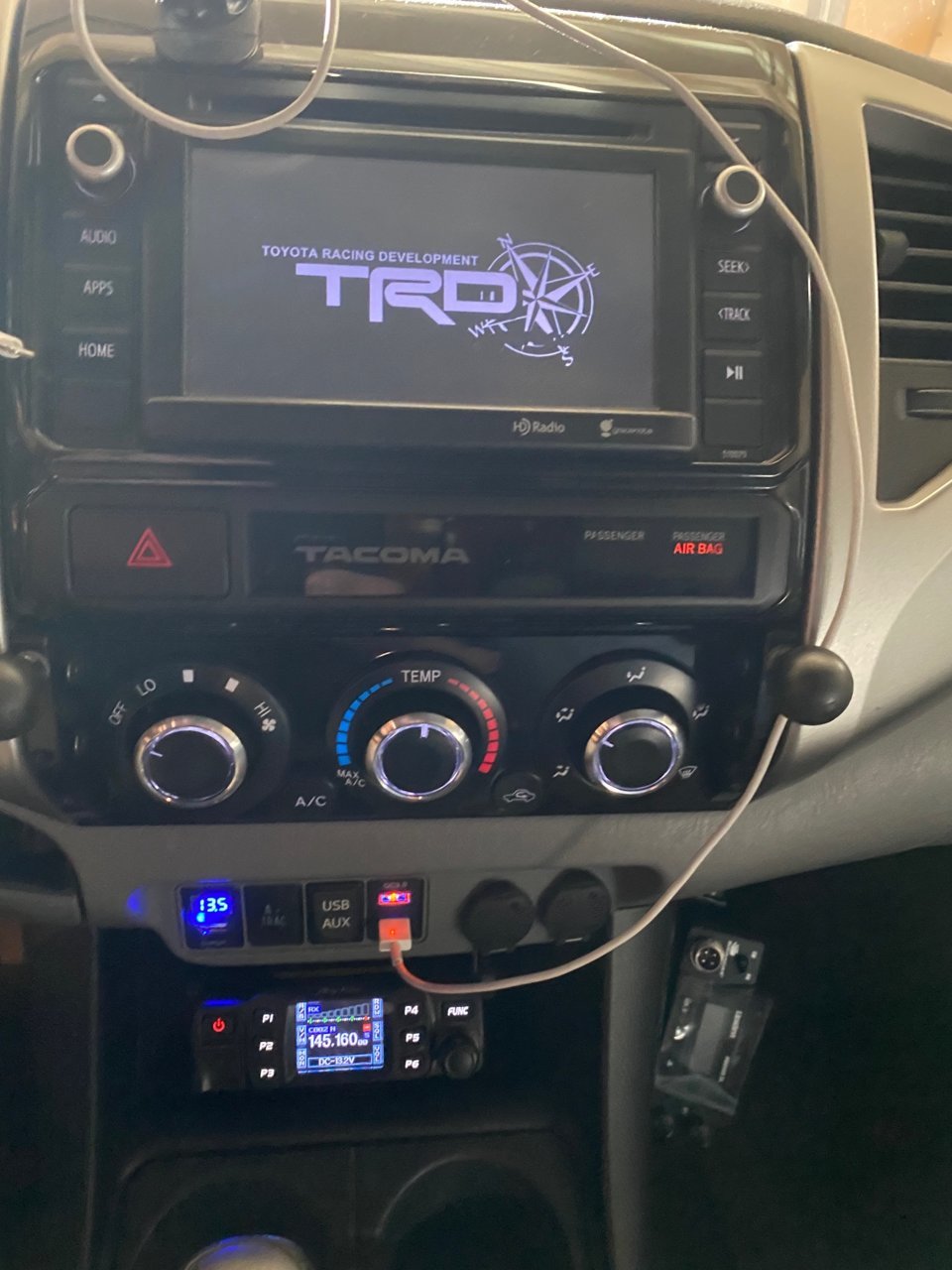

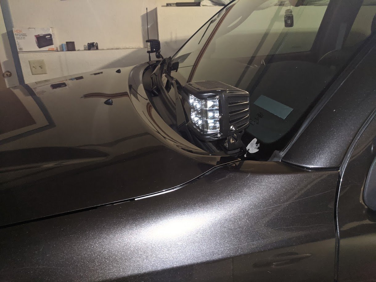

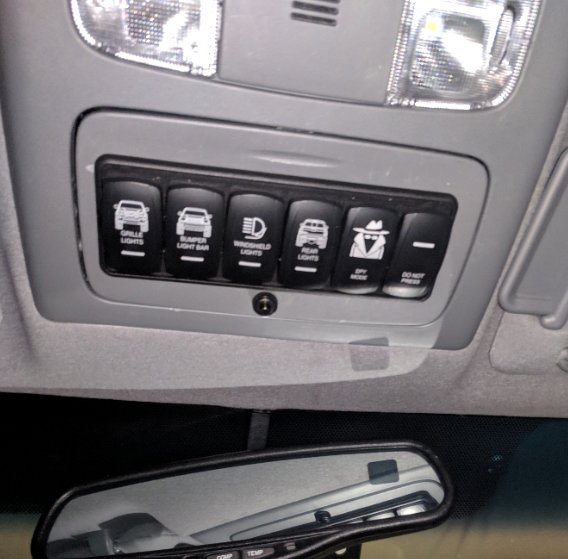

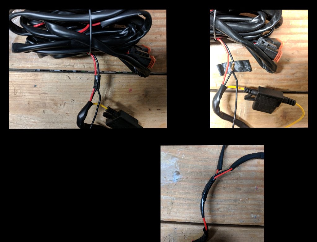

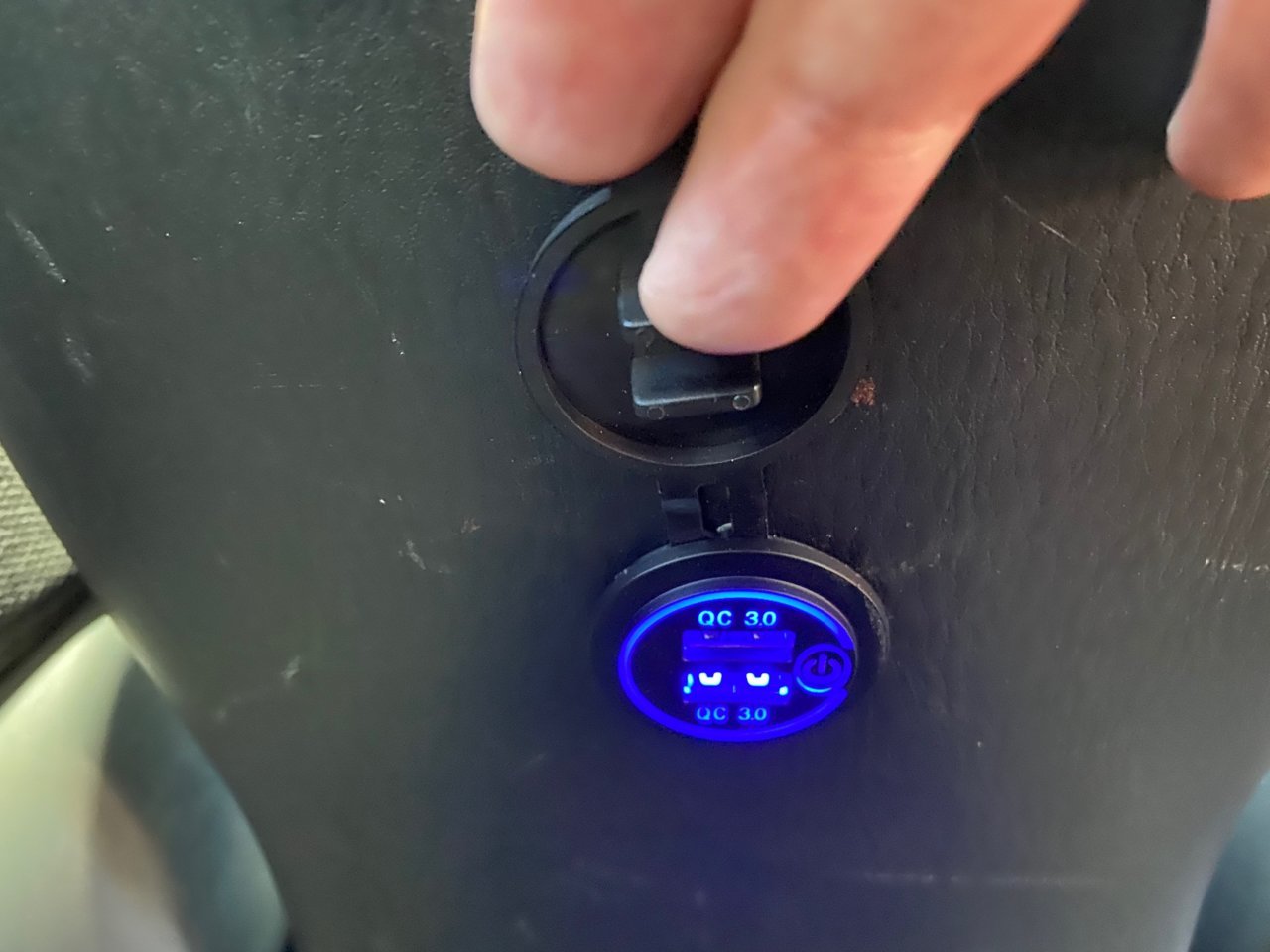

    I used my own automotive wire and some add a fuse taps which I connected under my dash using the trailer wire 7.5 amp and Power (cigarette lighters) 15 amp fuses. I added a 5 amp fuse with the 7.5 and a 7.5 amp fuse with the 15.
    I also use a marine heat shrink wrap on all my wiring and when I solder them I typically do it in two ways, 1. Solder, then cover with a little electrical tape and finish it off with a marine grade heat shrink. Or 2. I have been testing out some new premium solder heat shrink butt connector sleeves (from Amazon) which so far seem to do a good job and connections test well. I still cover it with a marine grade heat shrink for good measure because it just looks cleaner. I didn’t list either here because you can get it from amazon pretty easy or harbor freight.
    · Note on the Yohan Quick charger that I placed in the back of the center console for the rear seats, It has constant power so I specifically chose the USB with the on off switch.
    Some Photos of finished work:
    1. Front Antenna.jpg 2. Rear Antenna.jpg Z9. Radio Power On.jpg Z9.1 USB power 1.jpg
    I almost forgot, I picked up the 84” wiring kit from sPOD and connected to my extra battery so now the only thing connected to my primary is the winch (which is separated by a solenoid and power switch so it only draws when I turn it on). In all I am finally read to start looking for what is next on the project list.

    Here are some Installation photos so you can see what it took to actually complete the installation:

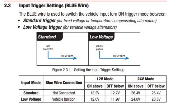

    Did you hook up the blue wire of the Redarc to an ignition source?
  18. Feb 17, 2020 at 5:25 PM
    #58
    000doodie000
    000doodie000 [OP] Well-Known Member
    Jun 12, 2016
    #189457
    869
    J
    2015 Taco TRD Off-Road
    Many and always modding Wheels Suspension lift Armor Electrical gadgets etc...
    I left the blue disconnected so it uses standard trigger settings. I do not believe the 2015 Taco has a variable voltage alternator/smart alternator. (when I watch the voltage on the battery it normally runs between 13.8 and 14.2 , sometimes lower depending on temperature. (so it would seem to be ok on my 15 with the standard trigger.)
    ypahuboy[QUOTED] likes this.

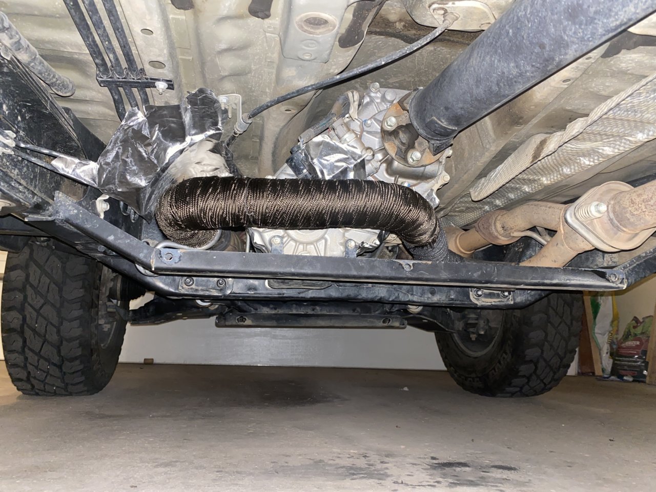

    Finally got around to an exhaust re-route. I wasn't going to do it because I have the Mobtown skid setup (for non-reroute) but I hit it pretty hard about a month ago and the exhaust would rattle against it (at certain harmonics) It annoyed the crap out of me.
    No more issue now! Time to put the armor back on. Once it breaks I will be replacing it with a new set, unless I decide that the extra inch is worth the $$ (or someone here on TW is making a set and wants to sell me one on the cheap) :)
    I did check and it sounds like the left side cat may be void on the warranty (if there is an issue). However, the right side should be fine because it has not been modified.
