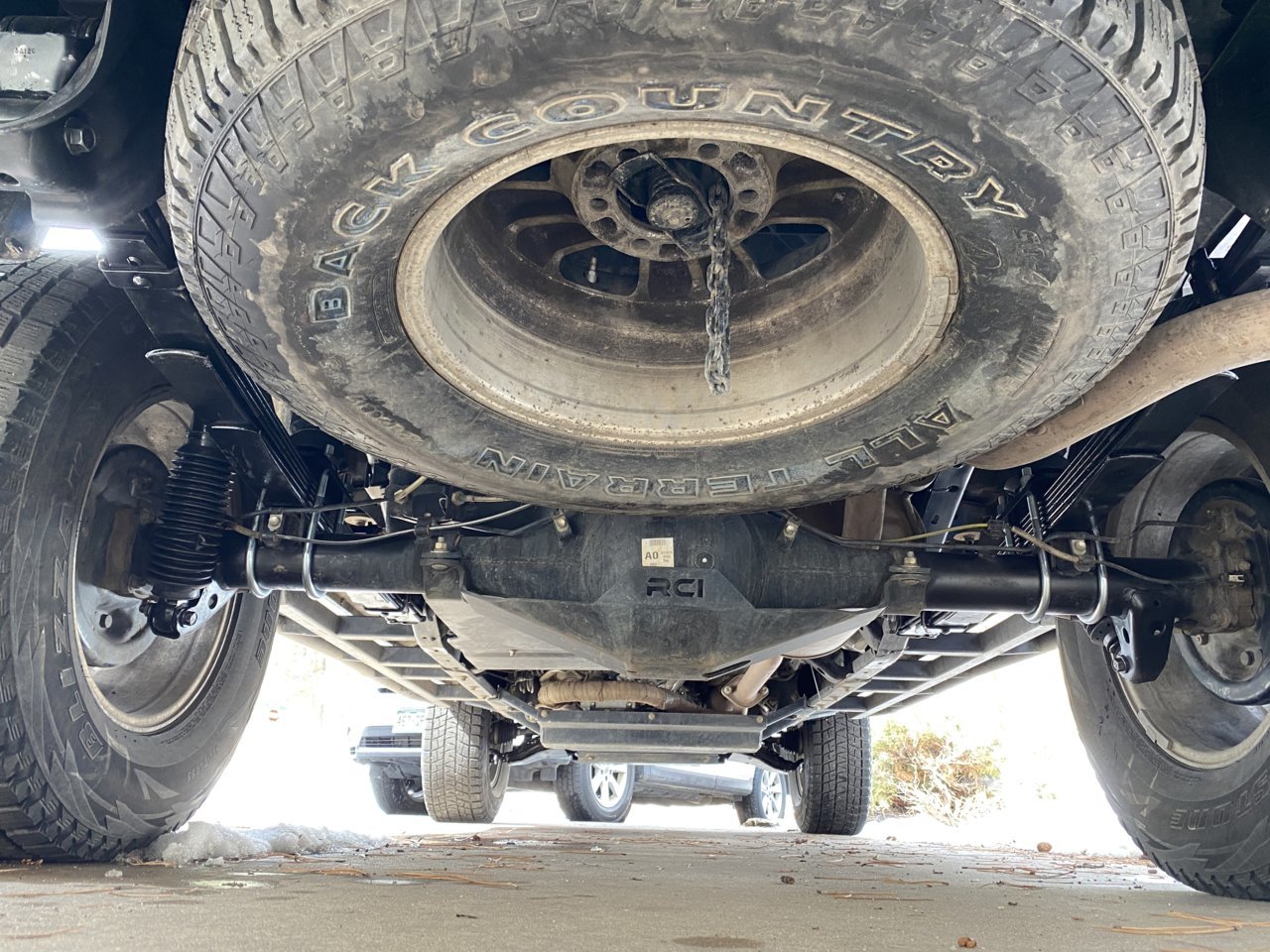

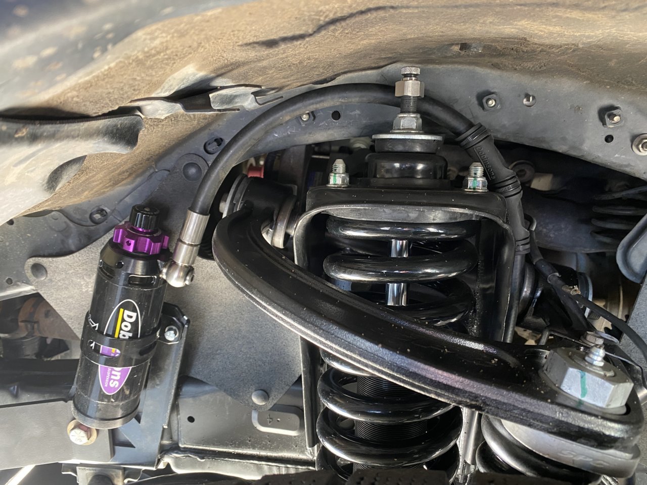

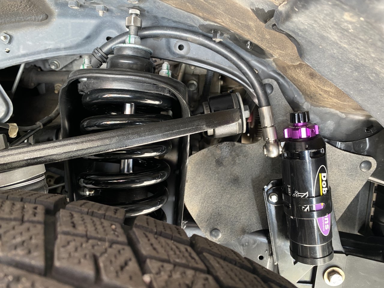

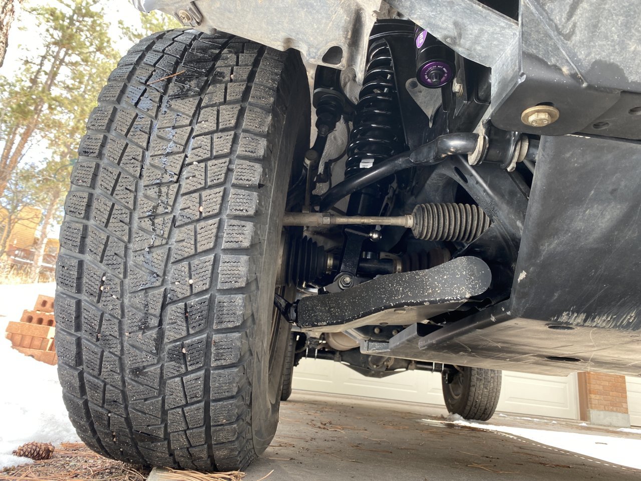

    Well the Icon’s are off and the Dobinson’s are on. So why Dobinson’s?
    I looked at Icon (since I have a stage 3 and liked them), OME BP-51 setup, The Dobinson's, and a few mixed combos Fox Rear + Icon Front, etc.
    But bang for the buck Dobinson's seemed to check all my boxes. I also had 3 people highly recommend a local shop (Armorology) and like supporting local folks so I purchased through them and decided to have them do a BMC for me. Jed from Armorology was awesome. It sounds like Mike from Exit Off-road helped get him set up as Dobinson's reseller so far quality folks all around which excites me more about the products from Dobinson’s In general I asked many people a bunch of questions, watched as many YouTube videos about the products as I could find, pulled everything out of my rig and weighed everything to get an accurate assessment of all my gear and how I run empty and full. (I am pretty confident I made a good decision)
    So What more did I want that I didn't have...
    1. Full adjustability on all 4 corners, and I wanted it to be simple)
    2. More OEM style bushings and joints.
    3. Longevity in the rebuild lifespan.
    4. More load capacity.
    What did I order?
    • Black Coil Springs (just could not do the turquoise)
    • Shooting for 2 - 2.5" Lift Selected the following:
      • 110-240LBS Front Coils (C59-352) (considered the MRA59-A220 but didn't want to end up pushing 3")
      • MRA59-A221 Front adjustable Struts
      • 213MM SEAT HEIGHT (Stock Seat Hight)
      • SC59-001 DOBINSONS STRUT TOP PLATES
      • BS59-560 DOBINSONS ADJUSTABLE FRONT BUMP-STOP KIT
      • MRA59-A940 Rear Shocks
      • L59-111-R DOBINSONS 2.1" LIFT 600LB CONSTANT LOAD HD
      • PB59-110K Bushing kit bundle
      • Greaseable Bolts for leaf bushings
    • SPC UPPER CONTROL ARMS (Considered the JBAs and almost went with Red Coils but the deal on SPC was too good)
    • Timbren Flipkit with new U-bolts and bumpstops
    • I'm also going to do a BMC along with the install (no more rubbing!)
    I also run 255/80/17 Cooper ST Maxx, (skinny is the new sexy) ;P
    *Last, a quick Note about my Icons... The Icons are great, but with the weight I am carrying now and traveling I am starting to do (last year even with covid and travel restrictions, I put 8k miles on in backroads) I figured I'd pull the Icons and see about getting them in the hands of someone who will appreciate/use them more effectively. Between that, rear springs not cutting it, and November pricing it was time to make the change.
    (My Icon Kit sold fast, I probably under priced them a little but the rears did need a rebuild so I think it was a win/win for me and the new owner)
    Things I didn't like about the Icons:
    1. I didn't like the idea of having to rebuild every 30k ish miles
    2. Ihe Icon UCA (uniballs)were noisy and I was meticulious about trying to keep them clean and I even tried the caps on them. This is not Icon's fault, I should have chosen better.( I will never use uniballs again, I should have went with Deltas, but they were not super common at the time )
    3. I did not plan for the weight I am carrying now when I purchased them and I was doing some trips about one weekend a month to wheel and some camping on the off weekends. That is far different than where
    I am now. (up to 2 weeks at a time on the back roads and exploring, I don't use the truck for much daily driving.)
    In short all this just means I did not plan well when I was struck with the TW upgrade sickness and I had to do a fairly spendy re-purchase.
    with all that said here are the photos...

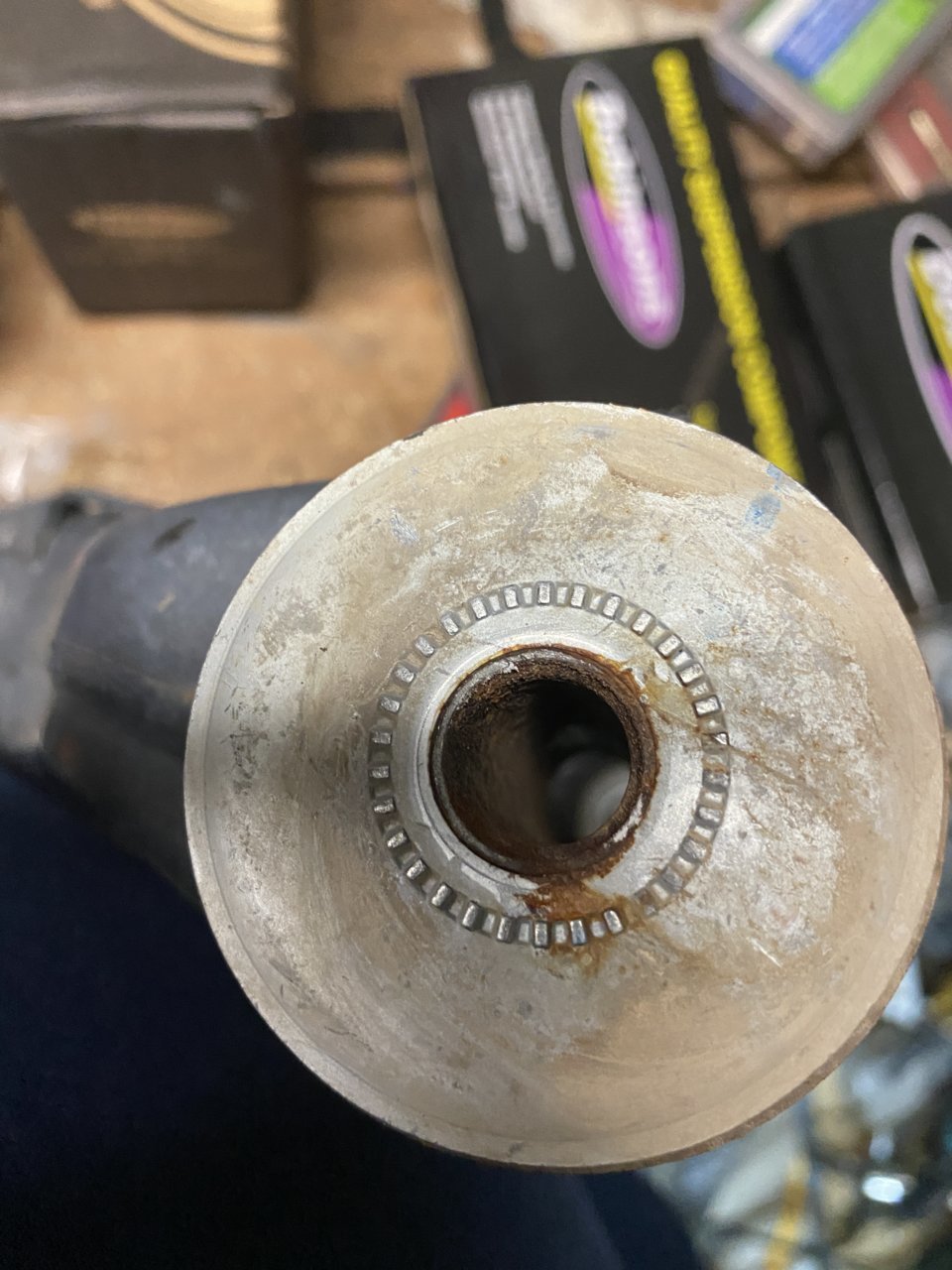

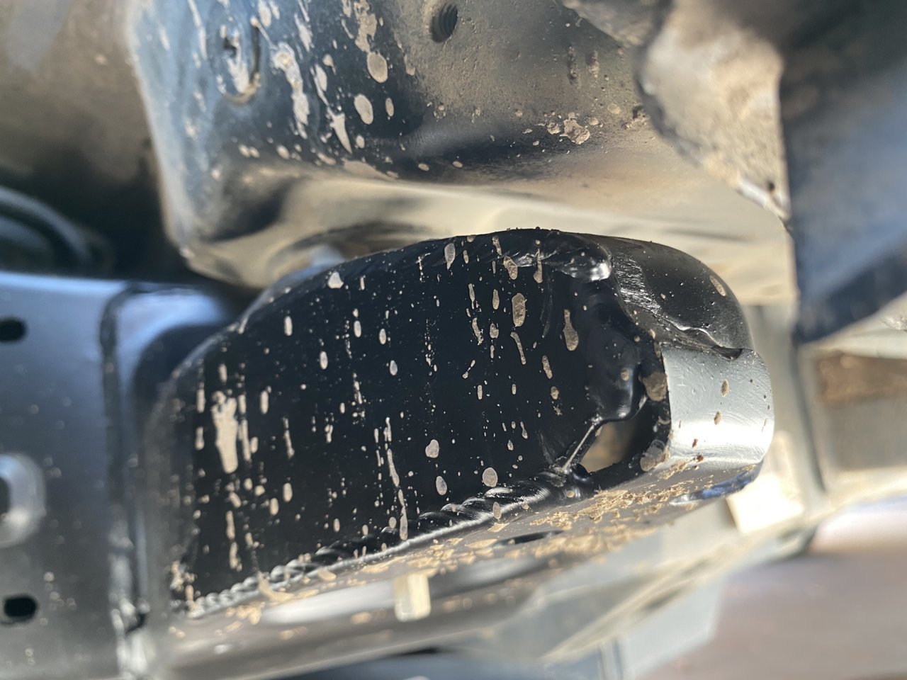

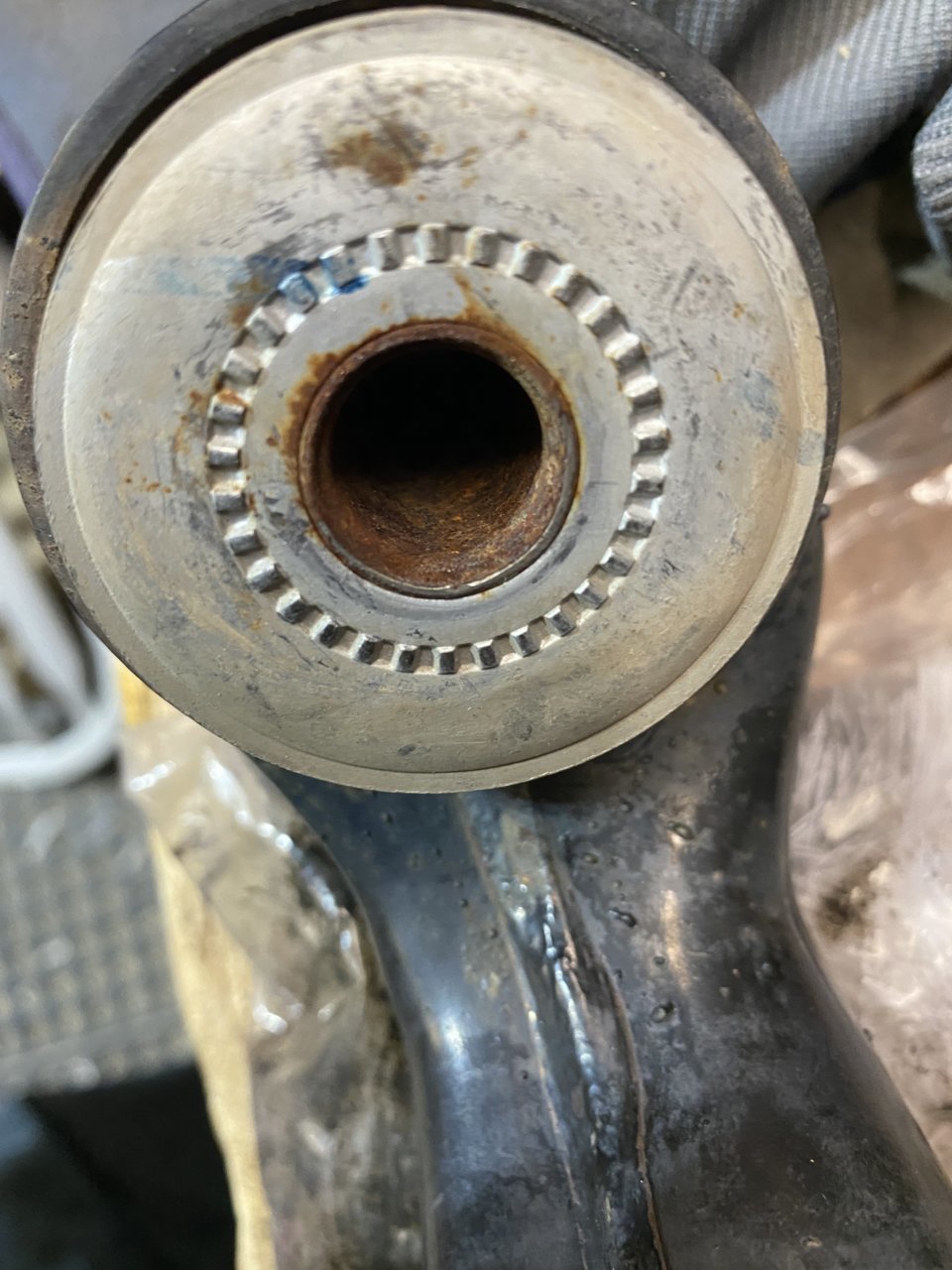

    During the installation I learned a bit about our Tacoma UCAs as well. The bushings tend to rust and seize which makes it very difficult to align. My truck is only a little over 6 years and had just over 50k miles. The bolts came out (barely) the LCA ball bearing was also bad. (I could move it with my pinky) so I replaced the LCAs during the change as well. The shop I used recommended anti seize and I had them use it on the LCA and the rear bolts in the leaf springs rather than the greasable bolts that came with the kit. I also used new bolts. (Why not while its all apart, if it’s worth doing, it’s worth doing it right.) I could have cleaned up the bolts but now I have a few spares.
    I was a little disappointed in the Timbren flip kit as the U bolts were only 1/2 vs 5/8. In terms of time I went ahead and used them as it seems like a common size for the flip kits and not having a direct bend like the square 5/8 bolts it’s probably fine. (I will see about getting larger ones and replacing them since it’s an easy change to make now that it’s all back together.
    here are a few photos of the LCA bushings.

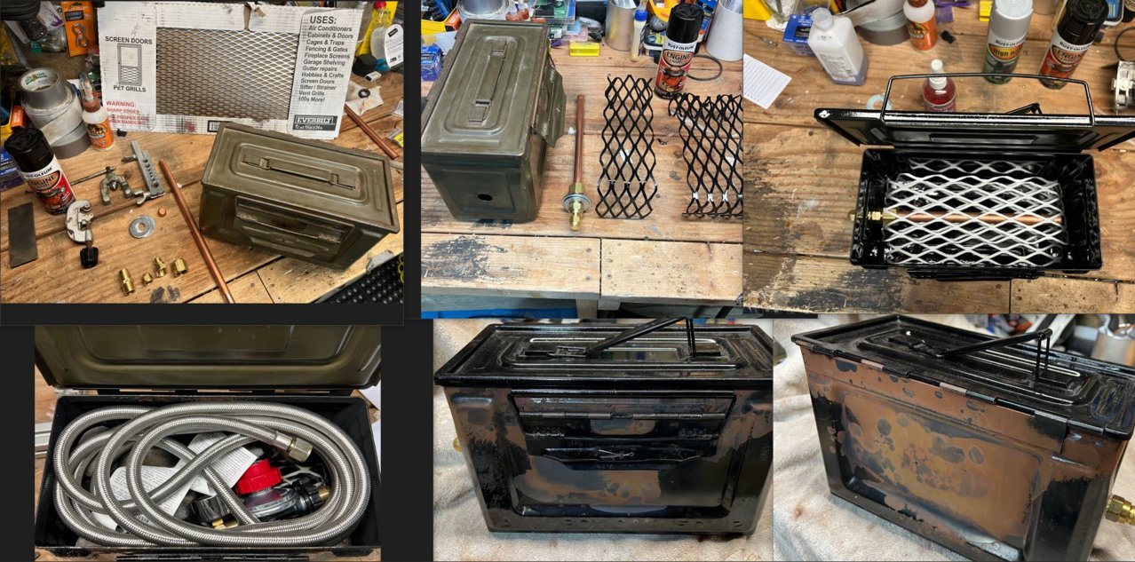

    First up ... With all the fire restrictions just about everywhere I figured I would put together an ammocan firebox. It works amazingly well and actually puts our a fair amount of heat. Its not as good as a wood fire. But it does take the edge off a cold night and fire is well.. ... nice.
    I ended up using some old airconditioner grate instead of what you see in the picture, because it was free and a little thicker. Other than that all the parts are there and if I were to do it again I would forego the high temp paint on the outside of the box. It baked off anyway and I like the patina that is now present. The image is a bit blurry below, but as you can see, its a decent flame. :)

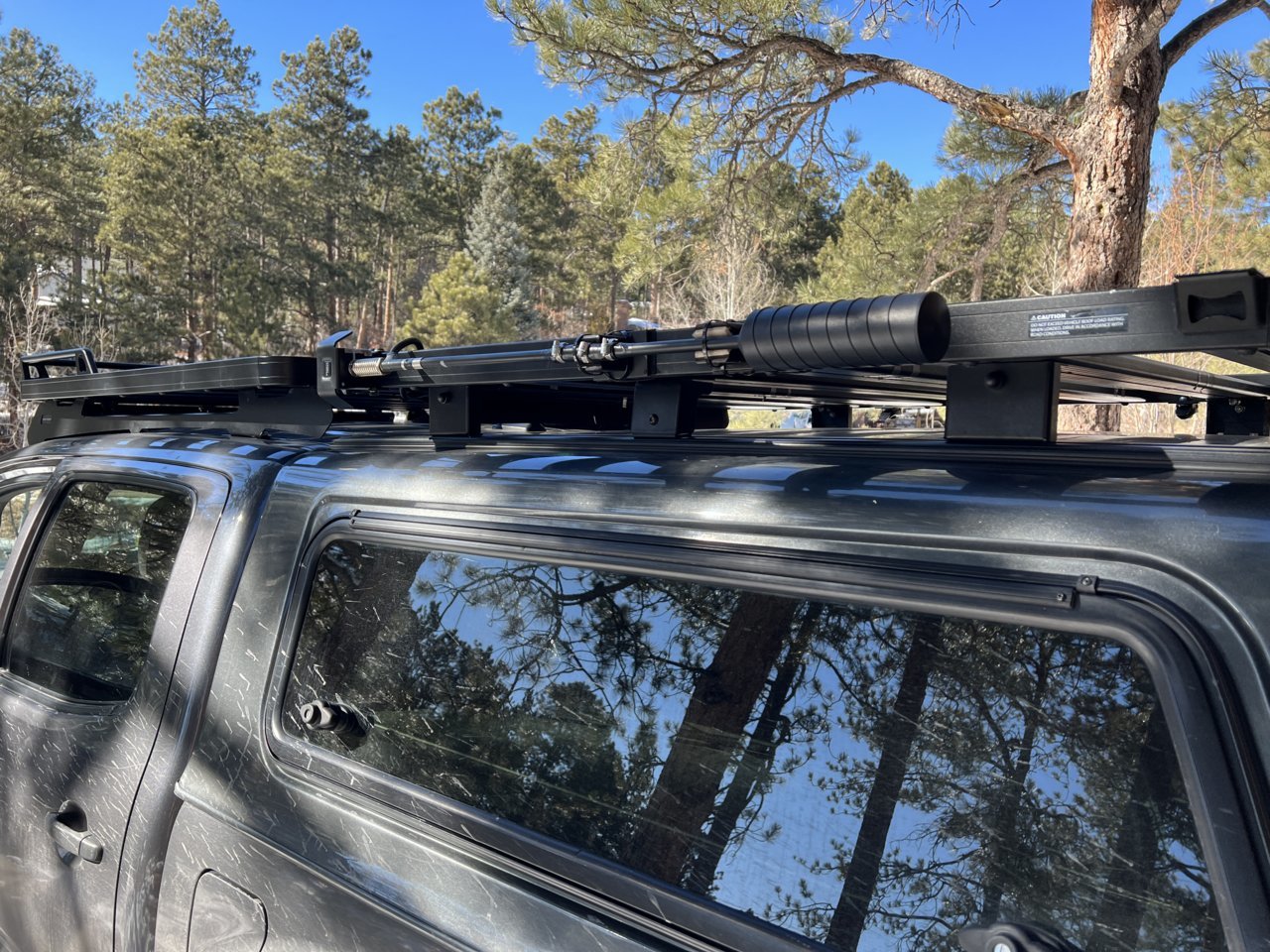

    After that, I found a great deal on a bigger tent.
    It was great... but with the added weight it was time to come up with either a better something to put the tent on or time to strengthen the topper... So, I decided it might be fun to try my hand at design and make something new.
  13. Nov 23, 2022 at 3:05 PM
    #93
    000doodie000
    000doodie000 [OP] Well-Known Member
    Jun 12, 2016
    #189457
    871
    J
    2015 Taco TRD Off-Road
    Many and always modding Wheels Suspension lift Armor Electrical gadgets etc...

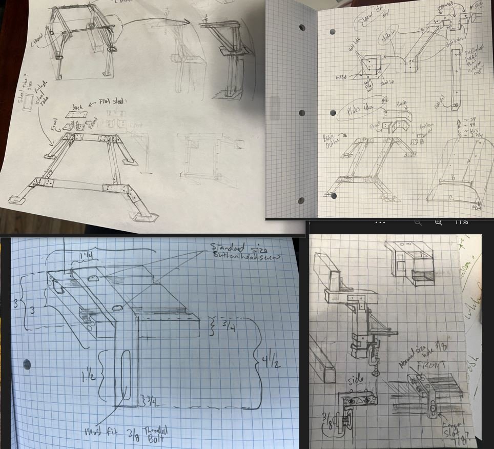

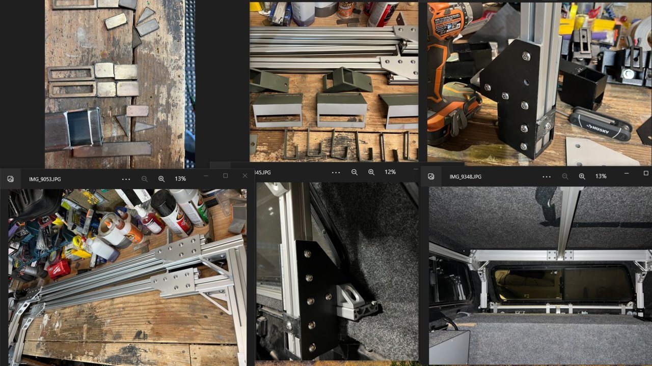

    So the reinforcement design commenced.
    After several iterations it was time for CAD... (which I had never used before). My son was taking some classes in school so he shared a few tricks and after several frustrating days I had a design to scale that was workable. I order the parts and started building. After several iterations, and a lot more $$ than I wanted to spend, I had designed a few parts to make it all work... ordered up some more parts, went down to a local shop and welded some parts together, spent many more weeks testing and fitting, cutting, cursing, grinding, re-welding... heh anyone who has designed something from an image in their mind knows what I mean... Ended up loving the process. Still not exactly what I want, but its close. I still have a final all aluminum bracket I need to finish, but I really wanted a summer to test it first.

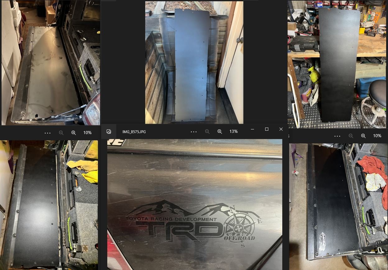

    As projects go, one thing leads to another... so after climbing in and out of the bed I was sick of the ribs on the tailgate so I made my own smooth one. I liked the design I had used on the side of the bed and had some additional vinyl made for the tailgate as well..

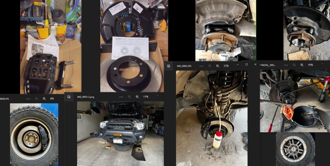

    Back to a project or two... It was time for the install of the new BBK...

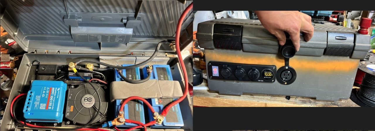

    Here is a quick shot of my first "baby generator" I have a little suitcase (2X 50 watt) panels to run this one. Its enough to keep power for the short trips. Between this and my second battery, I get about 60ah (~720 watt hours).
