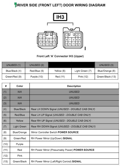

    Giant PITA honestly. There's like a kajillion wires to trace and find out where they go. I took the easy approach and am just going to forego using the factory body ECU and lock module since I would have to re-run the entire length of the cab wiring harness if I wanted factory power locks, so I'm just going to power all the door motors with a simple 12v and the OEM lock actuators with a Viper remote start/entry system. Here's what I've got so far:

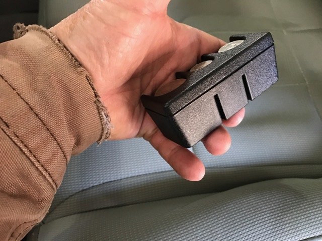

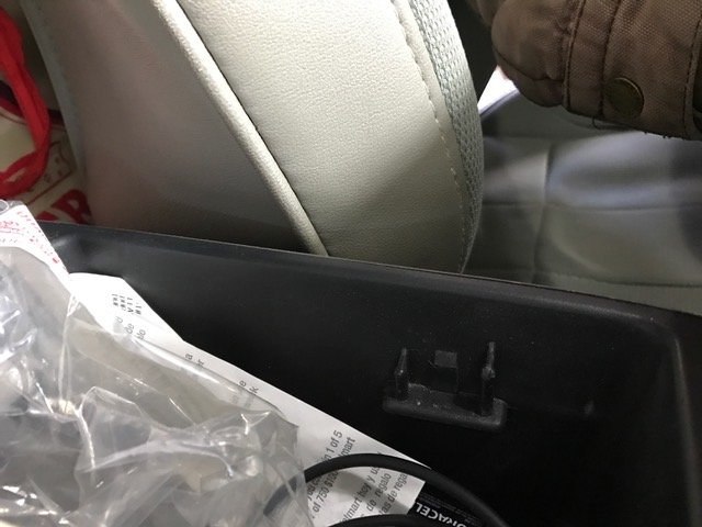

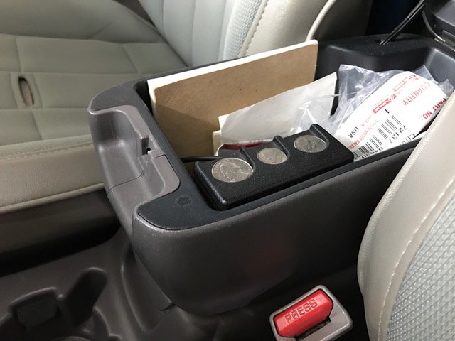

    Here are a few pics of my console. It actually came with a coin dispenser of sorts:
