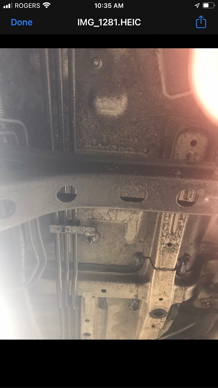

  5. Mar 1, 2023 at 9:59 PM
    #25
    babylon5
    babylon5 Well-Known Member
    Aug 19, 2015
    #162175
    926
    David
    2015 Tacoma Double Cab TRD Sport
    Have never been a fan of tar style undercoating. More of a sound deadener that anything else. Dries out and the water and salt get up between it and the body /frame and its only a matter of time. This is my bare frame that was krown oil sprayed on my 2015. . 8 years of toronto ontario salt/snow
