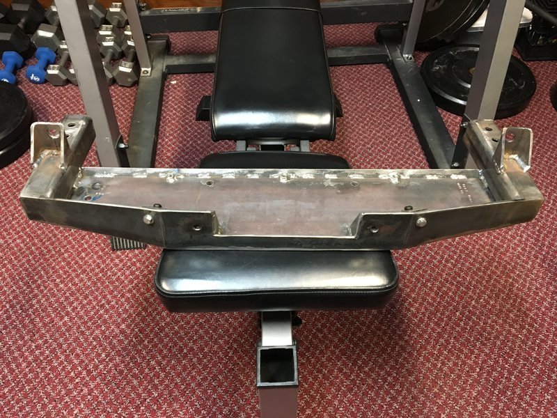

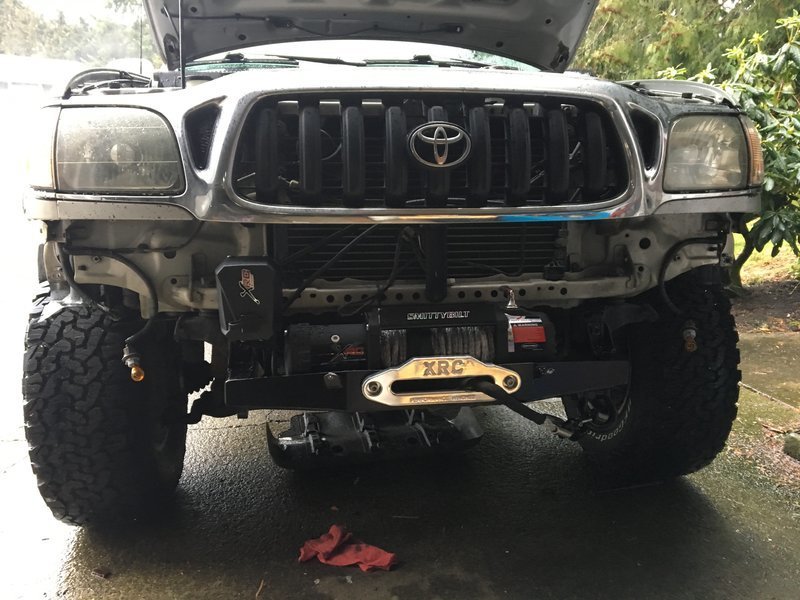

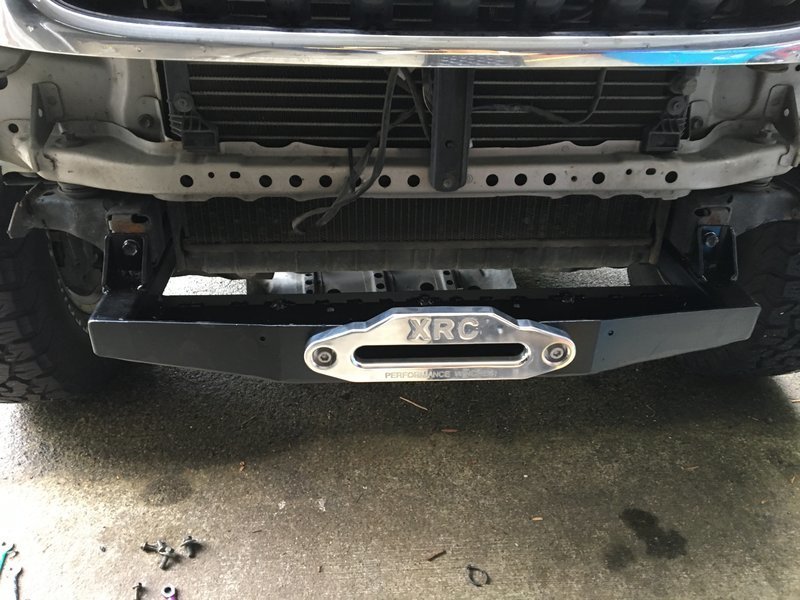

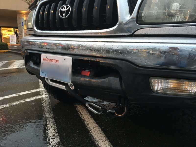

    Title says it all.
    Who has made one, or who is willing to make some, because the few people that have publicly posted about making these have gone MIA (to include the guy who's pictures I just stole).
    I don't care for an aftermarket bumper, and don't care about having to trim the factory bumper.
    Here are pics of said mount -

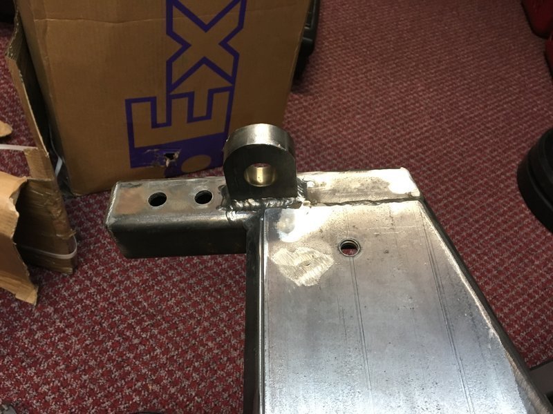

    Two solid bars that attach to the frame horns.
    Gussets and winch plate.
    And well the rest looks pretty self explanatory.

    Yeah, I'd probably toss a rib at the beck end of that since that's a pretty wide span between the frame rails. Maybe even put some to the sides of the winch.
