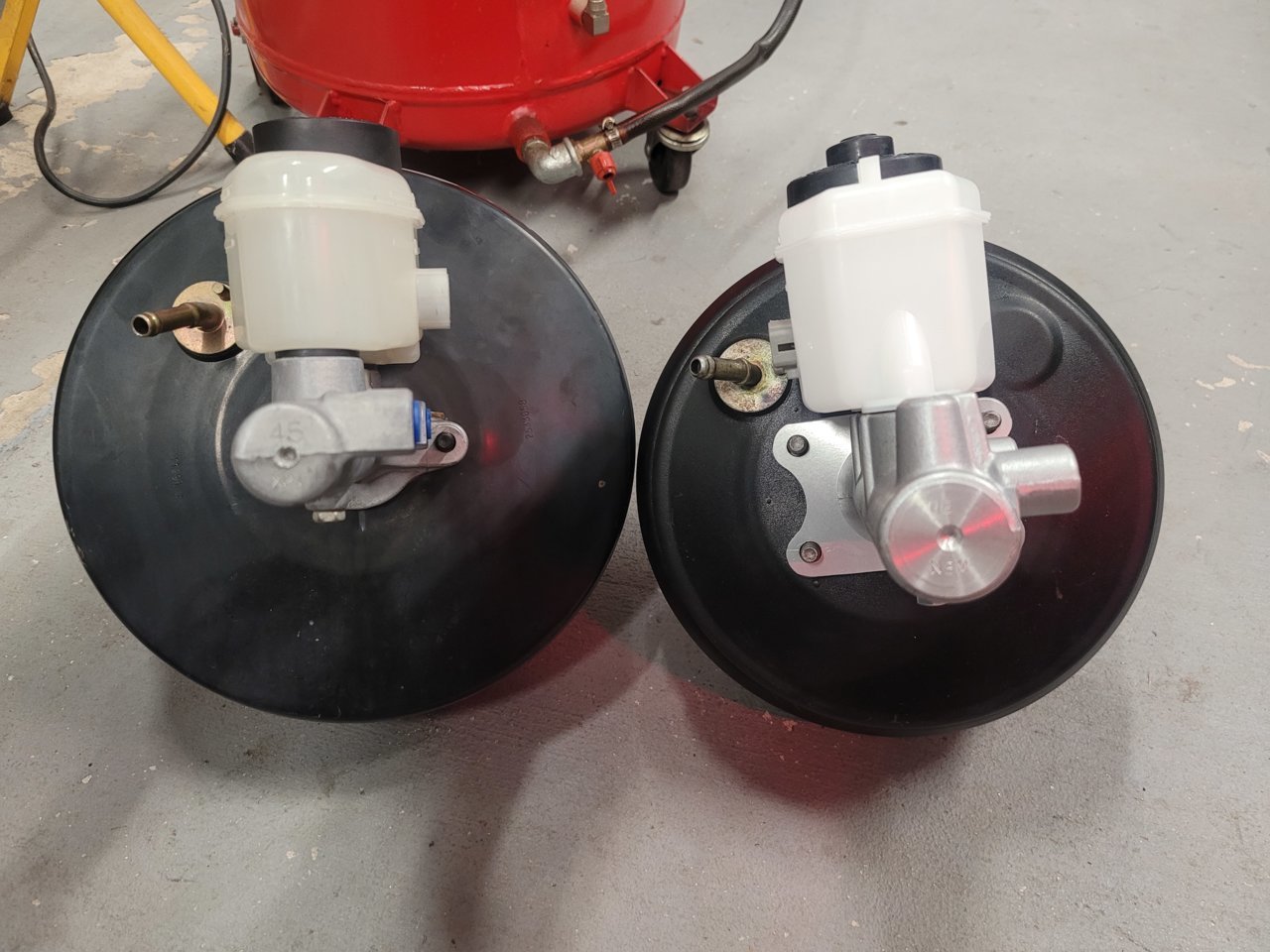

    Something you should know also for reference.... 2 bolt are single, 4 bolt are dual.

    Common practice for 4x4:
    95.5-00 are 4 bolt (all I've seen are 4 bolt)
    01-04 are 2 bolt (These year don't have a 4 bolt from factory)
    If you’re looking for a dual 4 bolt, look for a 1t t100. They use a 4 bolt dual diaphragm booster with a 1.07” MC.
    Picture:
    Left is 02 taco
    Right is 1T t100

  19. Jan 26, 2021 at 8:10 AM
    #479
    02 Goldie_1tons
    02 Goldie_1tons Well-Known Member
    Jan 18, 2021
    #353243
    59
    2002 4dr gold 3.4 (530k miles)
    Non yet, but everything ordered to do 1tons.
    Thanks for the info! I know it’s out there already somewhere. But I appreciate you laying it out there! That helps a lot.
    While we are on this topic though, when using said 4 bolt booster and desired masters. Are you guys finding that the master push rods are working factory or need to be shortened/lengthened?
    I’m sure I’ll figure that out in a few days also. Just looking for already learned knowledge.
  20. Jan 26, 2021 at 8:11 AM
    #480
    allenfab
    allenfab I hate everything
    Oct 23, 2014
    #140913
    2,653
    Todd
    Lakeland, FL
    08 5-lug on one tons
    4 bolt booster. I bought the sky manufacturing adapter and had to make my own plunger/pushrod extension and that was it. Oh, and a wildwood prop valve for the rear
