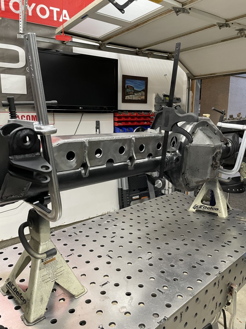

    Been doing work lately.
    Artec truss addition with my own 1/4" top
    Silver braze new longer copper ARB line on
    Raised engine
    Trimmed engine cage to clear intake manifold
    Re-do air bump mounts/pads
    New PRP bench seat (trim out cage tubes, make new seat mounts)

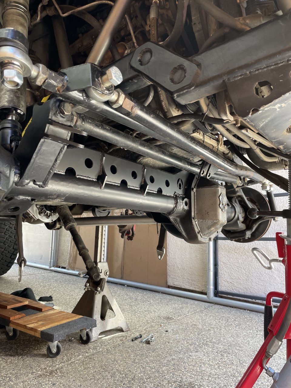

    Really this all started with just wanting to cut off/re do the shoddy air bump pads I put on the front axle 7 years ago haha. One was dented from jumping the truck in Pismo too

    Is your steering a y link setup? Draglink is mounted to the tie rod? Never knew that or is that new?

    New as of a year ago maybe? Less bump steer with this setup and zero chance of heims binding.

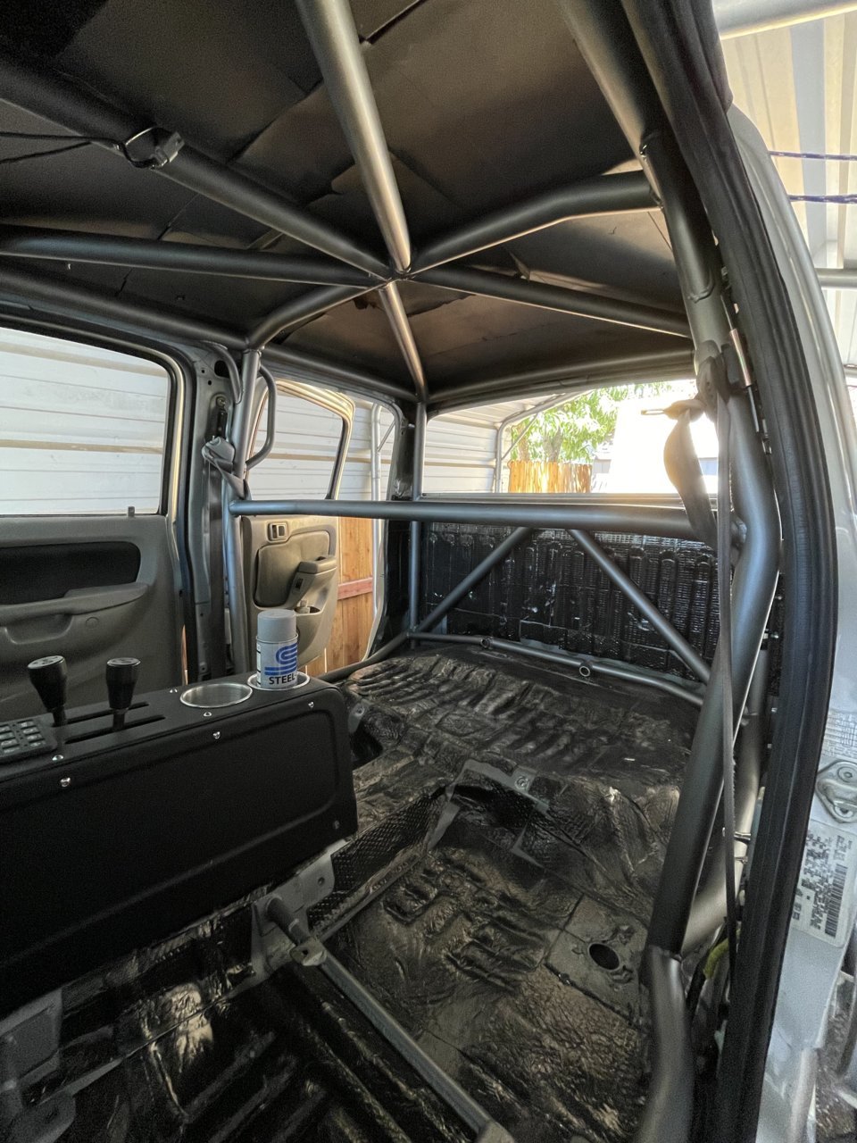

    Stoked how perfectly this bench seat fits. The rear portion fits directly on the flat part of the “hump” in the floor. Going to use 3/8” pins for the rear seat mount so I can easily pull them and flip the seat forward to access stuff back there.

    Nice. wishing I went this route. I had to limit the travel 2.5 inches or so to keep the heims from binding

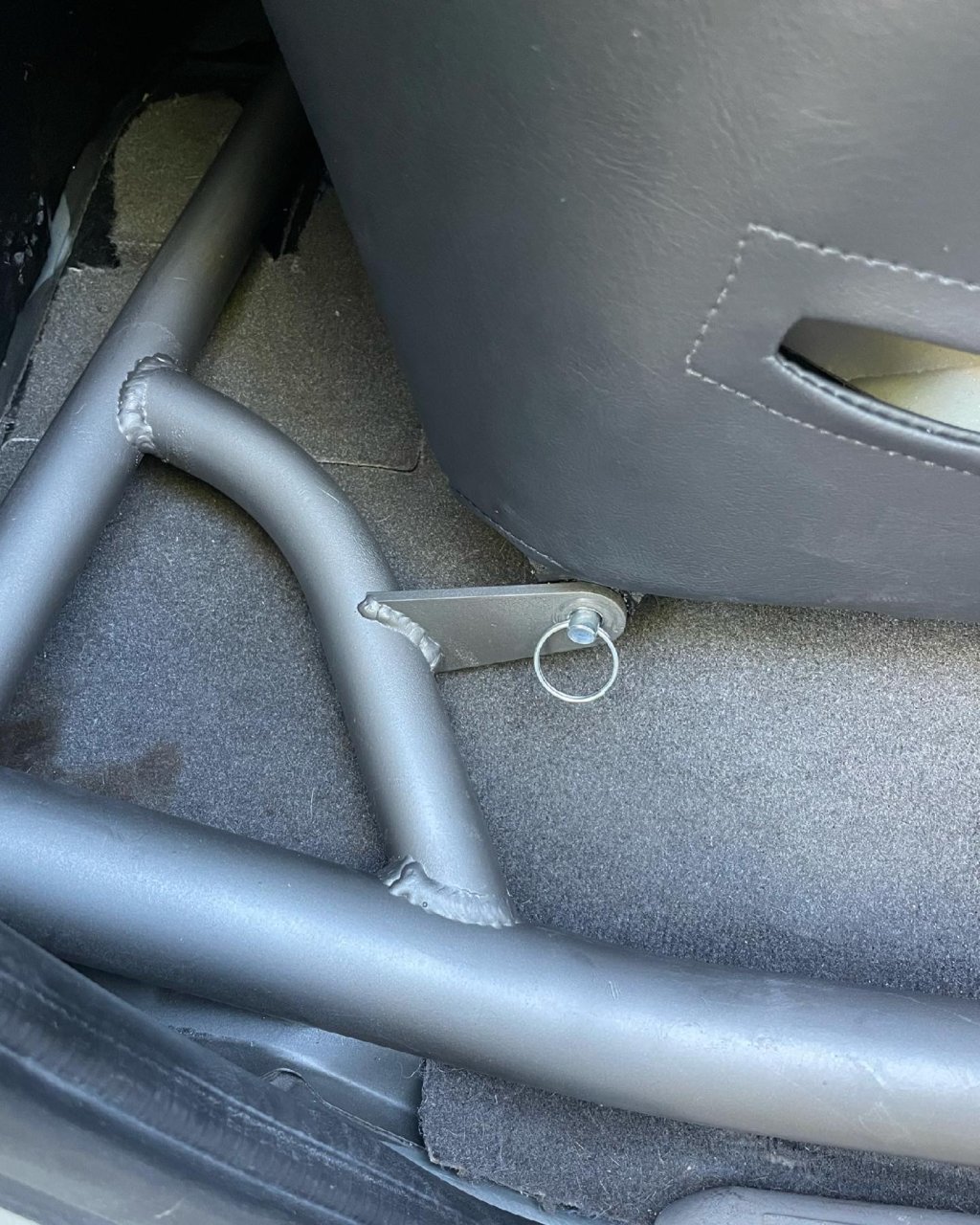

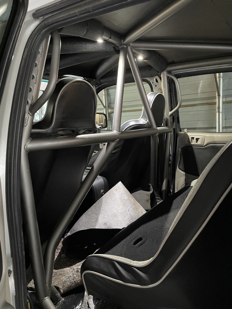

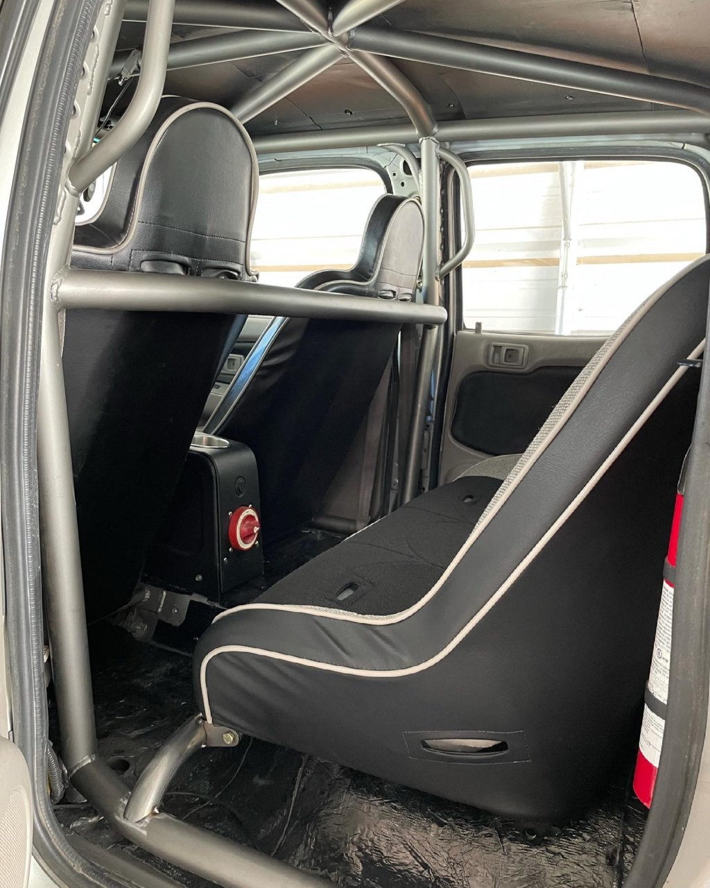

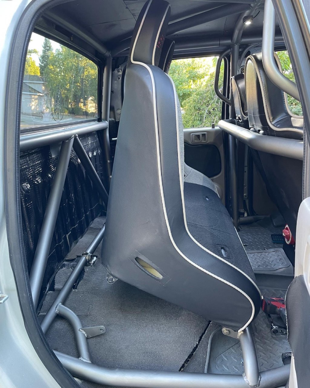

    Bench seat is installed, truck is back on the road. Yeehaw!
    Built the bench seat to have an ejecto seato mod
    4C604806-4208-4884-9E4D-0B3E306749BC.jpg 3DEEFF97-3E52-488B-B843-B86C3AB56156.jpg

    I'm actually thinking of putting hood struts on it somehow so I just have to pull the pins and the seat lifts itself up :rofl:
