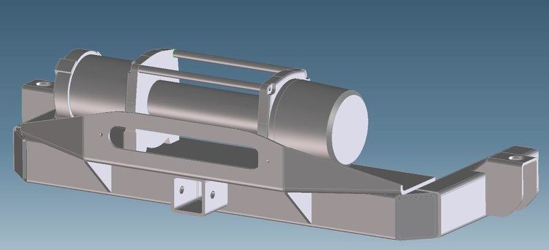

    Modeled up the front frame section and winch/mount :cool:

    Wish I knew how to use CAD :pout:

    LOL I use cardboard in real life still. I'm not advanced enough yet to send drawings to a CNC plasma but someday I will be :cool:

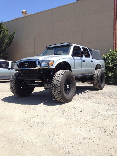

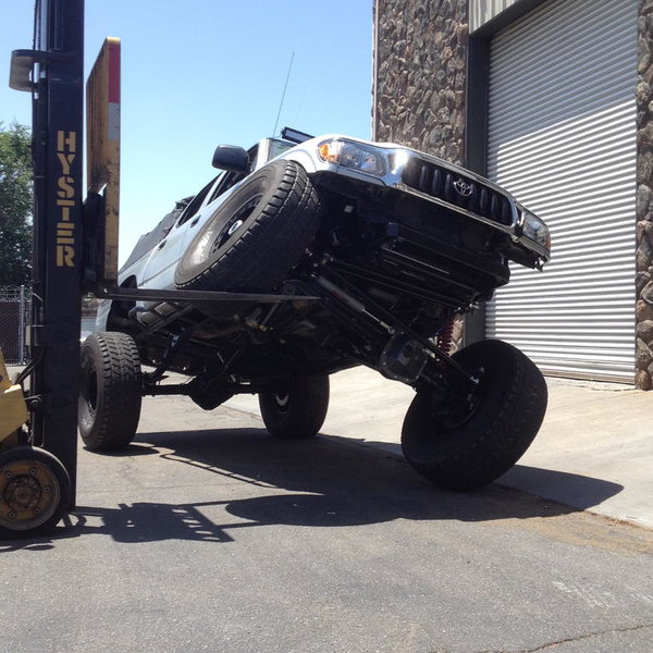

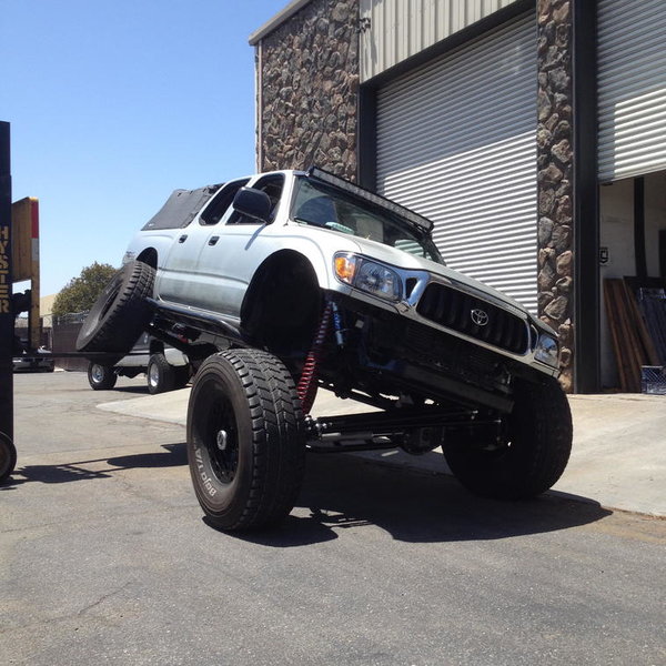

    Welp, the truck left the garage today. Decided to stretch its legs on the forklift too :D Brakes SUCK real bad. I may have to bench bleed the master cylinder a bit more but other than that, it drives great!

    Cot dayuuuum!!!!

    Sweet baby Jesus!
    Thanks for finally flexing it out a bit, I needed some new fap material :D

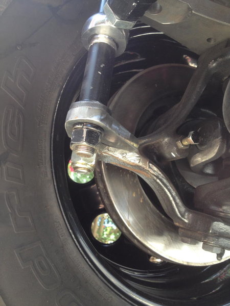

    I may have figured out why the brakes suck. It literally feels like manual brakes, no booster action. I didn't seal up the space between the booster and master cylinder so I'm going to seal that up today and try to bleed them again. It should help a bit :D

    I figured out the brakes today. Missed a vacuum line, put RTV between the master and booster and moved the push rod out a little more. I think I need to come out with the push rod a little more and the brakes will be gravy. Pics :D
