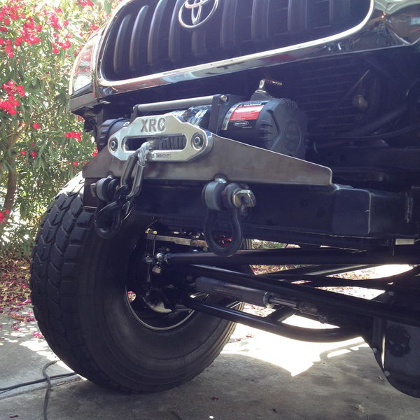

    Double steering? The front cost a pretty penny, not sure how much exactly.
    I'll link the rear after I do an interior cage. I will probably chop the frame and build new like I did with the front, cage the rear and link the back all in one project.

    Oh just the double steering arm or whatever it is, vs just being on the top of the knuckle.
    I'm sure the rear will be just as beautiful as the front :thumbsup:

    You have to run mid-steer if you want any kind of decent uptravel numbers. I'm sitting around 5.5" of up travel.
