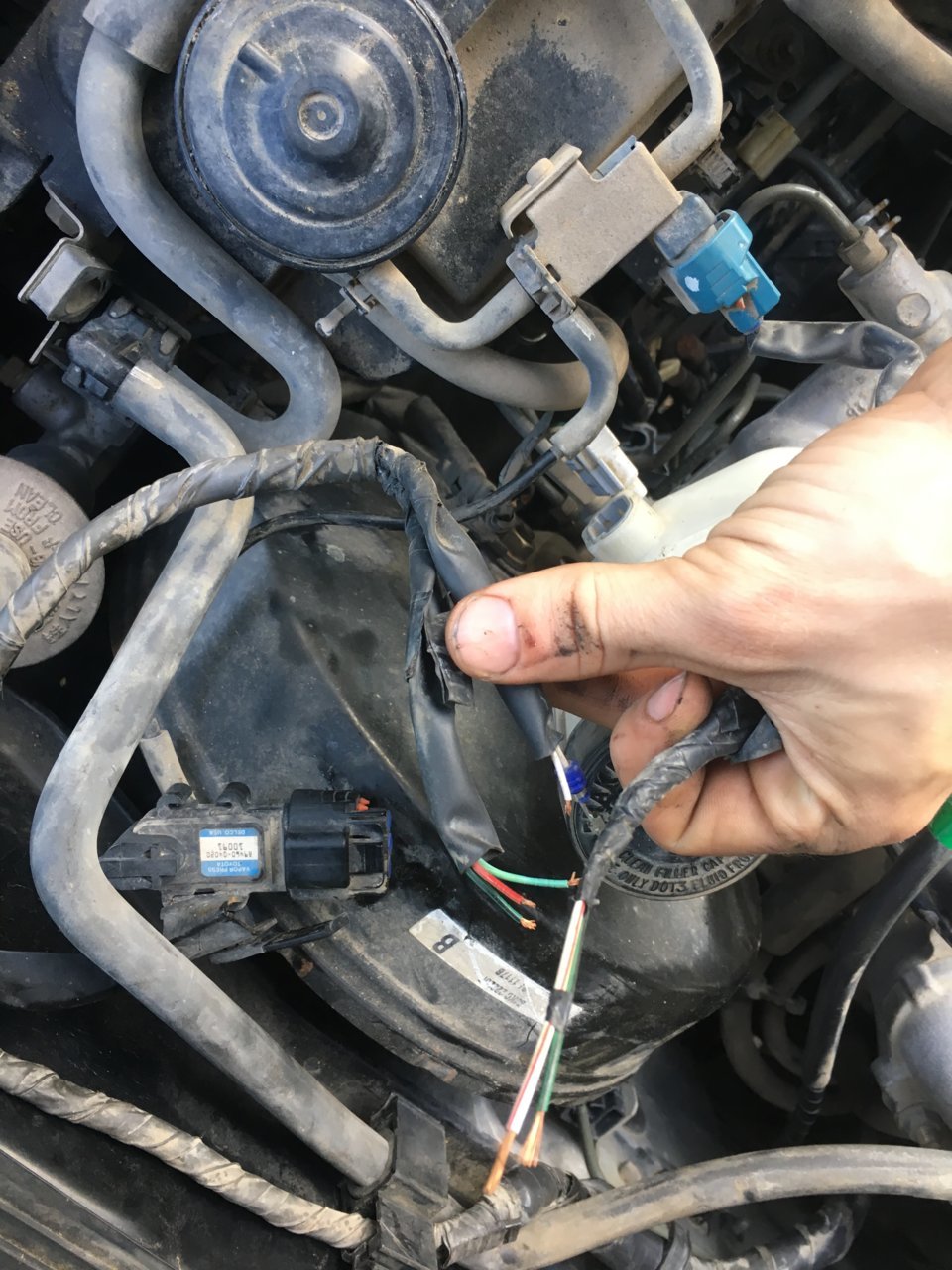

    almost forgot. I broke some connections...
    anyone know how these are supposed to hook up?

    you're gonna have to get new plugs and splice them in, i have the harnesses if u need them

    I ended up pulling some good replacements from the yard and just looked inside the ones I tore and some at the yard to try to figure out what order they needed to be in. and thankfully it worked!

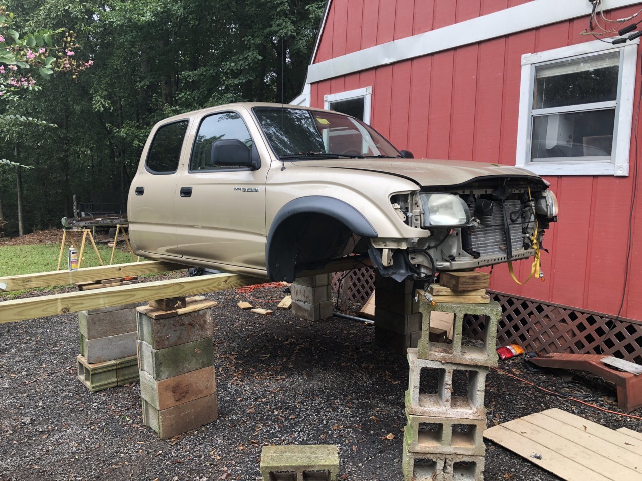

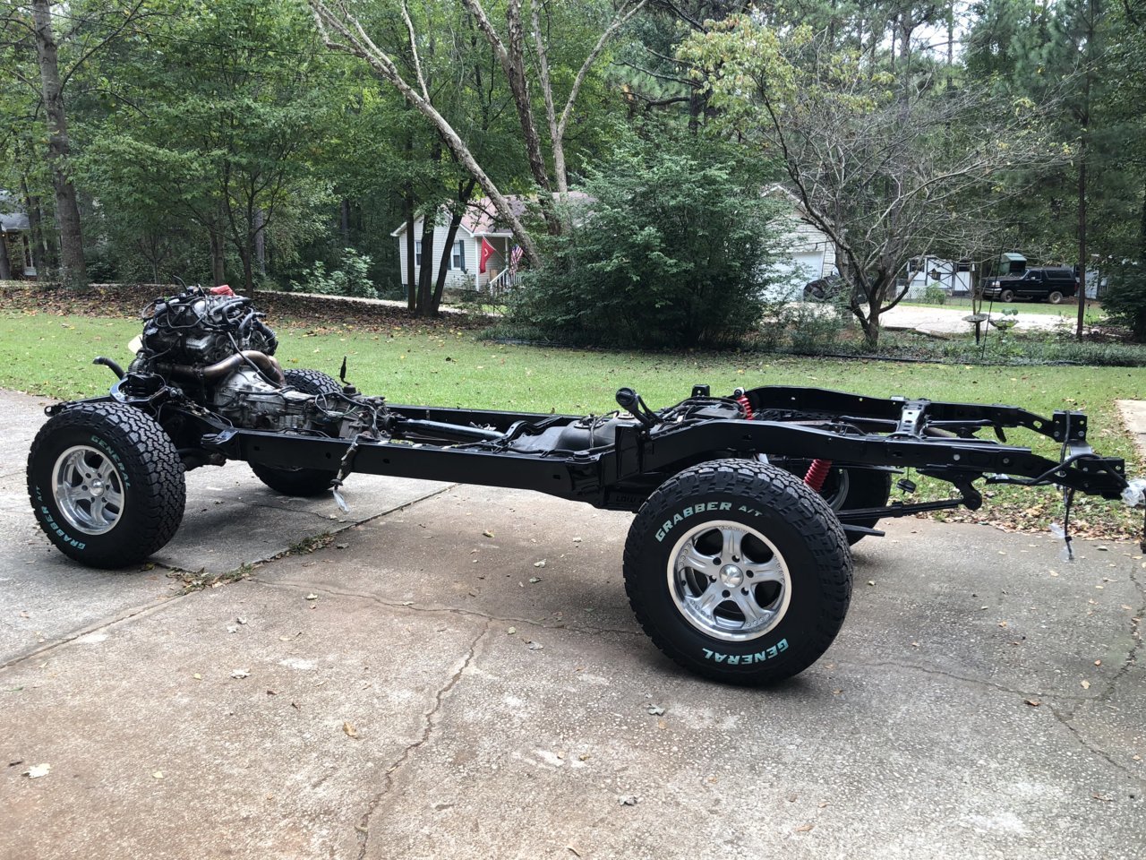

    A5AF9876-7EC4-449A-AEB7-D0F622803473.jpg 4AEA9ED4-0410-4D2D-A430-EA550C803781.jpg EA3D50E9-2C6D-4423-A4A9-4C5DFC9CF97D.jpg Just finished mine a couple of weeks ago. Pay attention to how the steering shaft fits into the rag joint.
