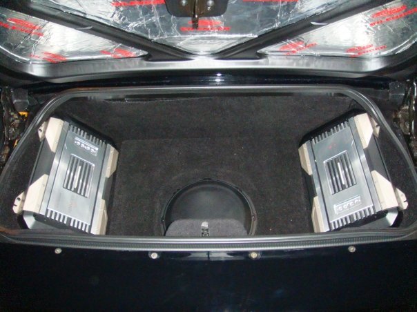

    Looks like you have a nice setup. At times I miss my Vette system with the JLW3v3 12. That car was basically a speaker box and I always had that thing turned on really low (1600W mono) except to show people what it could do.
