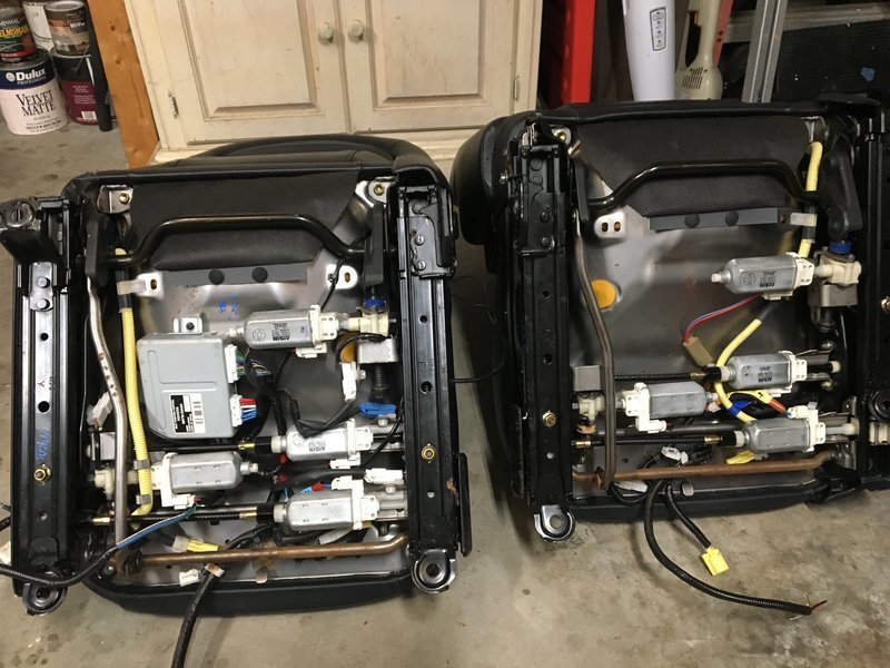

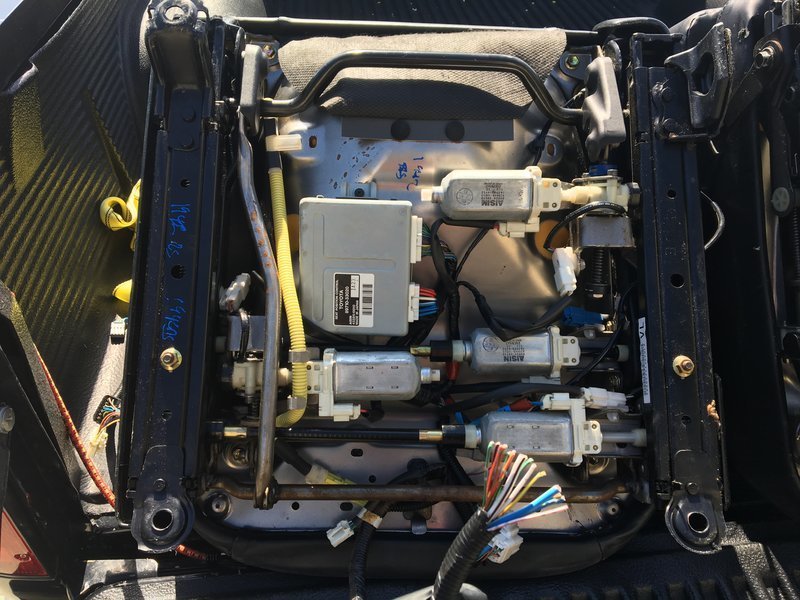

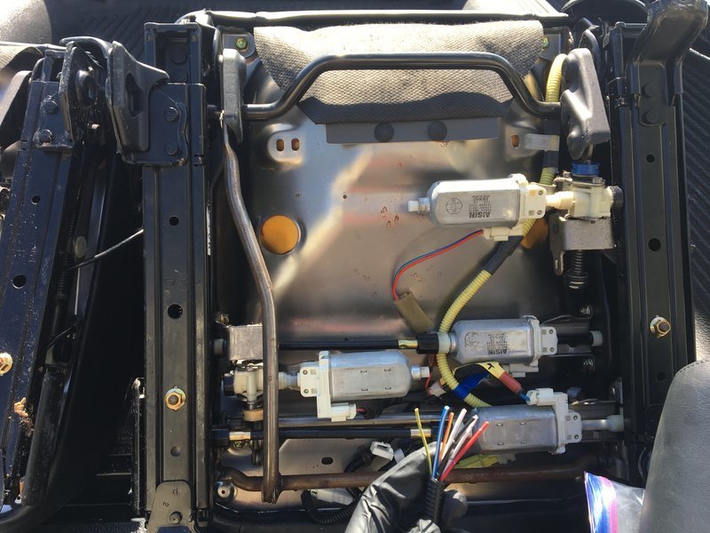

    Here are the seat bottoms with the seat control ECU, motors, sensors, and airbag components.
    The mounting system for these seats are based off the chassis of Toyota manufactured sedans (ie: Lexus ES, LS, GS & Toyota Avalon and Camry).
    I got the driver's chair hooked up last night to a battery. Most of the power functions work except for a few, it'll take some tweaking but all the basic functions are there.
    If you do this UNPLUG THE GODDAMN AIRBAG HARNESS I can't stress enough how important this step is. A lot of older luxury cars and more commonly today standard sedans, trucks, and SUV's have airbags commonly found in the seats. If you accidentally apply 12v to the wrong wires you're gonna have a bad time.
