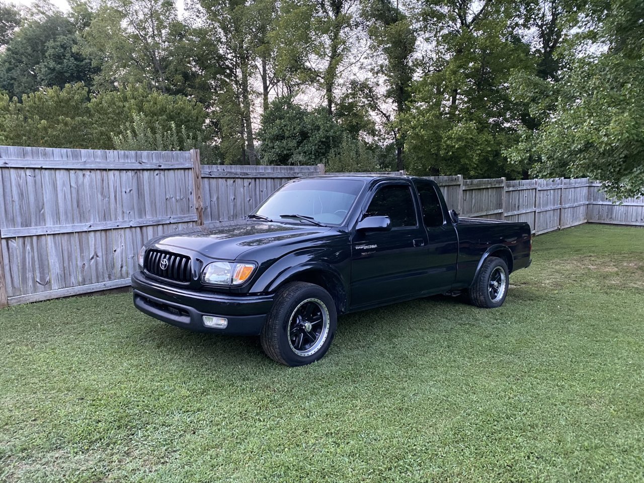

    Current truck is a 2001 Tacoma S-runner. Truck has 2"-3" lowering blocks in the rear. I am wanting to do away with them but want to keep a little of the lowered stance. I assume I can buy and add-a-leaf and shove in there to keep some drop and add some life to the factory springs. Does anyone have knowledge of this has being done? I looked around and haven't been able to find any answers. Thanks in advance!!

    why not just put in smaller blocks?
    add-a-leafs just make your ride stiffer.
    what's your plan for the front?

    Reason for wanting to add a leaf is to put some life into some factory 01 springs with "almost" 300k :eek:.
    Also plan on adding a topper as soon as I come across one so will be adding a constant weight.

    as a band-aid fix, sure that'd "work" to give you some lift, until you add all the weight, then you'd be back to what you have now. but you're talking about lifting a lowered truck, rather than just "less lowering".
    I'd still say remove some of the lift by using smaller blocks. Heck, you could probably cut them down on a bandsaw, lol... blocks tend to increase things like axle wrap, so having smaller ones (or none at all) would be better all around anyway.
    IMO, just save up for new springs. That way, you can get exactly what you need to carry the exact load you need, and they'd be designed to have the proper lift/lowering you need without bandaids like blocks or aal's...

    I got just under 3" drop in the rear by having Deaver de-arch my factory springs to my own specs. They told me they almost never replace leafs due to just age, what is wrong with yours other than the ride height?
    Do you have a drop on the front, if not maybe this is messing with your stance and giving the impression of worn rear springs? Pics would be nice of course!

    I purchased the truck the way it sets. No bj flip but it does seem to have an aftermarket coil in the front. I ordered new Moog coil spring up front (which I assume will lift the front back up) and bought kyb shocks to go around. I am thinking about doing the deaver add a leaf and take out the blocks since I am experiencing some axel wrap. Sure I will lose +/- 1” of drop but in the end I feel like it’s the most economical way to get it done.

    What wheel tire combo are you running? These hideous black AR wheels were on the truck when I bought it. I like the look of a factory wheel, clean and simple.

    Not looking to get back to stock ride height. I will be taking the rear blocks out, they are 2” or 3”, and putting in the deaver aal in (hoping this gives stiffens up the rear and hoping it puts me around where it is now or adds some north end rake). I’ll be putting the new moog coils in with new shocks to go around. As far as the front goes, there is aftermarket drop coils in there. Not sure how much drop they provided. I’m sure with the new moogs I will go up slightly in the front.
    Front shocks are blown so bounces everywhere atm, rear seems pretty soft. Hope to eventually run across a leer are are slick top to put on the back, this is one reason for the aal.

    Seeing your super sweet SRunner the front does not appear to have too much drop if any from what I can tell in the pic.
    I would start off just removing the rear blocks and see where this gets you ride wise and stance wise. This would be the most economical approach and you will learn a bit about how the truck rides and looks without the blocks.
    Then you can go on changing from there depending on how it comes out or what you would like to improve on further.
