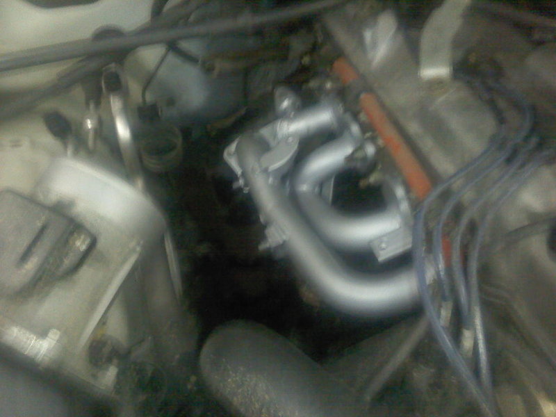

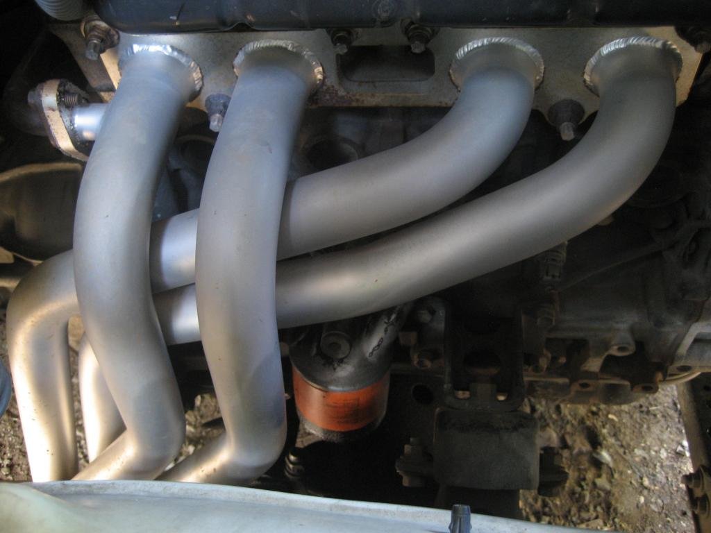

    Built for maximum low end torque, tooter II.VII intake manifold spacer, LCE long tube header, Injen long tube intake, 2,900 rpm torque peak.
    Hey vin, :)
    I like running the stock exhaust with a header, and had this LCE on my 1996 2.4 for a decade. (And by the way, that's what it looks like after 10 years. The ceramic coating held up extremely well. )
    They also make a similar header for your 2.7.
    At $399 they aren't cheap, but they are one of the very best mods you could do to your 3RZ. You could always find a cheap used stock exhaust to fit your truck, because guys are always taking them off to install aftermarket ones.
    The stock exhaust retains enough backpressure to retain the low end torque, while the header allows the engine to hit the torque peak at lower rpms.
    It's a win/win. :)
