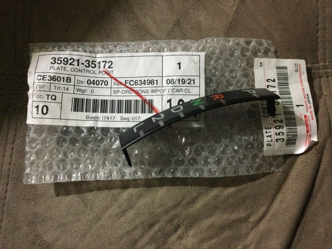

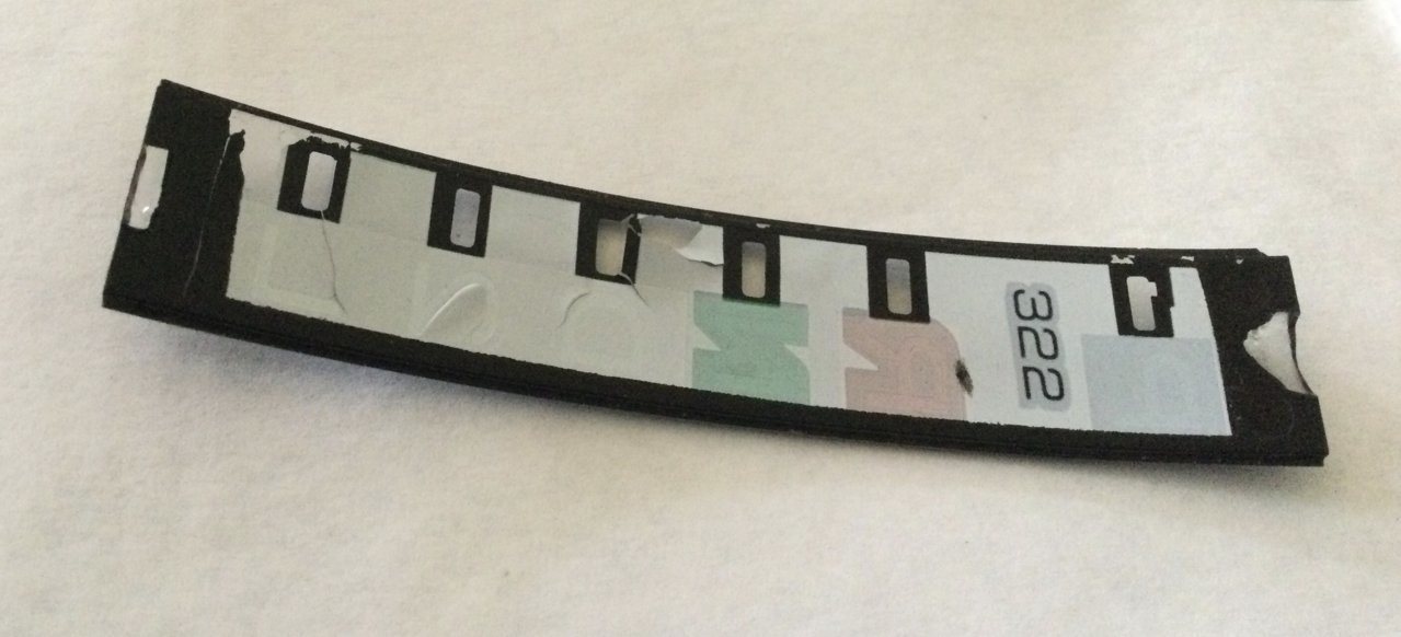

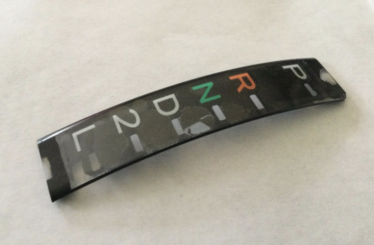

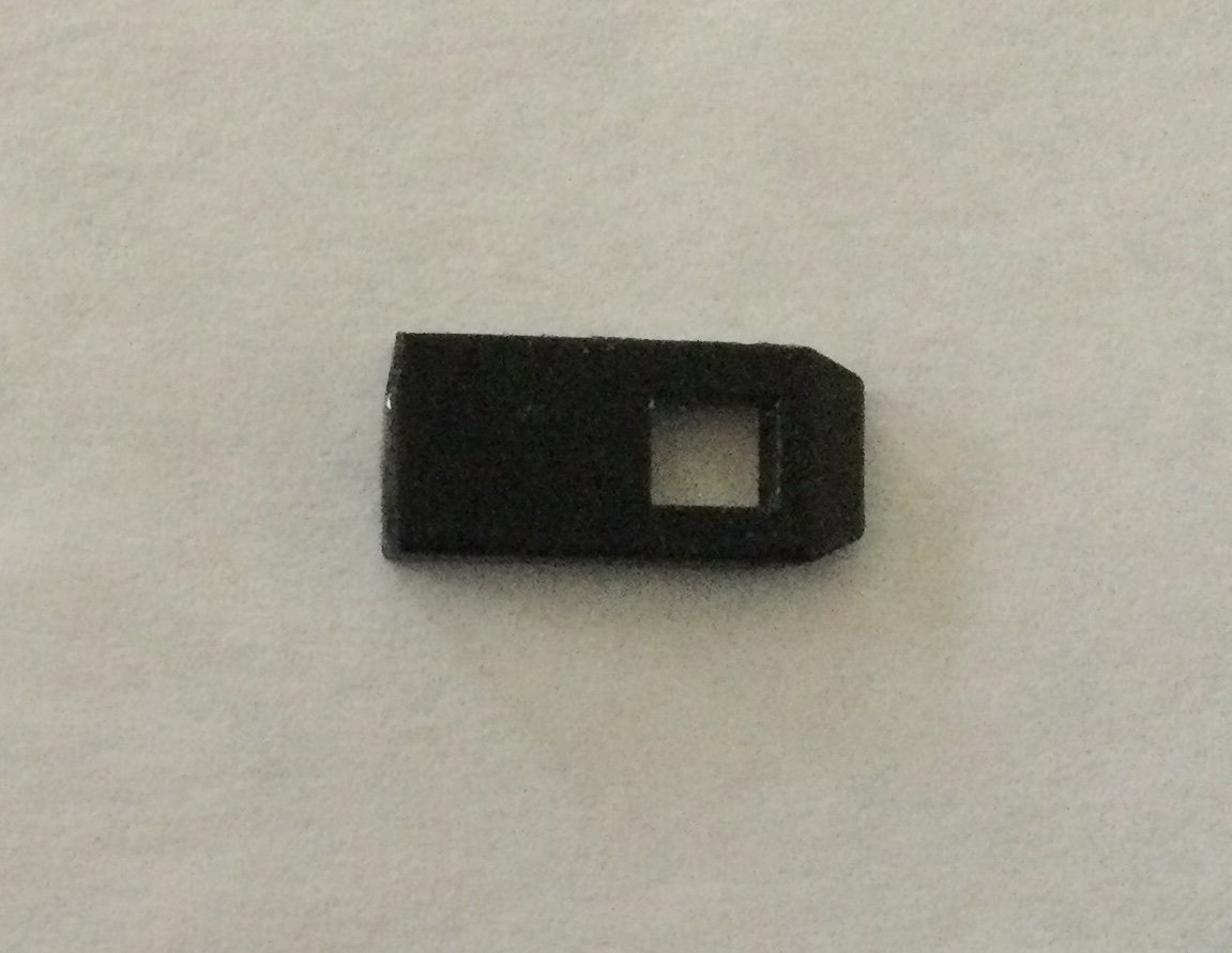

    I sacrificed mine and found there are two clips you can only get to from the bottom. Basically the top of the shift indicator (35921-35172) above the “P” and below the “L” have a squared off plastic piece that you insert into the plastic bezel around the shifter. This pushes past a plastic nub that locks it in. The letters under that are extremely brittle. Once I get the replacement I’ll add to this thread in hopes it will help others. Every dealer has different pricing. I found mine local for $44.92 plus tax.

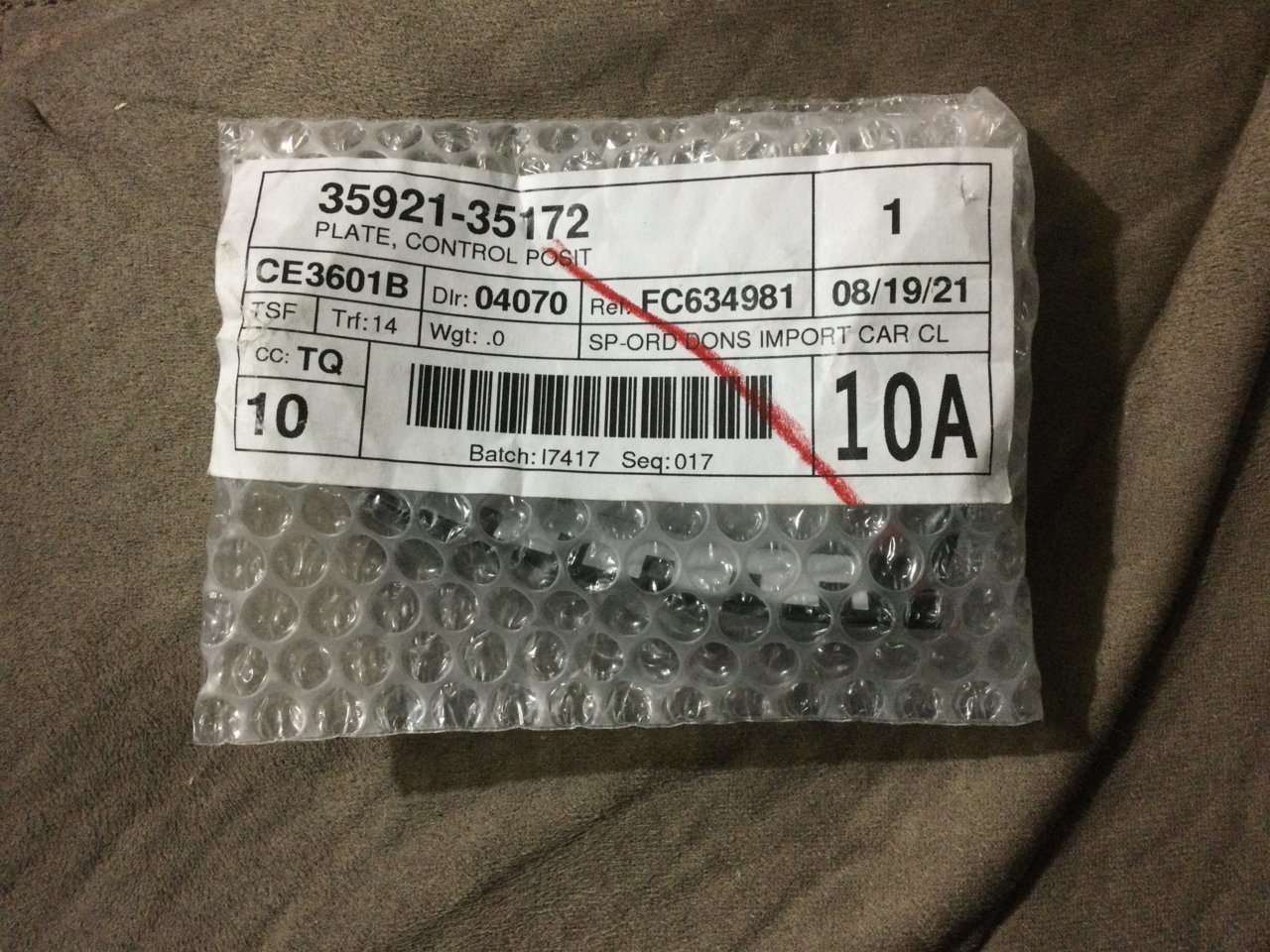

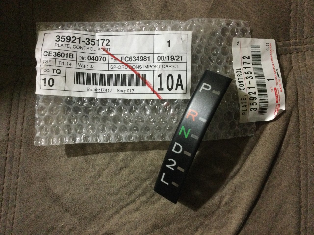

    UPDATE:
    Finally got it. See pictures. I’m sure there is some way to recreate the letters but I didn’t find anything online and I don’t have a way to do it. This just slides in and it’s locked. I hope this helps others.
