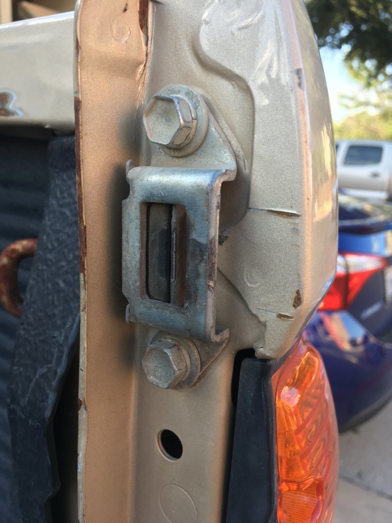

    hey @gunny1005, do you have the part number for the plastic part that spaces the the latch in the tailgate in the center?

    I'm not sure it's listed in that picture. I took a picture of my tailgate latch that is missing the piece I am talking about.
    The piece was white plastic and kept the sliding piece centered in the latch. You can see the square outline where the plastic used to be.

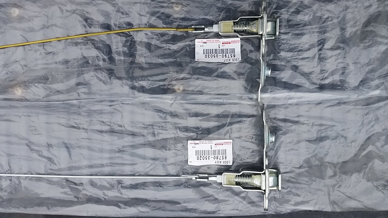

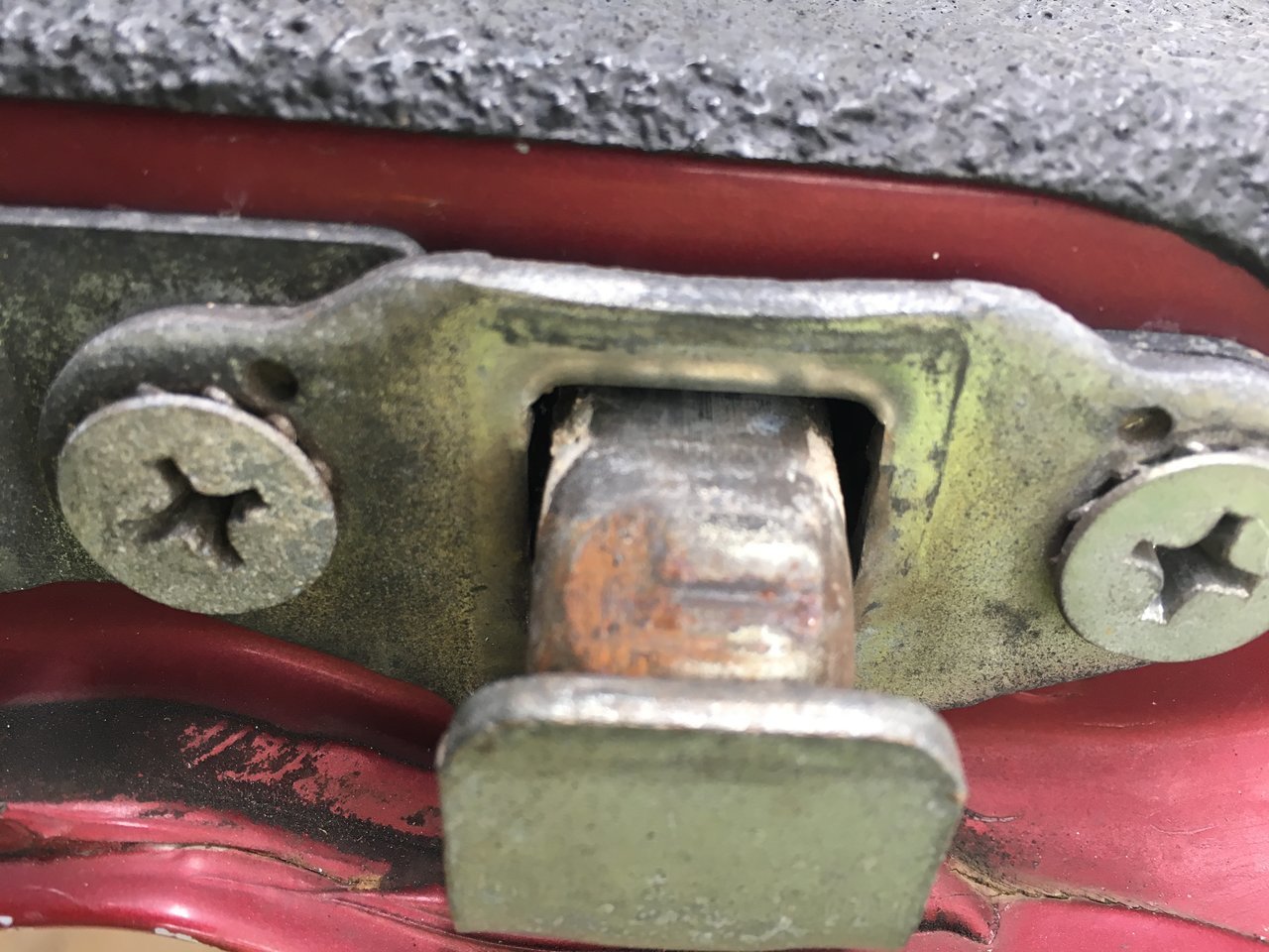

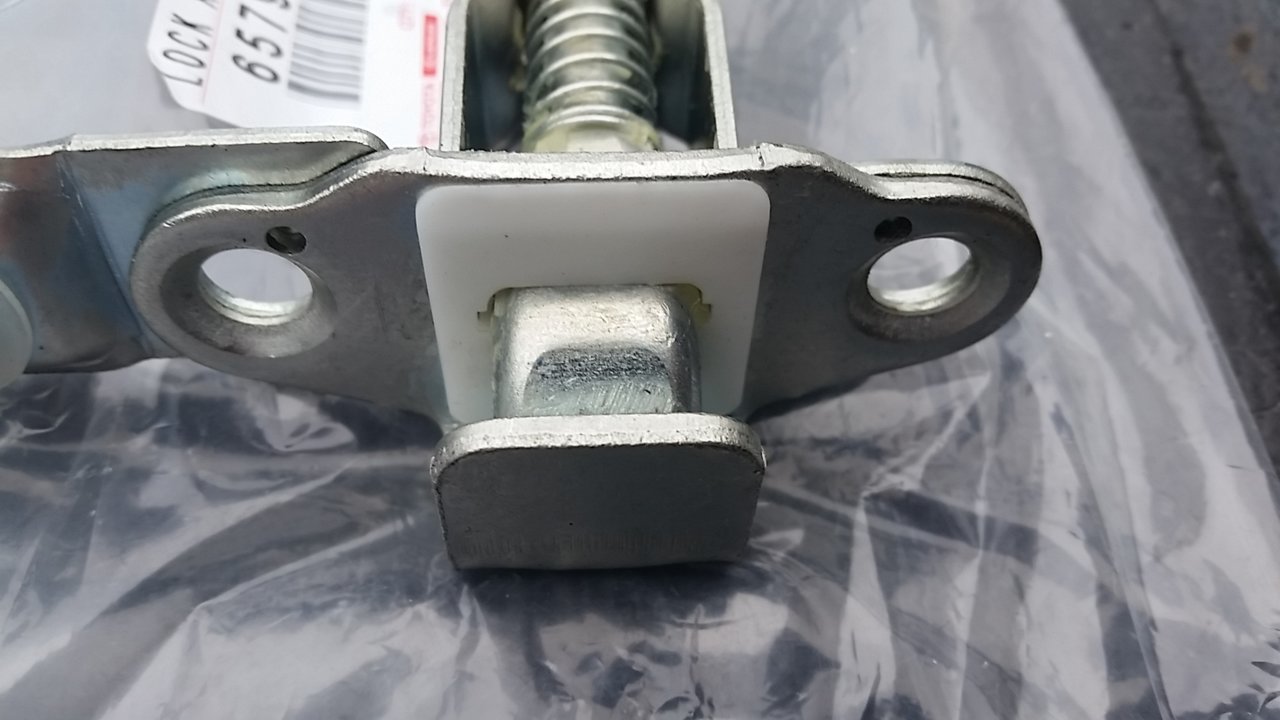

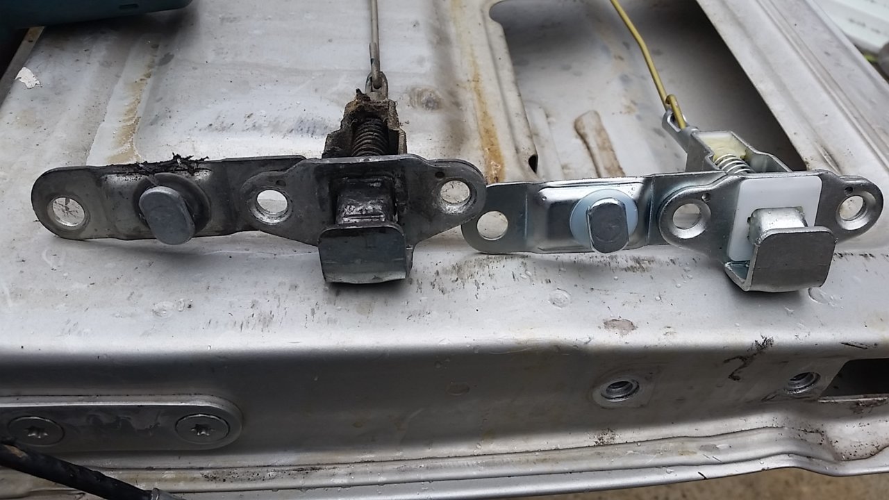

    My tailgate rocked back and forth. Even popped open a few times when I hit a bump. Rubber bumpers are fine. I could grab a latch with my fingers and rock it back and forth. I've lubricated the latches over the years and remembered a plastic bushing, but both had vaporized. Searched google images for a picture of the latch and sure enough my plastic bushings were missing. I also saw the picture in post #10 which looked exactly like my latch - missing the plastic bushing.
    Toyota is 65780-35020 right. 65790-35030 left. With Toyota the latches come with the rods attached. Best price I found was on ebay $85.45 for the pair with free shipping.
    Dorman is 38729 right. 38728 left. Best price I found was Rock for $79.37 with shipping. The rods are not included - just reuse the originals.
    I have the standard bed. When you search the Toyota parts it warns that the latches I bought are not for stepside or double cab. With Dorman it doesn't matter. My guess is that since Toyota includes the rods, the rods are different for stepside and double cab. My further guess is that it doesn't matter with Dorman because you reuse the old rods. I don't have a stepside or double cab to see if their latches are the same as my standard bed.
