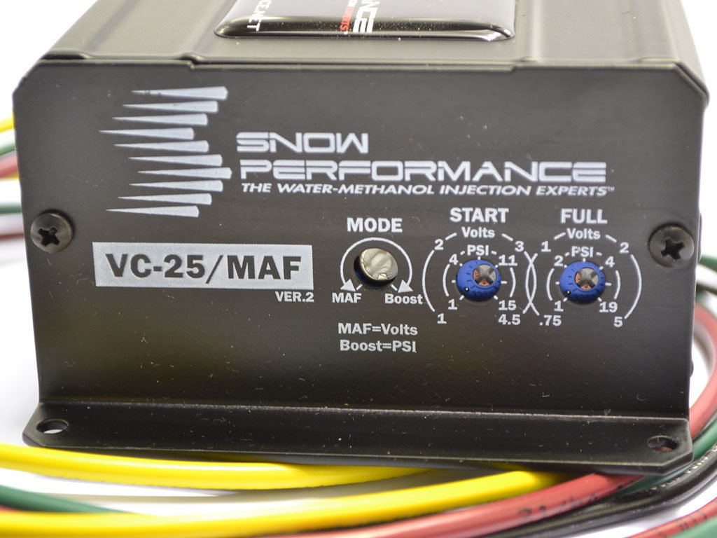

    Most kits are coming with the vc50 which is the one I have. Look at post #226.

    Ya that’s what snow performance told me, gotta go with vc50

    You won't need a boost gauge. It's all in there
