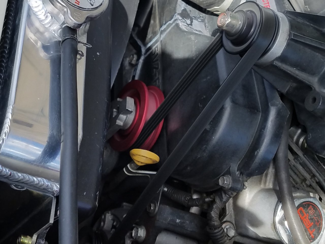

    The guy that did the dyno is a speed freak expert on turbos and superchargers.
    He uses a calculation calculator to figthe max rpms by measuring the crank and other pulleys to find out the safe rpms limit. This is what he does and has been doing for 30 years.
    So we will see :)))

    Haha or waiting for a bomb to go off,
    But seriously I’m running a 2” pulley now thats probably worn down a bunch maybe even to. 1.9” now as it’s slipping, so it’s not really that big
    of a reach for a 1.8” pulley.
    When these aluminum pulleys wear out they start to slip as the ribs get worn down
    with less belt contact

    What type of belt tensioner do you use?

    The upgraded version
    Problem with these superchargers are the belts are thin in width and with more boost higher
    chances for slipping

    Why don't you get a steel pulley made instead. Will last longer and won't slip as bad

    Yup thehighspeedlap is doing that for me, ordered it today

    He has made steel ones for me before

    Custom pulley is like 150.00 or so
