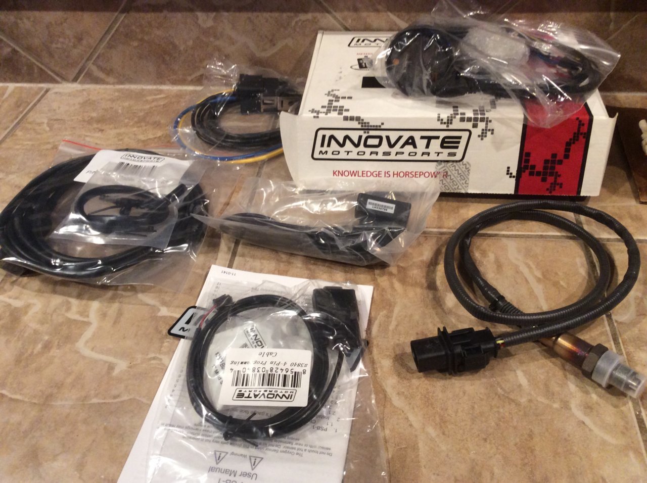

    Failsafe AFR / BOOST gauge arrived. Buying it was the easy part.
    Now to get it installed.
    I’m pretty excited about this failsafe function on this guage with the methonal kit
    because if the methonal nozzle is clogged or ran empty or the pump not putting out
    enough pressure or some other issue the gauge will actually cut the boost from the supercharger so
    your engine will never be in danger of running lean or to rich. This type failsafe guage is probably
    a must have if running a methonal kit or a supercharger with ping issues for engine protection.

    How does boost cut work on a s/c? Does it force open the actuator on the back for the blower? Also, do you have to drill out and weld in a new bung for the O2 sensor or does it replace the stock pre cat sensor?
    1997tacomav6[OP] likes this.

    Would have to be added in addition. Can't replace the stock o2 with it.
    In theory yes it would open the bypass valve. How..I'm not sure.
  6. Feb 3, 2019 at 6:05 AM

    You have to weld the bung in, not sure yet on the boost but it looks like there this a control valve
    that goes inline to the bypass valve, so I guessing the guage control valve controls the bypass valve.
    Just got it so will see

    That only has one port on it it looks like. That's likely the boost sensor

    I was curious about the O2 sensor b/c I know with the PLX AFR you can replace the stock sensor and wire the aftermarket sensor to the stock ecu so it reads it as a narrow band signal at the same time at sending a wideband signal to the Gauge.
    I guess I was just curious if Innovate had the same feature

    I bought the wrong model.
    Should have been the SCG-1: Solenoid Boost Controller & Wideband O2 Gauge
    NOT the PSB-1
    Grrrr
