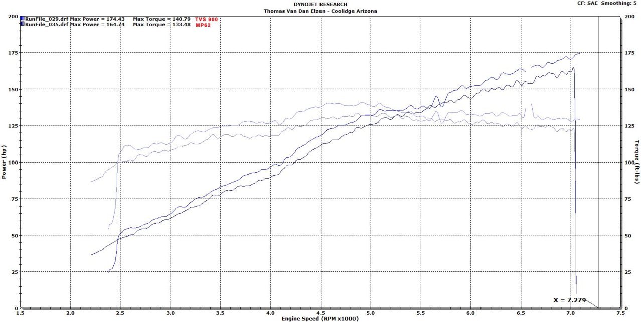

    Thought you might be interested to see this.
    The new TVS rotors are very similar to a twin screw system in that they don’t make heat like a roots does. Despite that fact the mp62 actually has a better curve than a TVS for what we want. More HP and more TQ where you want it. It only makes more power above 5500 RPM. I’d much rather have the MP62 seeing this.
    Considering all the hate that the roots gets, especially from Ken Bell and Whipple, it doesnt do half bad. Interesting. I guess TRD really do a pretty good job. However I’d really like to know how a MP90 would do fitted to the 3.4.
    Maybe one day someone will do that to compare it. I’d really be interested to see what would happen. You’d think that the higher CFM and cooler charge would help. But the question is how much. Doing all the calculations is one thing but a real world comparison is the only way to really know.
    Here’s the link from, god forbid, a Miata forum. Neither one was aftercooled.
    http://www.fastforwardsuperchargers.com/forum/forum/miata-performance/tvs-900/2707-tvs-900-vs-mp62
    boostedka and 1997tacomav6[OP] like this.

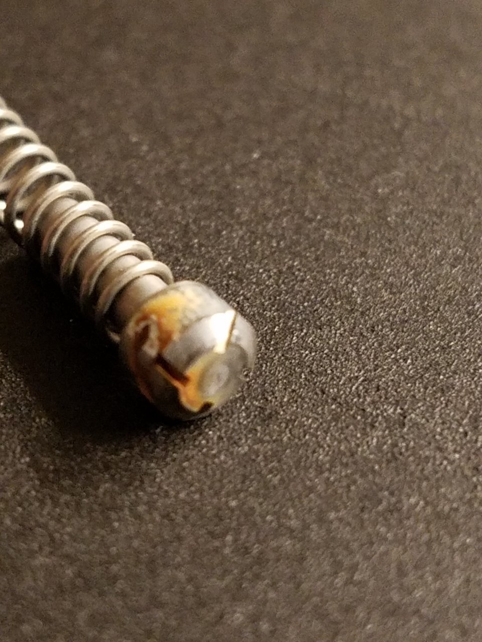

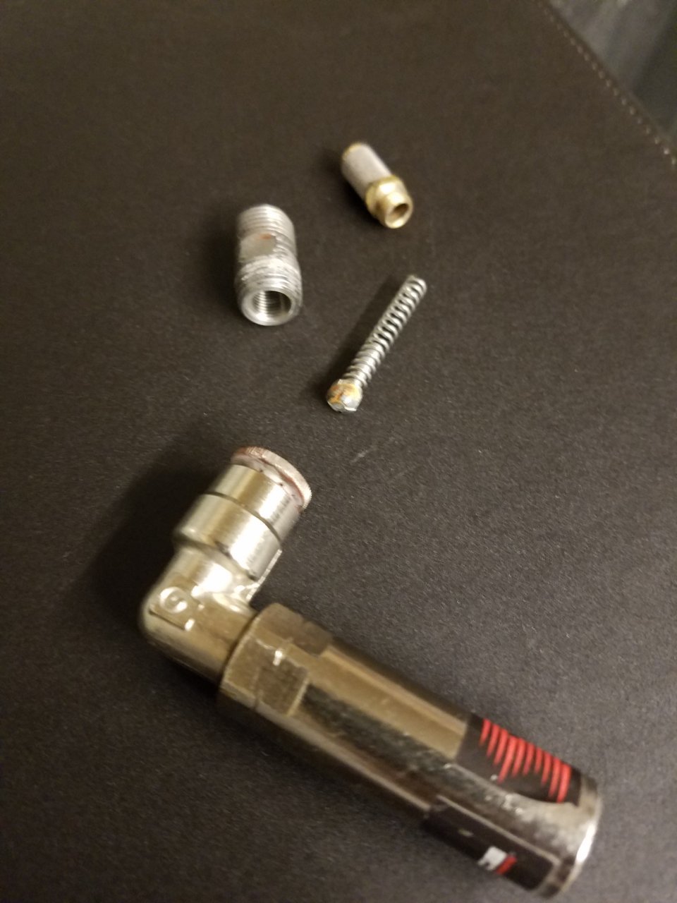

    I decided to check my nozzle since I have probably have 15k miles too or so.
    You have to take the nozzle apart.
    The screen was clean and the nozzle hole was clean,
    But the rotating plunger inside the nozzle had a bunch of gummy dirt
    Took a brass wire brush and cleaned the gunk off and back together.
    That’s why I would inspect it every 15k miles even if everything is working fine.

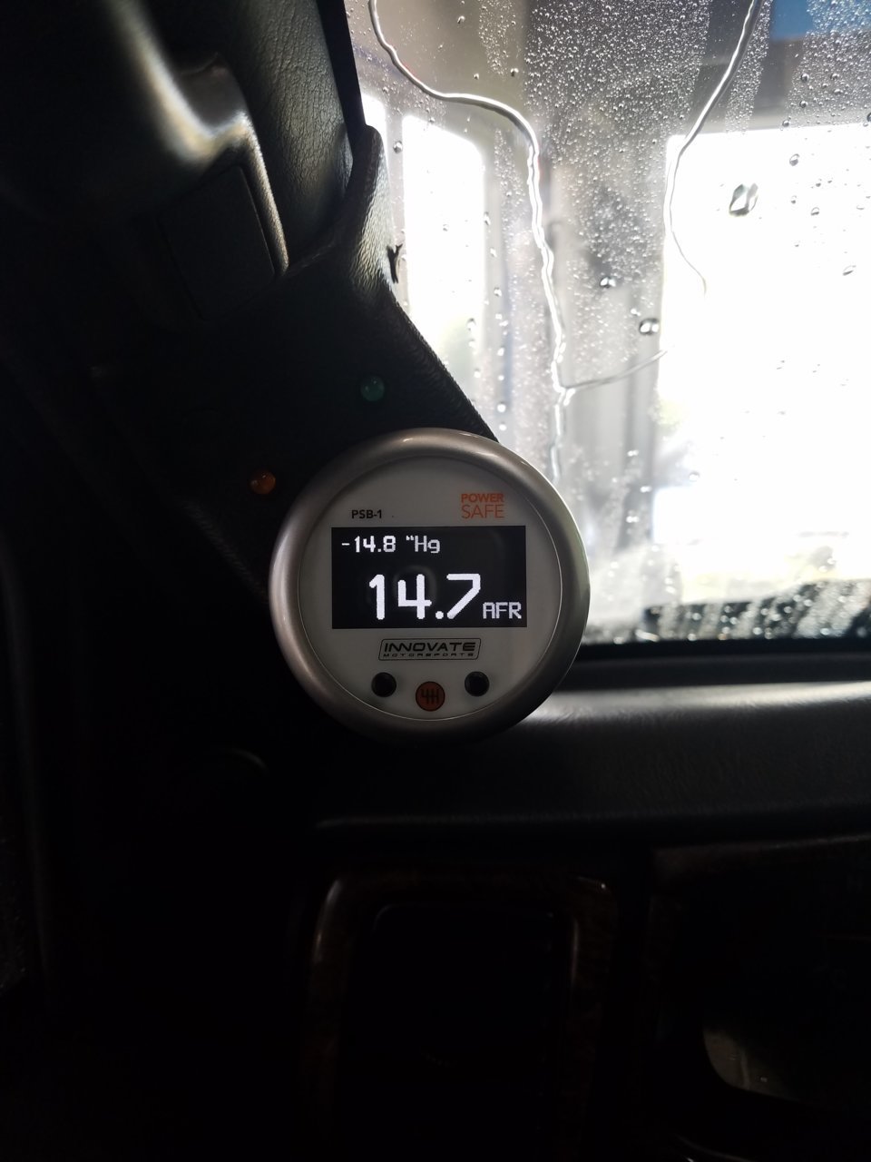

    Finally got the combo boost gauge + AFR innovate psb-1 Gauge installed.
    Apparently the failsafe option doesn’t work on the TRD type superchargers, but that’s ok.
    It’s nice to have the combo info on tap in one gauge and being able to toggle the lead gauge info and have the secondary info on tap.
