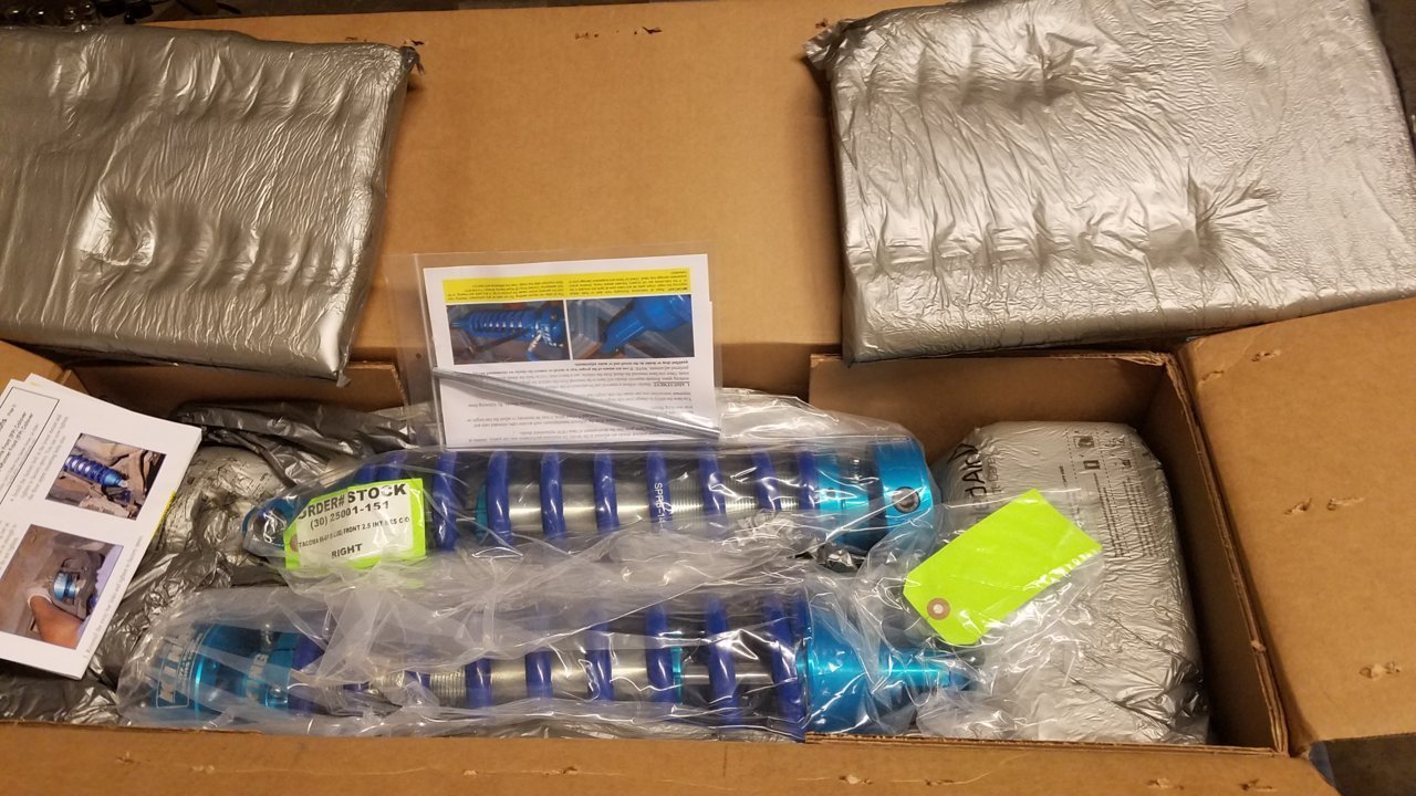

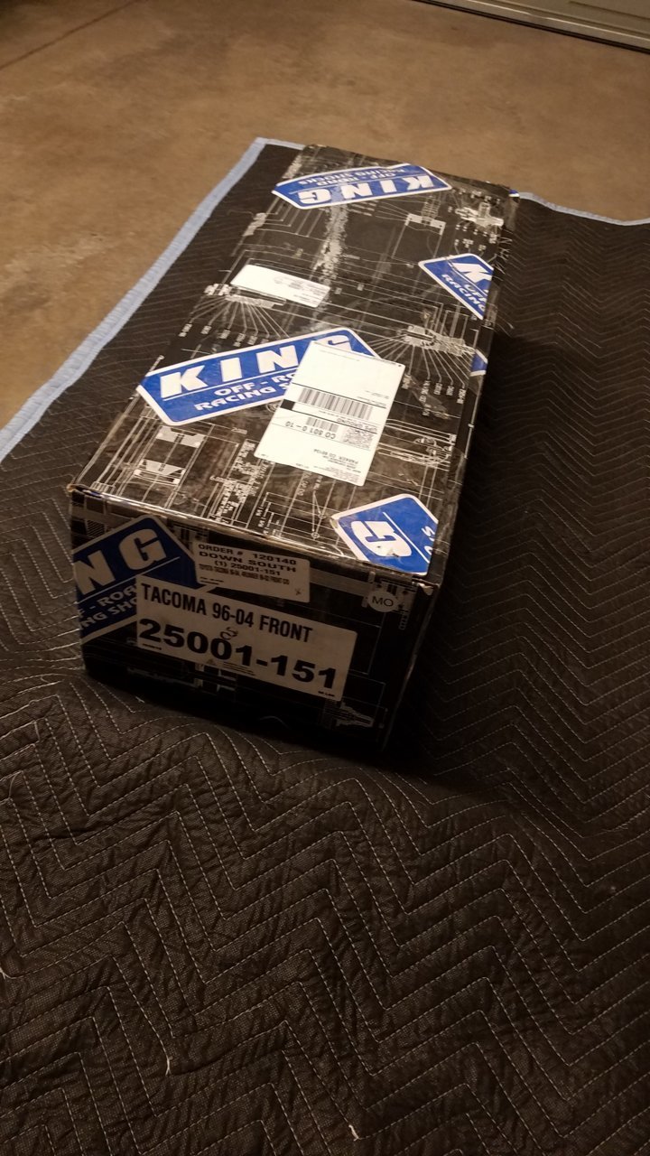

    Finally after all these years I sprung for a set of kings.

    So I have the Kings up front and I got Bilstien 5100s for the back.
    The Kings a pretty dam nice compared to what I’ve been used too,
    (Monroe Quick struts, Bilstiens yellow struts and trd coils)
    The Kings eat up the poles holes and wash boards extremely well now.
    Before I always would be nervous hitting poles holes or road damage because
    it would be so jarring and sometimes scary depending on the road damage making the truck jump and not planted.
    The Kings are a game changer. They eat up theses road issues fantastically.
    Washboards and road damage and poles are NOT a problem anymore.
    Steering wheel doesn’t try jumping out of your hands too when hitting these conditions.
    Truck feels really well planted all the time and even going around a corner with speed
    the truck doesn’t dip or tilt or lean as much.
    It did end up raising the front end 1.5” even at the lowest setting but my helper springs I have give a rake to the truck.
    So the trucks pretty much level now, maybe just a hair lower in the back.
    Also the cool option is they are adjustable so the drivers side strut is cranked up
    1 1/2 turns higher than the passenger side and now there’s NO TACO LEAN anymore.
    I ended putting the 600 pound springs on. I think they have made the truck more stiff tho.
    So my ride is definitely not a Cadillac ride especially tied with helper springs in the rear
    for the trailer.
    Possibly I should have gone with the 550 pounds springs because I have a regular cab.
    You can push down on any corner of the truck and it moves very little now and
    comes back to the original height immediately,
    No rocking or boat like bouncing
    My truck will always be a bit stiff but that’s ok.
    Overall very very happy.
