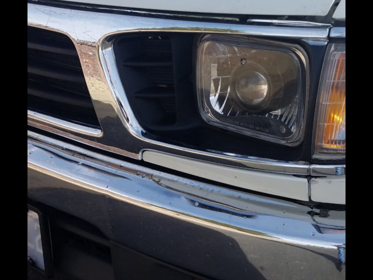

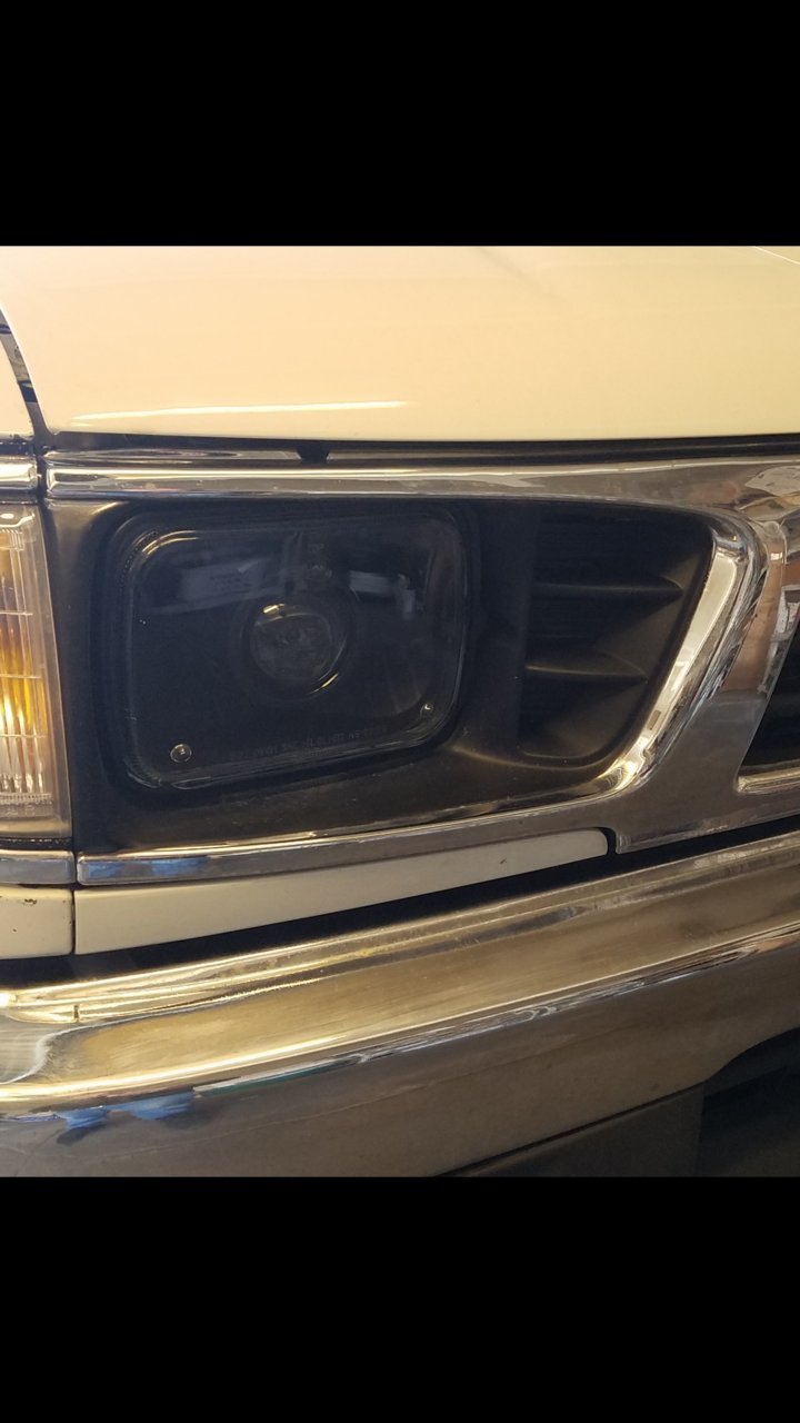

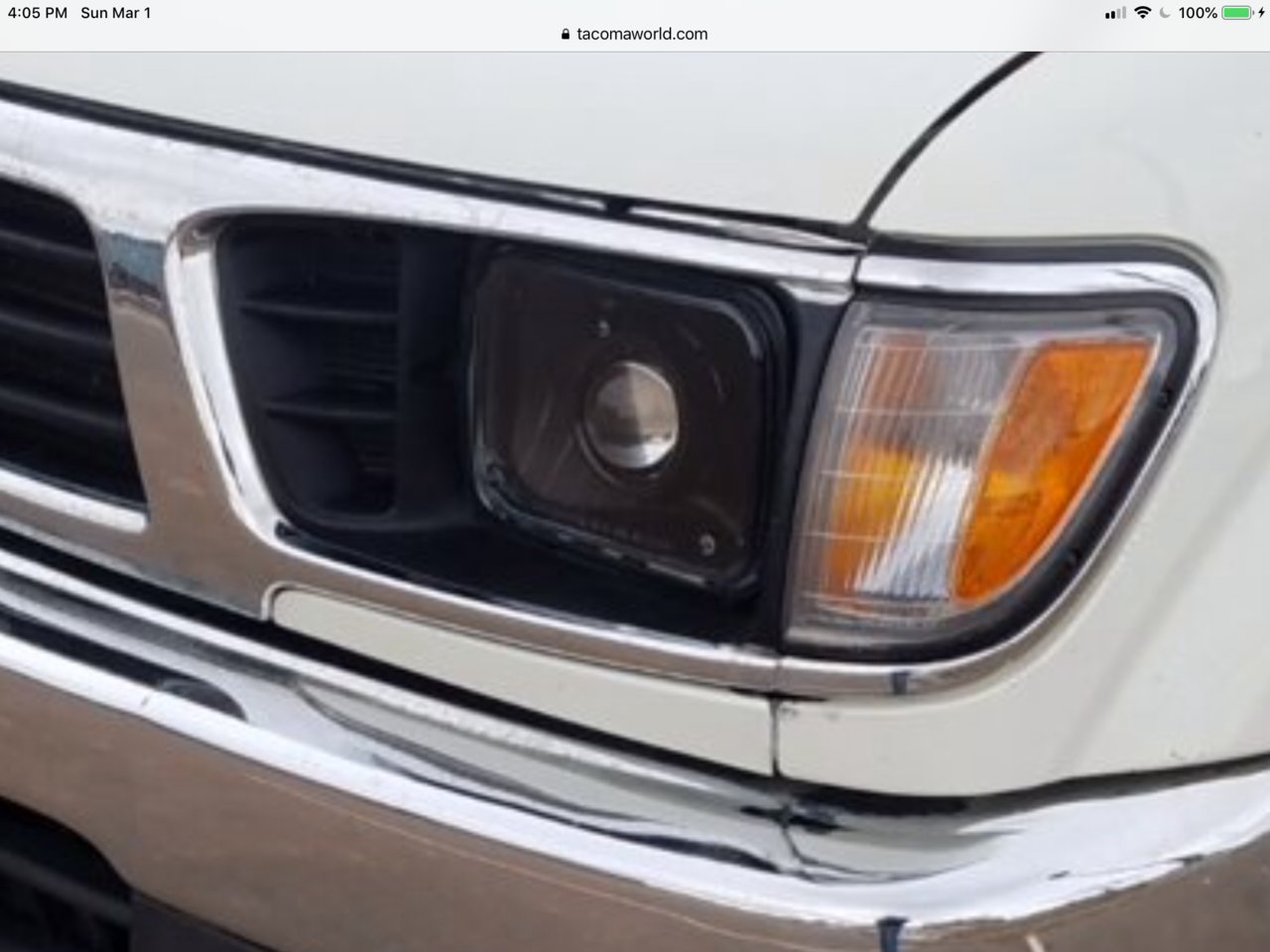

    Painted the inside headlight reflectors and the chrome bezel piece today to coverup the chrome with flat black paint.
    Looks much better
    Before and after

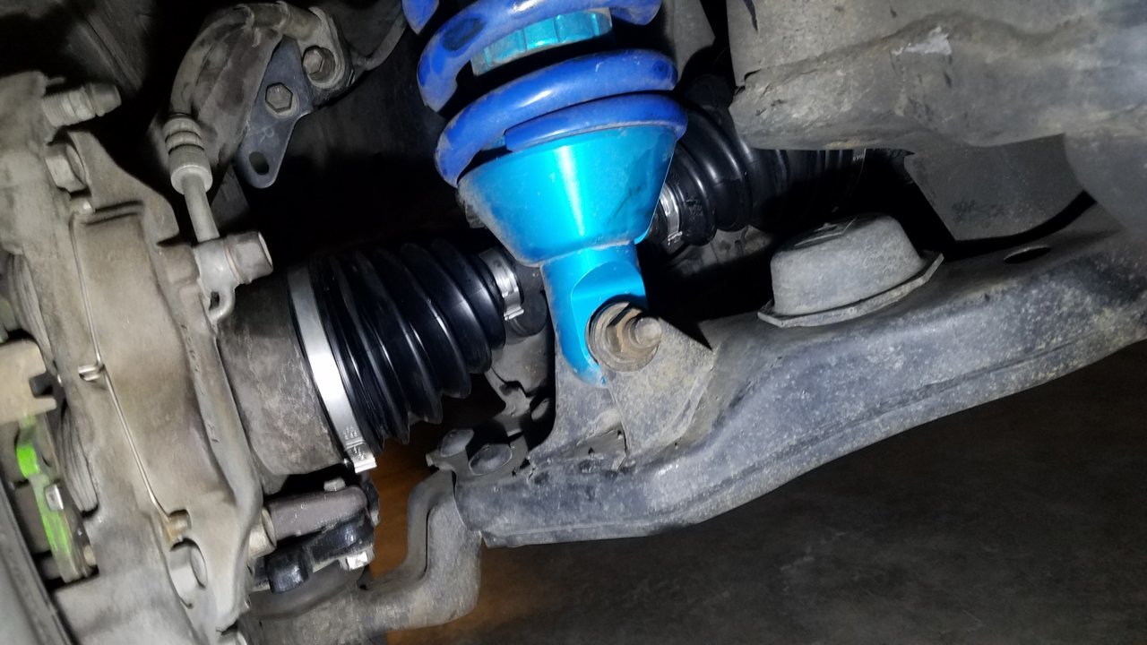

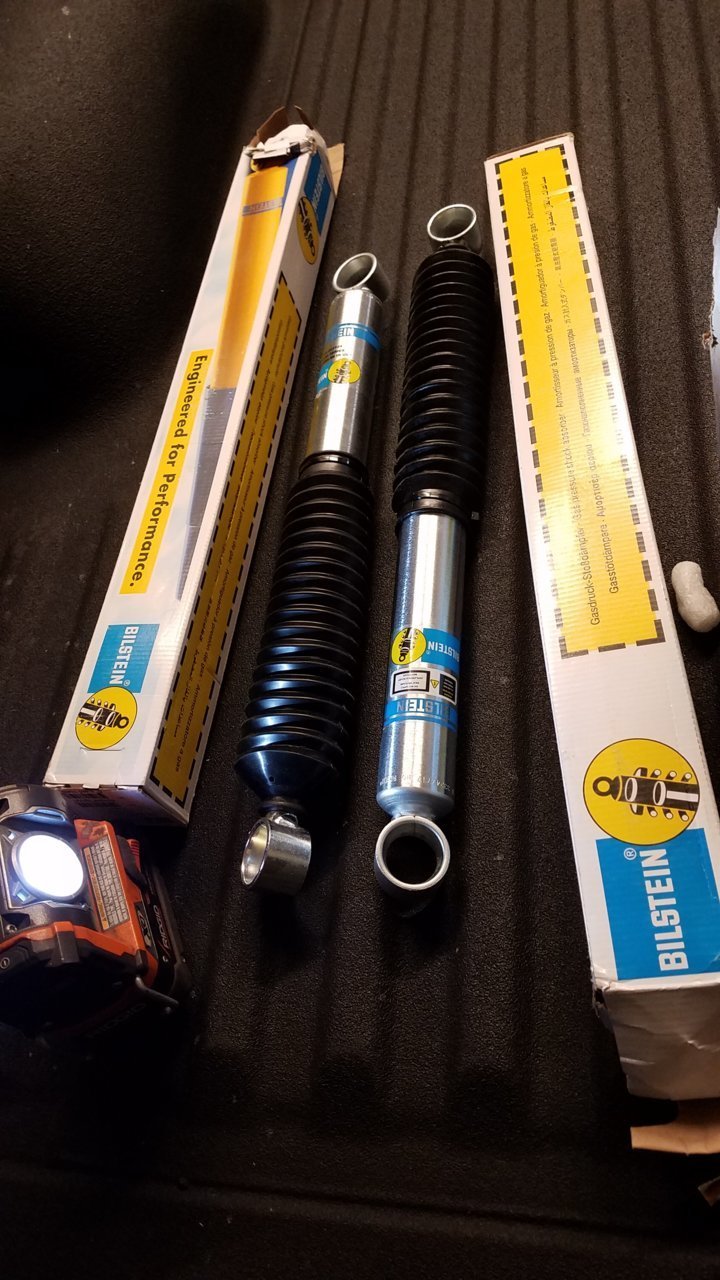

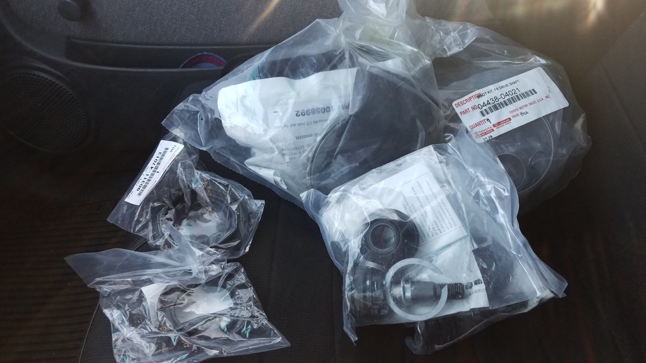

    At 620,000
    New rear 5100 Bilstiens
    New boots for the front half shafts
    New upper ball joints shocks

    boots look crisp & clean, were there any noticeable tears in the old ones?
    was it the first time you ever changed them?
  10. Mar 4, 2020 at 5:47 AM
    #410
    1997tacomav6
    1997tacomav6 [OP] V6 5sp,RegCab,TVS1320 Supercharger,Haltech, 800k
    Oct 5, 2013
    #113940
    10,393
    John
    Denver
    97 reg cab, v6 5sp 300hp supercharged, Methonal Injection, 800,001 plus miles, Original Owner
    V6 5sp,RegCab,TVS1320 Supercharger, 56mm pulley, methanol injected Haltech ECU, AC Tvs1320 supercharger,(MUST DO) every 125,000- 150,000 needs rebuild Projector headlights HID 5 speed manual Amsoil for all drive train Smaller 56mm custom pulley, (MUST DO) 2004 DESNO fuel injectors, zero ping ping, 2004 side door mirrors Dick Cepek Rims, Michelin tires LTX, ATM Pathfinders Dynopro ATM ( that last 100,000 miles) Now running Dynopro ATM mud and snow tires KN cold air intake Cat back dual exhaust with ss exhaust tip, Raised exhaust tail pipe to 2" below body line Optima*dry cell battery,red top Alpine sirius radio, 200 watt amp, focal is165 split door pod speakers Focal door speakers Subwoffer behind seat Viper alarm, Electric Locks Dark tinted windows, bucket seats corbeau lg1 Tacoma Rubber floor mats TRD fender extenders, Bilstien shocks, King shocks JBA UCA trailer iv hitch, electric brake control, Drilled slotted brakes, High carbon steel (MUST DO) EBS green stuff 7000 series pads(MUST DO) TRD engine oil cap TRD stick shift, Marlin crawl shift kit. Rear sliding window 2002 4Runner functional hood scoop cut into Tacoma hood, 4Runner dual overhead map light Gentex Auto dim + Compass + Temp, garage,rearview mirror Snow Methonal kit stage 2 Custom 3 core aluminum radiator Linex bed liner Haltech stand alone ECU, Intake supercharger gauge. Stainless steel brake lines, Custom leather wrapped steering wheel, Haltech stand-alone ECU,
    There were lots of spider type cracks from age, no tears tho on the old set.
    This is the 2nd time I’ve replaced the boots in 620,000 miles
    and upper ball joints 1st time.

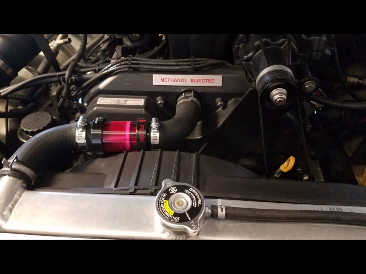

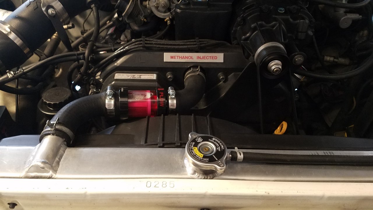

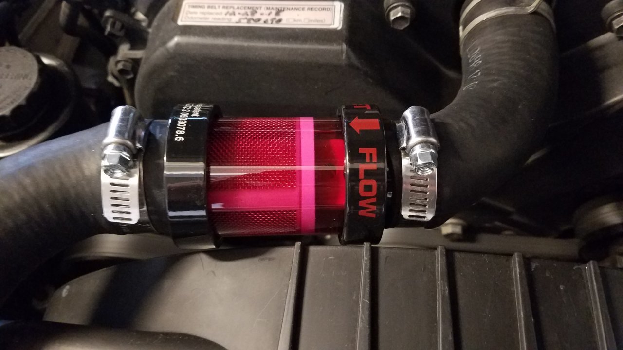

    Added this in-line radiator filter.
    Has a thick glass lens for inspecting.
    Now you can see if your coolant is low.
    If you have air in your system
    If their is an exhaust leak in your system
    If their is oil in your system from head gasket
    If your low on coolant
    If your system is dirty
    A screen that will caught dirt from the cast iron block

    That’s cool! Love it!

    That’s sweet, got a part number?
