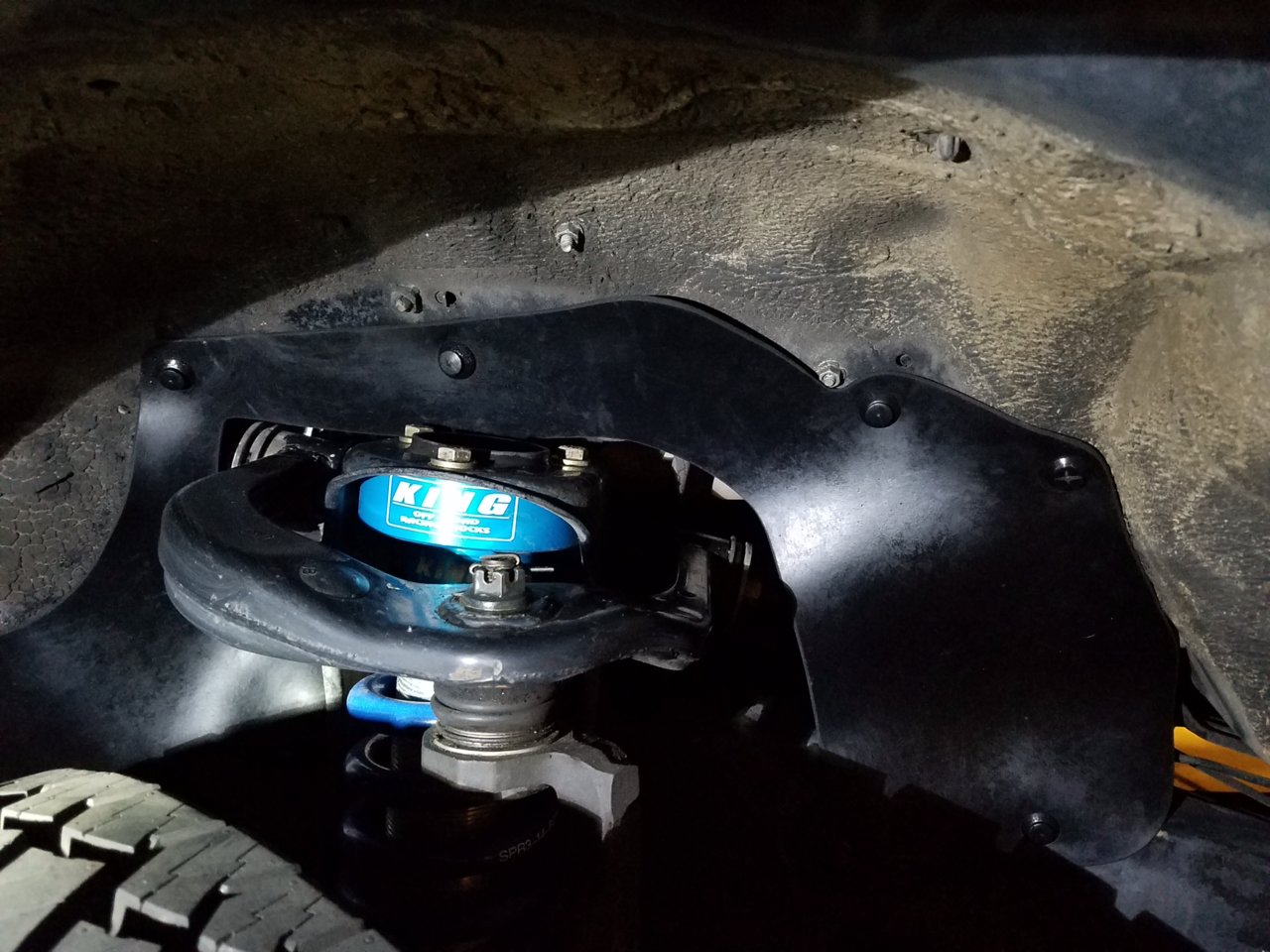

    Got my gear tech fender splash shields on, they fit pretty well and they are probably 5 times thicker than the stock shields.
    Down side is these take at least a month to receive after your order, I think the seller waits for a batch before getting them made and are not in stock.
    Otherwise great product.

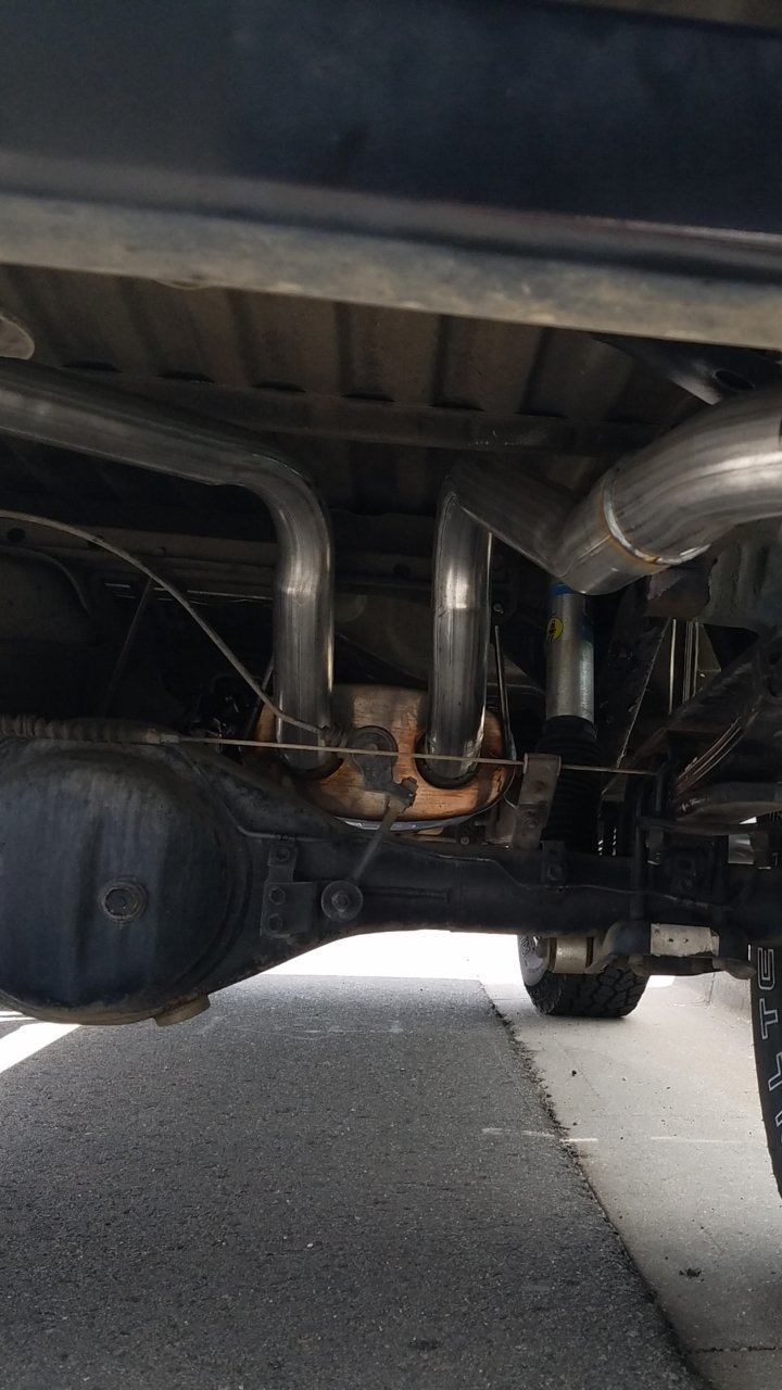

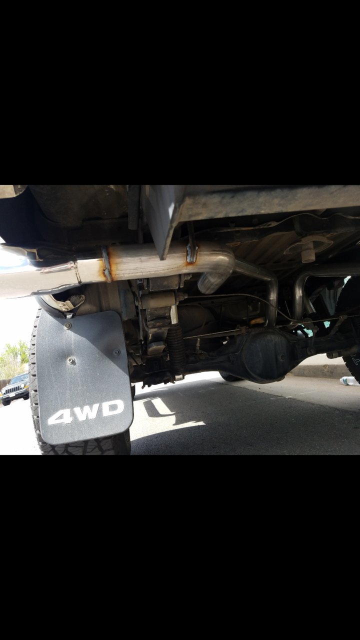

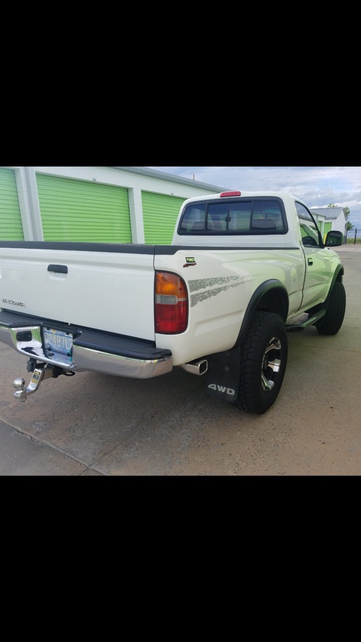

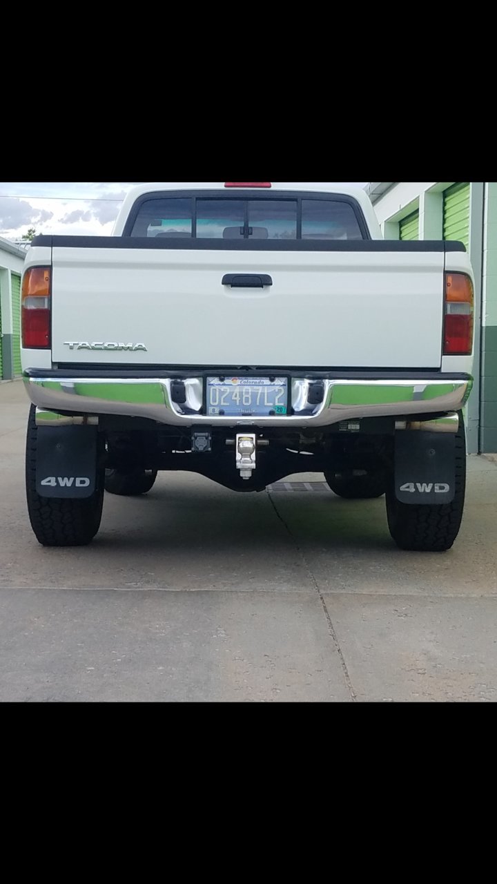

    Always wanted a set of dual exhaust pipes,
  9. May 27, 2020 at 10:42 PM
    #449
    Empty_Lord
    Empty_Lord Toyotaholic
    Mar 13, 2016
    #181186
    28,297
    Dan
    Northwest Indiana/Chicagoland
    that has to be the first dual exhaust ive seen on a 1st gen that looks good!

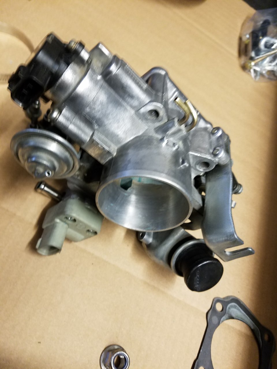

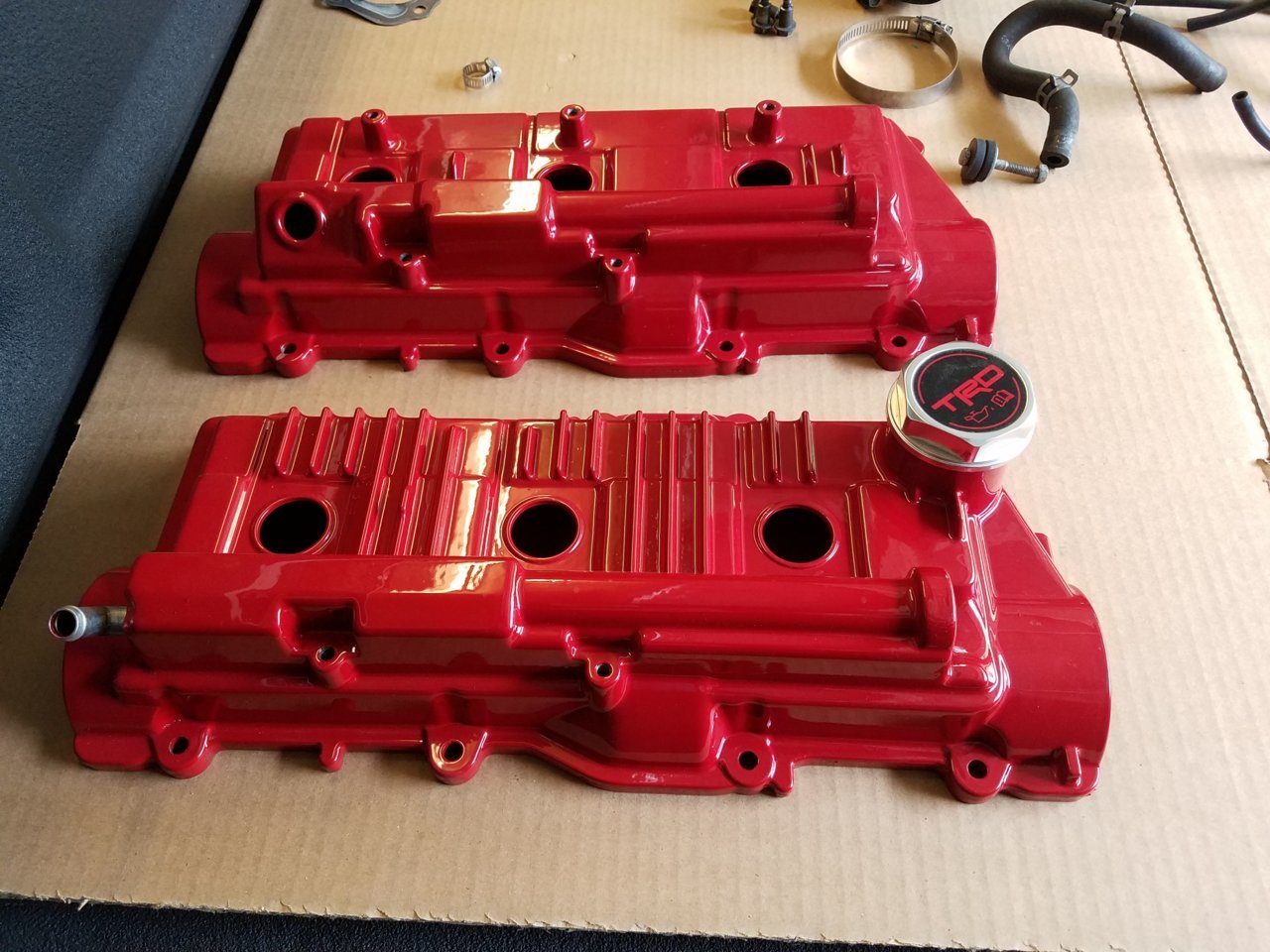

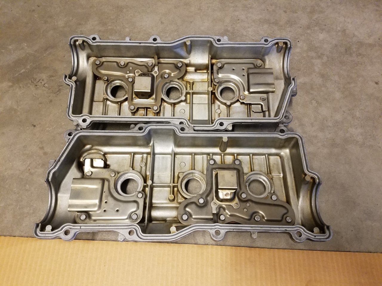

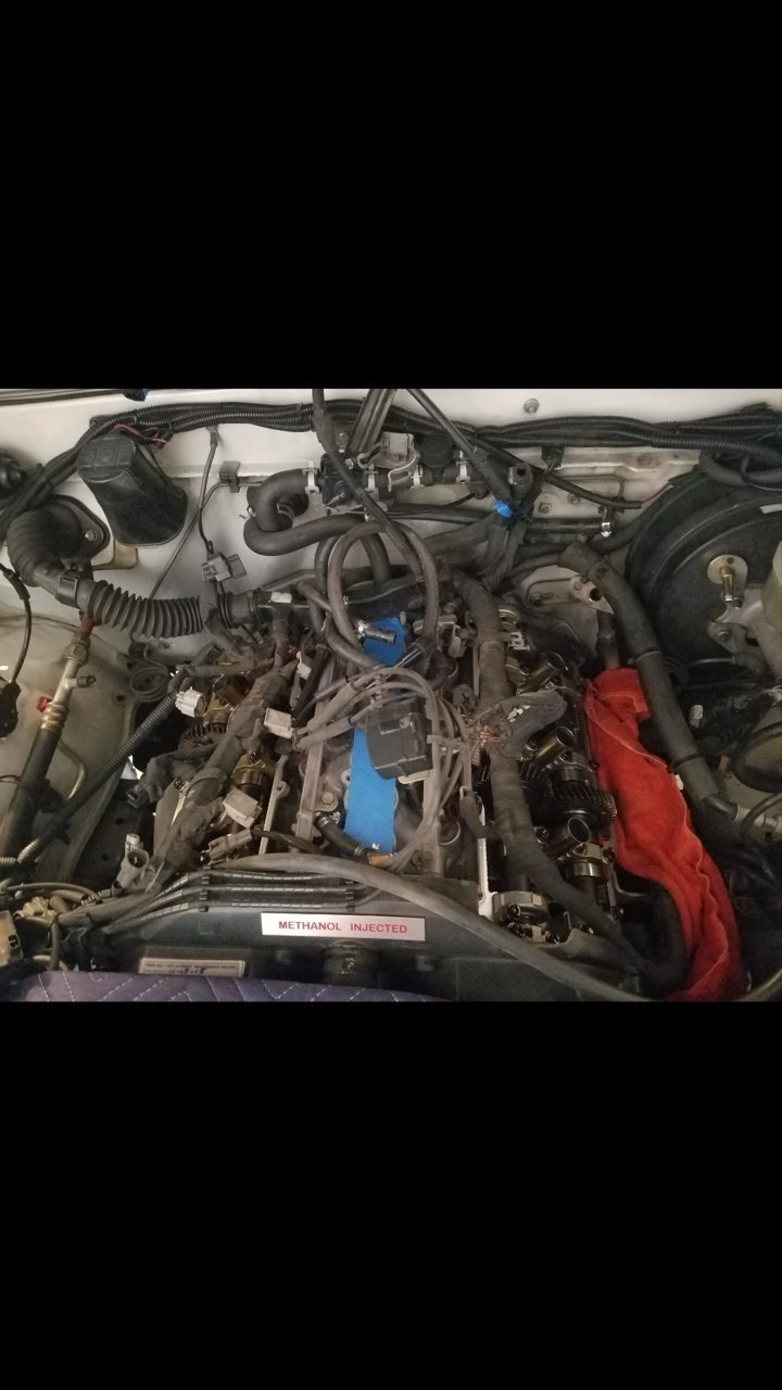

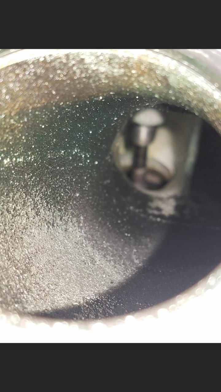

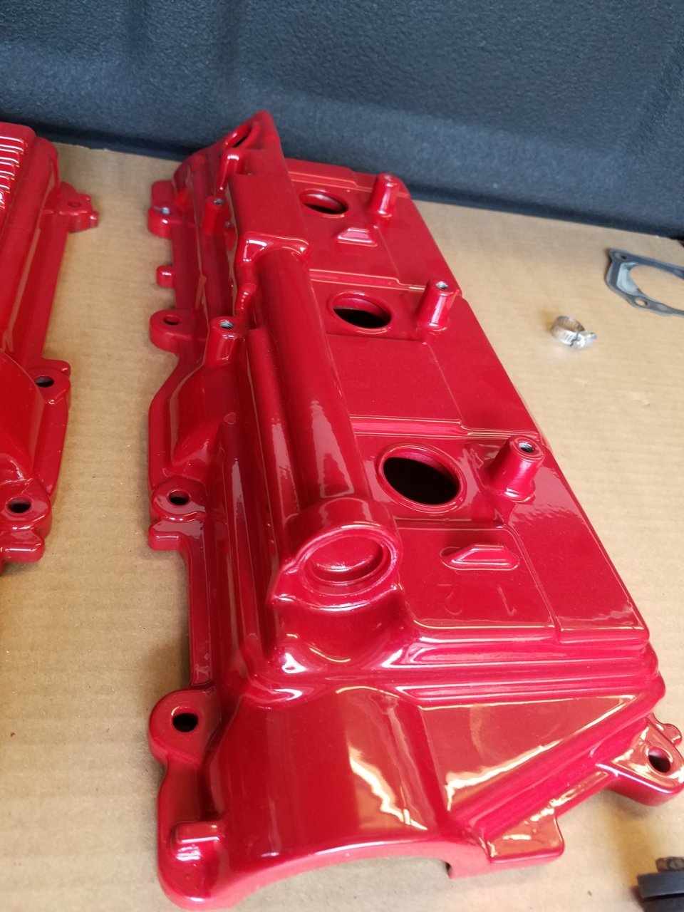

    Decided today would be the day to do new valve cover gaskets and buff the throttle body.
    Then have the valve covers paint bright red Monday,
    Inside of the engine looks amazing clean still

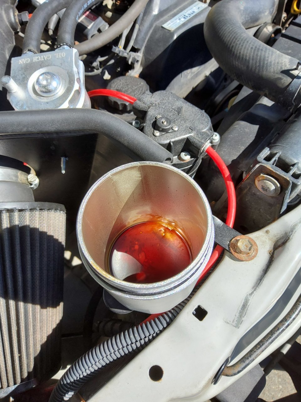

    Looking good John. Have you looked into adding a oil catch can. I added one last month and this is how it looks after 1k miles

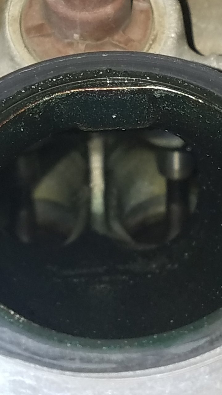

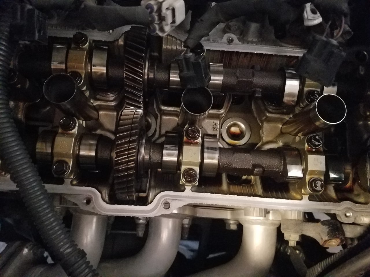

    Thanks, Ive seen these before and I know they help prevent carbon buildup.
    Because of my methanol setup, the methanol has eliminated any carbon buildup for me.
    If I didn't have the methanol I probably would.
    So im kind on the fence if I need it or not.
    Heres my carbon free valves today

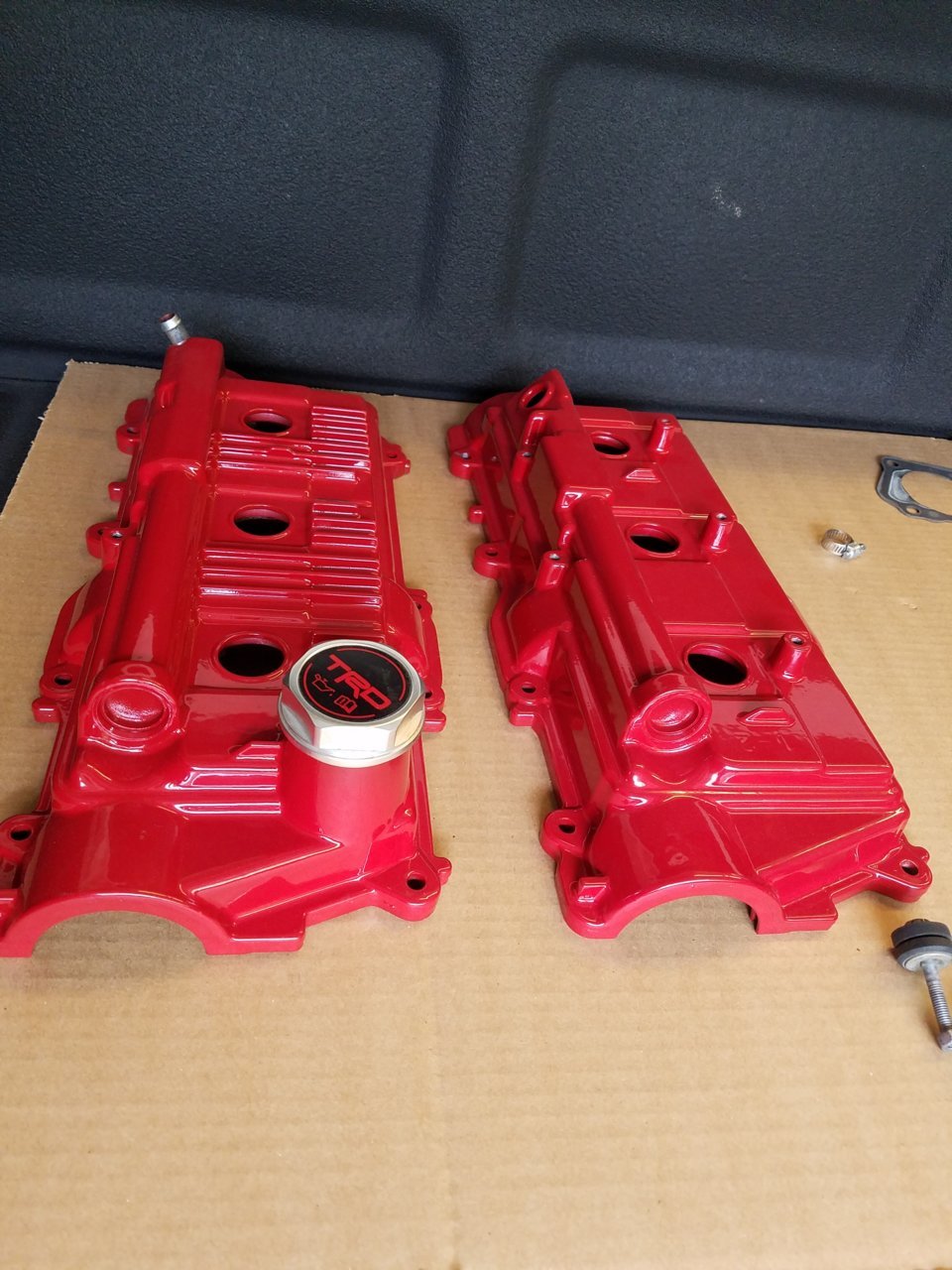

    Got the valve covers back from the painters today,
    well worth the 100.00

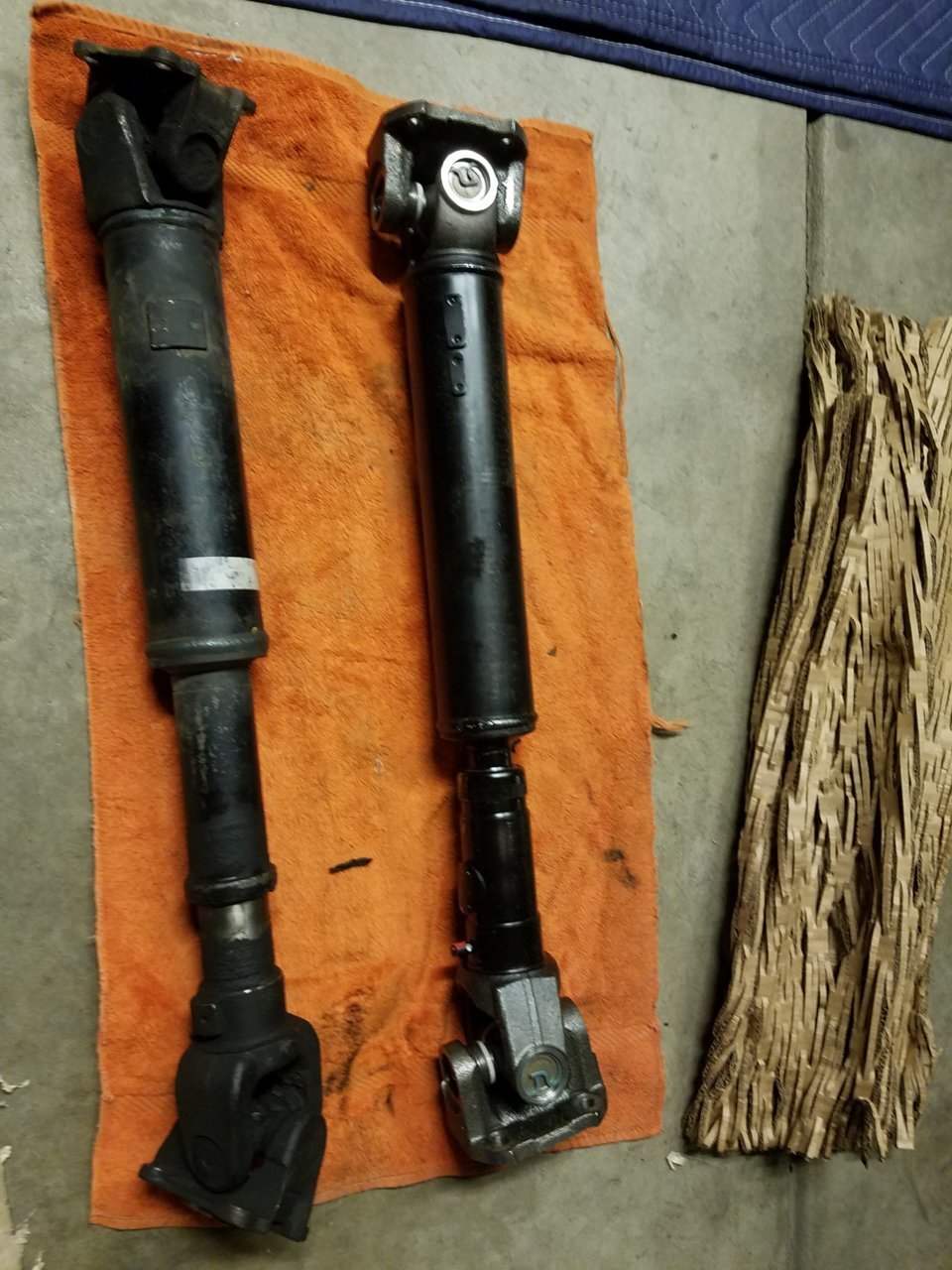

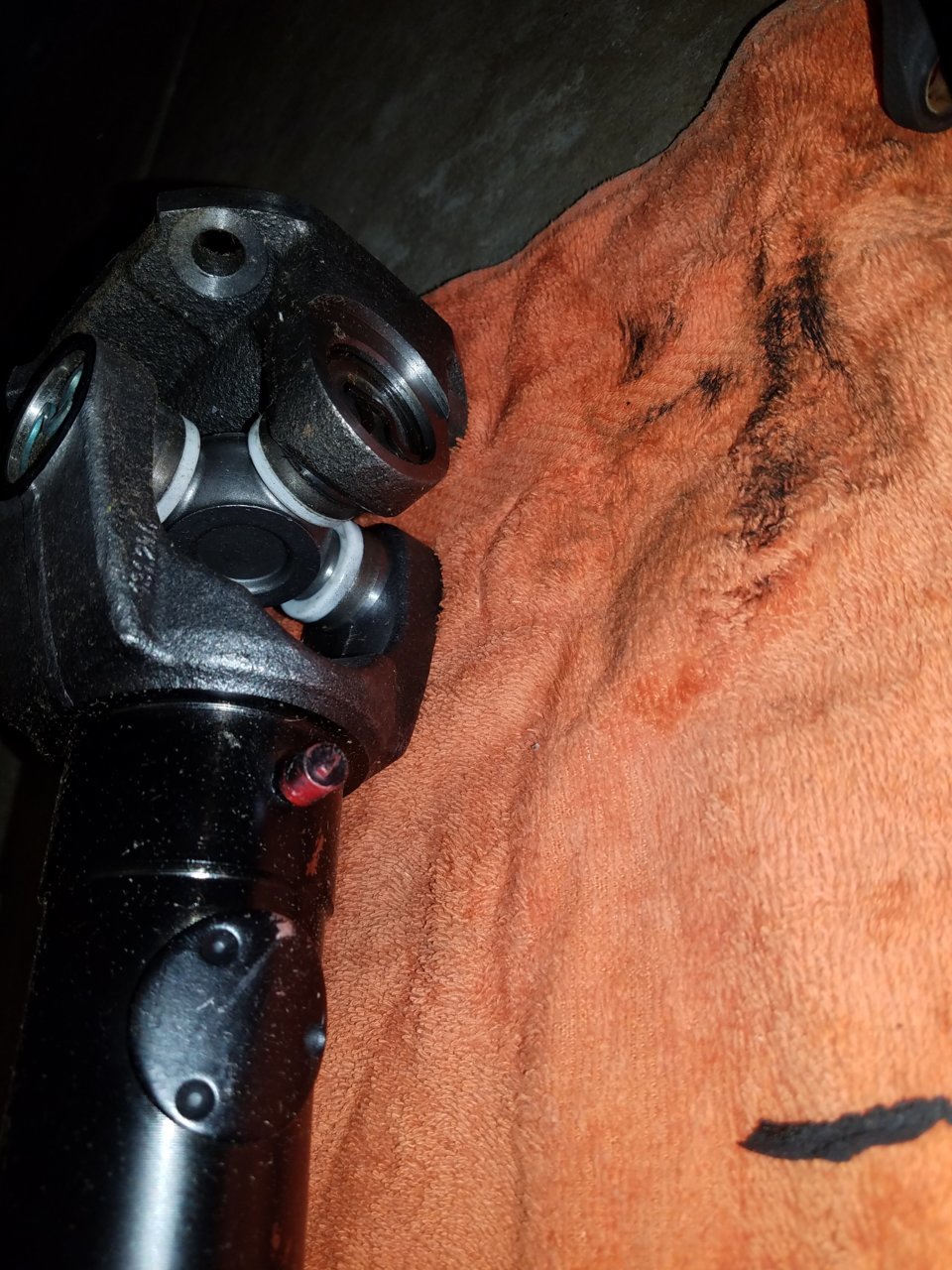

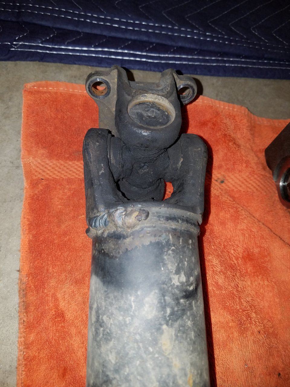

    So after 625,000 miles the front driver shaft un-joint zerks BOTH decided to disappear, Mmm
    That’s right they somehow both came loose and are gone.
    Decided to just get a whole new spicer drive shaft
    AND these spicer u-joints are sealed so NO MORE zerks to grease, :)
    Spicer front drive shaft was 270.00 with shipping

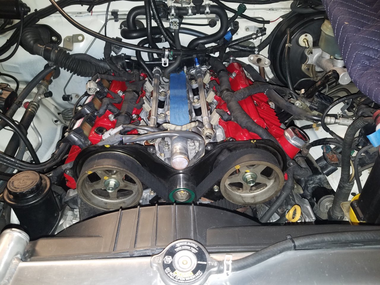

    Hi stranger, been busy putting my truck back together, sent injectors out to be serviced and now installed today, been busy
    Doing a deep cleaning of the engine and engine bay, :)
    She needed a good cleaning

    Looks so good!!! I need to acquire these skills someday lol. Sounds like a lot of work!
