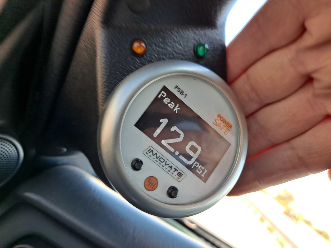

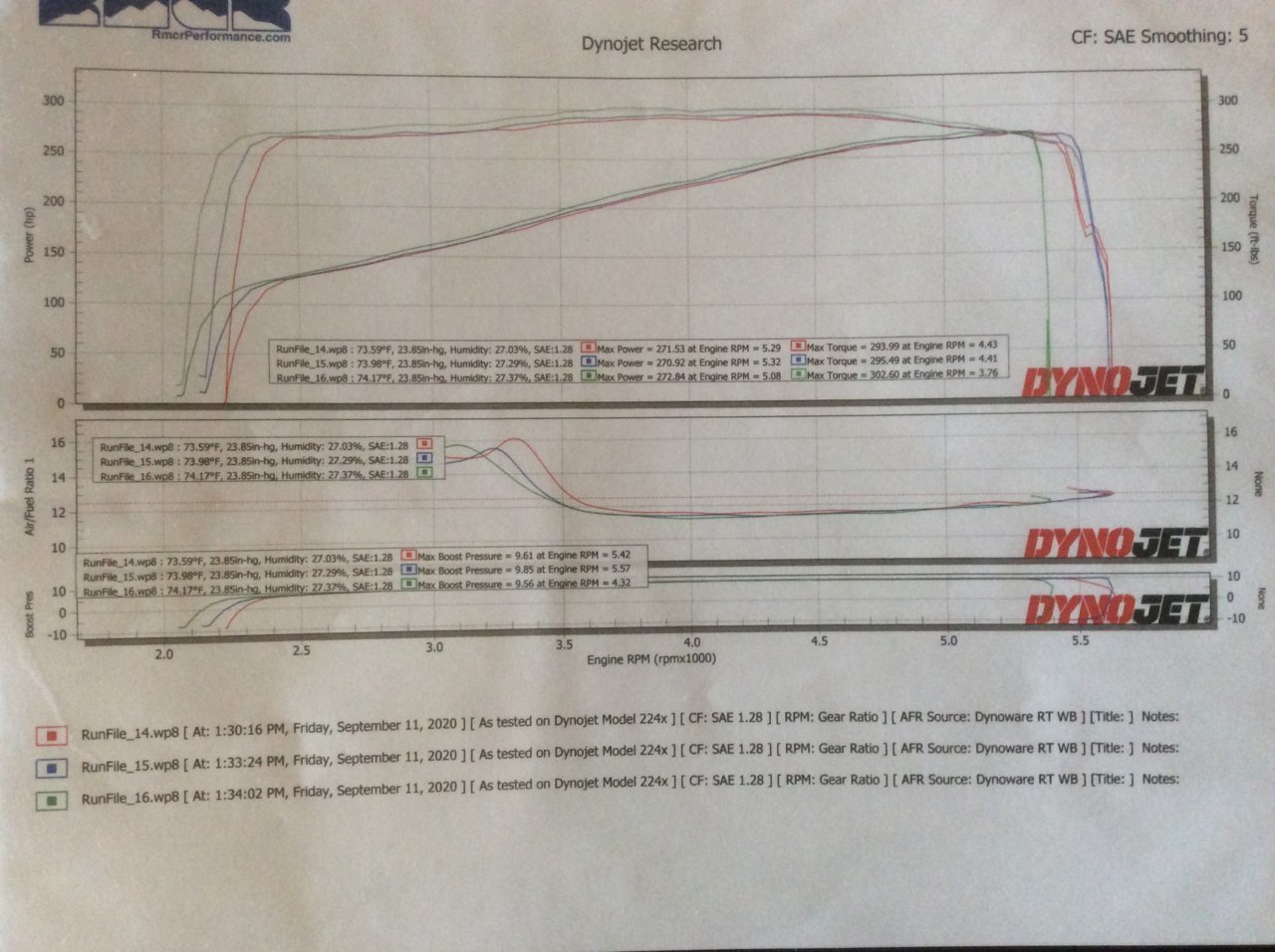

    Just an update on what can be done with tweeting the supercharger that’s run on methonal, with Stock ECU, Stock injectors, stock fuel pump.
    NO 7th injector, NO piggy back, No high flow fuel pump,
    I did a Dyno last week to see where I stand with stock ECU,stock injectors, just methonal added.
    At 6000 feet my boost varies from 10 to 13 pounds depending on the temperature, humidity, barometer pressure, etc.
    It was a warm day and my boost was on the low end at 10 pounds.
    Dyno read 10 pounds when tested actually 9.8 and
    The results were 273 hp and 302 pounds of torque at 10 pounds.
    Each pound of boost is 12 hp at the rear wheel or so for my truck.
    So at 12 pounds my rear wheel is at 297 rear wheel and 326 pounds of torque rear wheel.
    13 pounds would be 309 and torque at 338,
    Typical my boost is 11 pounds, on a good day 13 pounds on a bad day 10 pounds.
    At sea level you can get more boost more power but still the TRD is maxed out around or a little above the 300 mark if setup correctly.
    Torque goes straight up right out of the gate almost to max at 2500rpms,
    So my rear wheel horses vary from 275-300 depending on the day
    and torque 302-325 depending.
    Stock 3.4 puts out around 150hp at the rear wheel.
    Daily Driver at 635,000 miles.

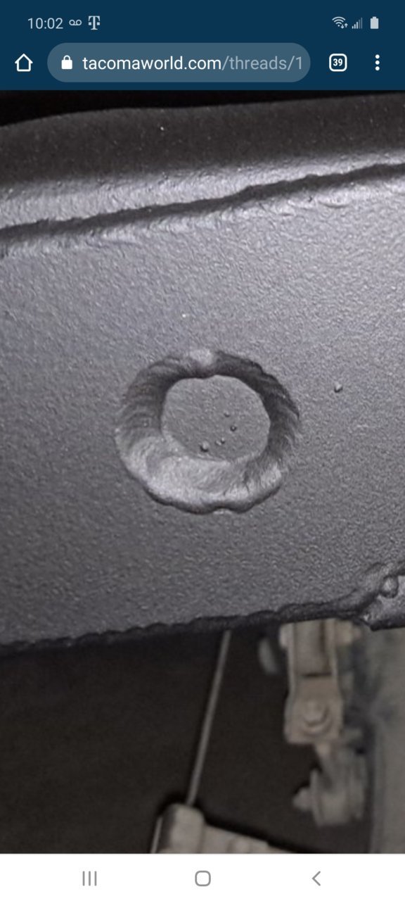

    V6 5sp,RegCab,TVS1320 Supercharger, 56mm pulley, methanol injected Haltech ECU, AC Tvs1320 supercharger,(MUST DO) every 125,000- 150,000 needs rebuild Projector headlights HID 5 speed manual Amsoil for all drive train Smaller 56mm custom pulley, (MUST DO) 2004 DESNO fuel injectors, zero ping ping, 2004 side door mirrors Dick Cepek Rims, Michelin tires LTX, ATM Pathfinders Dynopro ATM ( that last 100,000 miles) Now running Dynopro ATM mud and snow tires KN cold air intake Cat back dual exhaust with ss exhaust tip, Raised exhaust tail pipe to 2" below body line Optima*dry cell battery,red top Alpine sirius radio, 200 watt amp, focal is165 split door pod speakers Focal door speakers Subwoffer behind seat Viper alarm, Electric Locks Dark tinted windows, bucket seats corbeau lg1 Tacoma Rubber floor mats TRD fender extenders, Bilstien shocks, King shocks JBA UCA trailer iv hitch, electric brake control, Drilled slotted brakes, High carbon steel (MUST DO) EBS green stuff 7000 series pads(MUST DO) TRD engine oil cap TRD stick shift, Marlin crawl shift kit. Rear sliding window 2002 4Runner functional hood scoop cut into Tacoma hood, 4Runner dual overhead map light Gentex Auto dim + Compass + Temp, garage,rearview mirror Snow Methonal kit stage 2 Custom 3 core aluminum radiator Linex bed liner Haltech stand alone ECU, Intake supercharger gauge. Stainless steel brake lines, Custom leather wrapped steering wheel, Haltech stand-alone ECU,

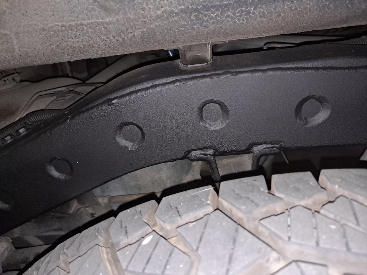

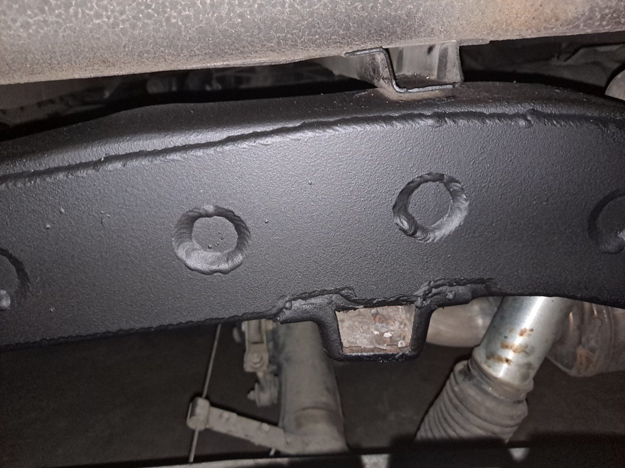

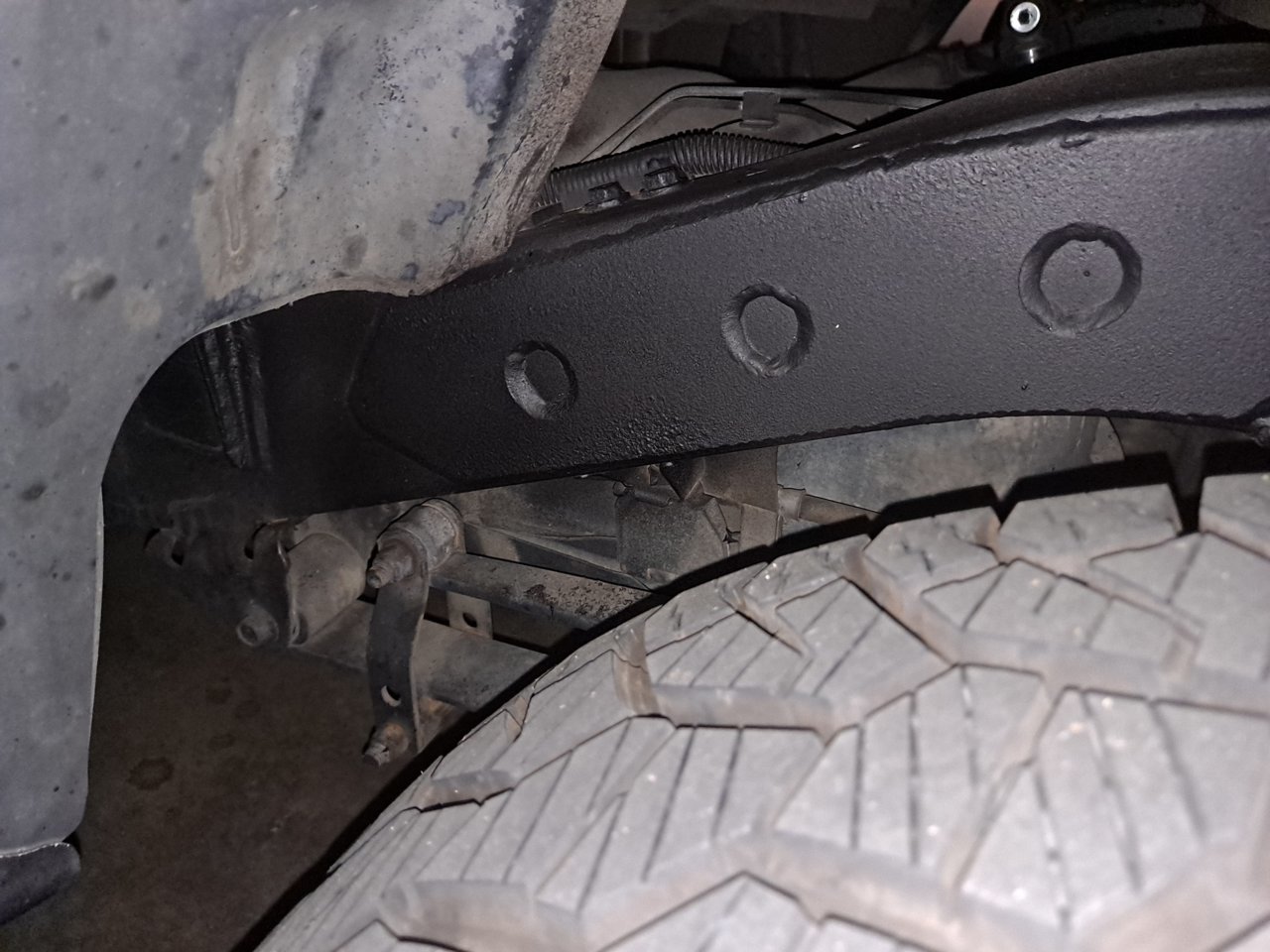

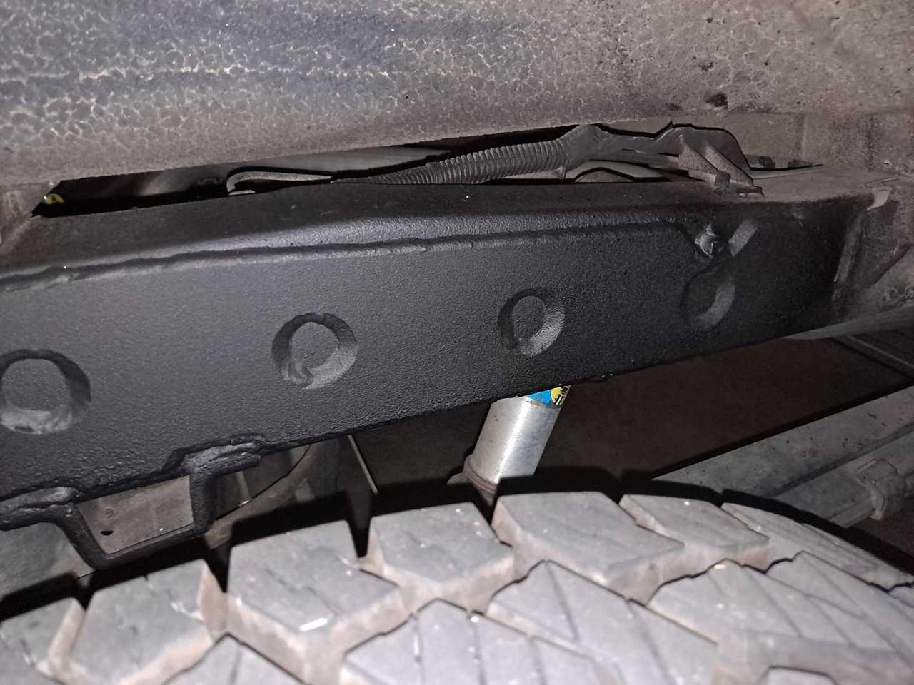

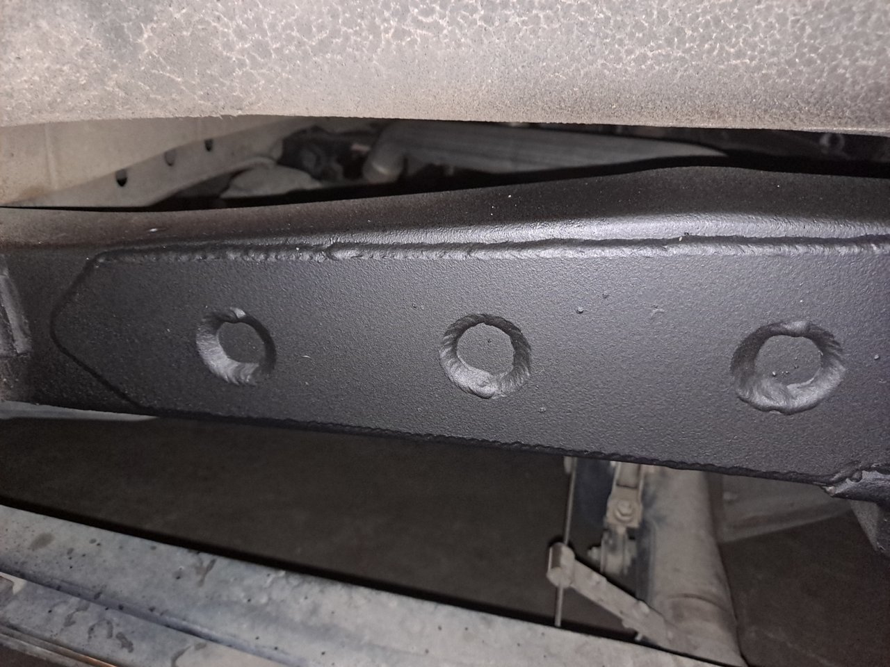

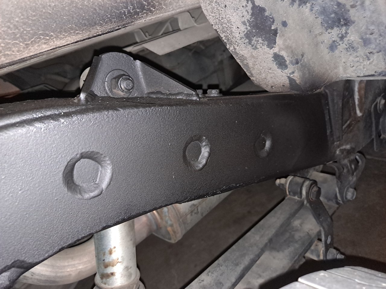

    Frame Brackets and new shock mount installed and painted today.
    Came out beautiful!!
    Been wanting to get this done for a few years,
    Finally done.
    Matt at 3D off road in Colorado did this beautiful work, perfect welds!!
    They do plenty of custom welding
    https://www.3d-offroad.com/

  15. Sep 28, 2020 at 7:05 AM
    #495
    Grimm30
    Grimm30 Well-Known Member
    Jan 5, 2017
    #206620
    174
    Kody
    Ventura, CA
    04 Tacoma 3.4l MT 4x4 Limited
    Wow, this is the cleanest I've seen so far. :101010:
    1997tacomav6[OP] likes this.
  16. Sep 28, 2020 at 9:04 AM
    #496

    Yeah, even those rosette round welds are absolutely perfect,
    A master welder indeed

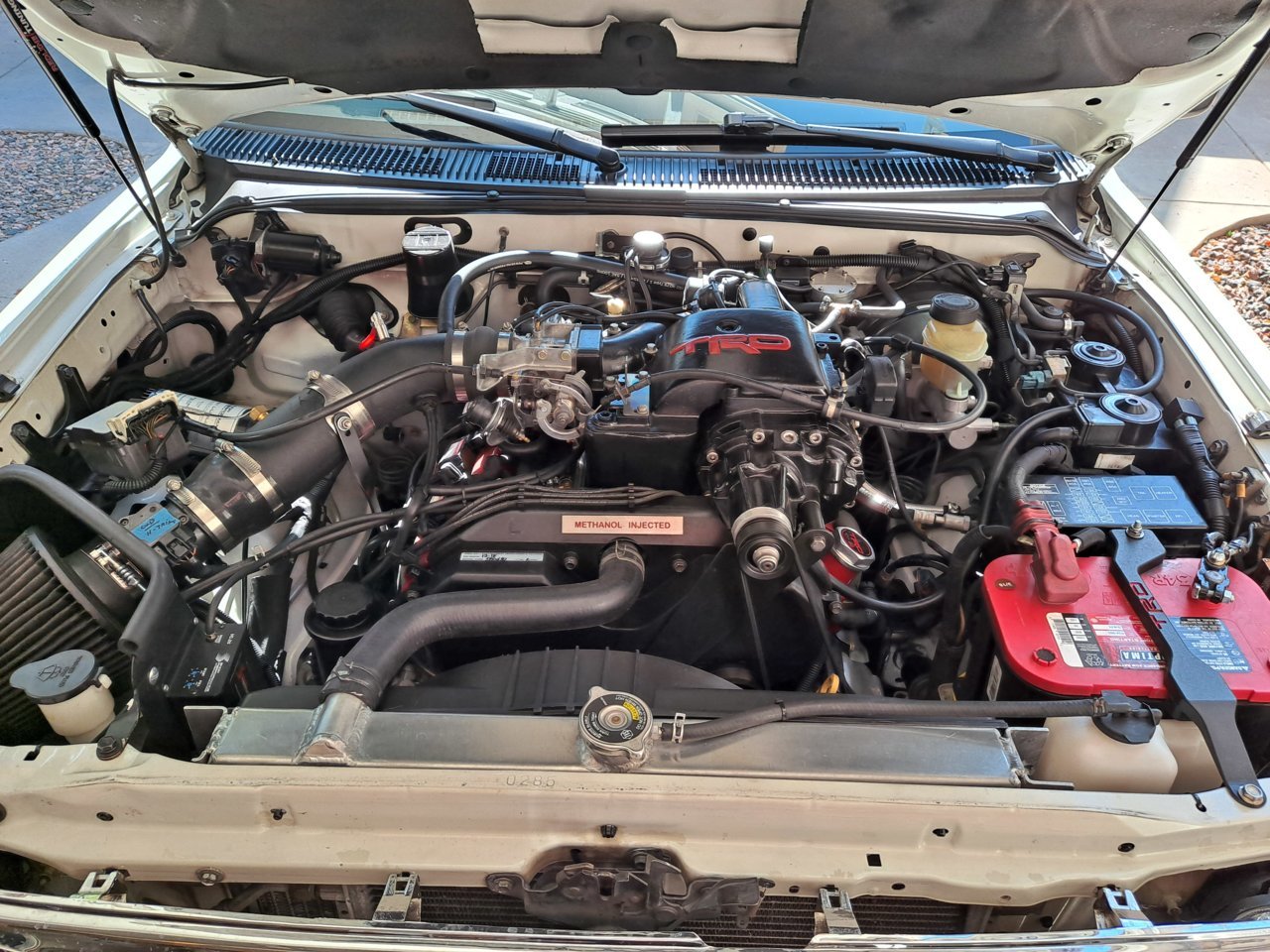

    All cleaned up and supercharger is putting out some great numbers
