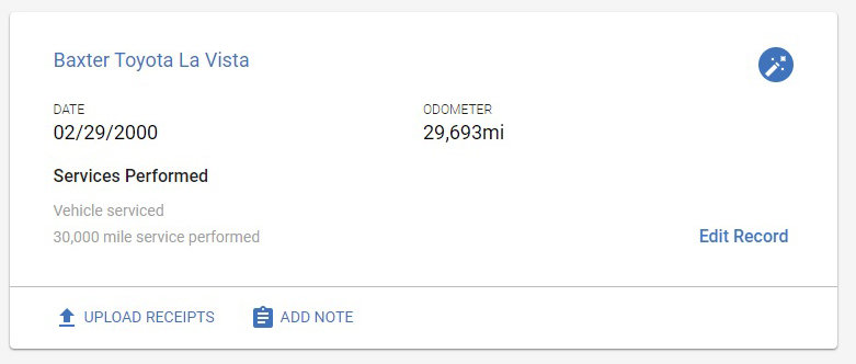

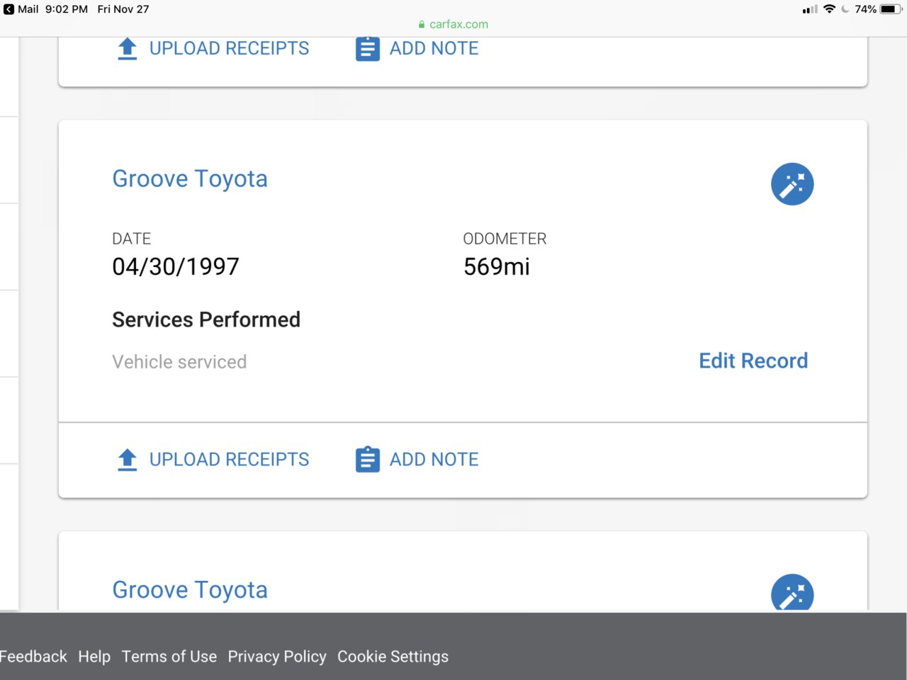

    you've got me beat there!, i did not get mine until May 9th lol
    how about Leap Day 2K, this is what i had

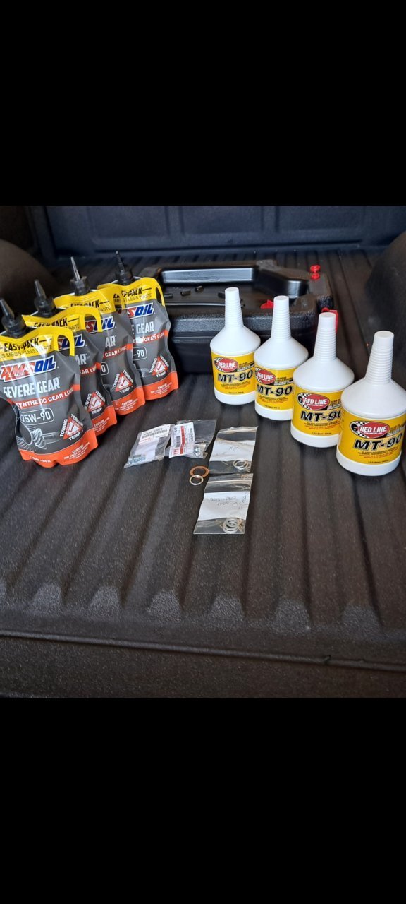

    Time for the running gear oil change at 645,000
    T-case is 1.1
    Front Diff is 1.6
    Rear Diff is 3.
    Ended up getting 4 quarts of Amsoil 75w90 GL5 for the front and rear diffs.
    Ended up getting 4 quarts Redline MT90 75w90 GL4 for the transmission and Tcase.

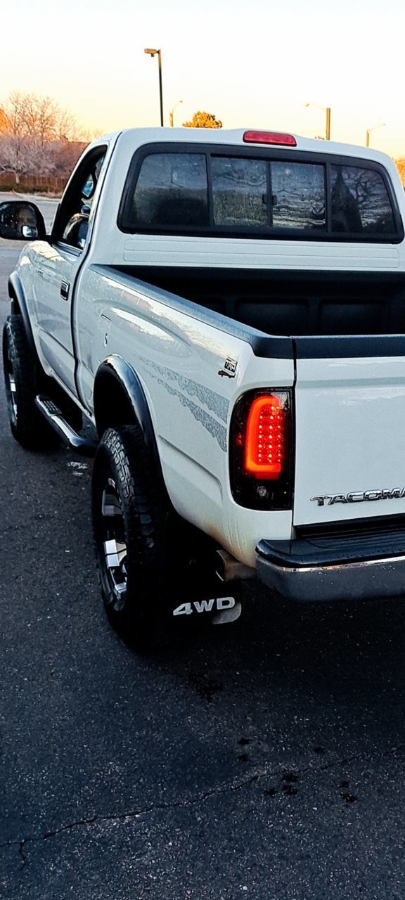

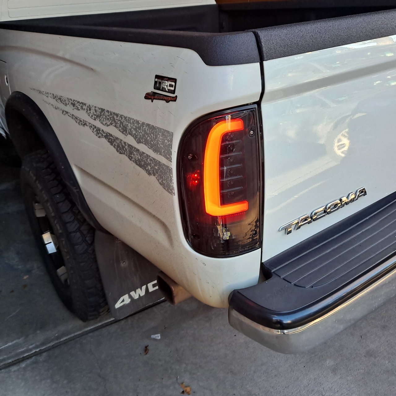

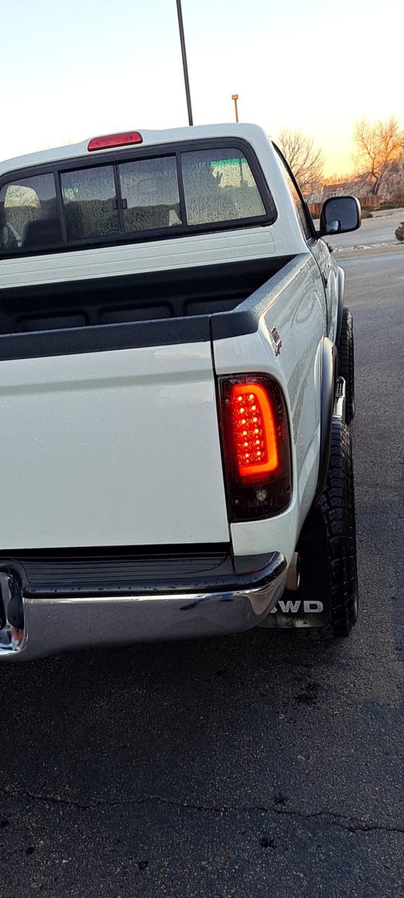

    Christmas present came today.
    Anzo LED Rear lights :)
    Plug and play

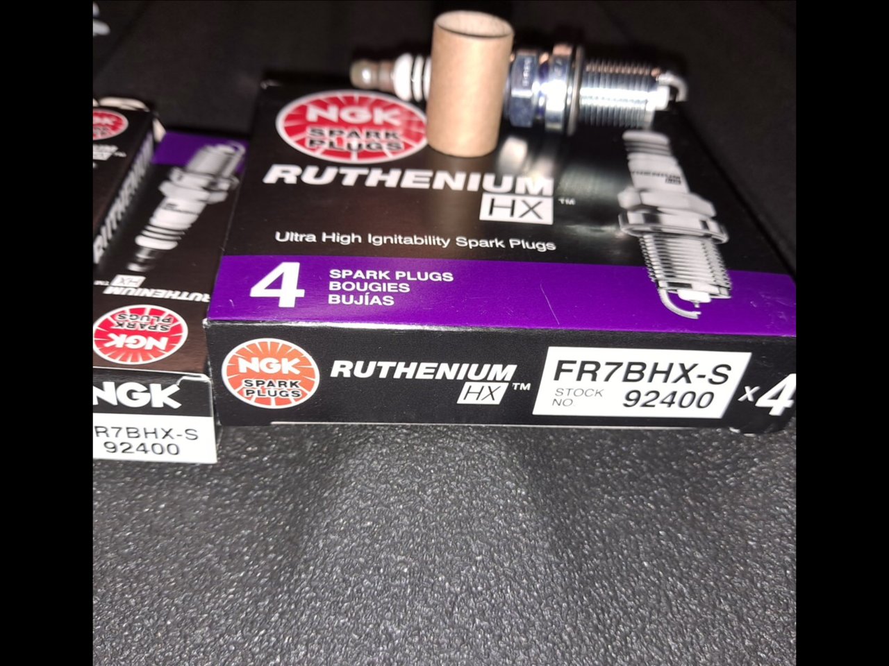

    Added ruthenium spark plugs @ 661,000
    FR7 are a two step cooler plug for Supercharger
