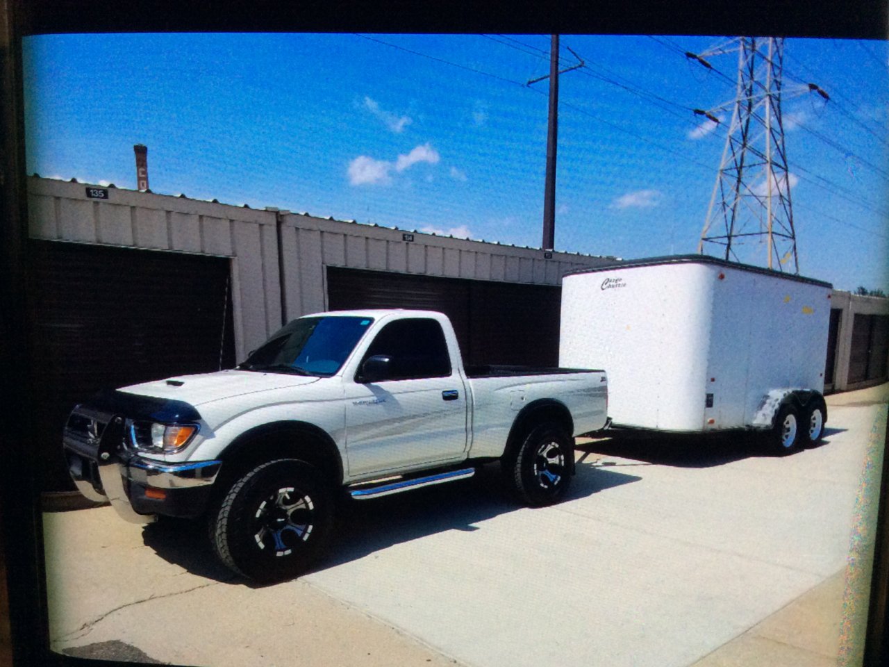

    Also, did you haul the trailer with the Jag using the taco? What was the total weight of that?

    No, just my trailer double axle,

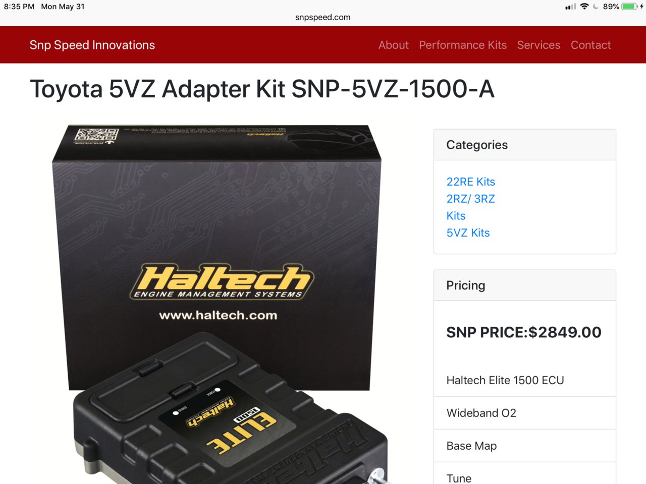

    Haltech 2000 Stand alone is my next step, just put in my order yesterday, will arrive in 6 weeks.

    Any plans for the new ECU?

    The new ECU will give me perfect AFR numbers going forward for the supercharger

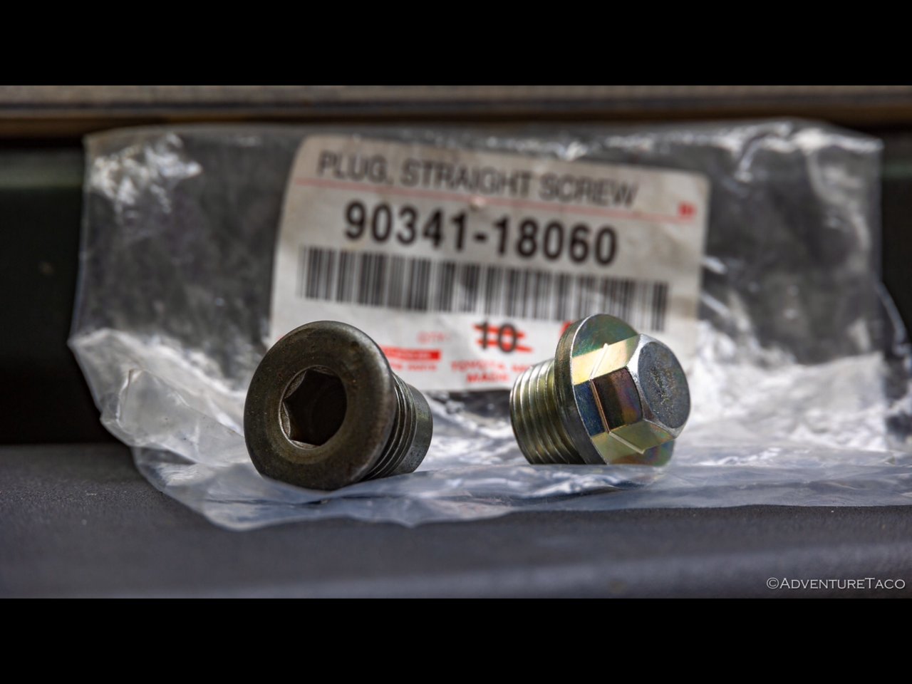

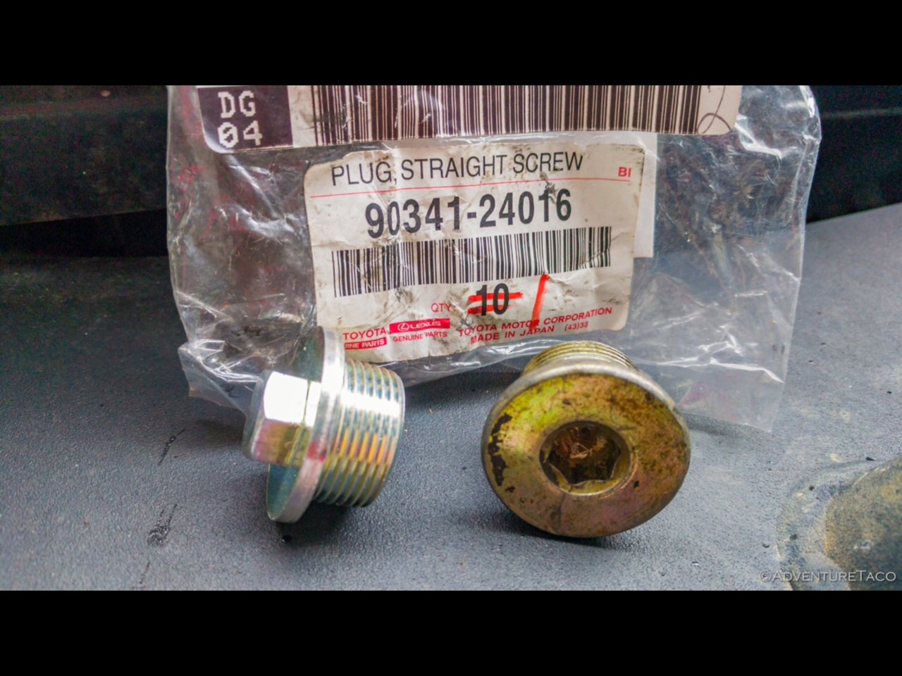

    dumb question but by front and rear you mean front and rear diff right?

    Yes,
    The front diff plugs use an Allen head that tend to strip out,
    These are Lexus replacement ones that I got for my front diff fill and drain that have a bolt head on them

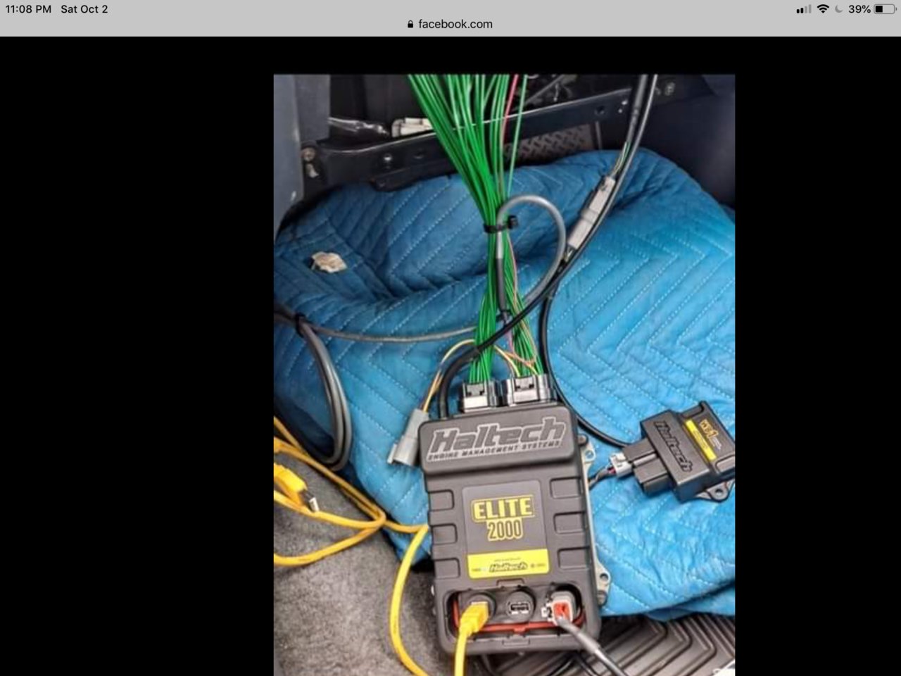

    My next mod for the supercharger is a stand alone haltech 2000 ECU with a plug and play harness that takes less then an hour to install.
    It’s been ordered and in 6 weeks out because of back order it will arrive.

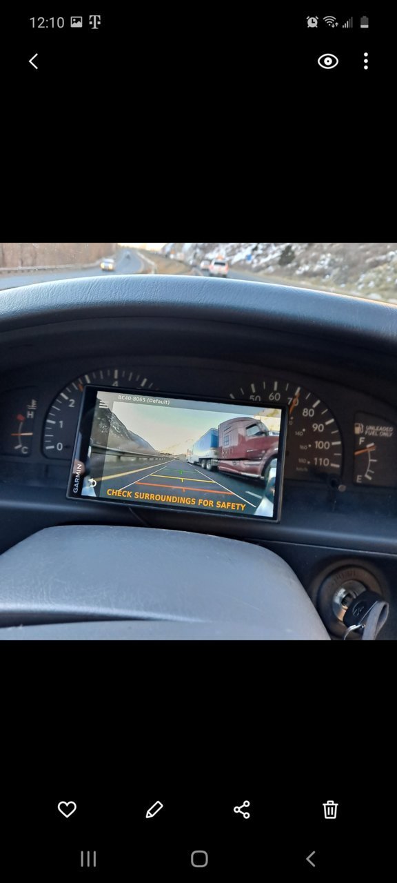

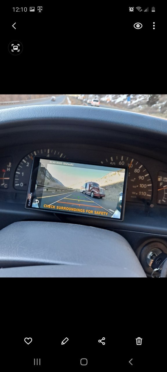

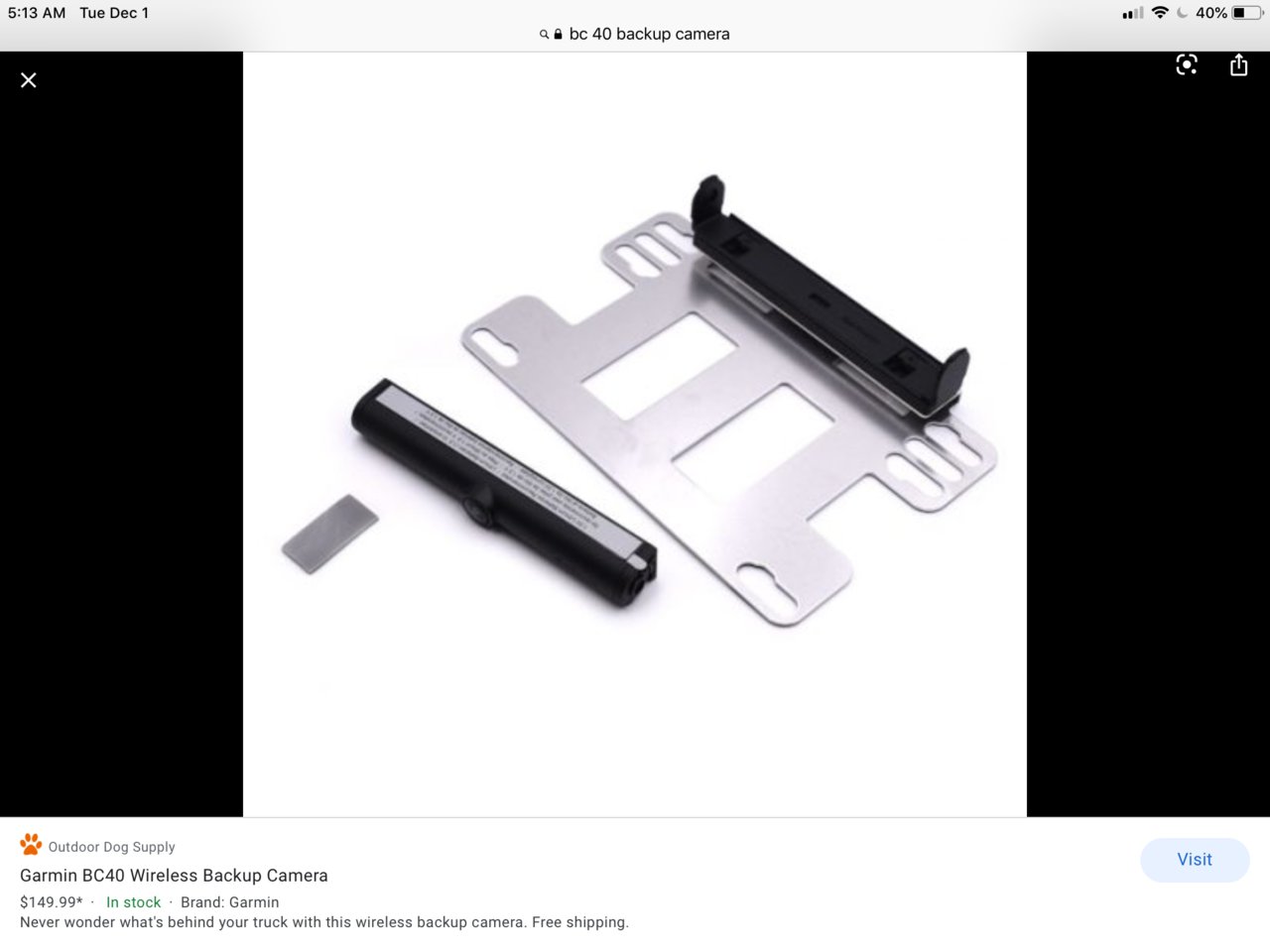

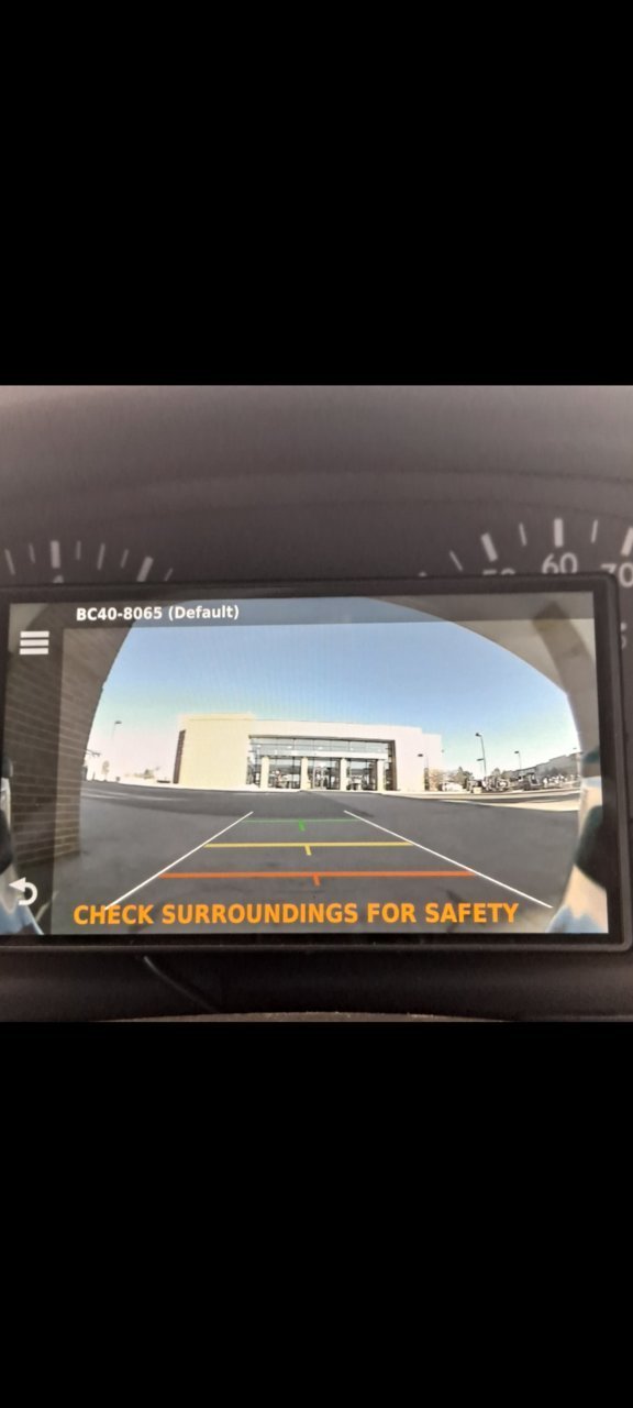

    How long do the batteries last on the camera given it's wireless?
  10. Jun 1, 2021 at 11:55 AM
    #530
    1997tacomav6
    1997tacomav6 [OP] V6 5sp,RegCab,TVS1320 Supercharger,Haltech, 800k
    Oct 5, 2013
    #113940
    10,391
    John
    Denver
    97 reg cab, v6 5sp 300hp supercharged, Methonal Injection, 800,001 plus miles, Original Owner
    V6 5sp,RegCab,TVS1320 Supercharger, 56mm pulley, methanol injected Haltech ECU, AC Tvs1320 supercharger,(MUST DO) every 125,000- 150,000 needs rebuild Projector headlights HID 5 speed manual Amsoil for all drive train Smaller 56mm custom pulley, (MUST DO) 2004 DESNO fuel injectors, zero ping ping, 2004 side door mirrors Dick Cepek Rims, Michelin tires LTX, ATM Pathfinders Dynopro ATM ( that last 100,000 miles) Now running Dynopro ATM mud and snow tires KN cold air intake Cat back dual exhaust with ss exhaust tip, Raised exhaust tail pipe to 2" below body line Optima*dry cell battery,red top Alpine sirius radio, 200 watt amp, focal is165 split door pod speakers Focal door speakers Subwoffer behind seat Viper alarm, Electric Locks Dark tinted windows, bucket seats corbeau lg1 Tacoma Rubber floor mats TRD fender extenders, Bilstien shocks, King shocks JBA UCA trailer iv hitch, electric brake control, Drilled slotted brakes, High carbon steel (MUST DO) EBS green stuff 7000 series pads(MUST DO) TRD engine oil cap TRD stick shift, Marlin crawl shift kit. Rear sliding window 2002 4Runner functional hood scoop cut into Tacoma hood, 4Runner dual overhead map light Gentex Auto dim + Compass + Temp, garage,rearview mirror Snow Methonal kit stage 2 Custom 3 core aluminum radiator Linex bed liner Haltech stand alone ECU, Intake supercharger gauge. Stainless steel brake lines, Custom leather wrapped steering wheel, Haltech stand-alone ECU,
    3-4 months you have to get the really good long lasting batteries,
    Takes 15 seconds to replace them

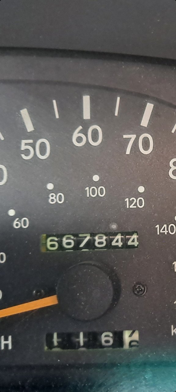

  12. Jun 25, 2021 at 8:03 PM
    #532
    1997tacomav6
    Oct 5, 2013
    #113940
    10,391
    John
    Denver

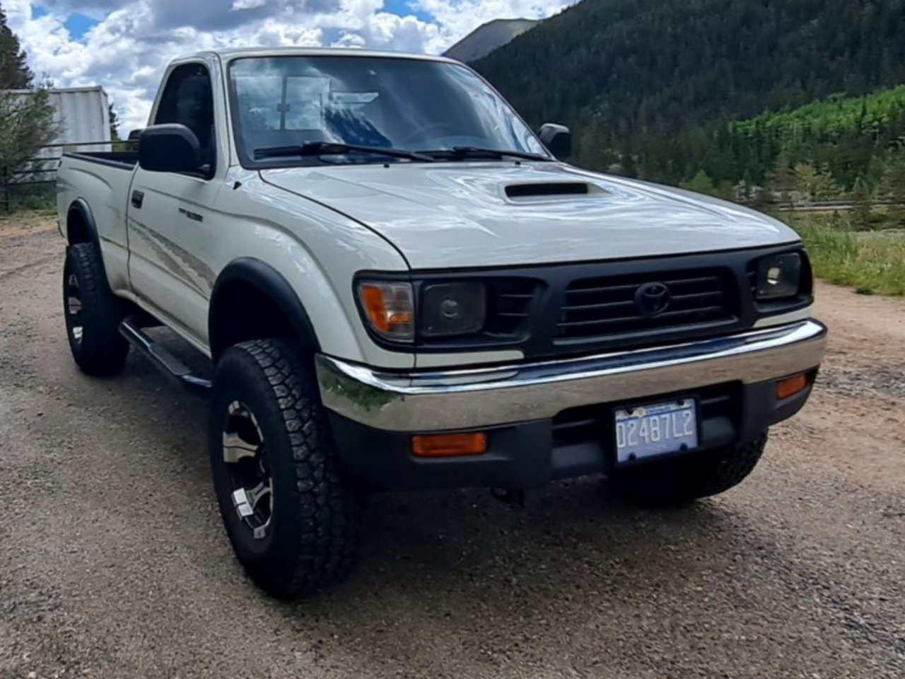

    Crossed the 667,000 mile marker and added a black grill and cleaned her up today
    tacomakid96 and JennJenn like this.
  13. Jun 25, 2021 at 9:13 PM
    #533
    tacomakid96
    tacomakid96 Lions Not Sheep
    Jan 27, 2010
    #30175
    4,244
    Phil
    Out n' about
    1996 Tacoma / 2000 4.7 Tundra TRD
    Man I just want to see my cluster on my 96 cross 300k that’s awesome.
    1997tacomav6[OP] likes this.
  14. Jun 25, 2021 at 9:21 PM
    #534
    1997tacomav6
    Oct 5, 2013
    #113940
    10,391
    John
    Denver
    JennJenn and tacomakid96[QUOTED] like this.

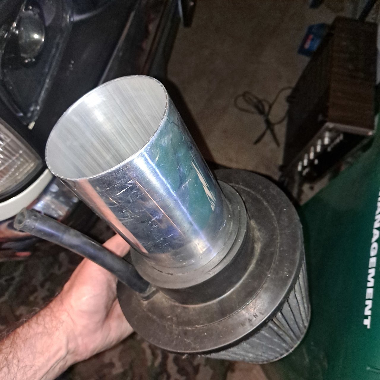

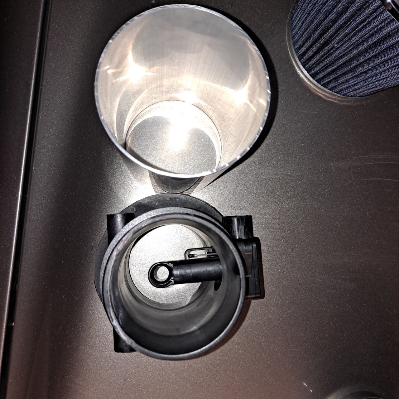

    Thanks,
    Running a 5 speed with 4:10 rear, 15” rims, 31” tires

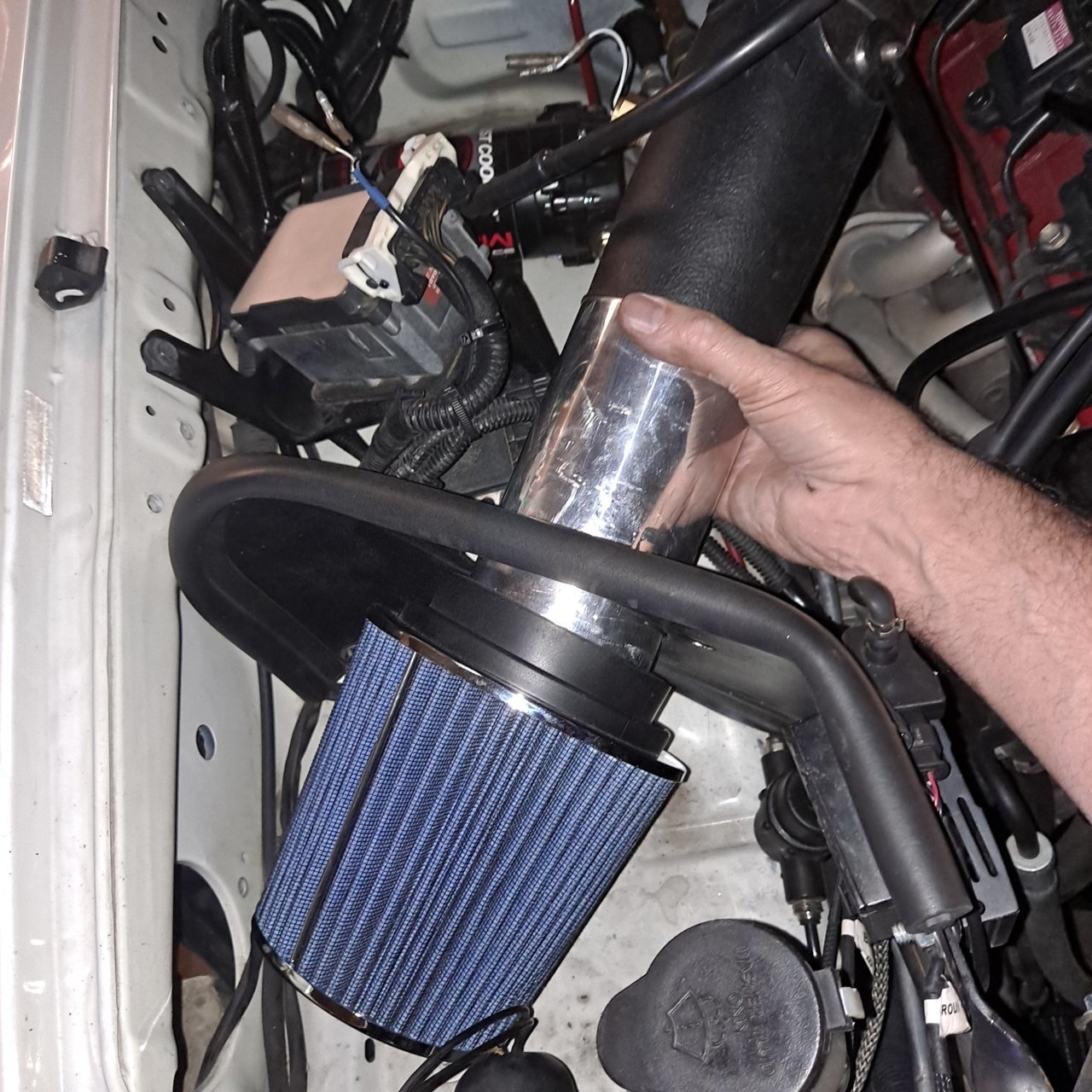

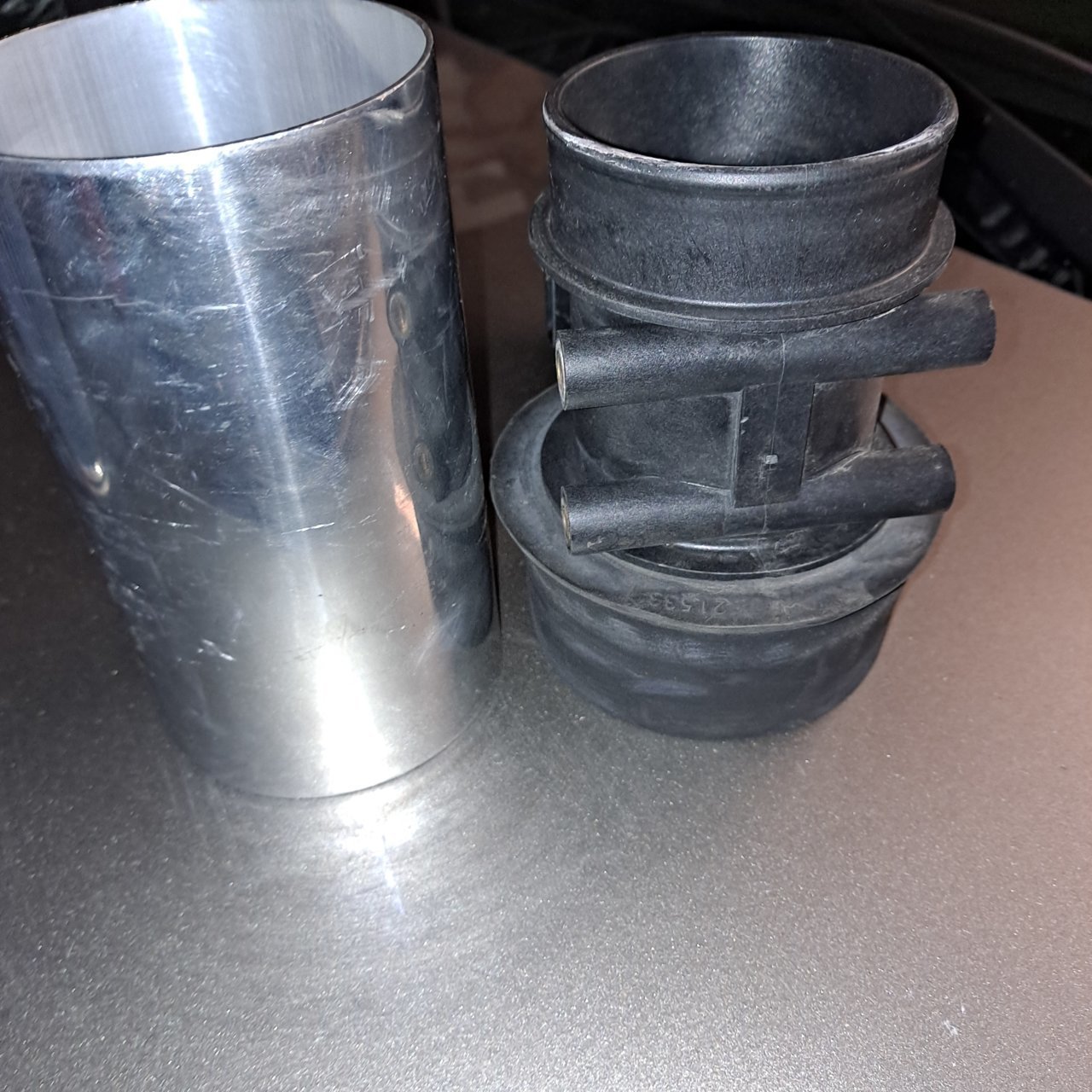

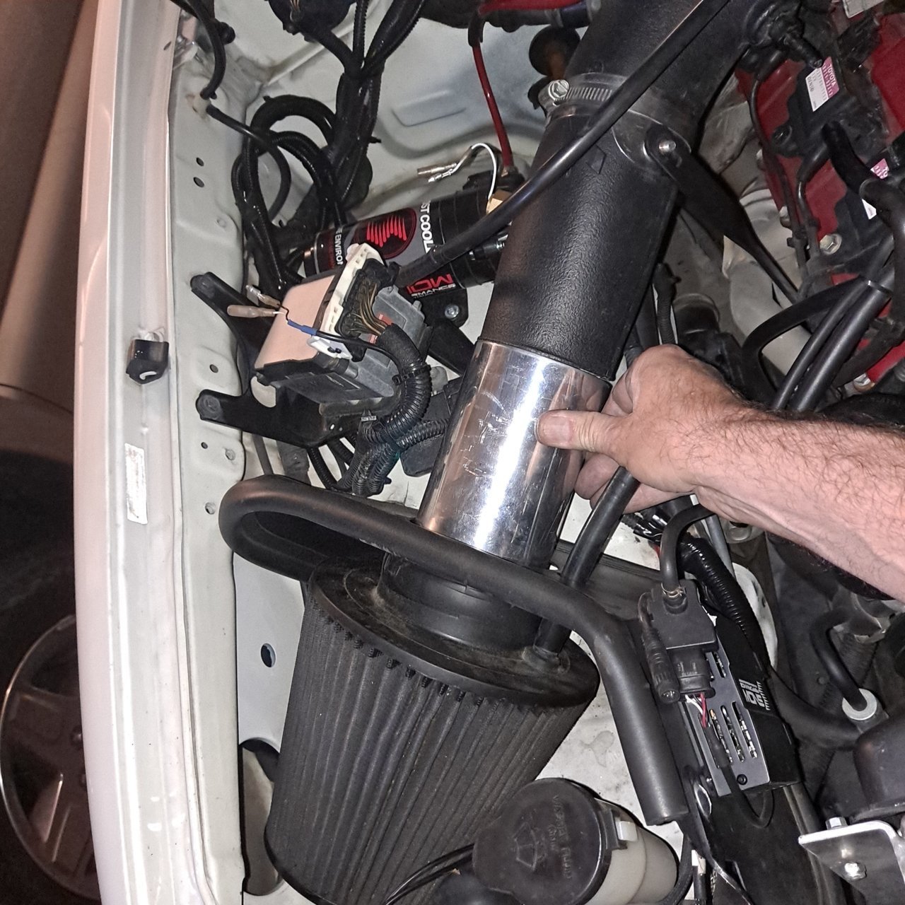

    Just got a 3” MAF intake section to replace the stock 2.5” intake section for when the new ECU arrives.
    The new Haltech ECU doesn’t use a MAF.
    More information in 4 weeks

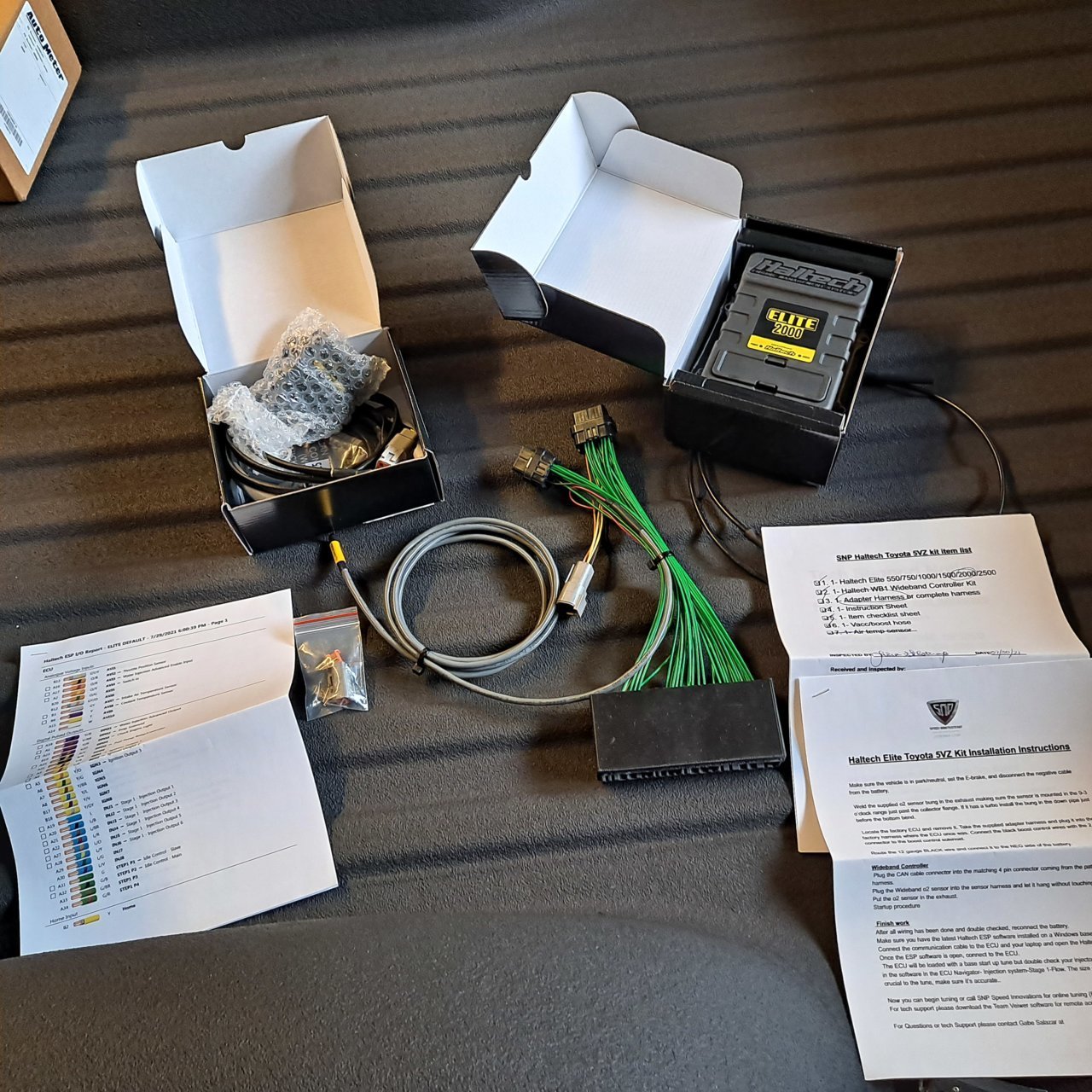

    The haltech 2000 Stand alone ECU arrived yesterday,
    02 sensor haltech 17025 bosch

    Thanks, the Haltech is a game changer and the sliver bullet for tuning the supercharger,
    Perfect tune, perfect AFR at all times, more power. Wish I had known about it earlier.
    Power comes on at 2000 rpms instead of 3500 because there is no closed loop to deal with anymore,
    Running a dual map, one with methonal for summer and another one for winter without.
    Added a AEM 50-1220 fuel pump 340lph that gives me all the fuel I need
