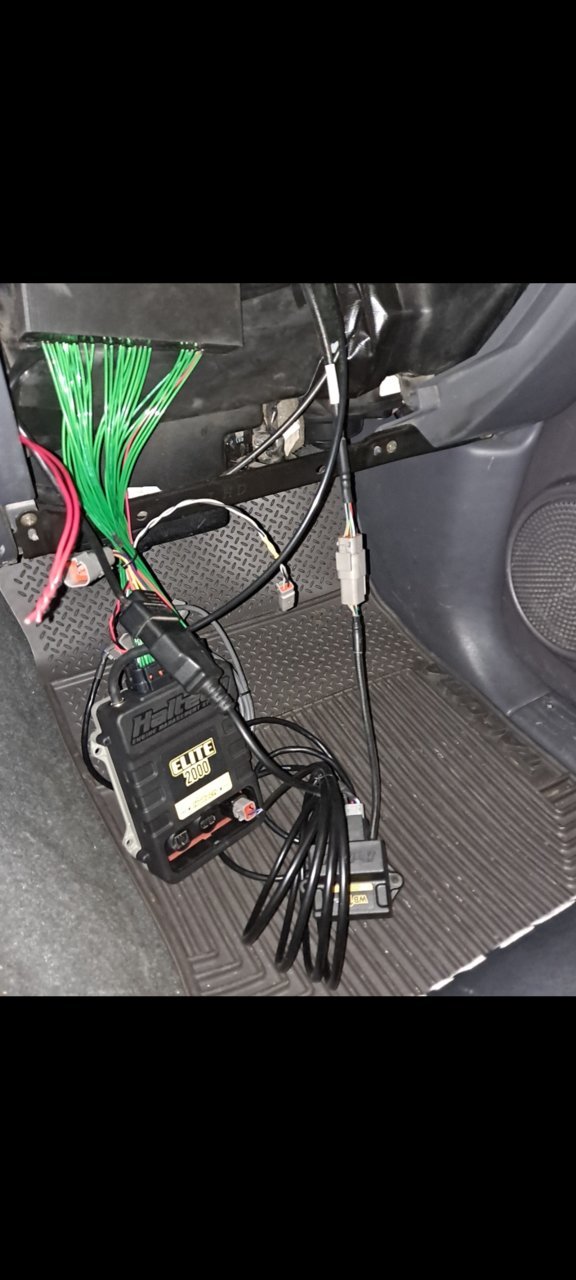

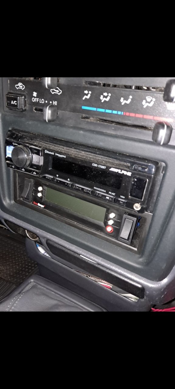

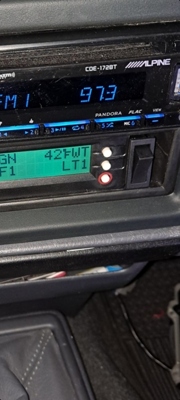

    I actually sent the haltech back to GABE last month and had him setup a dual map,
    1) So now I have one map that runs a perfect AFR all the time regardless for winter cooler temperatures.
    2) a 2nd map that will be tuned with the methanol to keep the supercharger temps in check for summer and
    a rocker switch to switch maps on the fly.
    The rocker switch I attached next to the scan gauge.
    also had him wire a patch so the scan gauge is working with the haltech

    :), now just have to find a place for all those wires behind the dash,
    Because I don’t have an airbag I will probably use that area

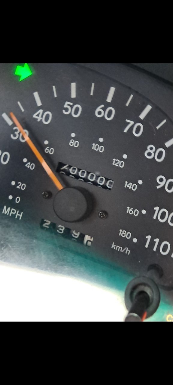

    Just passed the 700,000 mark and got some new BFG KO2 tires!
    Changed all the running gear oil and engine,
    Diff front and rear, transmission, tcase, supercharger,
    New ac compressor and condenser,
    New starter just because,
    New belts including supercharger,
    Should be good for another 100k :)

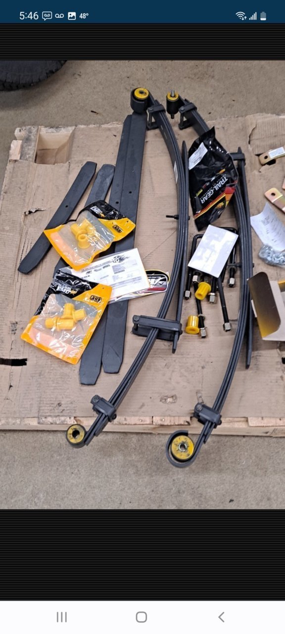

    But finally got a set of 2” OME springs for the rear with grease zerk shackles.
    Added a spacer to the drivers side to eliminate the taco lean also.
    Finally leveled the rear to match the kings upfront

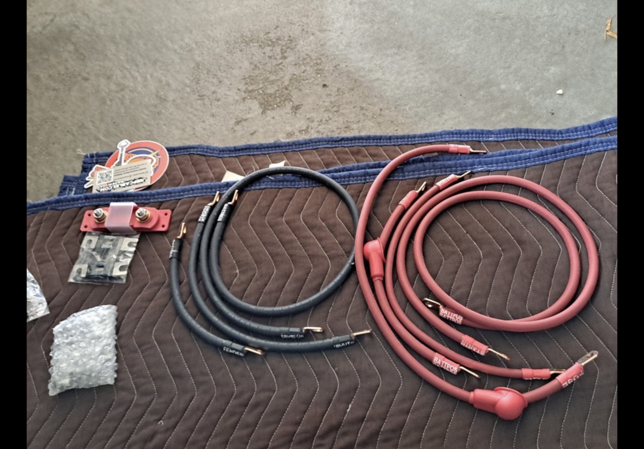

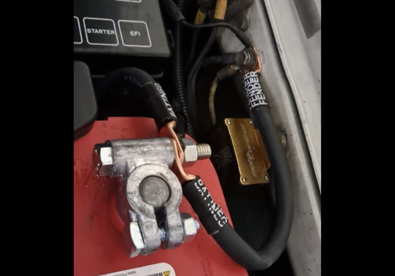

    Upgraded the wires with the big 7 pack,
    Clean kit!

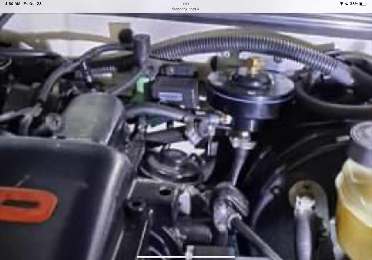

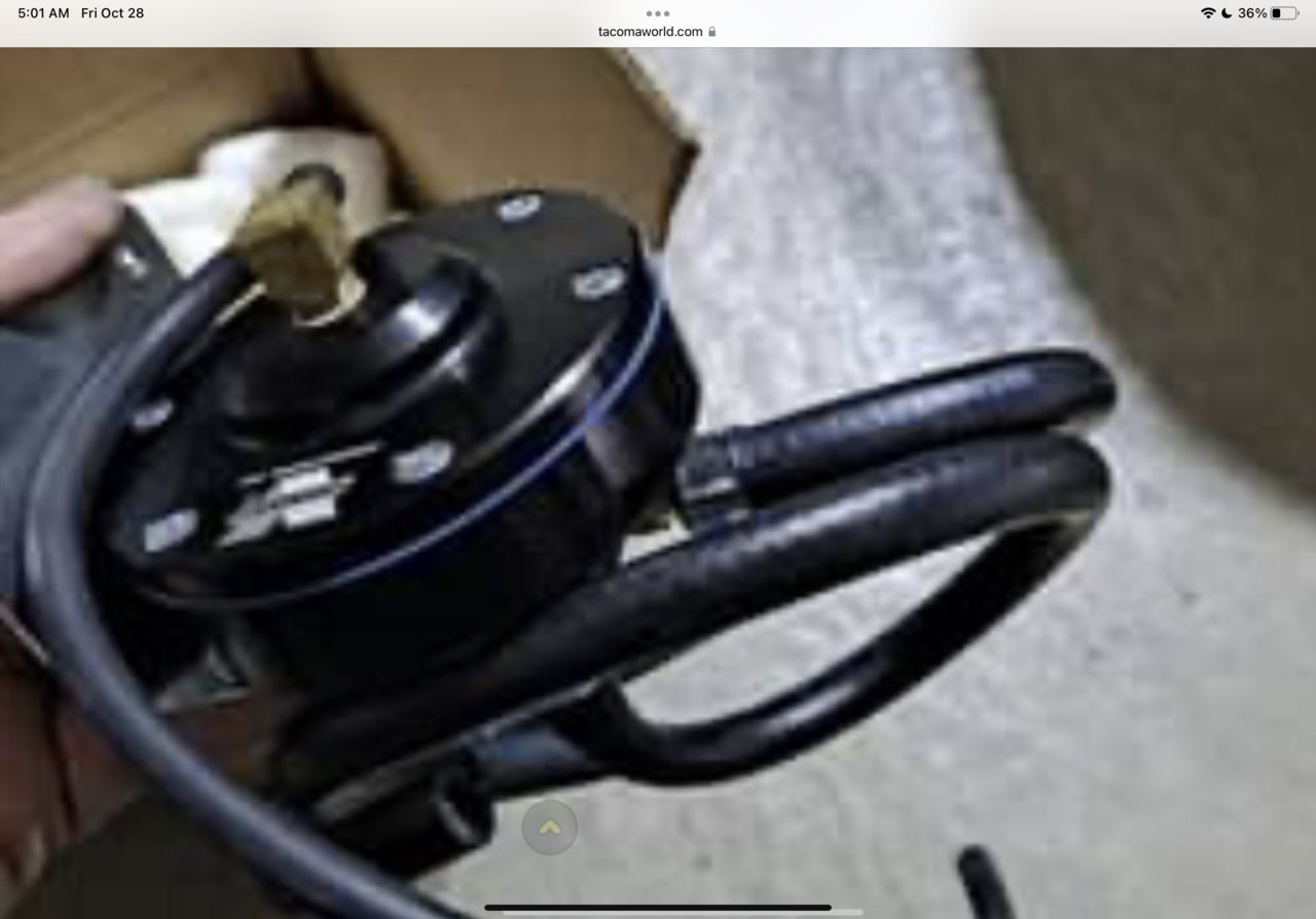

    Replaced the old original TRD FMU with a much more reliable vortech 3:1 ratio
    This guy works great for the supercharger raising the fuel pressure

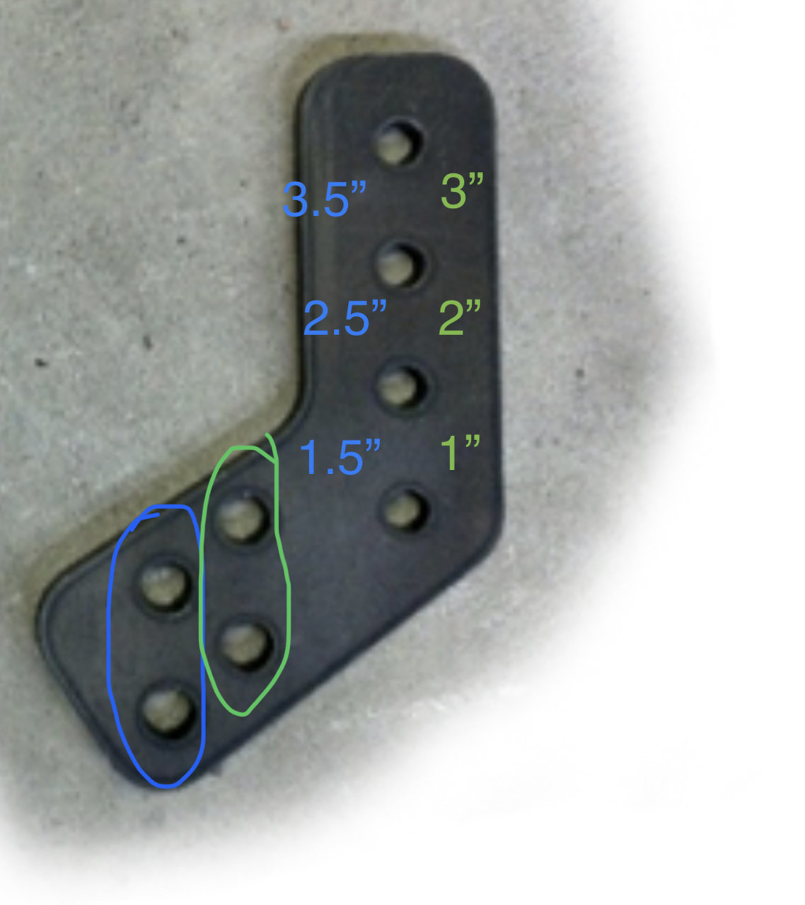

    Because of the lift Got a rear brake proportioning valve.
    Has 1/2” steps made of 1/4 steel
