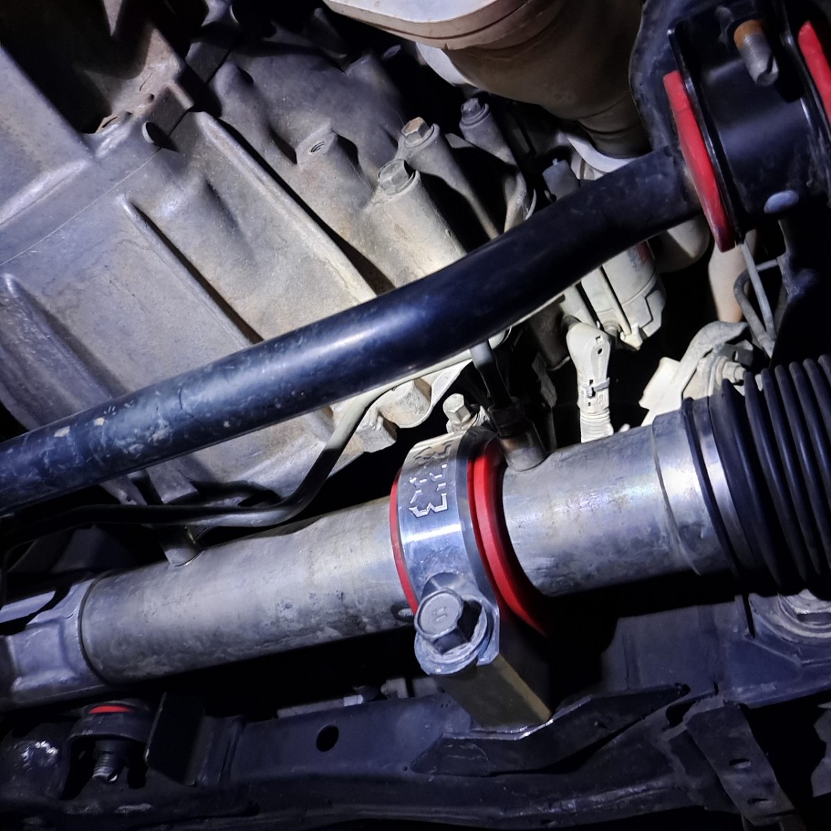

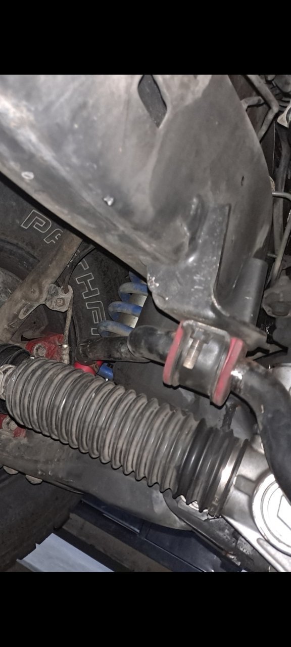

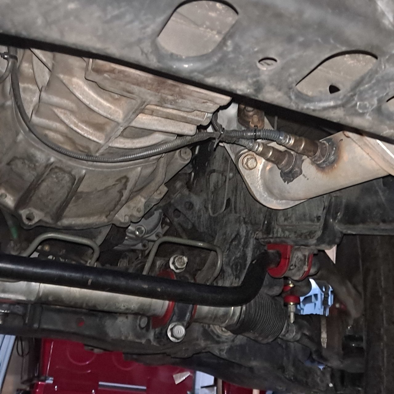

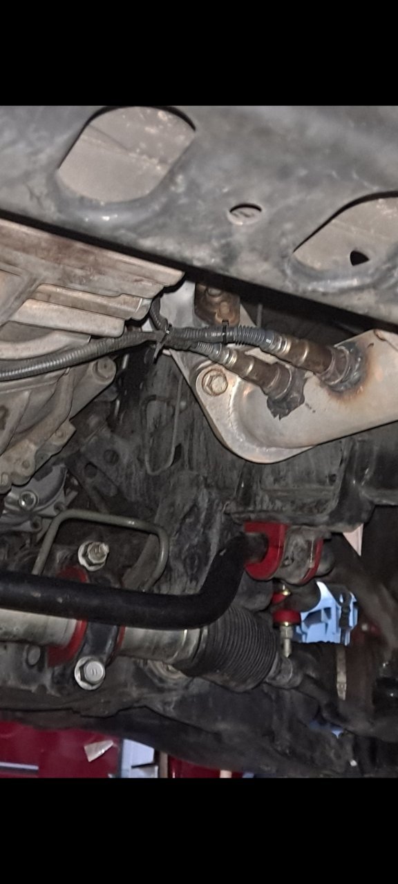

    Polyurethane steering rack bushings and
    Sway bar bushings installed in an hour or so.
    This has to be one of the best bang for the buck mod!=75.00
    That steering wheel vibration at 60-65mph is completely gone.
    If I had only known it was that easy:)

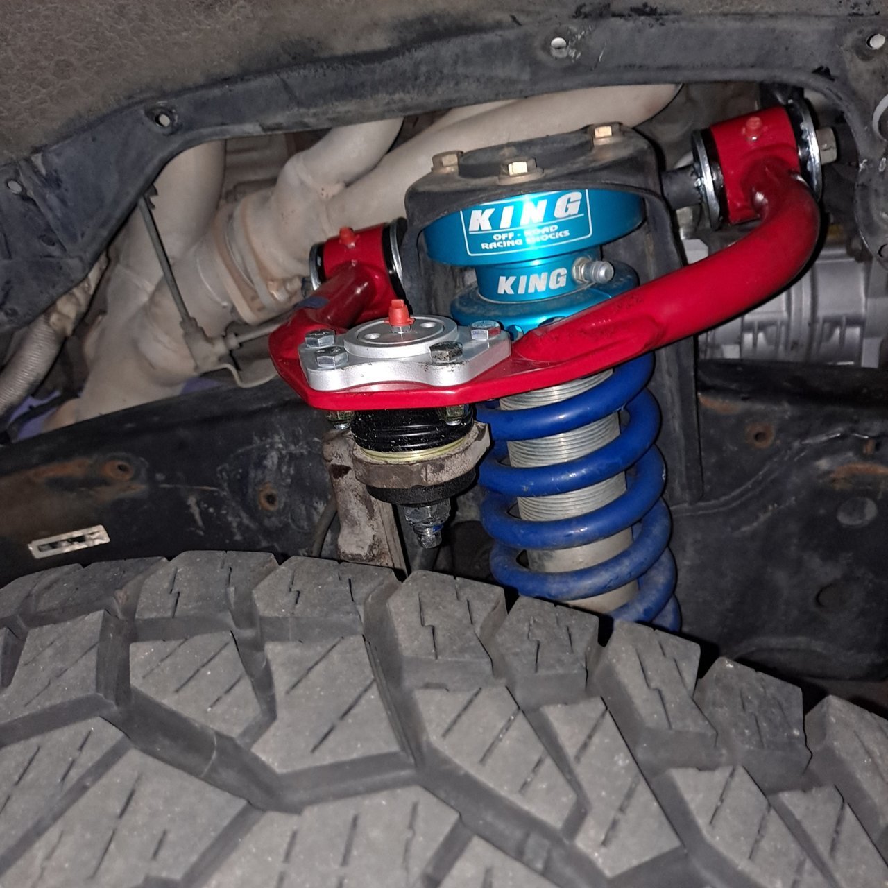

    More updates,
    Added a billet aluminum 333 steering clamp and JBA UCA.

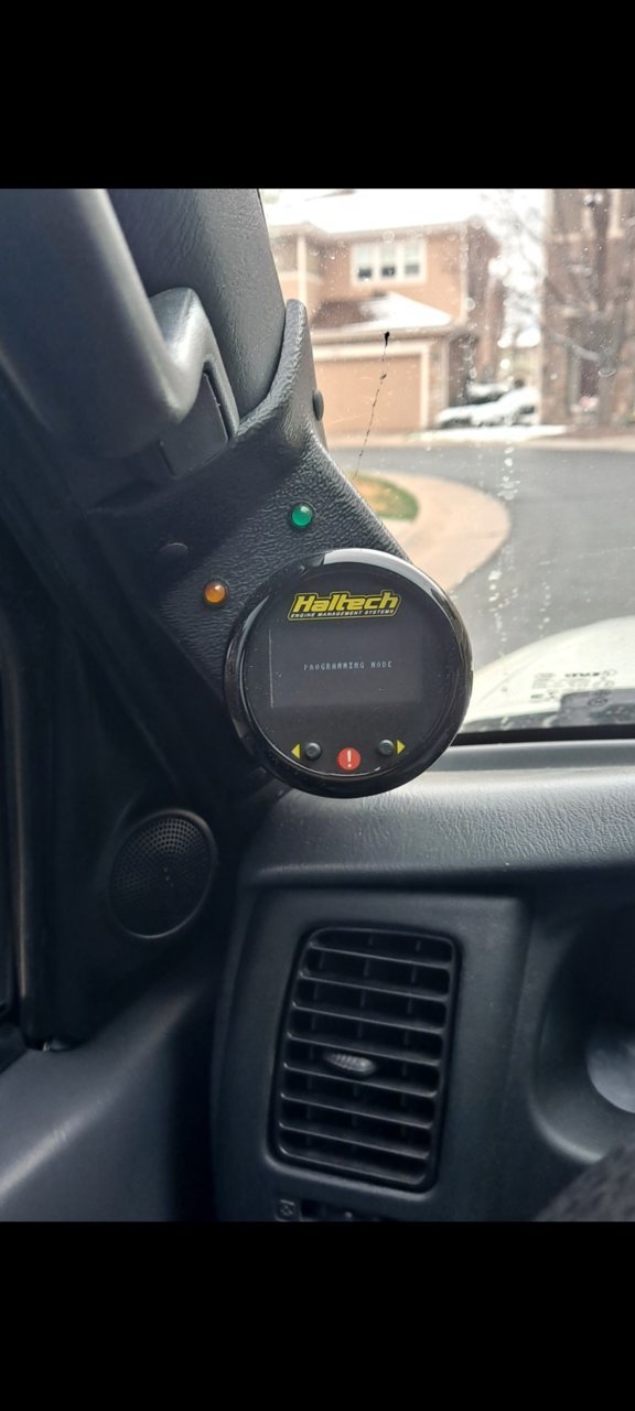

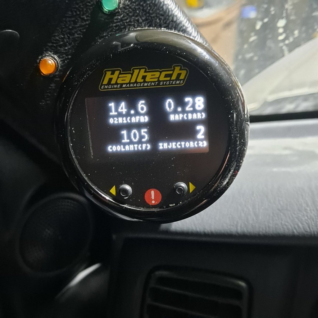

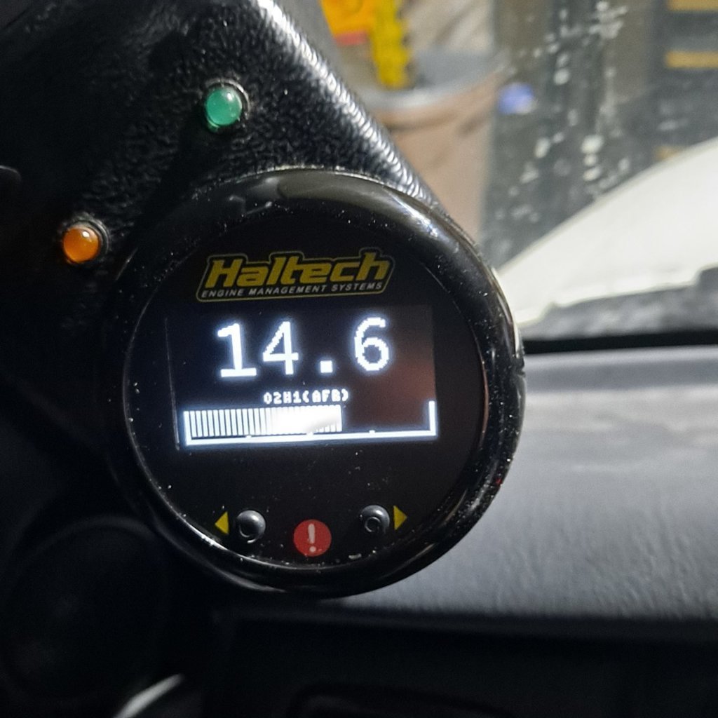

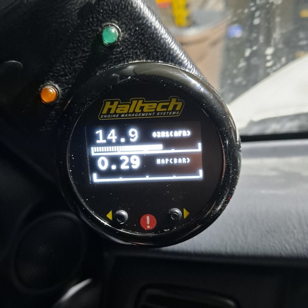

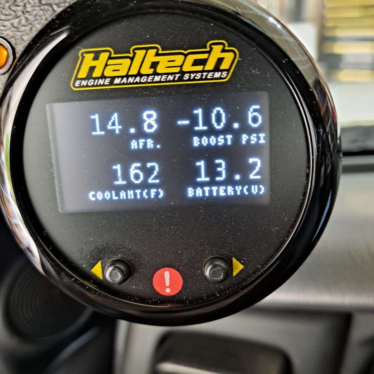

    Haltech can gauge installed today.
    Pretty sweet!
    It runs off the haltech ecu, so just plug and play with one small wire harness.
    No 02 sensor or vacuum lines needed because it's reading everything off the ecu.
    No needed for the scangauge II as all that info is now available through the gauge and more if you want.
    You have up to 10 pages available to program.
    On each page you can have 1 or up to 4 different readings.
    For the 4 different readings I have,
    1) AFR
    2) BOOST
    3) ENGINE TEMP
    4) INJECTOR DUTY CYCLE
    Got my haltech from snpspeed.com

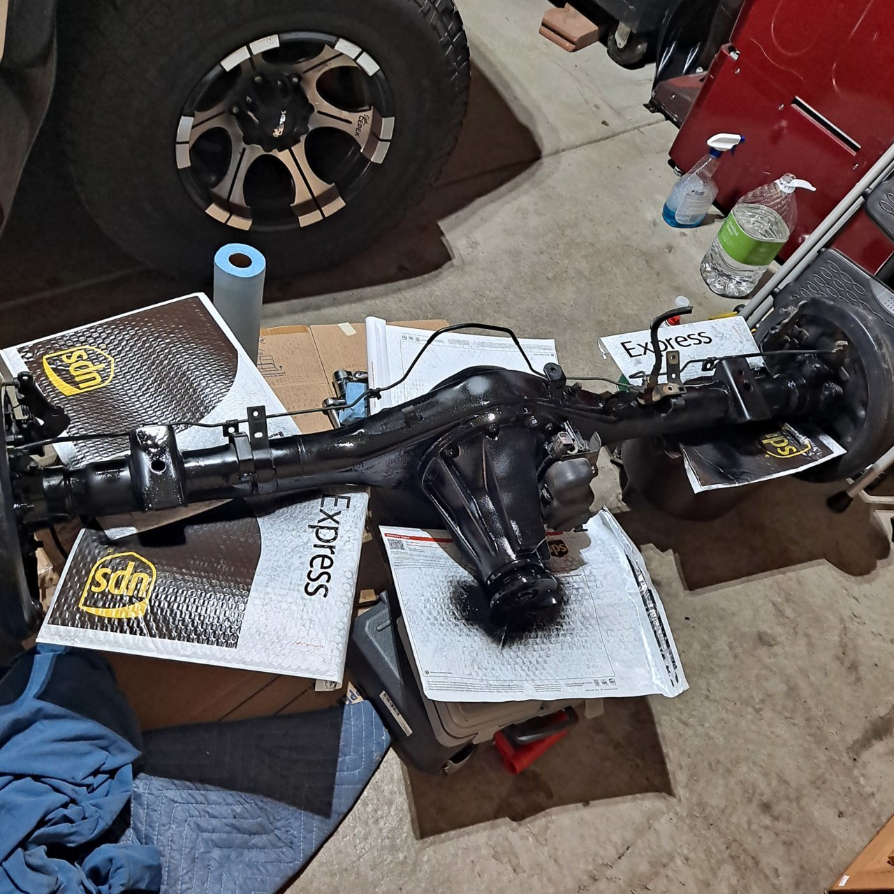

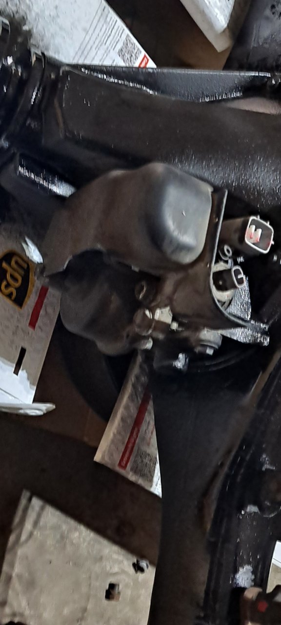

    Getting the rear elocker diff swapped in.
    Cleaning and painting the new one.
    Then getting the low range harness for plug and play setup to be able to activate it anytime

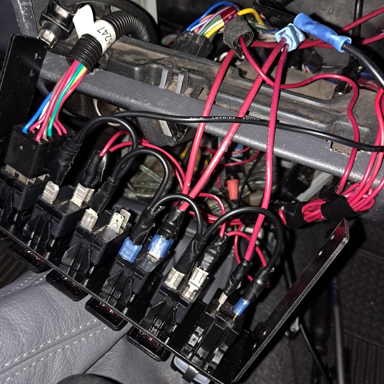

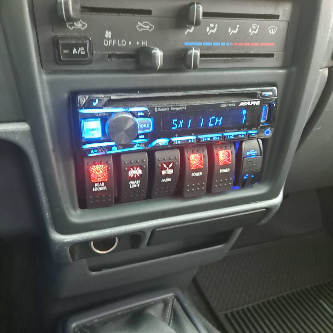

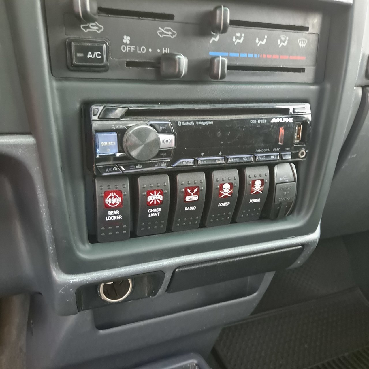

    Got the elocker trail gear harness installed and wired up some new switches and a USB port below the radio,
    Came out sweet:)
