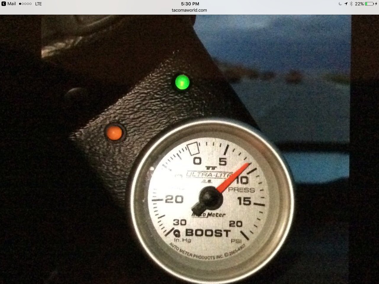

    My kit is made by Snow Performance, is a progressive kit, the pump shows 300 psi, base price is 495.00,
    I got a low fluid sensor and has a light that shows when the system is spraying,
    Installed both light indicators in the boost guage pillar

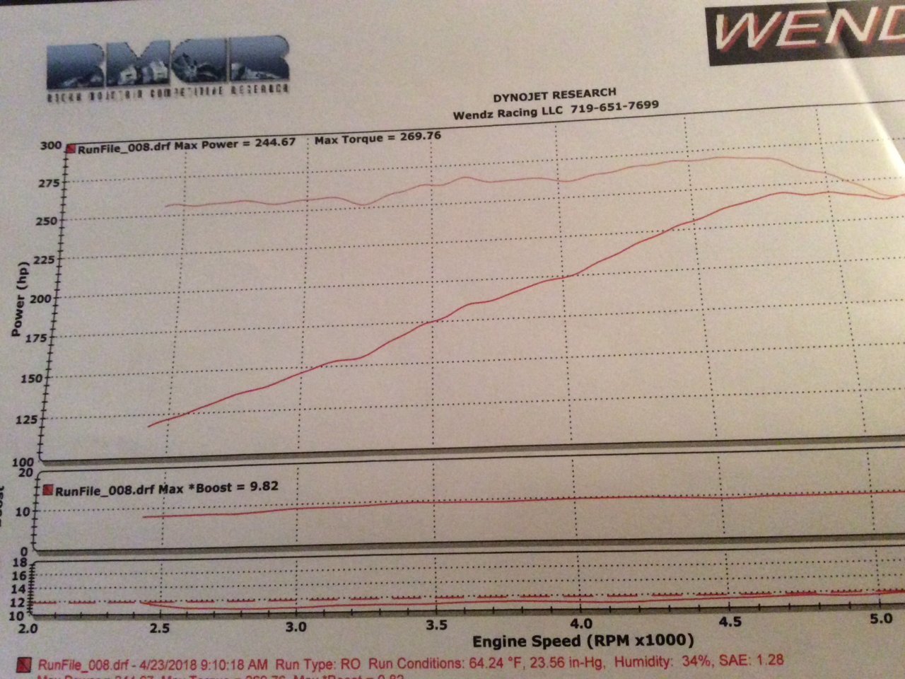

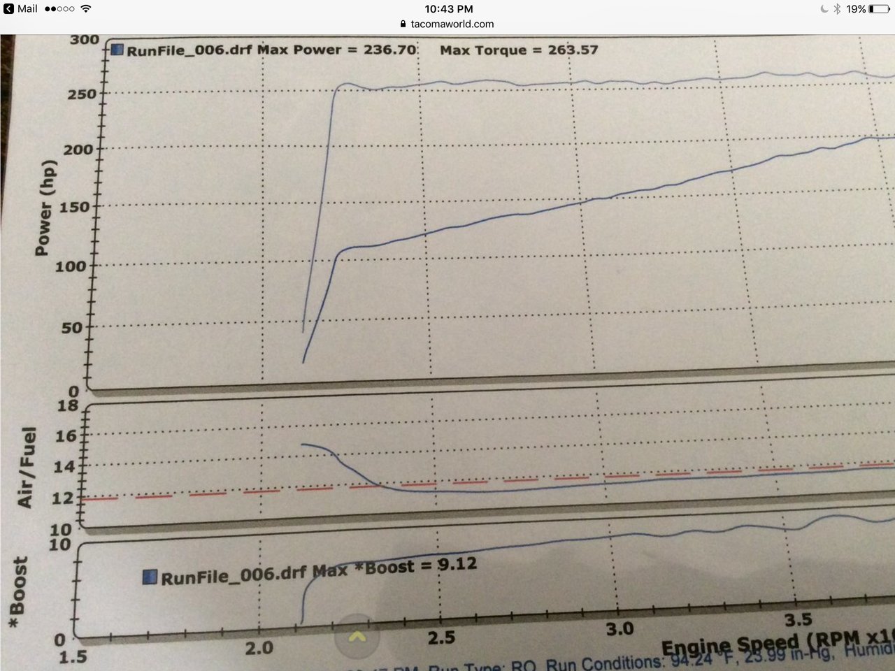

    I'm running TRD supercharger, methanol snow progressive kit, small nozzle, spray starts at 4.5 boost up, 50/50 boost juice (will give you 110-115 or so octane), KN cold air kit with elbow mod, with 2004 fuel injectors
    that are in the 2004 motor that I replaced, A high temp 400 degrees nose cone seal, 2" pulley that produces 9-10 pounds of boost for me at 6000
    feet, and produces about 240 hp and 265 :)(torque@2300rpms):) at the rear wheel which is about 300 hp and 325 torque at the flywheel, this is what you can expect at 6000 feet,
    At sea level would be much higher numbers,
    NO 7th injector, No fuel pump mod, No ECU mod, no intercooler, minimum installation time.
    The methonal kit address ALL of these issues for my system at a fraction of the cost 495.00 and you can see from the chart my AFR is dead on PERFECT under full boost of 9 pounds. Has to be one of the best options money wise I have added and didn't even consider the his option until this year because of the lack of info on this site.
    Post. 245 horses. 270 torque
