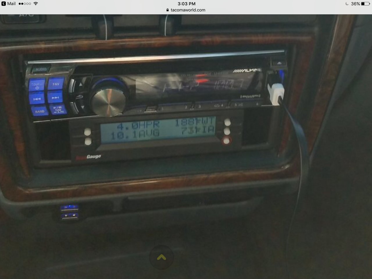

    Added the scan guage finally, not sure why it took me so long,
    Was a 5 minute install that fits perfectly under the radio in the lower compartment
    04yota, Phessor and Dalandser like this.

    What do you keep track of with it?

    There 15 difference guage options to pick from. Gives you all types of options to monitor your engine plus if you get a check engine light. You can customize the guage info you want on the front screen.
    I track my MPG, AIR INTAKE TEMP, WATER TEMP, VOLTS

    The kit has been fantastic for me at my altitude of 6000 feet. I did switch from a #1 nozzel to a #2 nozzel. The number 1 nozzel
    did plug up for some reason maybe because it’s so small. Otherwise it’s been perfect.
    I have close to 30,000 miles on the kit so far. I use half boost juice that is 50/50 with windshield
    fluid that is 70/30 methonal that is rated 20 below. One of my better upgrades for the 2” pulley letting me run 10 pounds of boost with zero issues and no more heat soaked issues
