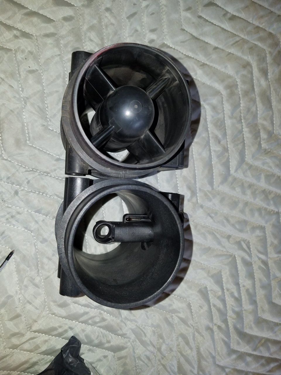

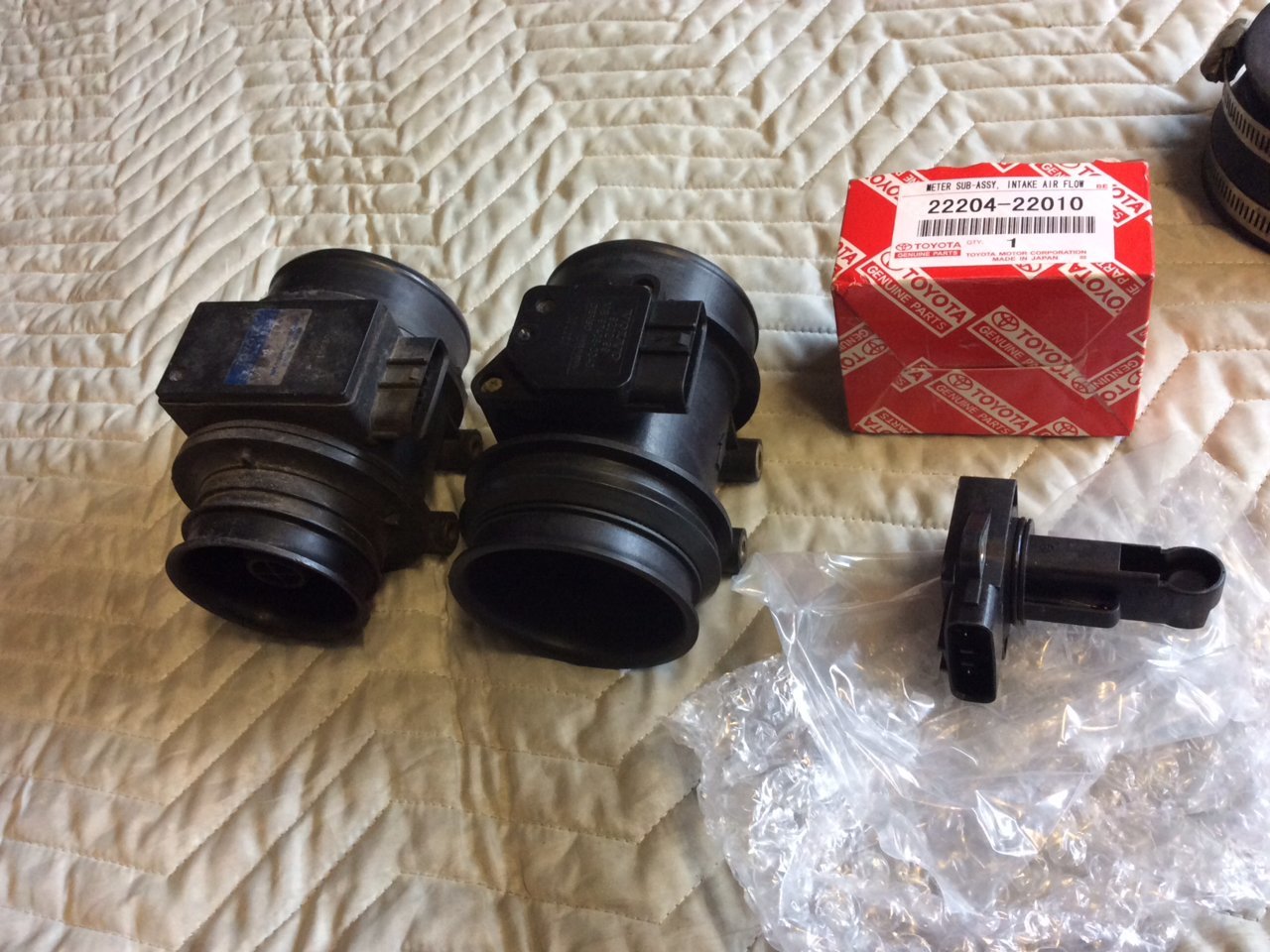

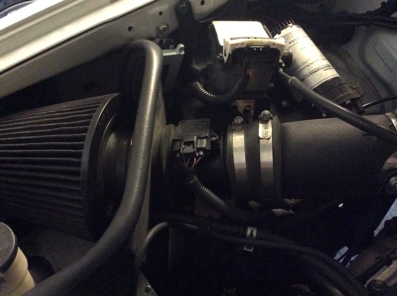

    Did a Volvo MAF swap yesterday so no more restrictive air flow and now can replace the MAF sensor if needed in 2 minutes,
    Truck now gets much better gas mileage, 3 more miles per gallon, 1/2 pound more boost.
    Wish I knew about this swap along time ago.

    Do tell.
    I know in my supra days we used to swap a Lexus housing over and out 550cc injectors in as it was 25% bigger housing and about 25% bigger injectors so was like cheating for tuning haha

    Here is the swap info, it’s a great deal for the supercharger and my mpg went way up, no ECU mods needed. And NO more Restrictions in the to the supra I believe still had this restriction any airflow ratio was changed
    https://www.tacomaworld.com/threads...1996-to-1999-3-4-supercharger-upgrade.542496/
    Blackdawg[QUOTED] likes this.

    Doing this didn't trigger a check engine light?

    Nope, the inside dimensions are the exact same as the stock dimensions with the Volvo, so the ECU does not need any adjustment.
    More power, alot better mpg for me

    oh no I mean doing the the mod to supras. Not a supra maf to a tacoma.
    Cool info. Will be doing this.

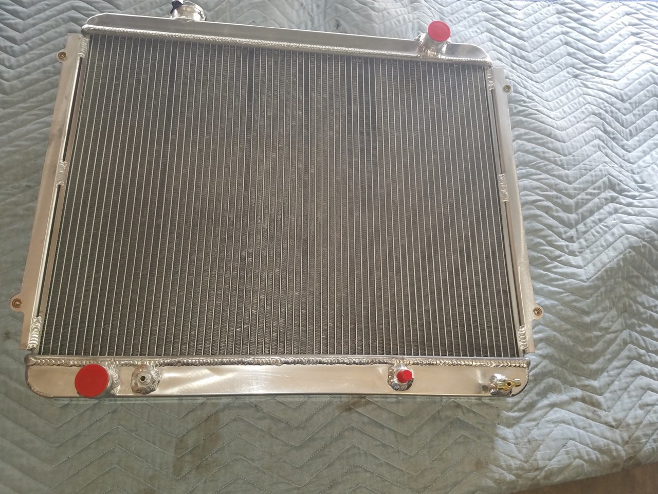

    Finally found some time to install the new Champion Aluminum Radiator today.
    It’s 3” thick compared to the stock 0.75 core
    It has 3 cores compared to stock 1 core
    Has Aluminum tanks compared to stocks plastic tanks
    Has metal and brass petcock compared to stock plastic petcock
    Makes the stock radiator look like a piece of junk
    Link below for installation
    https://www.tacomaworld.com/threads...e-swap-3-4-supercharger.543859/#post-17602780
    Win Win
    boostedka and 04yota like this.
