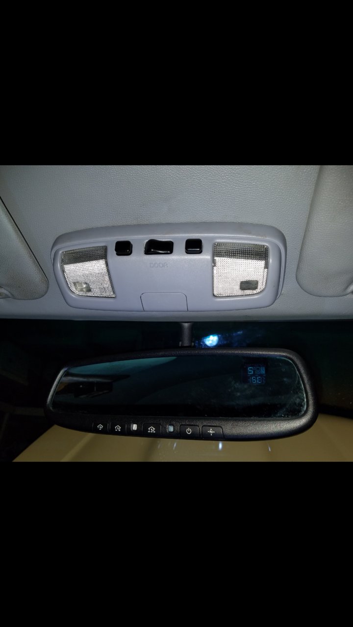

    Updated the Gentex 177 mirror to the newer 453 model with homelink today

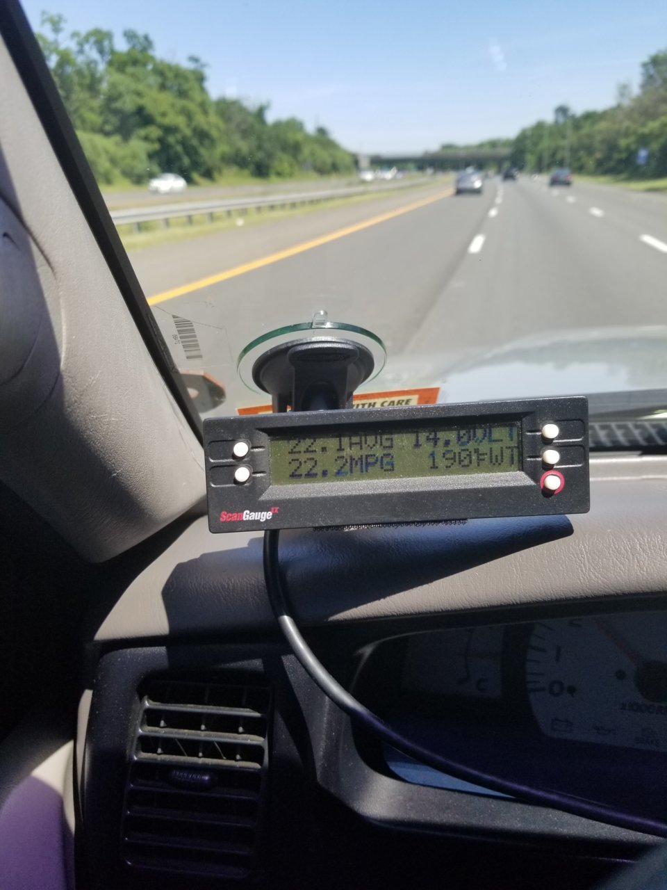

    Hey John what are your temps now with the methanol? My scanguage reads 190f all the time, even in 90+ degree weather wit the ac on. I dont hve the blower on yet, but the Stant thermostat I bought is the 170f

    The function of the cooling from the methonal primarily will cool down the supercharger a lot, not Engine temps so much.
    If you run a smaller pulley will definitely help. Engine temps don’t really change for me.
    Engine usually runs 188 degress almost all the time 188-190 with the supercharger and AC on the road.

    You have a 170f thermostat?
    I bet your new radiator is keeping them temps down:D

    No, I have the 185 stat, I don’t like changing the operating temps that the engine was designed for.
    The new radiator keeps the temps on point at 188-190 even when full boost with AC on,
    even with the 170 stat the engine will not run at 170 degrees
    anyways, there’s lot of thoughts about this.

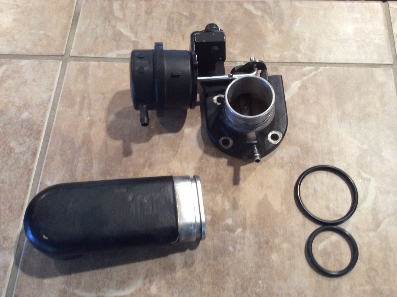

    #177
    1997tacomav6
    1997tacomav6 [OP] V6 5sp,RegCab,TVS1320 Supercharger,Haltech, 800k
    Oct 5, 2013
    #113940
    10,393
    John
    Denver
    97 reg cab, v6 5sp 300hp supercharged, Methonal Injection, 800,001 plus miles, Original Owner
    V6 5sp,RegCab,TVS1320 Supercharger, 56mm pulley, methanol injected Haltech ECU, AC Tvs1320 supercharger,(MUST DO) every 125,000- 150,000 needs rebuild Projector headlights HID 5 speed manual Amsoil for all drive train Smaller 56mm custom pulley, (MUST DO) 2004 DESNO fuel injectors, zero ping ping, 2004 side door mirrors Dick Cepek Rims, Michelin tires LTX, ATM Pathfinders Dynopro ATM ( that last 100,000 miles) Now running Dynopro ATM mud and snow tires KN cold air intake Cat back dual exhaust with ss exhaust tip, Raised exhaust tail pipe to 2" below body line Optima*dry cell battery,red top Alpine sirius radio, 200 watt amp, focal is165 split door pod speakers Focal door speakers Subwoffer behind seat Viper alarm, Electric Locks Dark tinted windows, bucket seats corbeau lg1 Tacoma Rubber floor mats TRD fender extenders, Bilstien shocks, King shocks JBA UCA trailer iv hitch, electric brake control, Drilled slotted brakes, High carbon steel (MUST DO) EBS green stuff 7000 series pads(MUST DO) TRD engine oil cap TRD stick shift, Marlin crawl shift kit. Rear sliding window 2002 4Runner functional hood scoop cut into Tacoma hood, 4Runner dual overhead map light Gentex Auto dim + Compass + Temp, garage,rearview mirror Snow Methonal kit stage 2 Custom 3 core aluminum radiator Linex bed liner Haltech stand alone ECU, Intake supercharger gauge. Stainless steel brake lines, Custom leather wrapped steering wheel, Haltech stand-alone ECU,
    Had to replace the bypass O-ring seals on the bypass on the supercharger.
    I had a vacuum leak there, don’t get them from your local parts store.
    You need to have the high temp seal and then use some motor seal permatex sealer.
    JB Performance has the high temp correct size if you need for the 1st gen supercharger.
    boostedka likes this.

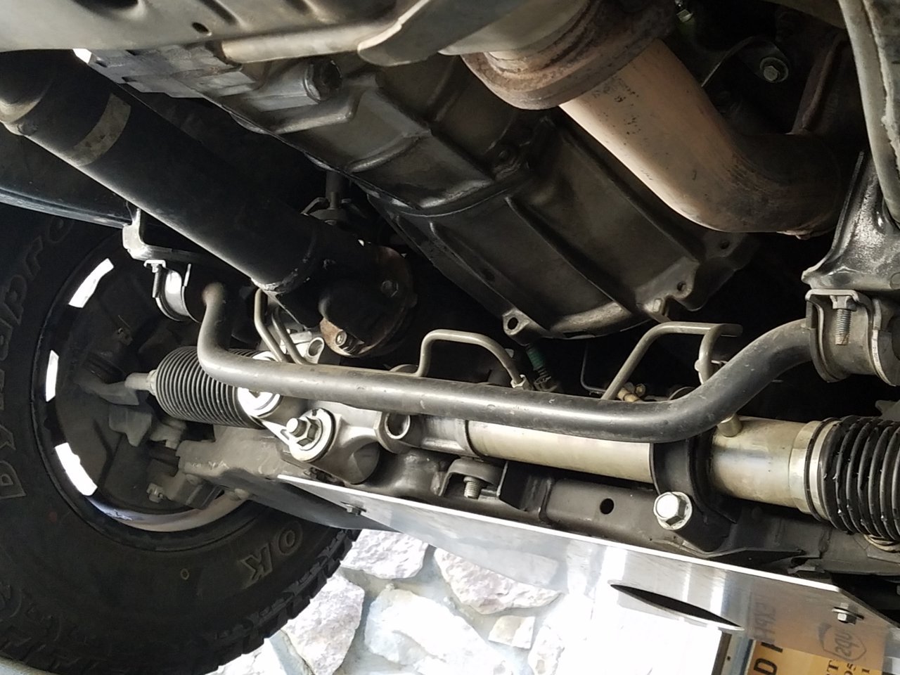

  18. Jul 20, 2018 at 7:33 PM
    #178
    1997tacomav6
    Oct 5, 2013
    #113940
    10,393
    John
    Denver

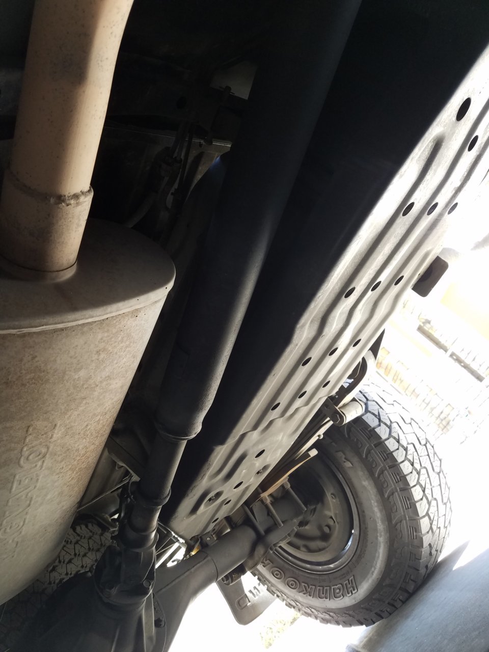

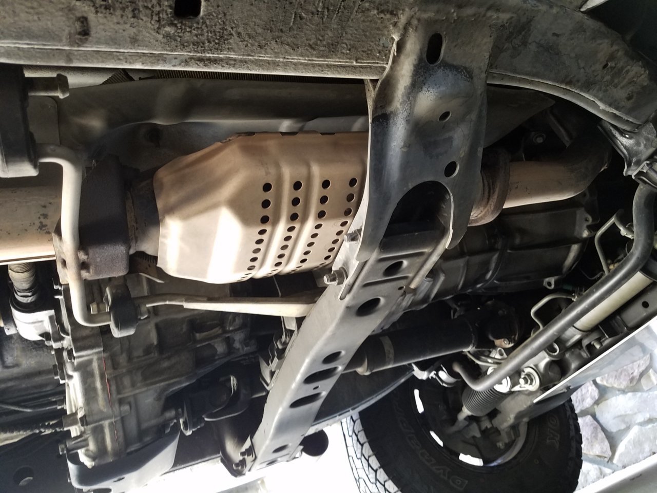

    Also wanted to add some photos of the frame because of the many rust issues.
    No rust anywhere on my truck, maybe because it’s an original Colorado truck.
    So There are actually Tacoma trucks that don’t have rust issues believe it or not out there.
    DJB1, silverbullet02, 04yota and 2 others like this.
  19. Jul 21, 2018 at 9:54 AM
    #179
    04yota
    04yota Well-Known Member
    Mar 12, 2014
    #125177
    1,220
    Angelo
    Central New Jersey
    04 ext cab supercharged 5speed
    That's really clean man. I bet people around your neck of the woods keep their cars for longer. Around here people tend to change them every few yrs because they rust to pieces.
